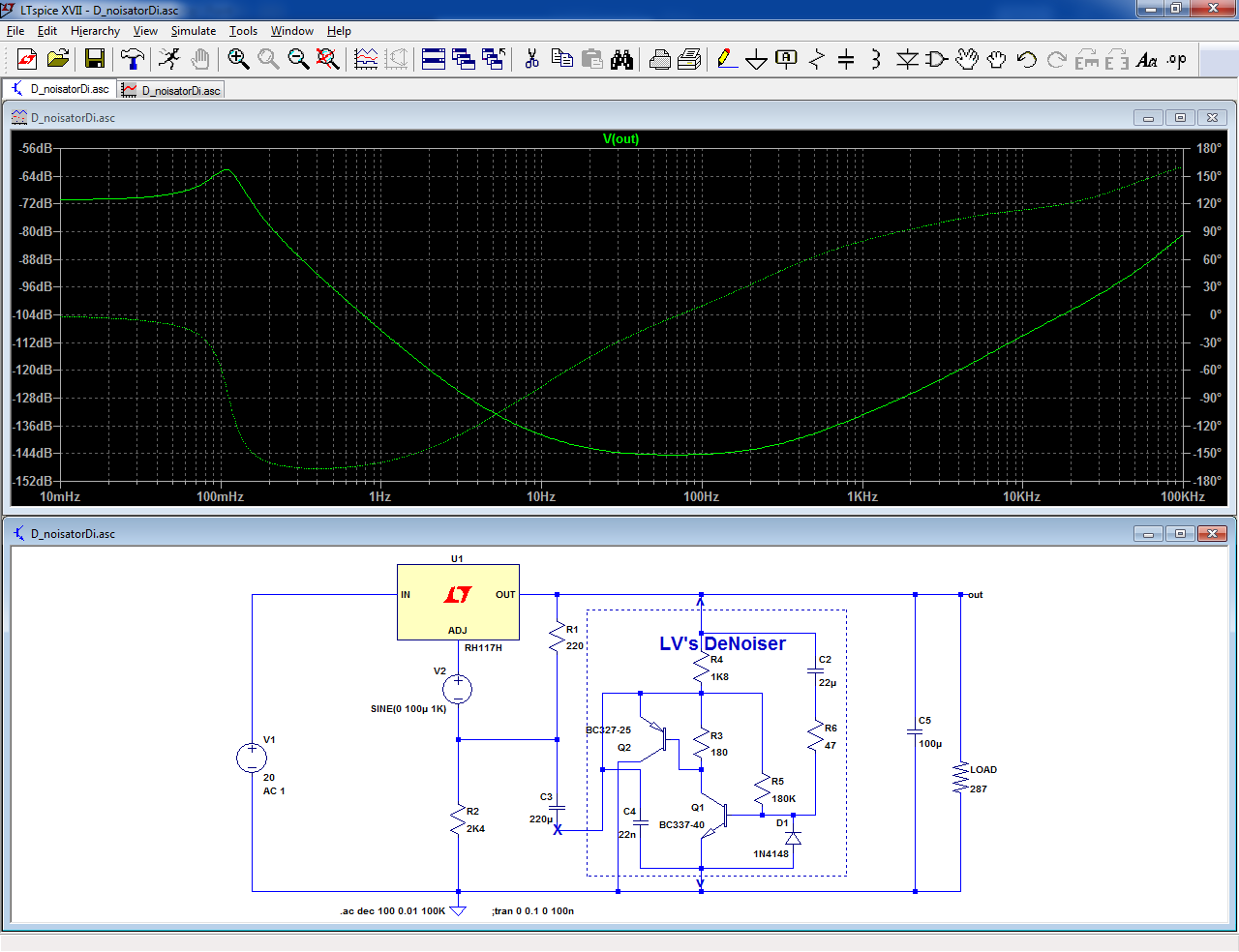

I have made a quick, simplified breadboard test of Diego's version, let's call it the Dienoiser, and it seems to work perfectly.
Of course, a more complete assessment would be required, to investigate stability aspects in particular, but it is certainly possible to make it work.
The compensation needs to be somewhat larger than for the simple Denoiser, it oscillates with C<6nF, but 22nF seems a good starting value.

The Dienoiser has interesting specificities compared to the nonoiser and denoiser, and offers an additional 20dB overall performance compared to the denoiser

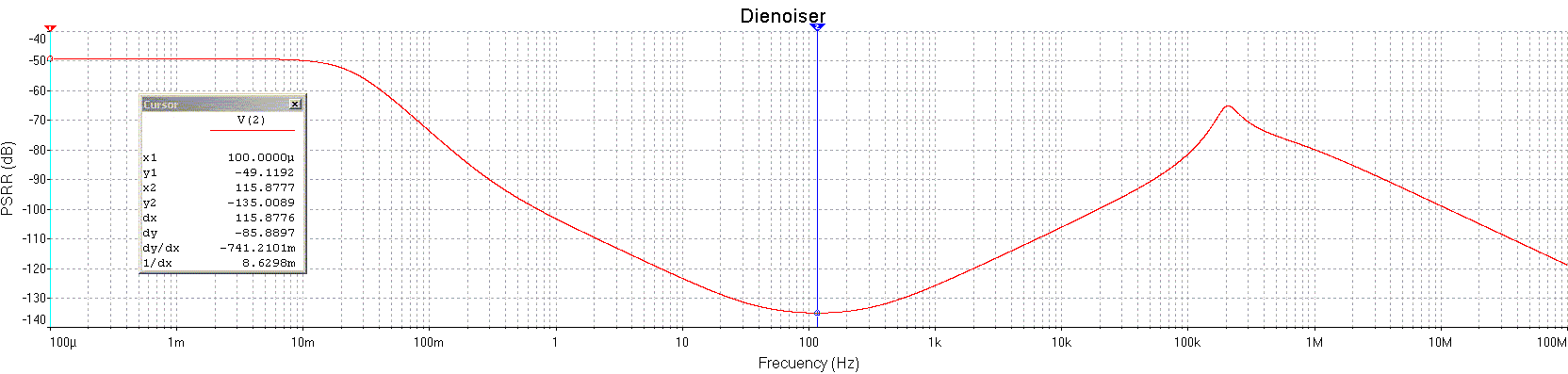

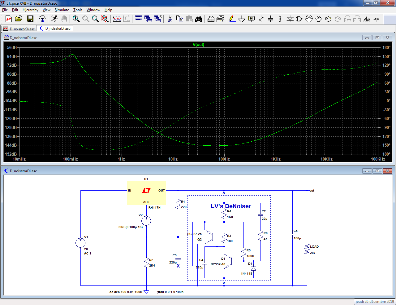

At a specific value of R3, the rejection of ripple is maximized. The first test value of 180 ohms gives acceptable results, although with values ​​close to 390 ohms we would obtain the highest PSRR in the 100 Hz range. Complementarily, some compensation capacity must be modified.
According to my simulator (Multisim 14), the biggest rejection would be in the order of 135 dB at 100 Hz, although I am observing even higher PSRR in LTSpice with only first test value of 180 ohms.
I like very much this Dienoiser!!! :D

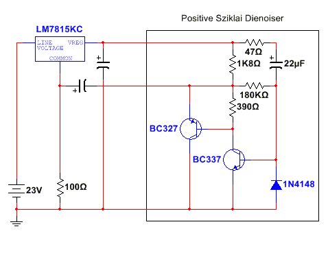

attachment.php
R3 is probably one of the most critical component of the Dienoiser: it heavily influences the performance, and it is output-voltage-specific.
In principle, a Dienoiser could be used as an upgrade for a regular 317 regulator, just like the denoiser, but R3's value will have to match the output voltage, which is a minor inconvenient considering the performance.
What the simulations predict has to be taken with a pinch of salt, because at the level reached, many minor effects are not taken into account.
What can reliably be said is that a denoiser adds >30dB of performance to a SOTA, cap-fitted 317 regulator, and the Dienoiser adds ~20dB on top of that, resulting in a 50~55dB global improvement for PSRR, impedance and noise.

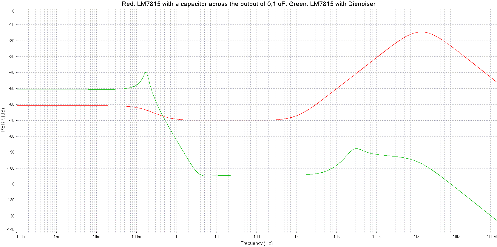

Other magic application: Fixed Regulators!!!
attachment.php
attachment.php
Compensation not shown.
The values ​​of the electrolytic capacitors not displayed may differ depending on the type of regulator. They could result in higher values ​​compared to those required for the LM317.

Interesting. As I do not have RH117 or LM317 models available on my LTSpice, I keep using the closest ones, which are LT1083 and LT1085.
They reach only -134dB @ 100Hz, instead of -144dB.
Is there a completely reliable model to use for the regulator?
Another question: why the curves you get with 22n and 220pF are exactly the same? Shouldn't they be slightly different?
Now about R3: how do you select the right value? By trying and error?

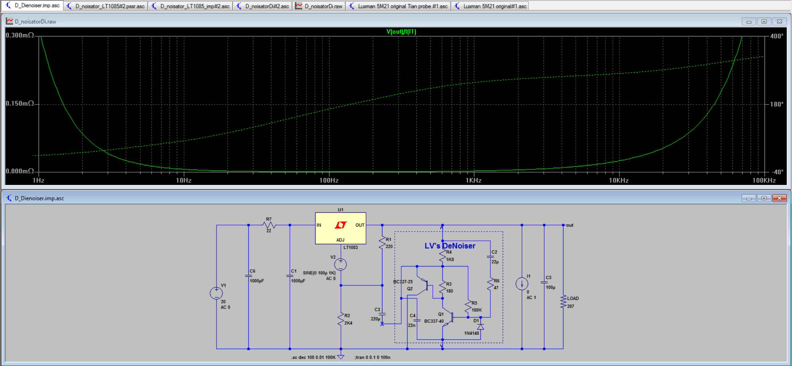

OK, I took the liberty of trying to simulate the output impedance from Diego's Dienoiser, and the results are absolutely remarkable.
Please check the asc file and tell me if the results I get are real.
I will later carry on those tests with the first Diego Denoiser version.
They are slightly different, but their effect is calculated to be identical: 22n/0.22n~= β
You simply have to write down the gain equation of the correcting amplifier loaded by the voltage setting network, take the derivative with R3 as variable, and compute the value of R3 for which this derivative is zero.

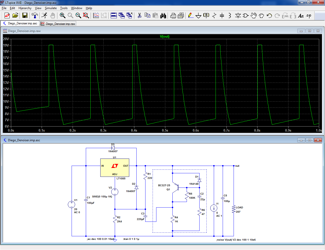

Here are the impedance results from the first Diego Denoiser mod, which I find quite remarkable.
The asc file is also included, to check if the parameters I used are OK.
You should have taken my advice into account:
Nice idea, but even if you don't want to get into hardware, I advise you to make a transient simulation: the result will surprise you....
This is the transient analysis (it is not needed in fact, because a simple inspection of the schematic shows that the phase of the correction is reversed):

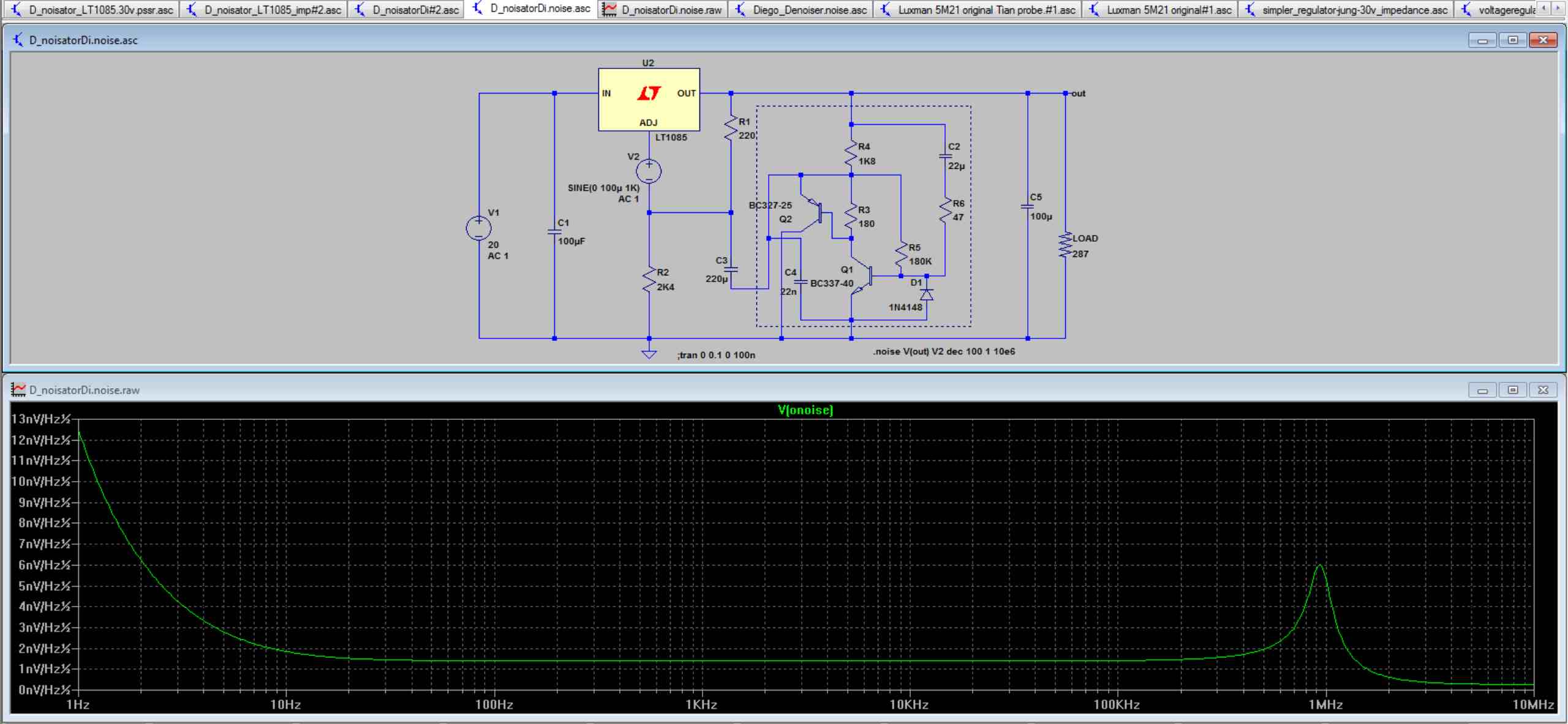

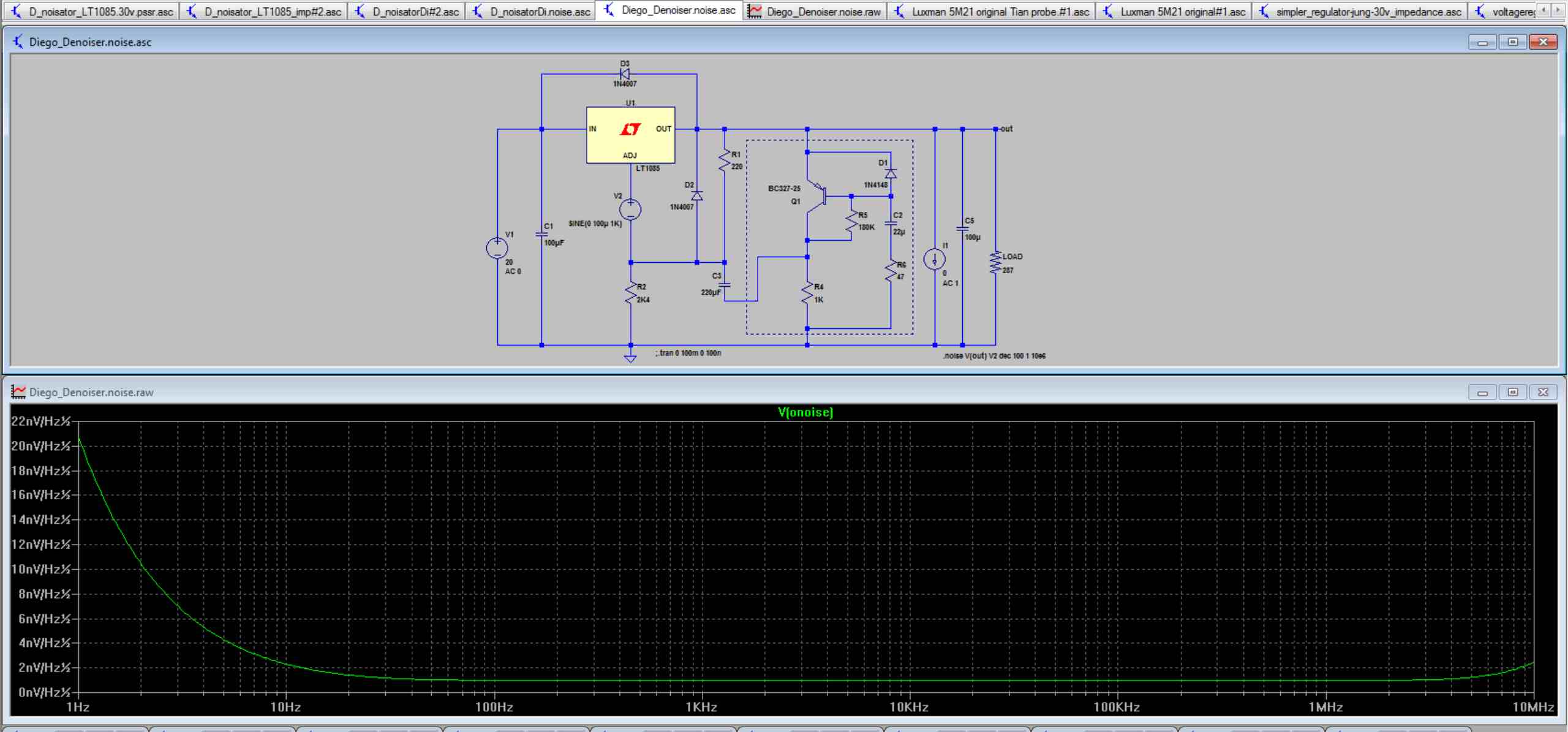

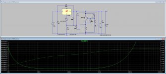

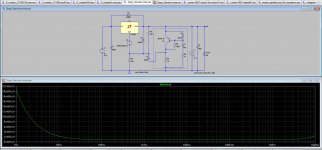

Now what about noise? I activated the noise parameters and got two curves from both Diego supplies.
Both look the same, but the more recent version has a 4.5nV peak at 1MHz.
Which of them all?
The one I gave to Diego:
He was sensible enough to follow it
Why don't you use some asc file, mine or yours, and upload the impedance curve you get?
Because it makes no sense: the circuit is non-functional (as a regulator anyway, but it works as a VLF multivibrator)
The one-transistor version is to be discarded.
The peak on the functional one is probably caused by the compensation: either it is inadequate, with a too small phase margin and a resonance, or it is too aggressive and lets some noise in when the correction runs out of steam.
The two are not mutually exclusive, and it might be impossible to find a good trade-off with a simple compensation scheme like this one
Yes, of course but even that will not always prevent silly mistakes: if the simulation time is too short to show VLF oscillations, or if the timestep is too large to allow oscillations to appear, you might see the correct voltage, or some strange voltages and behavior, without oscillations.
