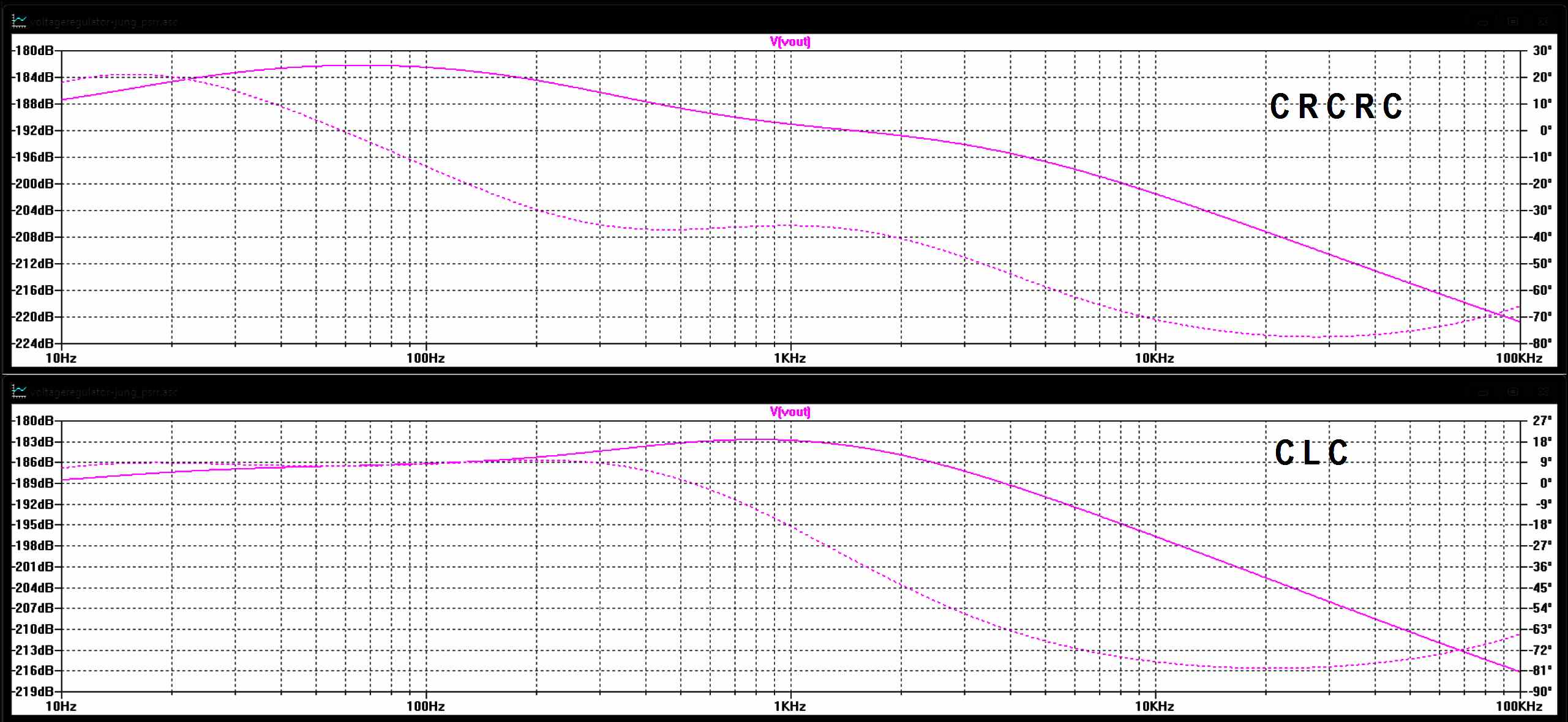

PSRR results with the inductor, on the simulation, look very very good. But I wonder if I will be able to find the exact inductor model to buy from Mouser.
Even if the results I was getting with the CRC were inferior, I then tried something that seems to very promising: CRCRC.
That was a pleasant surprise, because resistors would be very easy to find and implement, and even more: with smaller capacitors.
Using 470uF - 4.7R - 470uF - 4.7R - 470uF resulted in an even better curve than with 1000uF - 3.3mH - 1000uF.
Please take a look and tell me if you agree.

The CRCRC has a better general outlook, but at 100Hz, it is a few dB's from the CLC, but at -180dB, who cares anyway?Using 470uF - 4.7R - 470uF - 4.7R - 470uF resulted in an even better curve than with 1000uF - 3.3mH - 1000uF.
Unless you segment the filter and regulator into a number of well separated shielded blocks, there is no way you are going to arrive at such values in the real world.
You said it perfectly: there is no way you are going to arrive at such values in the real world.
So why should we go for that if that means building an impractical regulator?

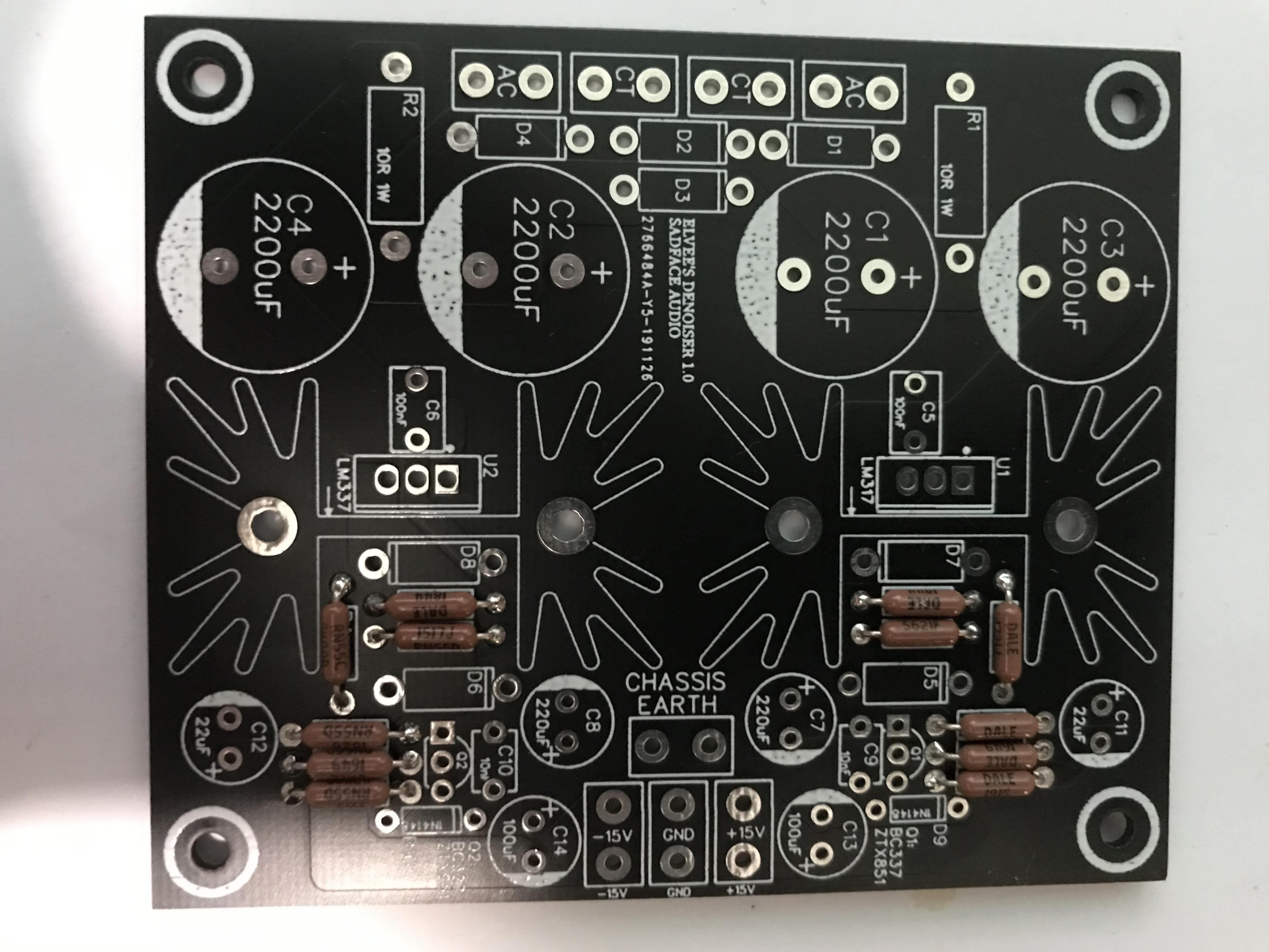

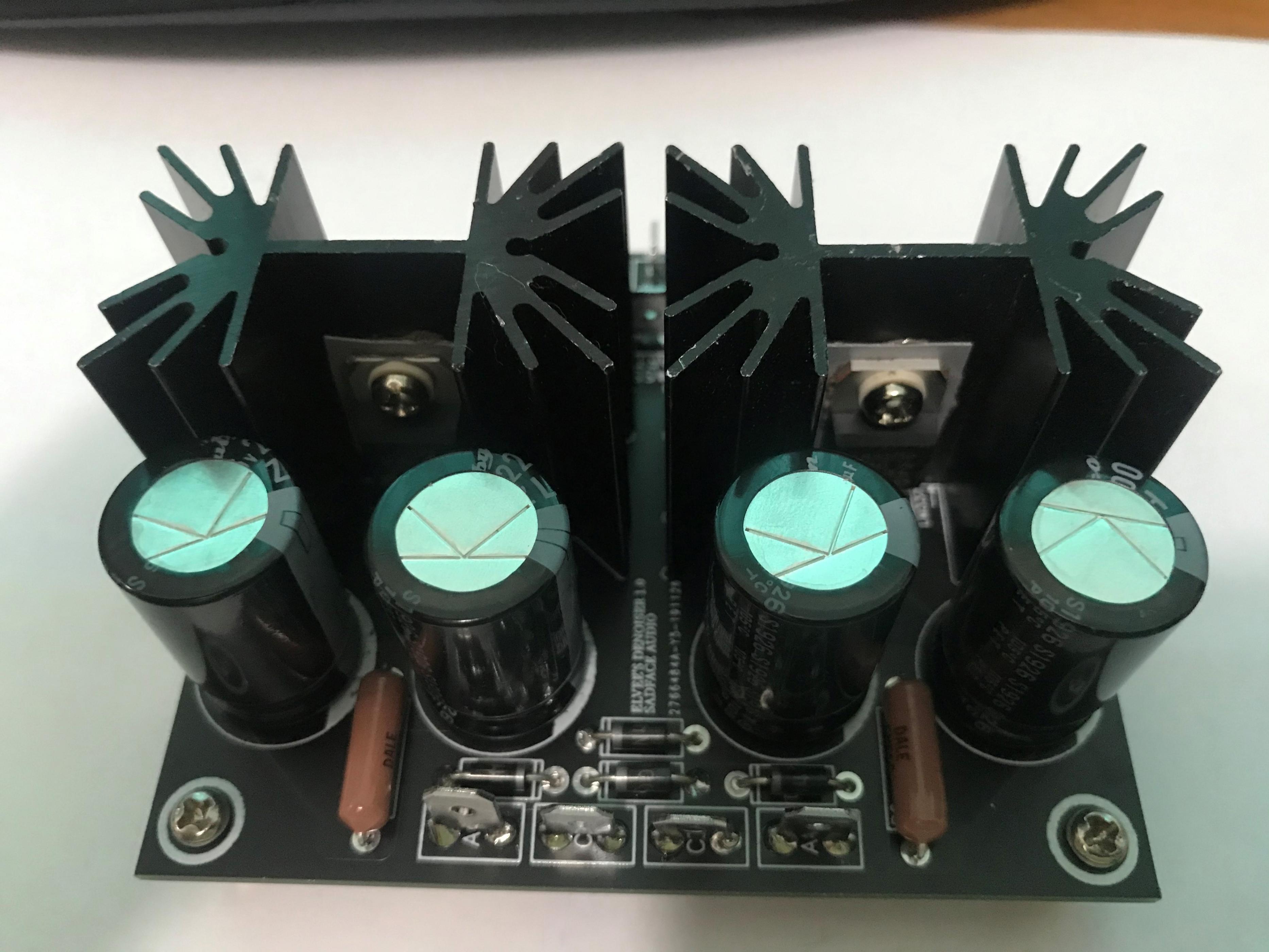

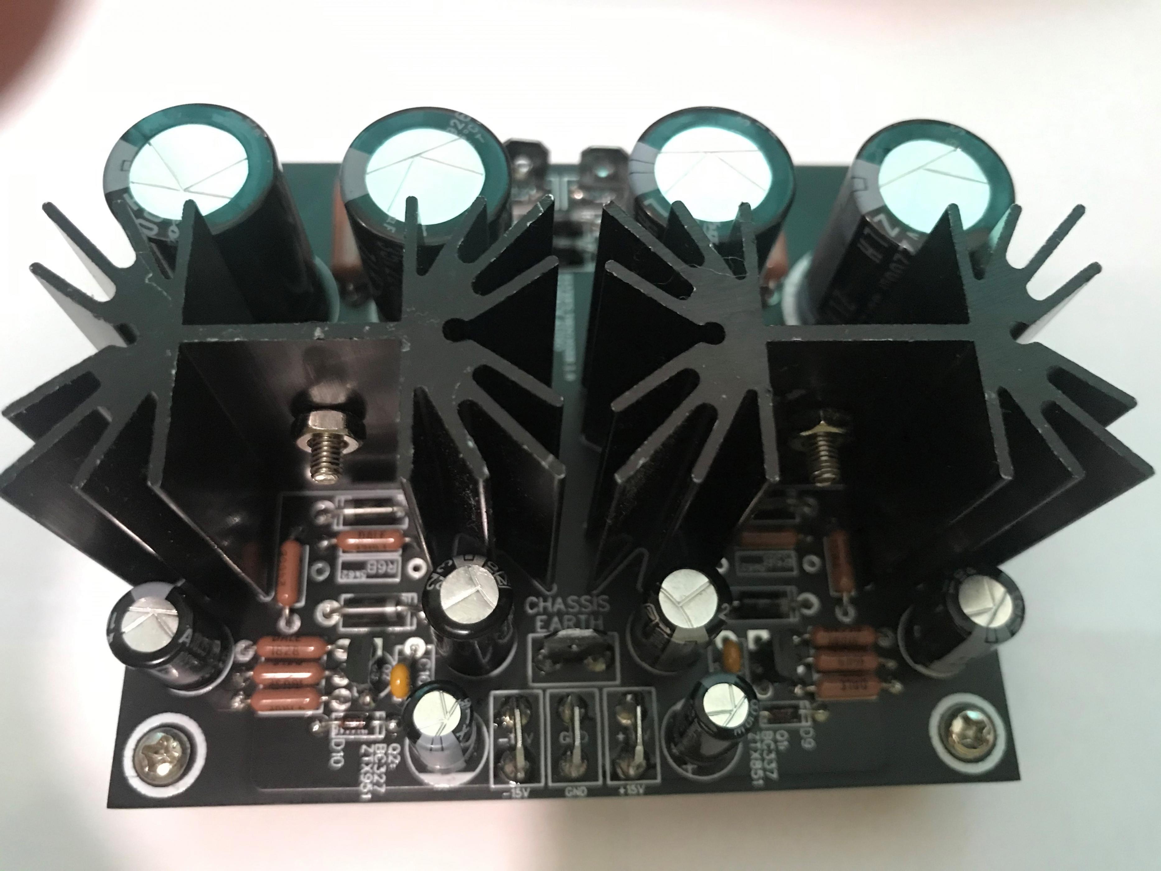

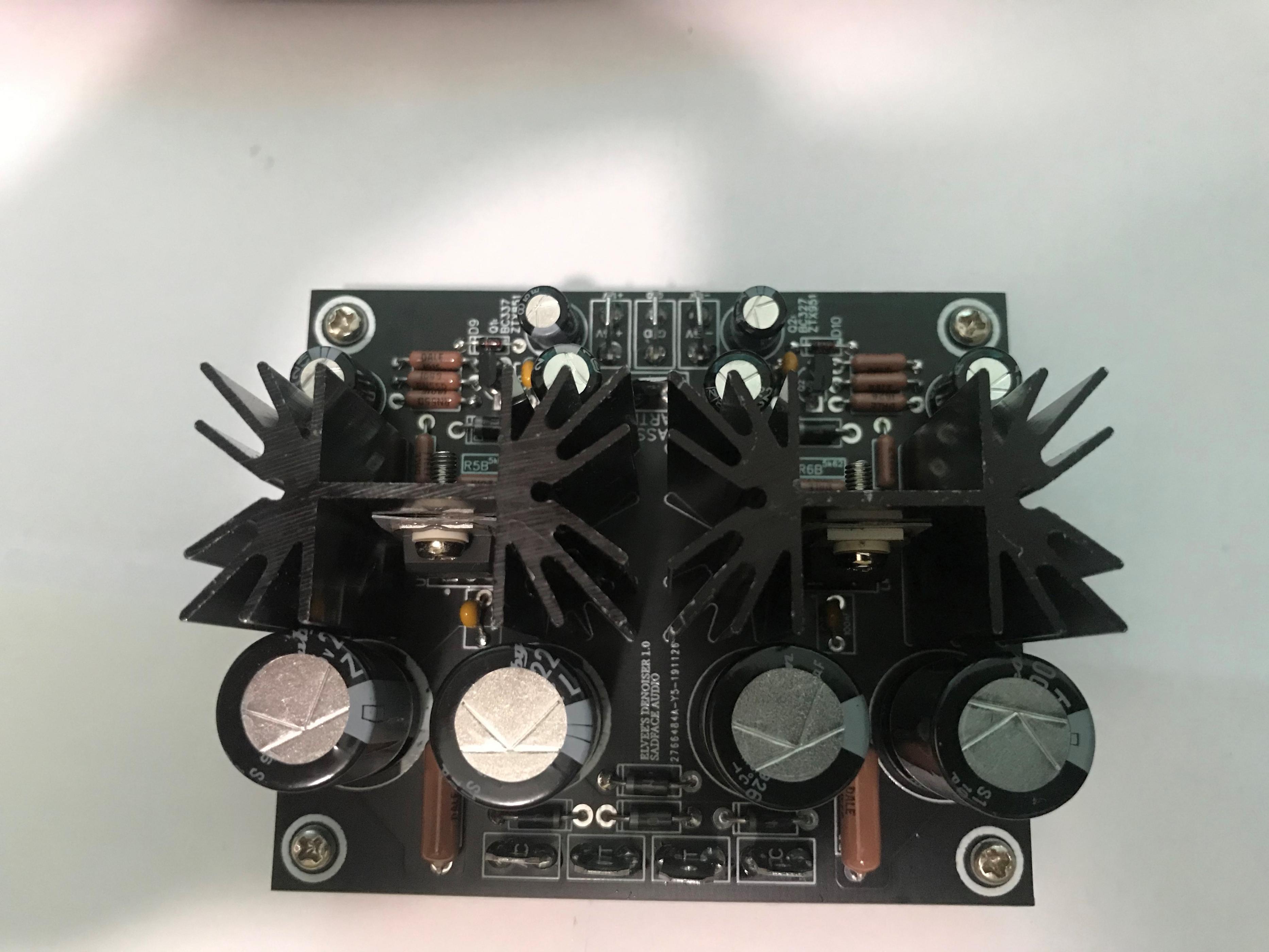

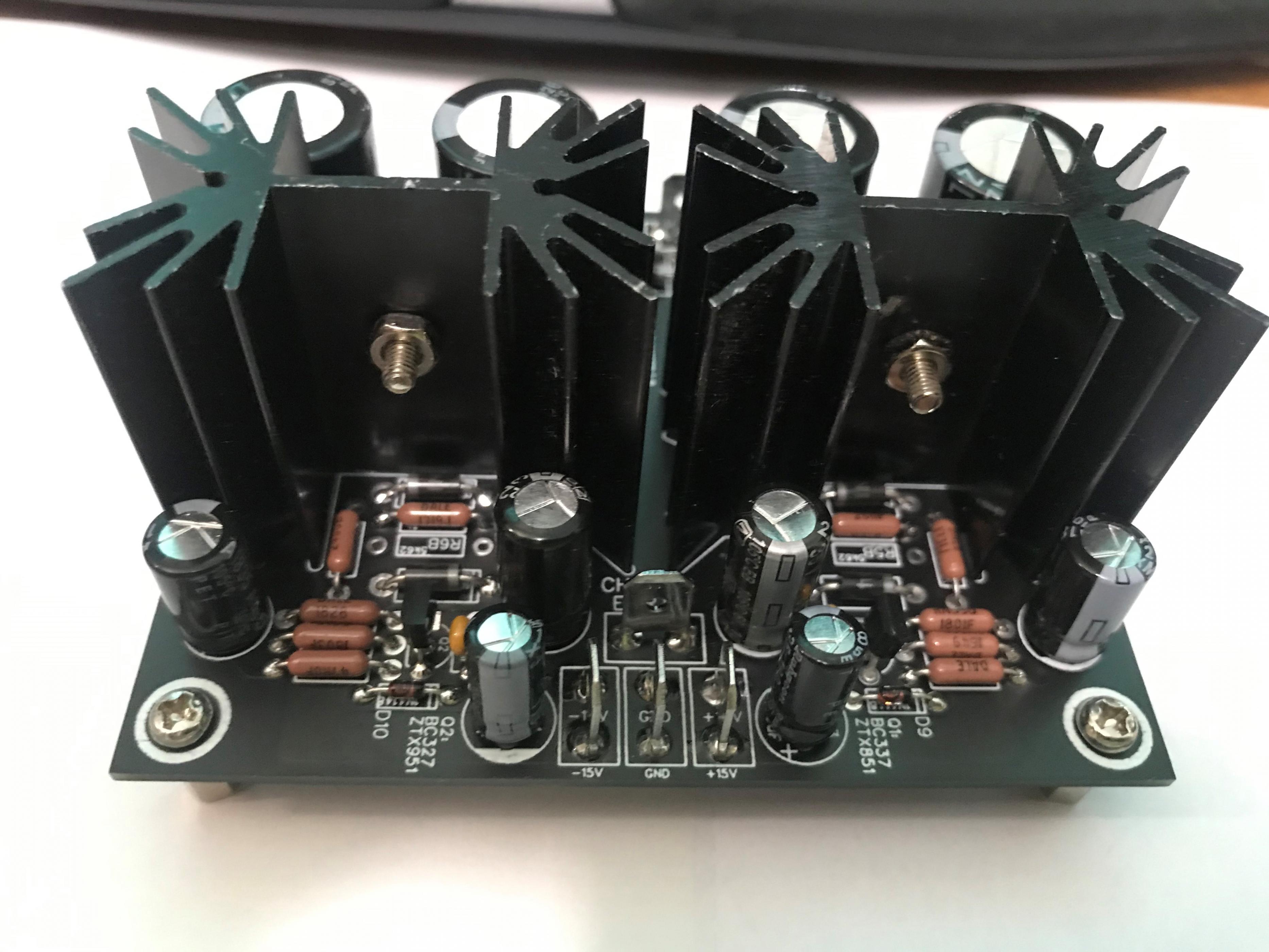

Hey guys,
Here's my completed pcb ready for testing.
I'll be making a jig for testing this afternoon so I report on my findings later.
I ended up using ZTX851/951 instead of the standard bc327/337 transistors. The pinout of ZTX devices was the opposite of the bc327/337 footprints used on the pcb so you may notice the BJTs are mounted backwards.
Resistors are all Vishay/Dale RN series or CMF series.
Ultra high reliability electrolytic caps have been used throughout. I've selected the electro caps used after the regulators to have as high ESR as was available.
Ceramics caps are X7R types.
