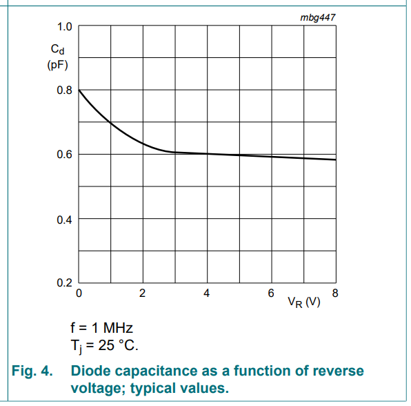

And the Nexperia BAS21,215 has 1/3 the capacitance of a 1N4149. Thus 1/6 the capacitance of a 1N4148.
_
Ok maybe you got me, but the Nexperia are surface mount.
The data sheet for 1N4149 shows total capacitance as 2 pf and the Nexperia datasheet shows diode capacitance as 2 pf also, wheres the 1/3 capacitance chart and what does the 1N4149 Measure under that test? The In4001 type are 10 to 15pf depending on voltage and manufacturer. The UF 4007 are 17pf

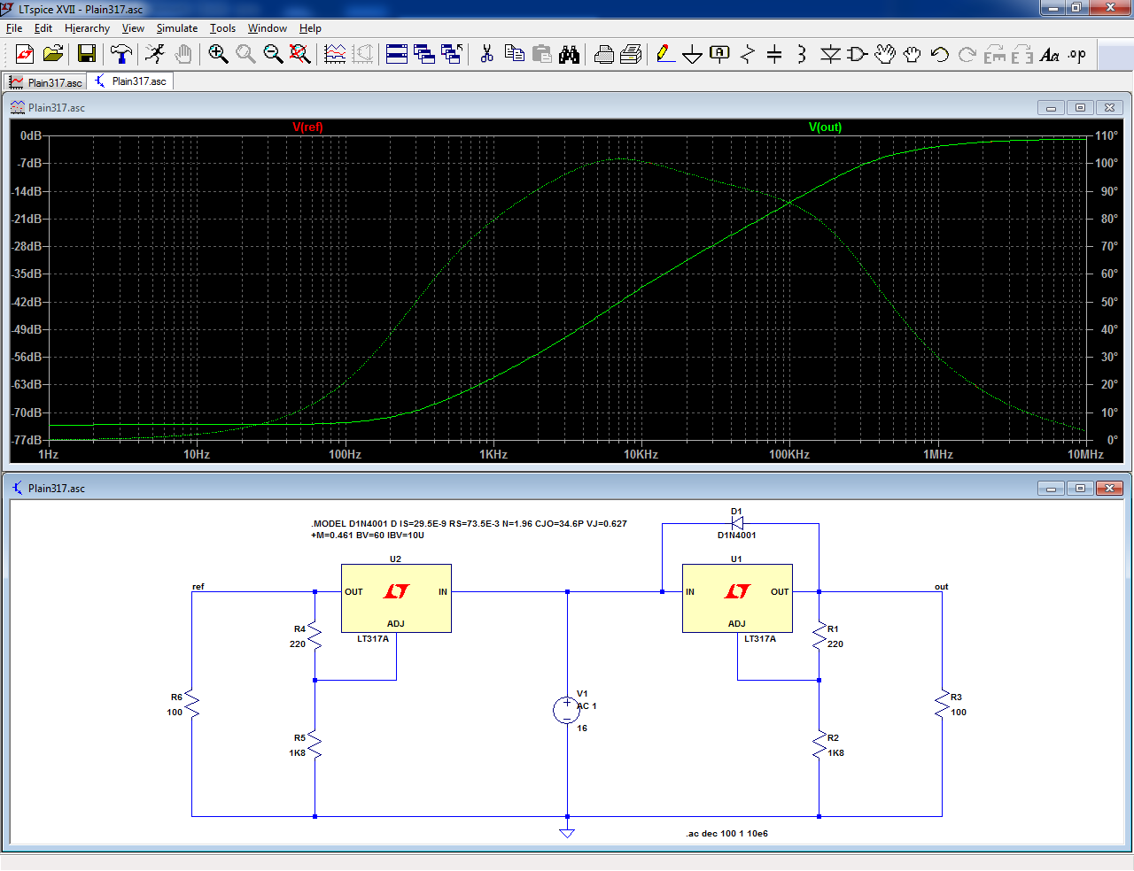

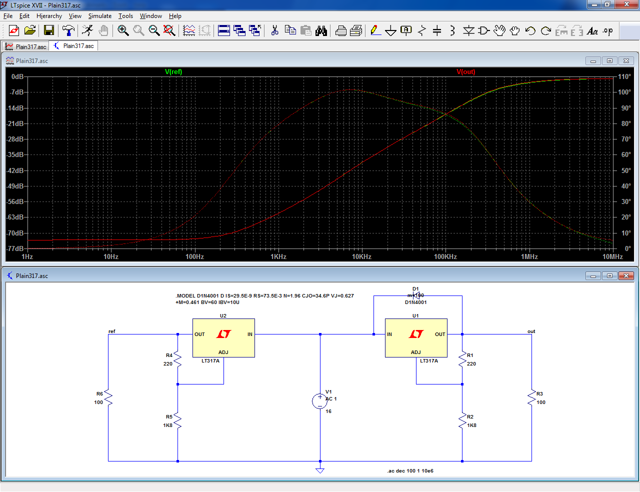

Regarding the effect of the diode capacitance, here is a sim comparing two situations zero capacitance, and 1N4001.
To make possible effects more visible, there are no capacitors at all, and the load is relatively light:
Look closely: there are two traces on the screen. Can you distinguish them?
Even if you don't believe in sims, measurements and similar artificial evaluation means, here is the simulated effect of having 100 paralleled 1N4001's across the 317 (the parameter m=100):
You just begin to see two distinct curves.
Note that this is an "ideal" situation (sort of): the load is light, purely resistive, and there are no caps anywhere in sight.
If you add the normal caps for a 317, you would probably need 1,000 // diodes to see a difference between the curves, and with a denoiser this would rise to 10,000 or thereabout.
But if you can hear the difference, and if your 317 is better protected with your D+R network, I am certainly not going to contradict you: everyone has a right to his/her freedom space

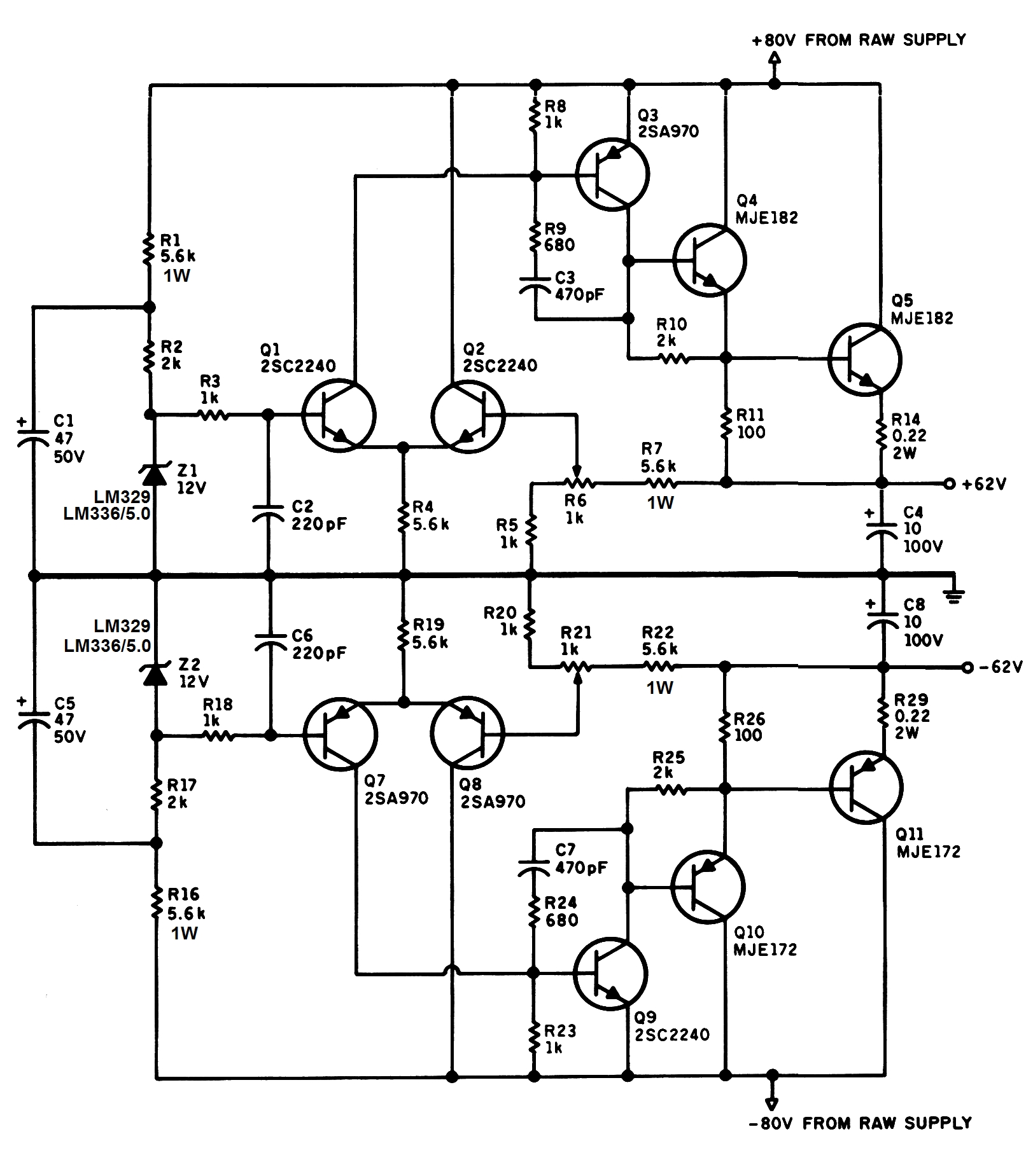

Is it possible to adapt the DeNoiser on a low current, high voltage 317/337 regulator, to be used to power the low current stages in some power amps I will be assembling?
The regulated output would be +/-67v, so the input would be around +/-75v, as those regulators are not LDO types.

In principle, yes, but that's not something I would encourageIs it possible to adapt the DeNoiser on a low current, high voltage 317/337 regulator, to be used to power the low current stages in some power amps I will be assembling?
Yes, that's the theory, and it works wonderfully in sims and demo's, but when it's confronted to the harsh reality of transients, shorts, disconnections, etc. it is an endless source of problems and annoyance, because the meltdown of the regulator generally has further consequences.Even if those regulators are not designed for high voltages, the requirement is that you do exceed 40v between input and output,
I have had to analyze this kind of failure ever since the idea was published in the application data tens of years ago, and the remedy was either the replacement by a cruder, discrete regulator, or a bullet-proofing of crowbars, transils and fuses more costly than the initial regulator.
Just use a TL783, it's made for the job, isn't costly and is much safer

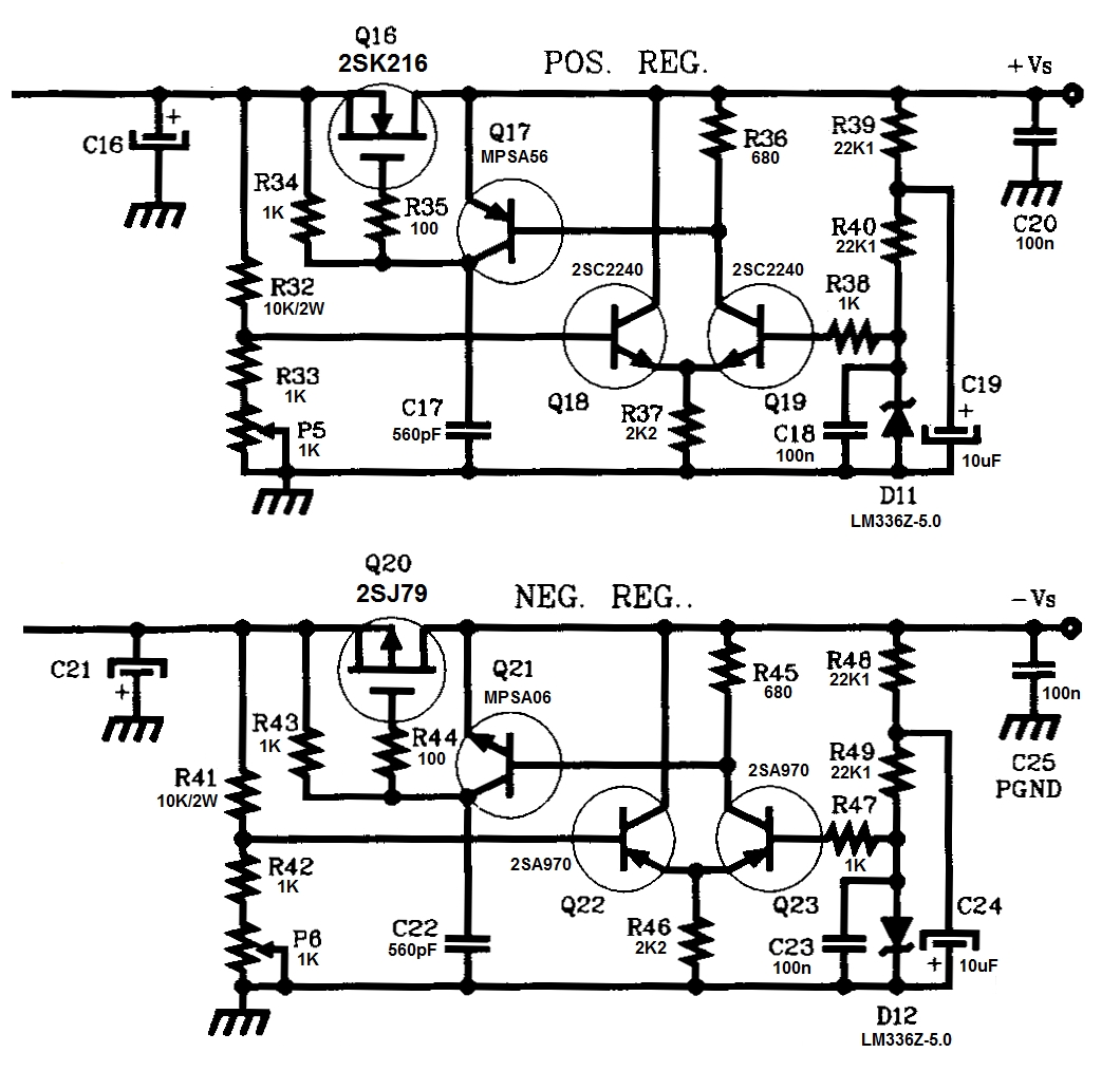

Today I found one of the articles, from The Audio Amateur magazine, where they used a 317/337 pair to modify an Erno Borbely 60w amplifier published years before on that same magazine.
One important thing mentioned on that article is that the author did consider the TL783, but considered the voltage drop too large: 10-15v. Indeed it is.
So I went back to have a look at two similar discrete regulators that I think might be simple and good options.
Kit Ryan's supply has the advantage of being completely bipolar, meanwhile Borbely's uses MOSFETs that you can't find now.
Your opinions over this are important to me.
I agree: the TL783 would be problematic for your use, and with the total voltages exceeding the 125V limit, you cannot resort to any trick.The only problem I foresee for using a TL783 is how to wire it as negative regulator, except by using separate secondaries, and wiring the ground from the positive and the positive from the second regulator, using the ground of that regulator as negative.

The Kit Ryan example looks like a good choice, except it is vast overkill for 25mA: for such a low current, you don't need triples or even doubles: the ballast transistor can be simplified to Q3 & Q9.
I have probably other working examples in my files, I will try to find something suitable.
But you should follow Mark's advice, and ask the moderation to open a dedicated thread, since this has little to do with the denoiser

I had already opened another dedicated thread, where I tried to get advice on how to use the 317/337 for high voltage.
There I also mentioned the Kit Ryan's regulator.

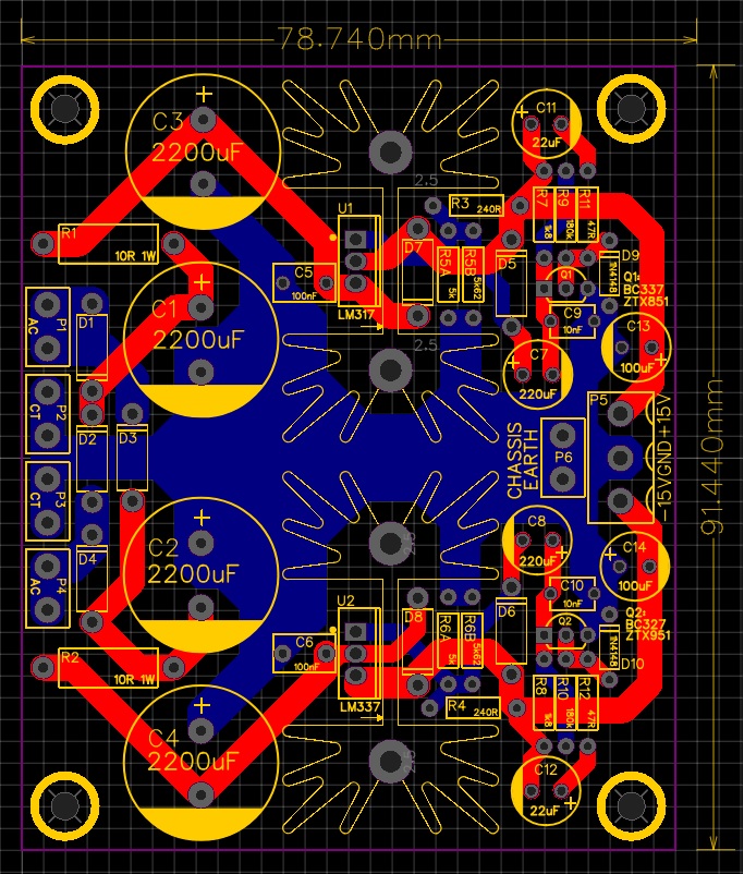

Be aware that R5 & R6 need to be the cream of the cream: generally, trimmers are noisy, unstable, non-linear but it does not matter when they are ~10% of the total resistance.
Here they are 100%.
When possible, connection in potentiometer mode improves matters, but with the 317, it is not possible
Back to fixed resistors it is then.
By my maths the R3/R4 of 240R gives 5.2mA. For +/- 15V with 5.2mA gives R5/R6 of 2.64k.
Req= product over the sum; using a 5k and a 5.62k resistor gives 2636.5ohm, which should be close enough.

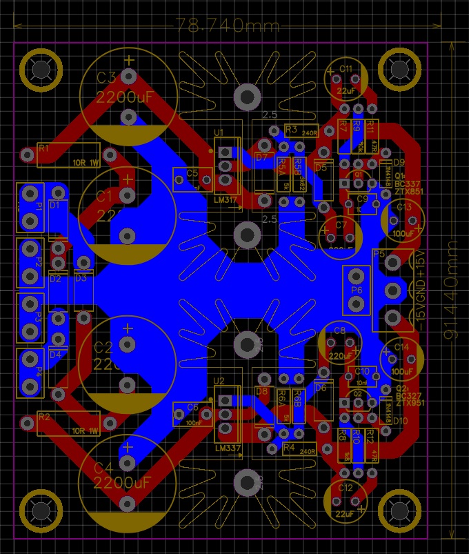

Here is the new layout with the trimpot replaced with dual fixed resistors again.
Does anybody see any layout mistakes or is this likely to work as intended?
