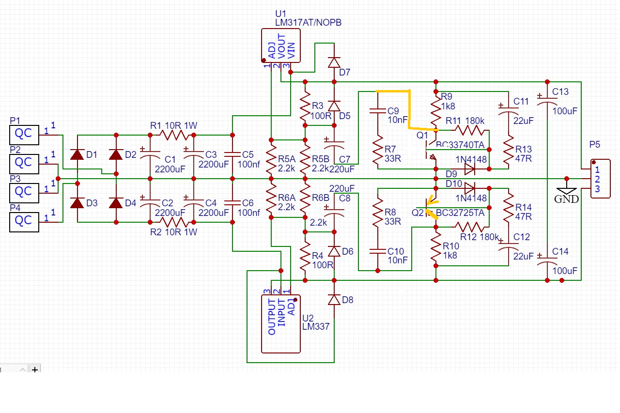

D-Noizator: a magic active noise canceller to retrofit & upgrade any 317-based V.Reg.
Drawing a circuit in such a nonsensical way is asking for trouble.
Despite the simplicity, I managed to spot two errors (there might still be one or two hiding in plain sight)
attachment.php
Edit: yes in fact, C13 and C14 should connect to GND, they are drawn just in series

Thanks for the feedback guys.

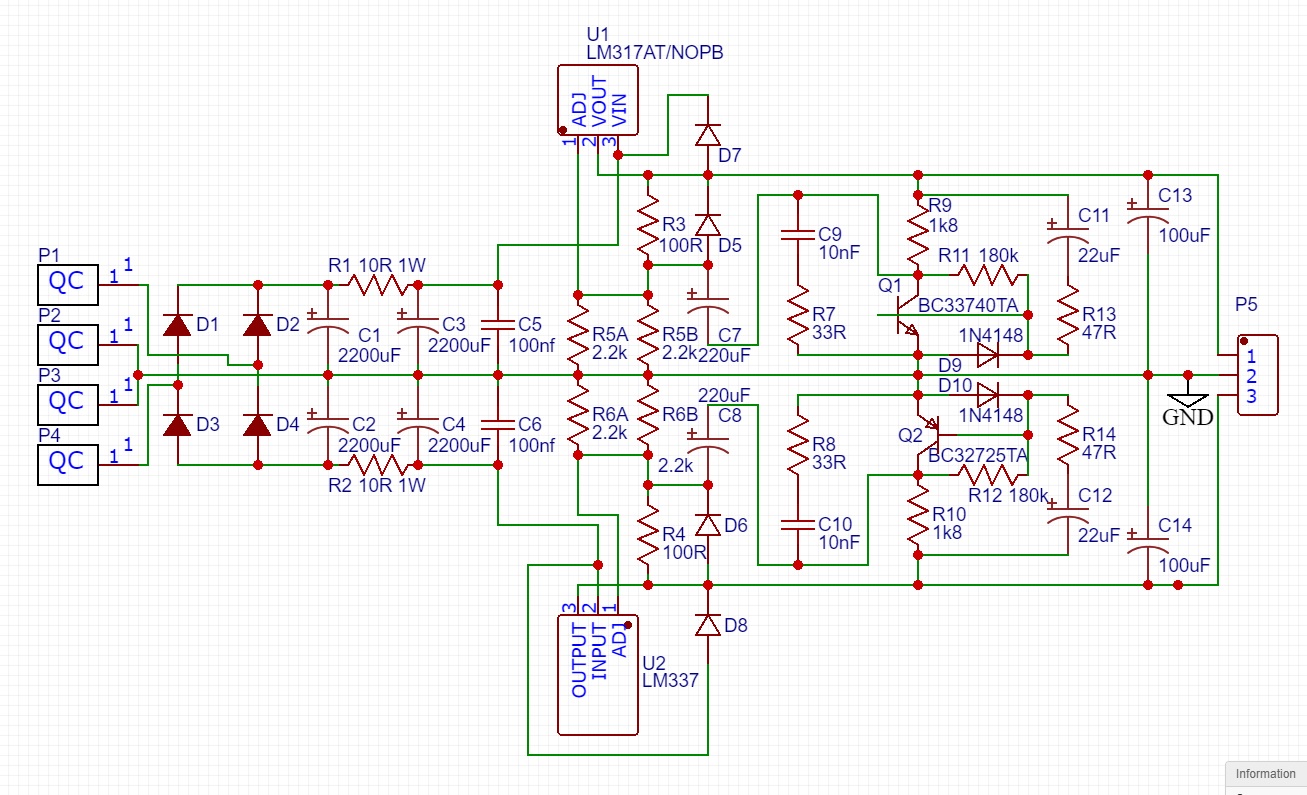

What am I missing? There's no connection to the base of the transistors Q1 & Q2.
The layout is a bit messier than I would like compared to drawing by hand, but that is unfortunately the limitations of the easyEDA software. I can't rotate Q1 to make the connection to the base clearer without having to fiddle around with everything else so I opted to run the link through the middle.
I am little embarrassed at missing link from C9 to Q1 and the missing links to ground on C13 and c14. I'm going to claim it was late and leave it there....
Thanks for spotting that Q2 was around the wrong way also.

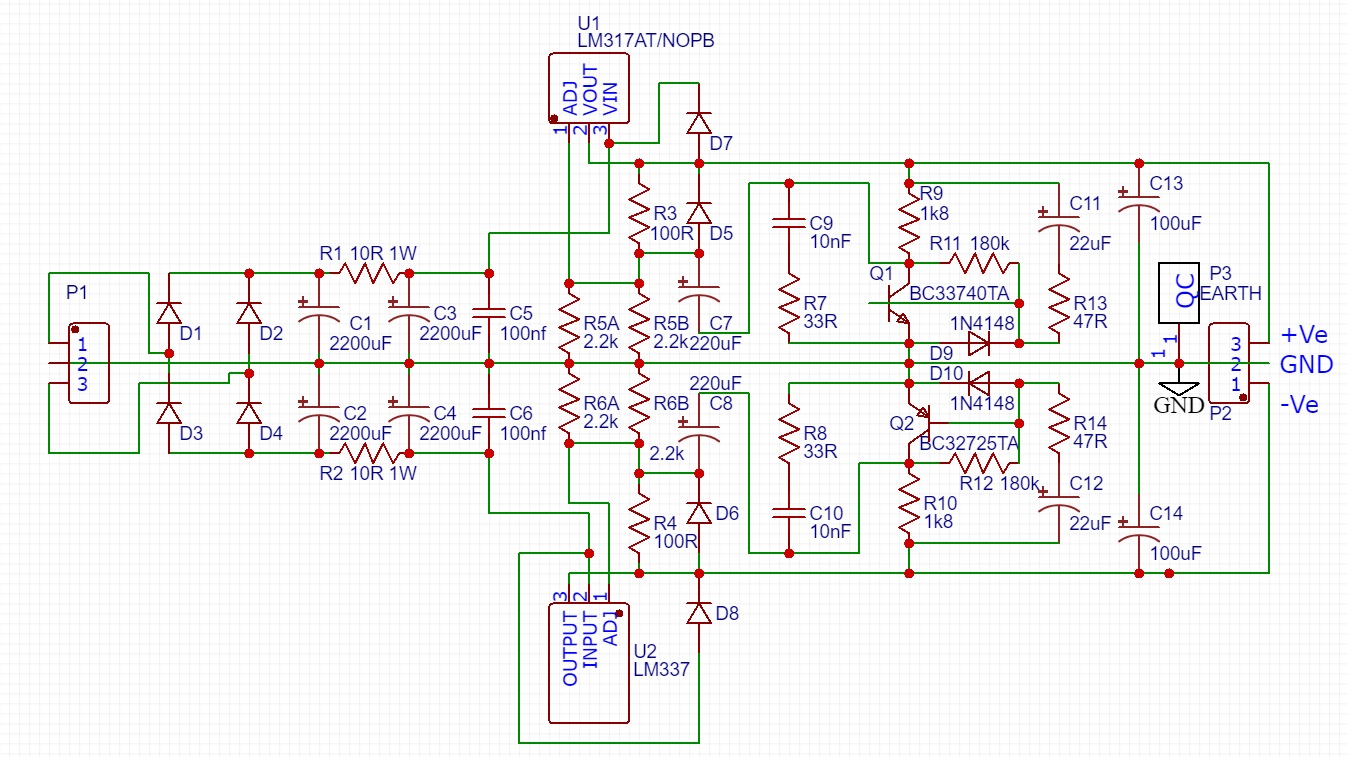

Here is the corrected version.
I do have a question as to whether the CRC filter before the regs is necessary with the denoiser afterwards.
Just in case anybody is wondering, the paralled resistors at R5 and R6 is to facilitate odd resistor values. In this case for 15v out one needs a 1.1k resistor in r5 and r6 which is uncommon compared to parallel 2.2k.
From earlier in the thread I understand r7 and r8 are optional but potentially improve stability so I figured I may as well leave them in there.

D10 's cathode to the ground , anode to the base.

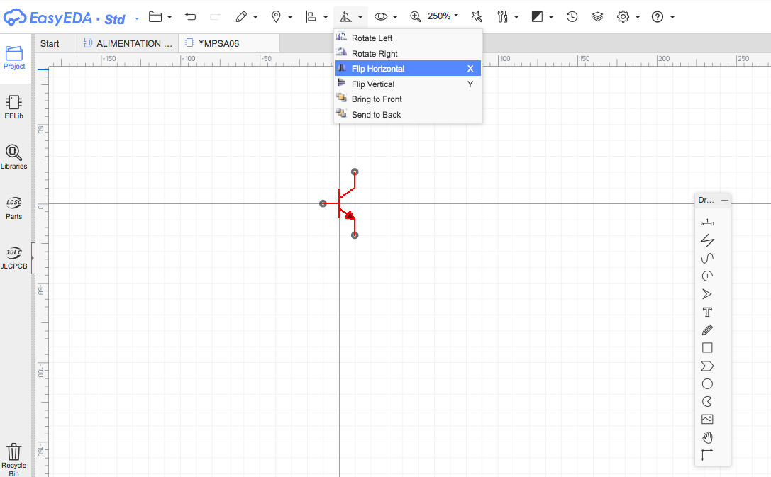

... but that is unfortunately the limitations of the easyEDA software. I can't rotate Q1 to make the connection to the base clearer without having to fiddle around with everything else ...
You may want to have a look at an alternative tool: DipTrace.

I do have a question as to whether the CRC filter before the regs is necessary with the denoiser afterwards.[/FONT]
I would say yes, it is necessary. To decrease the amount of ripple, so that the 317/337 can operate properly. The regs have a minimum dropout that needs to be ensured, for them to operate properly. My gut feeling would be 1,5...2,0 to keep me and the regs happy.
But there is a catch here. If you consider ripple voltage as an AC voltage superimposed on the DC that comes from the rectifier, you will also appreciate that there is a Vmax and Vmin within that input voltage.
With increasing load current, the ripple, or difference between Vmax and Vmin increases, because Vmin gets lower and lower.
If Vmin is sufficiently low, there will be moments during the cycle where the dropout that is necessary for correct operation of 317 / 337 is not maintained, and the 317 / 337 will fall out of regulation. The regs will simply not have enough overhead, or dropout voltage, to 'work on'. Hence, there will be times of the cycle during which they will not do their work properly.
That is the reason that you need some preliminary, and sufficient for the job, pre-filtering, just to keep the ripple within reasonable values.
There is even a formula that will allow you to assess the amount of ripple (Vmax-Vmin) that results from pulling a given load current from a filter capacitor of a given capacity uF. You need to dig it up and to the maths. Based on that, on the Vout, and the anticipated load current, you will have a gut feeling as to the magnitude of the ripple that is to be anticipated. You can then scale up or down the uF of the filtering capacitors and then assess the AC voltage that you need on your secondary to power up this thing.
D10 needs to be reversed.

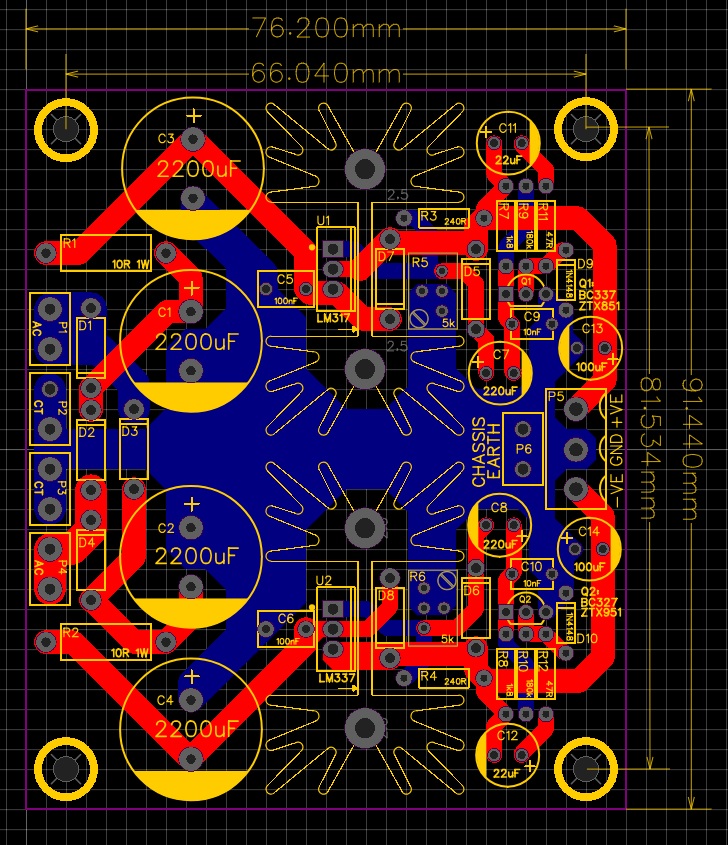

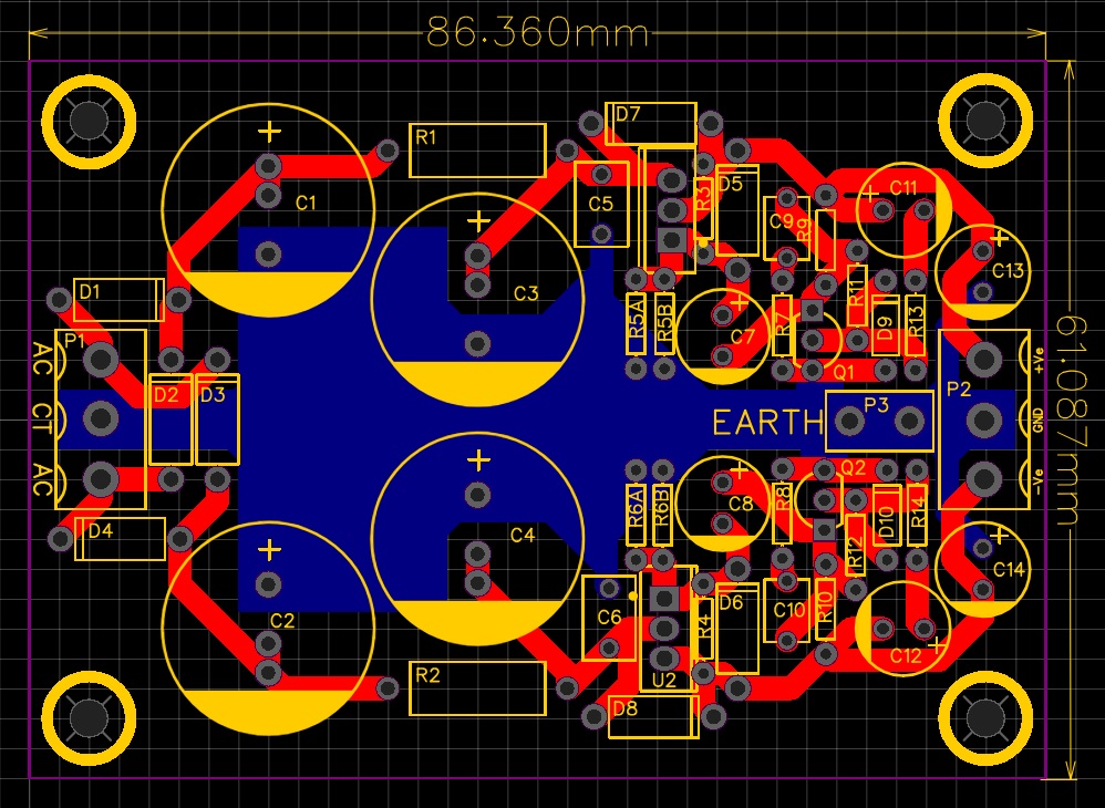

Here's my PCB first draft:
It may be worth considering to rearrange the 317 / 337 positioning on the PCB Layout?
In such a manner, so that their hot backs are aligned with the sides of the PCB board.
This way, depending on application, you have the option of mounting the 317 / 337 to some optional heatsinks, on the sides of the board, and you will not be constrained by the other elements on the PCB that exist in the vicinity of the regulators.
The 317 / 337 could be positioned slightly indented, such that there is still some slack on the sides of the board, to accomodate "on-board" a small heatsink, mounted directly on the PCB, or so that the 317 / 337 could be bent-out towards the rim of the PCB and mounted to a wholly off-board set of heatsinks.
Just an idea.
Considering, that such a circuit could be possibly used with load currents of even up to 1,5A, times a dropout voltage of say 2V, that would result in some serious heat dissipation, 3 Watts. Or even more.
In such a scenario, a heat sink seems to be essential.
YES YOU CAN.....use the flip horizontal
Thank you.

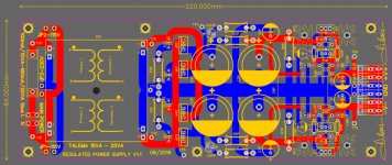

SadFace you should take this drawing without the transformer as an example i posted it in the P88 thread to help you
Upon close inspection, that is quite a tidy layout. I borrowed some ideas.

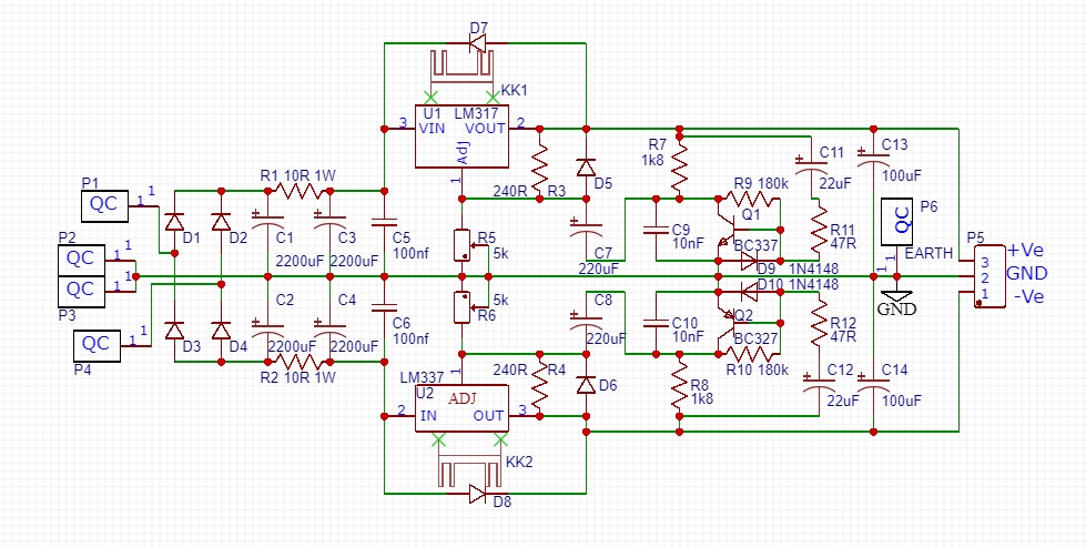

I've removed R7 and R8. I've changed r3 and r4 back to 240R and changed R5 and R6 to a 5k trimpot for simplicity.
Here's the corrected schematic

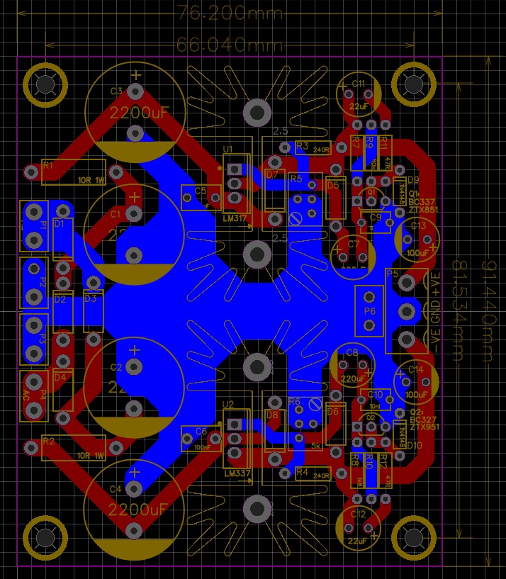

Here's the current PCB draft
Denoised 317-337 pcb v2.0 top side.jpg Denoised 317-337 pcb v2.0 bottom side.jpg
View attachment 790727 View attachment 790728
Be aware that R5 & R6 need to be the cream of the cream: generally, trimmers are noisy, unstable, non-linear but it does not matter when they are ~10% of the total resistance.
Here they are 100%.
When possible, connection in potentiometer mode improves matters, but with the 317, it is not possible
Nice work!!
I usually use a 10,000µF cap as a smoother after the rectifier----does the 2 x 2,200µF + 10Ω resistor perform better than this?
Easy to evaluate:
The 2200µ solution will start with a ripple ~4.5 times the 10,000µ.
At 100Hz the reactance of a 2200µ is 0.7ohm, and will divide the input ripple by ~10/.7=14.
As the initial ripple was 4.5x larger, the final gain with the CRC will be 14/4.5=3.1
So, it's better, but if you use it at 1A, it will generate a lot of heat....
