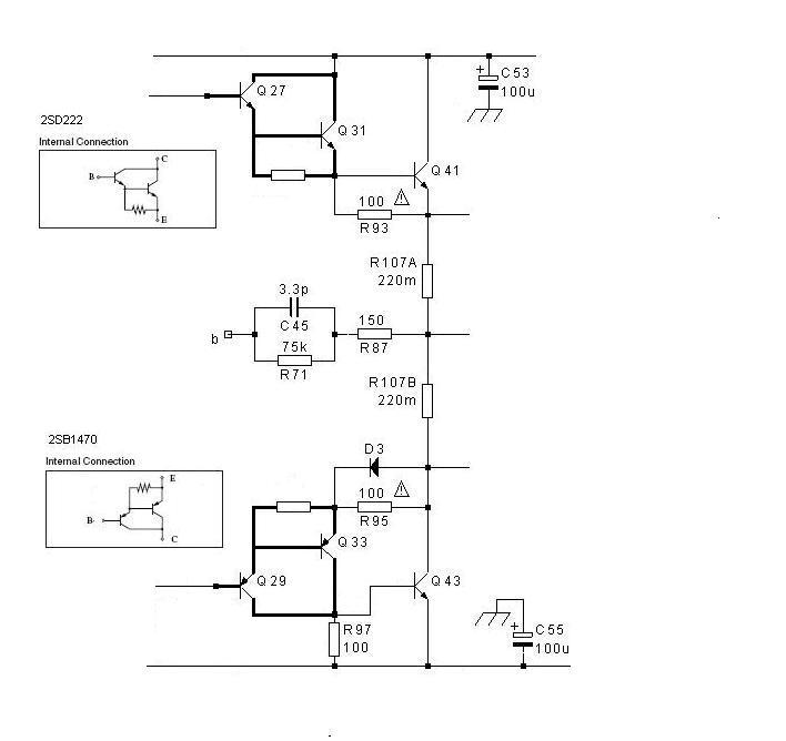

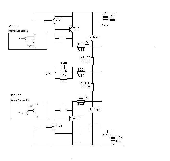

Hi all.
Question, one idea:
Is possibility to replaced the transistors, Q27-Q31 and Q29-33 for Darlington transistors 2SD222 and 2SB1470? Because have similar configuration.
Opinions please.
GEirin

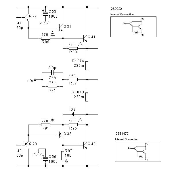

First read the schematic! 😉
There is a note on the schematic that I attached to Post #17 which states that if you run out of adjustment on the preset reduce the value of R83.
I have mentioned previously, either in this thread or another one regarding the Cyrus, that the measured quiescent current of one of my Cyrus 1s was about 75mA. I cannot confirm that this is the correct value as I have not seen any service information for this amp.
The service manual says 22mA
