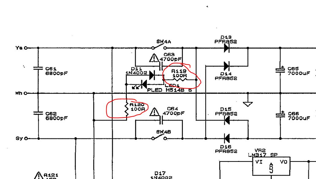

first power up just now. first thing i notice is that R119 and possibly r120 are HOT

Its an odd bit of the circuit for sure, at least the way they have done it...... as it seems to be just a resistive feed for the power on LED. The LED is run off the AC of the secondary winding of the transformer via these series resistors. The diode across the LED protects it from the negative half cycle and that in turn increases the dissipation yet more in the resistors as they conduct on both half cycles.
Yes, all normal and any failures there would only affect the power LED.

thanks ! So I suppose i could just remove them if I find it's keeping me up at night

The circuit shows the power switch acting on the secondary side of the transformer which means the transformer is permanently powered... that's how it looks from what I see.
The LED should only be on when the switch is on but there will be slight current flowing due to the 4700pF cap across the switch.
I won't go into details of how that works other than to say that with a high efficiency LED it could be possible to still see it illuminated when the switch is off.
Another weird (make that WEIRD) observation is that the secondary voltage per winding will be around 21 volts AC (rms) which means one heck of a current flows in that LED per peak of each half cycle. A modern high efficiency LED could be blindingly bright on 1 milliamp or less, this one sees nearer 100ma peak (or more).
That doesn't sound right to me. Just for curiosity, are they really 100 ohm resistors and not 1k ? Mind you, the wattage rating and heat generation fit. WEIRD.
they certainly measure 100 ohms and dropping 10v across

The LED is just plain weird although old (and this amp is old) LED's of that era were hugely inefficient compared to modern ones... not 100ma + inefficient though.

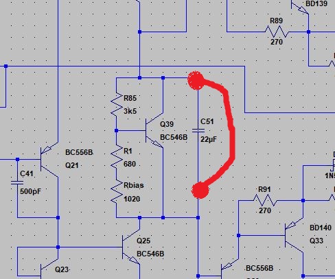

Its getting toward the wrong end of the day for this :) but here is how I would proceed...
If you have a lower wattage bulb such as a 60W then lets use it but nothing to small. If not we stick with the 100W
The bulb tester is our main safety feature, and it will limit the overall power that the transformer can deliver on the secondary side.
Although the bulb shouldn't be bright (which indicates a problem somewhere) we still need to work with this to see what is going on.
If you haven't the correct the fuses for the secondary side then we can link them out as a temporary measure providing we are always using the bulb tester. The original fuses will probably be marked AT or T which denotes time delay or anti-surge. A little over 1A would be around the level of fault current the bulb would allow, the 3.15A wouldn't have blown.
We also need to go to the next level for forcing zero bias which is to apply a short across the bias transistor... this removes the whole preset and the transistor out of the equation. Shorting the cap across the transistor is perhaps an easier option.
Now we test again. If the bulb is still bright then you need to measure the following.
1/ The DC voltage on fuse 1 that has been replaced/linked.
2/ The DC voltage on fuse 2 that has been replaced/linked.
The above measured with respect to ground.
3/ The DC voltage across either of the 0.22 ohm for left channel.
4/ The DC voltage across either of the 0.22 ohm for right channel.
The voltage across the 0.22 ohm will tell us if that is where the fault current is flowing, and if it is, in which channel/s.
If anything is getting unduly hot in the amplifier section then switch off and terminate the test.
