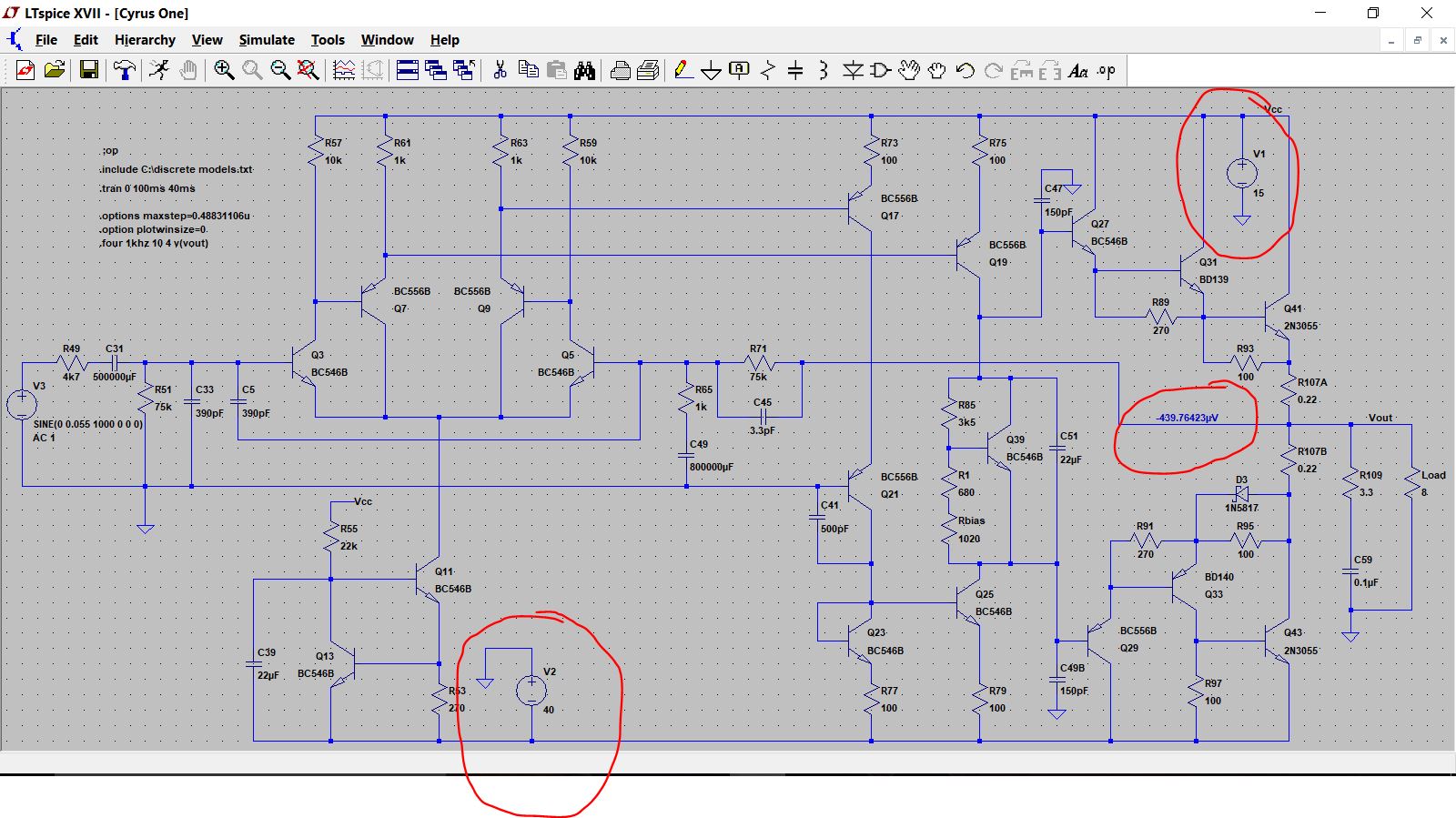

Imbalance in the rails has no effect... strange but true. This is set to +15 and - 40. No offset 🙂
So 5 mv is a great result.
So it is bias next.
So it is bias next.

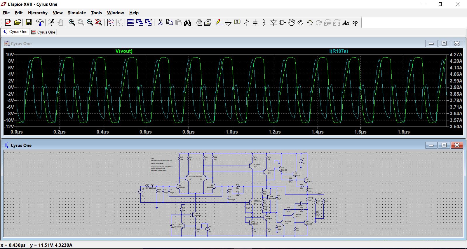

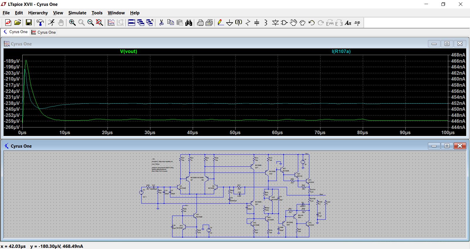

This shows what I think is happening. Look at the scales at the left and the right which show output voltage and current in the 0.22 ohm for normal bias and zero bias. This shows very high frequency oscillation of around 600kHz.
I have deliberately set the amp up to do this, however the basic design seems quite stable... so we have a puzzle.
