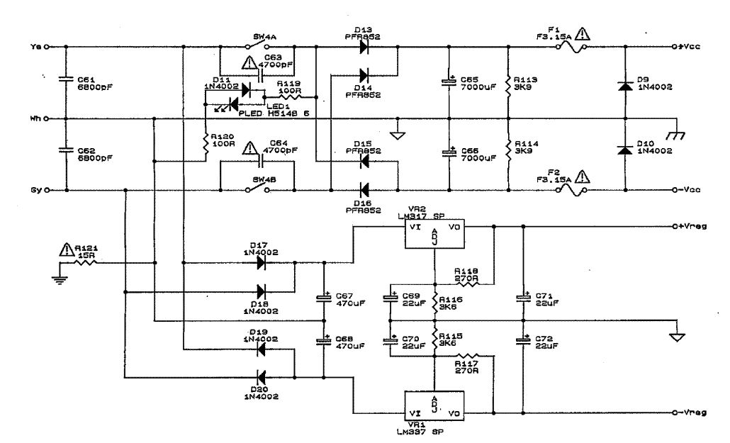

They sound all right, but as I mentioned in post #231, gather the evidence and see what is happening.
As a sanity check, see what the voltage is across R113 and R114. It should be zero volts DC with the power switch off, and 30 volts DC with it on.
The replaced caps are hot, and that's wrong. So check the AC voltage being applied to those diodes as a first step. If that is high then the DC voltage would be high on the caps.
The high voltage on the fuseholders and the caps overheating, although bizarre, don't seem directly related. We need more evidence.
Go off the circuit as they are marked correctly here. If there are board markings then they may be incorrect.

Two things to check.
1/ That R121 is OK. Its the 15 ohm that ties the ground of the circuitry to the chassis. Just check its not burnt up or open circuit.
2/ A quick check that the plus and minus 15v (is it 15 or 18 ?) is OK from the regulators. Don't short anything out 😱

R121 dead as a door nail !
18v on both regs.
guess i just find a suitable R121 replacement or could there be more to it. Did my balls up kill it ?
Hard to say. The resistor just ties the circuitry loosely to the chassis and mains ground to prevent it floating. When you mentioned the high voltage reading I wondered if the resistor could be duff and you were actually measuring from chassis to a 'floating' circuit.
We'll probably never know. Just replace it, and its non critical, anything in that ballpark will be fine such as a 10 ohm or 22 ohm. Didn't you mention hum a while back ? It might help with that if so.
