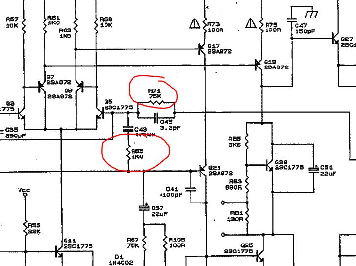

To explain the gain a bit more...
You will have heard the term 'negative feedback' and it is precisely this technique that removes all (to all practical purposes) any variability between component differences, particularly semiconductors.
The actual voltage gain of the amplifier is set by the ratio of these two resistors and is equal to:
(R71/R65) + 1

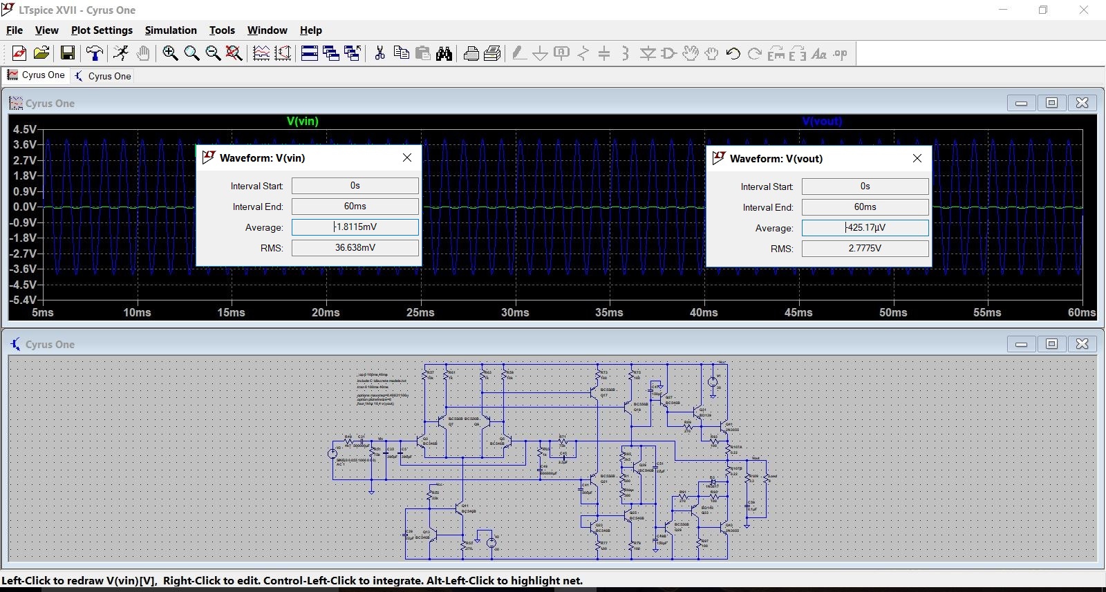

Those values give a calculated gain of 76. Lets now run our simulation and see what we get. You can see we have Vin at 36.638 mv and Vout out 2.7775 volts. Dividing one into the other gives 75.81
(the values we are looking at are the 'RMS' values in those two boxes)
In terms of db difference from measured and theoretical, it is just 0.02db
All audio amplifiers behave like this and the gain can be calculated from recognising these feedback components.
(R71/R65) + 1

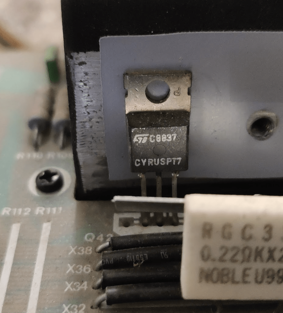

Hi everybody, I have been studying this topic in order to learn how to fix my Cyrus One...
If I am right there is only one of the original output transistor blown (the other three measure identical)
I am hoping to get away with just replacing the one transistor so I am hoping one of you guys saved one from your repairs and is willing to send it to me in Holland...
