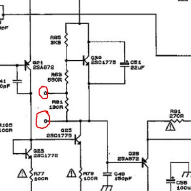

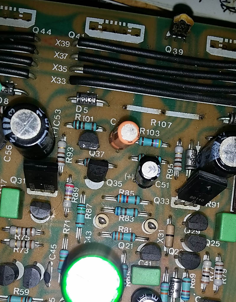

R81 bias setting resistor, what are the adjacent posts ?
adjacent to R81 are two looped wires with ceramics round them.
Is this anything to do with the bias ?
Just an aside, I just thought they look handy and no idea what they do, no component # on the board that I can see ?
I'm just about to pull R81 and attempt to squeeze in the 2k5 bourns pot.

Those loops appear to connect to R81 and in fact are marked in an obscure way on the circuit diagram. The only function they serve is to allow another resistor to be added in parallel which would increase the final bias current. This is the problem with fixed settings... they are so dependent on the actual characteristics of the semiconductors used and so each amplifier will be slightly different. Swap the semiconductors and they will be a lot different.
You can snip that resistor out (R81) and then having first set the preset to maximum resistance tag it across the pins. That leaves the 680 ohm in circuit.

is there anything to stop me just leaving the preset in place once the bias is adjusted ? ir do i need to fit a new R81 in the form of a normal resistor?Yes. I've just added to the post above (refresh the page )
excellent thats also good news. what can possibly go wrong ...Leave the preset in place everytime. It would be very difficult to make up (for example) a 763 ohm or whatever value the preset is finally tweaked to.
Fixed bias amps are in a minority, and the only reason has to be to save on a manual adjustment on the production line.

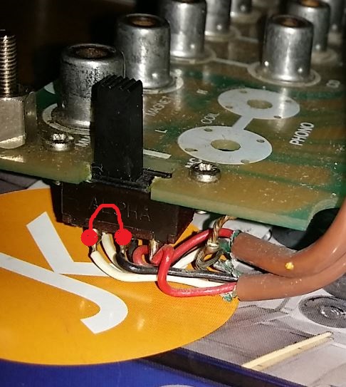

btw I can't help noticing the phono signal runs through wires to a crappy looking switch! ? could i bypass that somehow ? it'll be MM for the forseeable futureand remember to keep using the Mains Bulb Tester to power ON every time you make any modification.

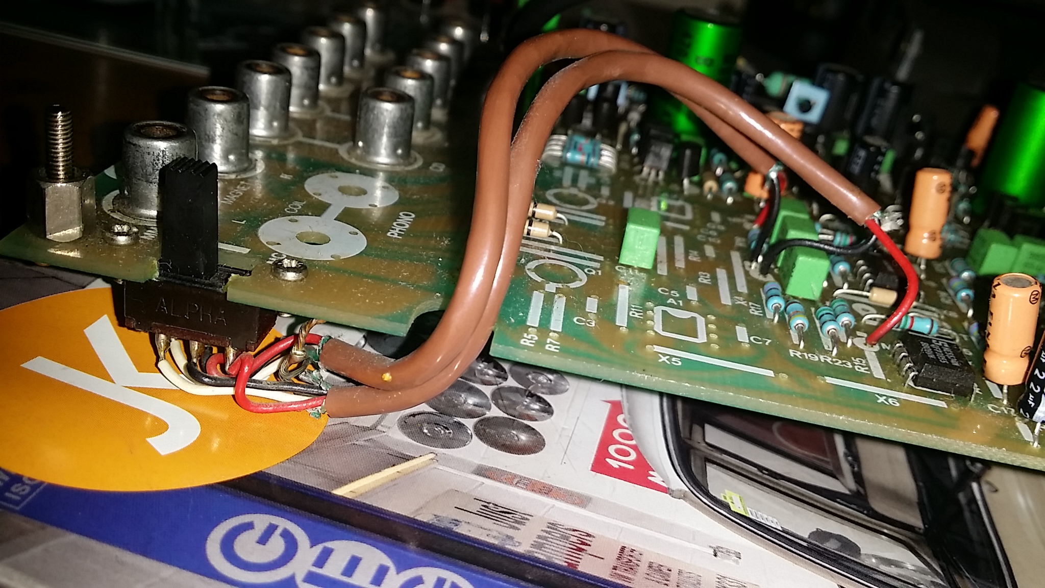

Can you post a pic showing the detail?btw I can't help noticing the phono signal runs through wires to a crappy looking switch! ? could i bypass that somehow ? it'll be MM for the forseeable future

That is a bit of an average looking switch. To bypass it you simply short the middle pin to whichever end pin the switch is turned toward. Do that for both sides of the switch.
