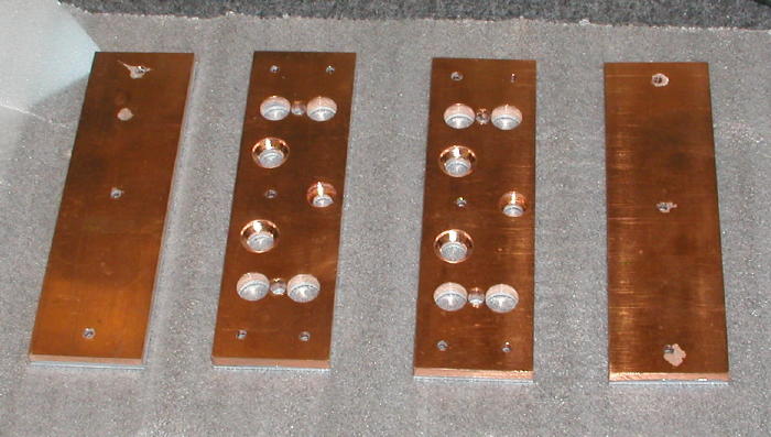

In difference to some people here, I don't write about what I think, or what I imagine. I write about what I actually do.
So, I just went to measure 4 plates I recently cut for Patek amp. Each one measured between 1,758 and 1,762, so it's actually better than was suggested previously. If I really made the efort, it could be +/- 0.001" And I did them on a trusted, old Ryobe.

Peter, we know what you are showing.
But, if you show a picture of you working in your live 200 amp panel at home and state that you do it this way all the time without stating how dangerous it can be will get someone seriously hurt if not killed.
All we are saying is it is an unsafe way of using a tablesaw and shold be stated as such.

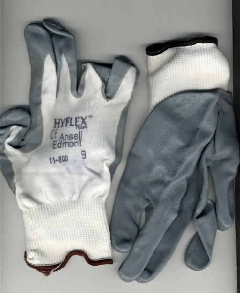

I typically run mills, lathes, grinders, and most types of saws. The one I am MOST cautious about is the table saw. Not scientific but I have been hit by a kickback. It's just me.
As for gloves, my PET PEEVE... This is a popular theme on the home improvement shows. Gloves are a great way to turn a potential nick into an amputation when operating rotating machinery. Sucked into the tool as it were. It's ridiculously stupid. If you are afraid of getting a cut, go sell lingerie.
You are 100% correct. Gloves are bad news.
-Ken
I once worked in a metal shop where we had a huge accident rate because of gloves snagging in the tablesaws. When the boss under WCB pressure made us remove gloves, there were injuries from mini flying bits of metal being embedded in out hands.
The solution was gloves with the fingers cut off 🙂
