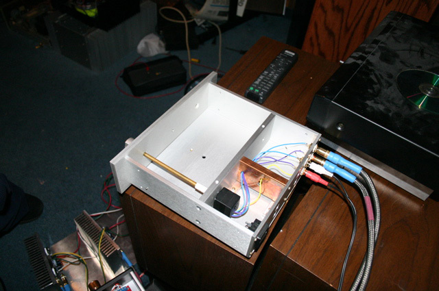

To my question should i clear coat ?
Well, I usually don't recommend claercoating on aluminum. I always prefer the natural aluminum appearance.
Anodizing would be a better choice, but for a single piece may be too expensive ($100 or more).
I usually use alodine in such cases, which can be compared to using sealer on wood. It will protect against corrosion, staining and discoloration, but not against scratches.
Using clearcoat is more or less like anodizing, it just looks less professional, sort of like the rims on the car 😉

I'm also using a sled I made out of baltic birch which helps in the accuracy and safety of the cuts. Plus, you can clamp the piece to the sled if needed. Works great.
