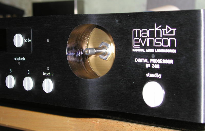

I used hole saw to cut that opening, the edges came out almost perfect: http://www.diyaudio.com/forums/showthread.php?postid=493493#post493493
The hole saw was sourced from Home Depot (Task, IIRC).

Peter Daniel said:I used hole saw to cut that opening, the edges came out almost perfect: http://www.diyaudio.com/forums/showthread.php?postid=493493#post493493

The volume knob was custom made, from 1 3/4 aluminum rod, using grinder and bench press. You can make one yourself as well.
