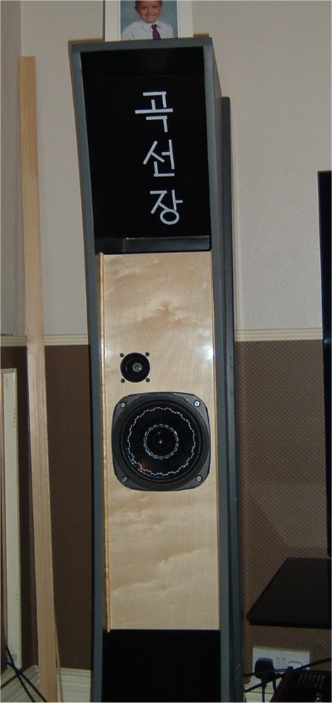

Curvy Chang thread
the right one (from front)

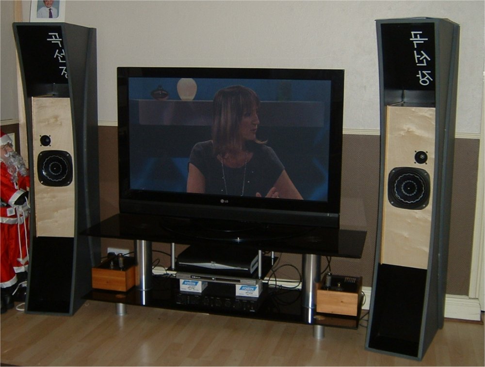

And a another view from the business end (from the focal point).
Unlike other speakers I've had, there is very little sound when you stand between the speakers, untill you are a good 6 or 7 foot away, again I presume due to the beaming of the sound waves.
What comes to mind is an old Marants advert where the guy is sat in a chair, and when the music turns on its like he is sat in a hurricane, or the energy waves that Neo projects in the Matrix slow mo scenes.
They go loud, without you realising, as the clarity stays, it wasn't till out 18 year old lad came down and told me and his Mum off as he couldn't hear the TV upstairs that we realisied how loud we were playing it. Tut! tut!😱

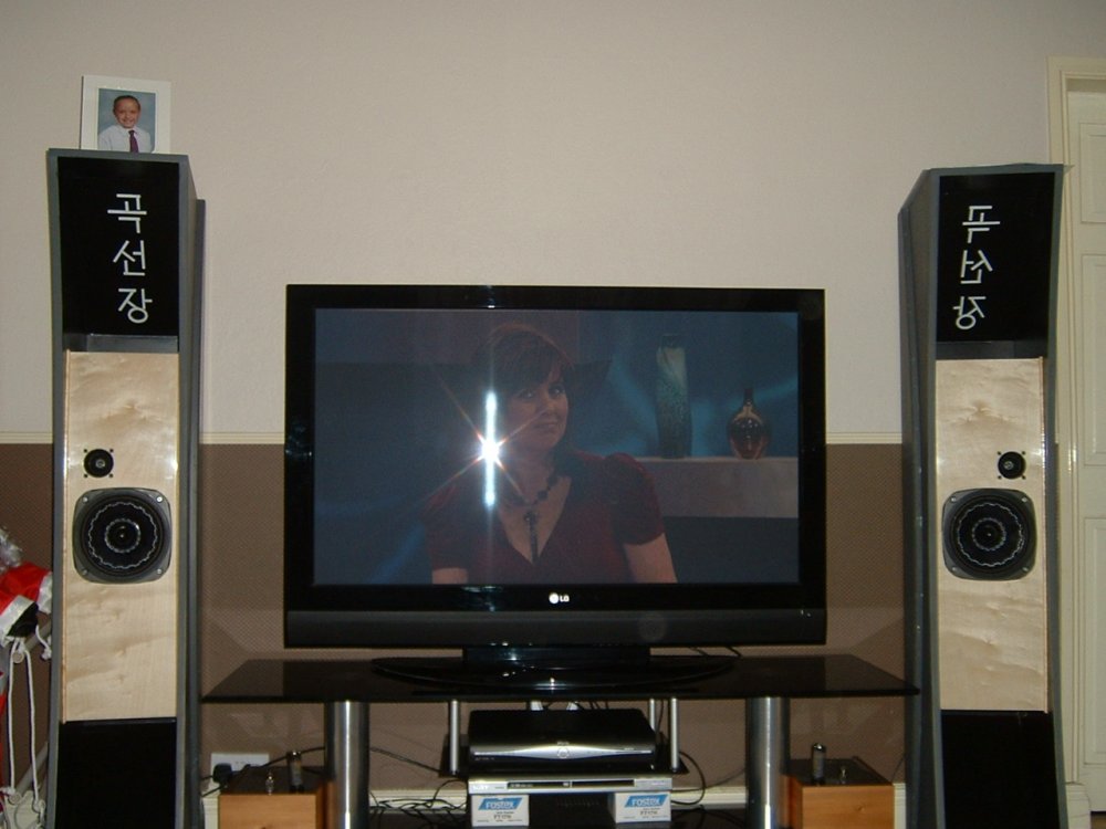

An angled shot showing the curve more.
Edit, when the weather improves I've got a stack of cans to spray the sides, unfortenatly Northern English Seaside towns are only allowed 3 days of sun a year, till then I'm gonna have to live with battleship grey.

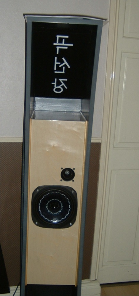

The paint job is on hold till I can spray them, theres just to much area. I'm a bit miffed with my veneer finish as well, its had 9 coats of Plastic Coating, and when I rub it back I get a nice matt, flat finish, then when I buff it up distant images are distorted as the coating seems to have slight waves in it, looks like more coats and more rubbing down, i'll leave that till the weathers a bit better and I do the spraying.
I think the crazy pattern is called EnABL, i belive there may be a smallish thread on it somewhere🙂
Gutted that I havn't yet got a finish anywhere near you 3-ways yet, but I am persistent so hopefully one day.
The waviness might be due to how the veneer was glued. The smallest defect will telegraph through when you go high gloss. It was my original intention to do the same gloss on the veneered parts of mine, but even though this was factory applied veneer, it was still not good enough.
I ended up cutting back the gloss to a smooth satin, that IMO, looks more refined anyway. Also makes a nice contrast.

I think that is the problem, its so irritating as you cant actualy feel the bumbs and close up (ie when I did the buffing) it looks OK. Trouble is they sit opposite the window so in a morning all I can see are wavy reflections Arghhhhh!!!!!:bawling:
So i think I'll follow your advice John and Chris and cut them back to a satin finish.
The finish I have used is a plastic based finish, but can be finished in a variety of ways.
I do concur with your view Chris, the finish looks cheap, I've used french polish in the past a lot and get a much richer finish.
So nest time the drivers are out it a good rub down (iron wool though not iron Michelle🙂
