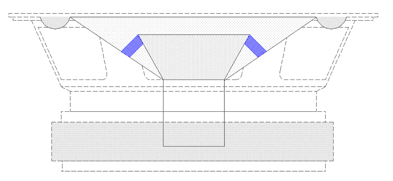

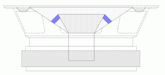

marce said:Edit: Found the picture with the neopreme under the whizzer
Not neoprene... you want low density open cell foam rubber.
dave
Packaging foam from small circuit boards (computer cards and the like), usually light grey and about 1cm thick.
extra soft version of the foam they make cheap mattresses from.
Very low mass, a piece can be easily blown across a table with breath.
I've been looking for pieces large enough to suit the 207's whizzer for a while.
Dave: is that a cut-and-shut segment from a larger ring to get that shape like a slice off a funnel?
what is good glue to do the joint with? most of the good foam I've found is only 10mm thick.
OzMikeH said:Packaging foam from small circuit boards (computer cards and the like), usually light grey and about 1cm thick.
This is what i use -- comes in blue & pink as well. The original used foam from a furnace filter.
It is just an appropriate size srtip and i just friction fit them. 9ie this is a reversible tweek)
dave

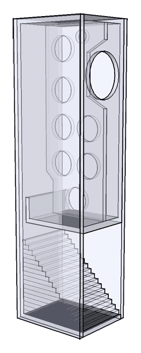

Greetings,
I am planning to have a pair of the Curvy Chang's built. My cabinetmaker who is Almish needs to know what kind of bracing is needed for the cabinet and driver. Can someone provided a drawing for this.
Sincerely,
Cambe😎
Sincerely,
Cambe😎
Poke thru the plans at the planet10-hifi.com box library and at frugal-horn.com. You'll see a number of examples of holey driver braces. Curvy Chang really needs one of those (i believe every speaker needs one of those). Additional bracing on the main chamber sides is also recommended -- you can run strip braces or another holey brace from front to back forming a cross.
Remember: DO NOT put a brace dead centre, even off-centre a little bit makes it more effective.
There are pictures of what Marc did earlier in this thread. Attached is the latest render i have handy that has a driver brace in it (this box needs more bracing than shown too.
dave
dave
