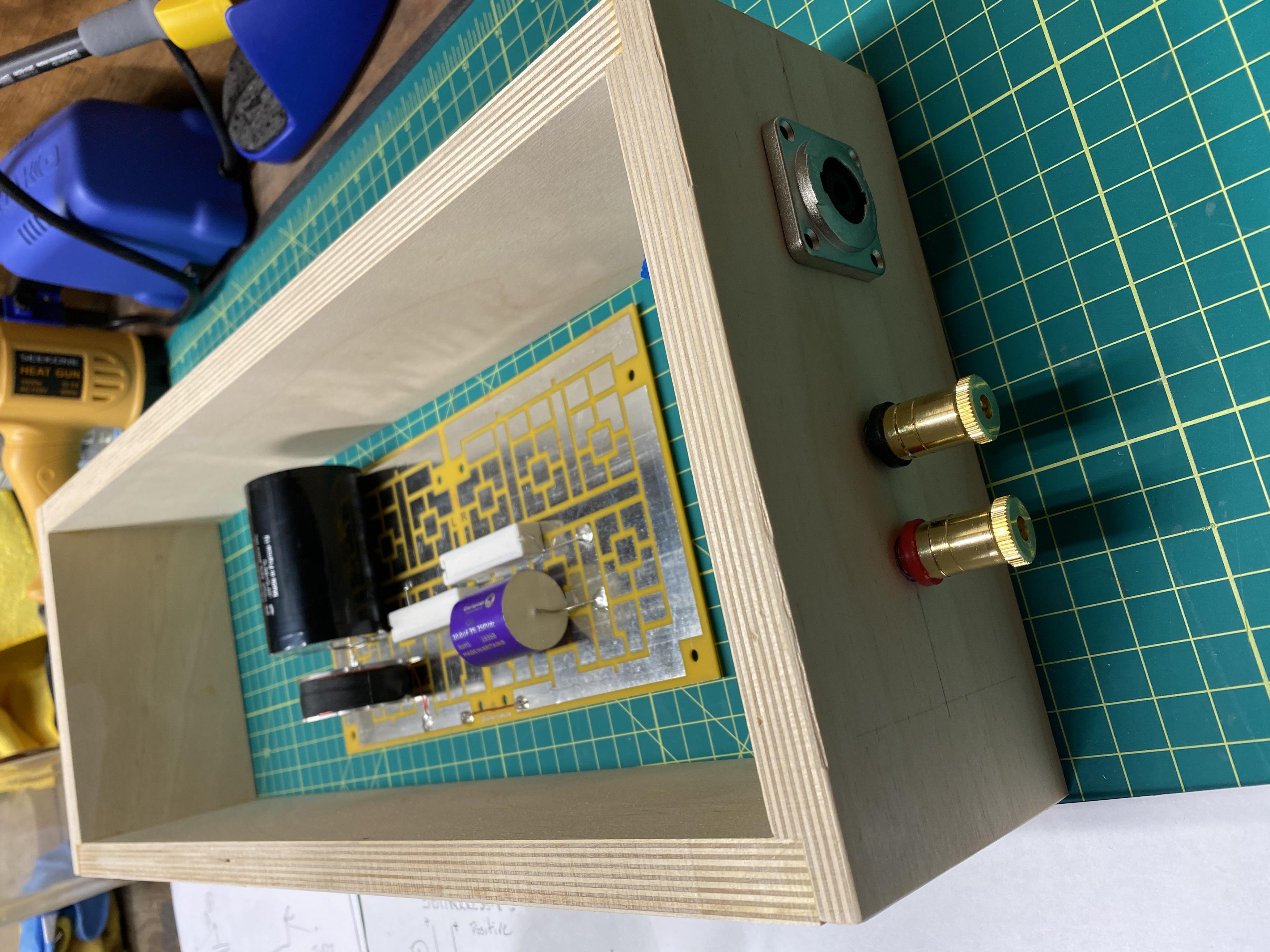

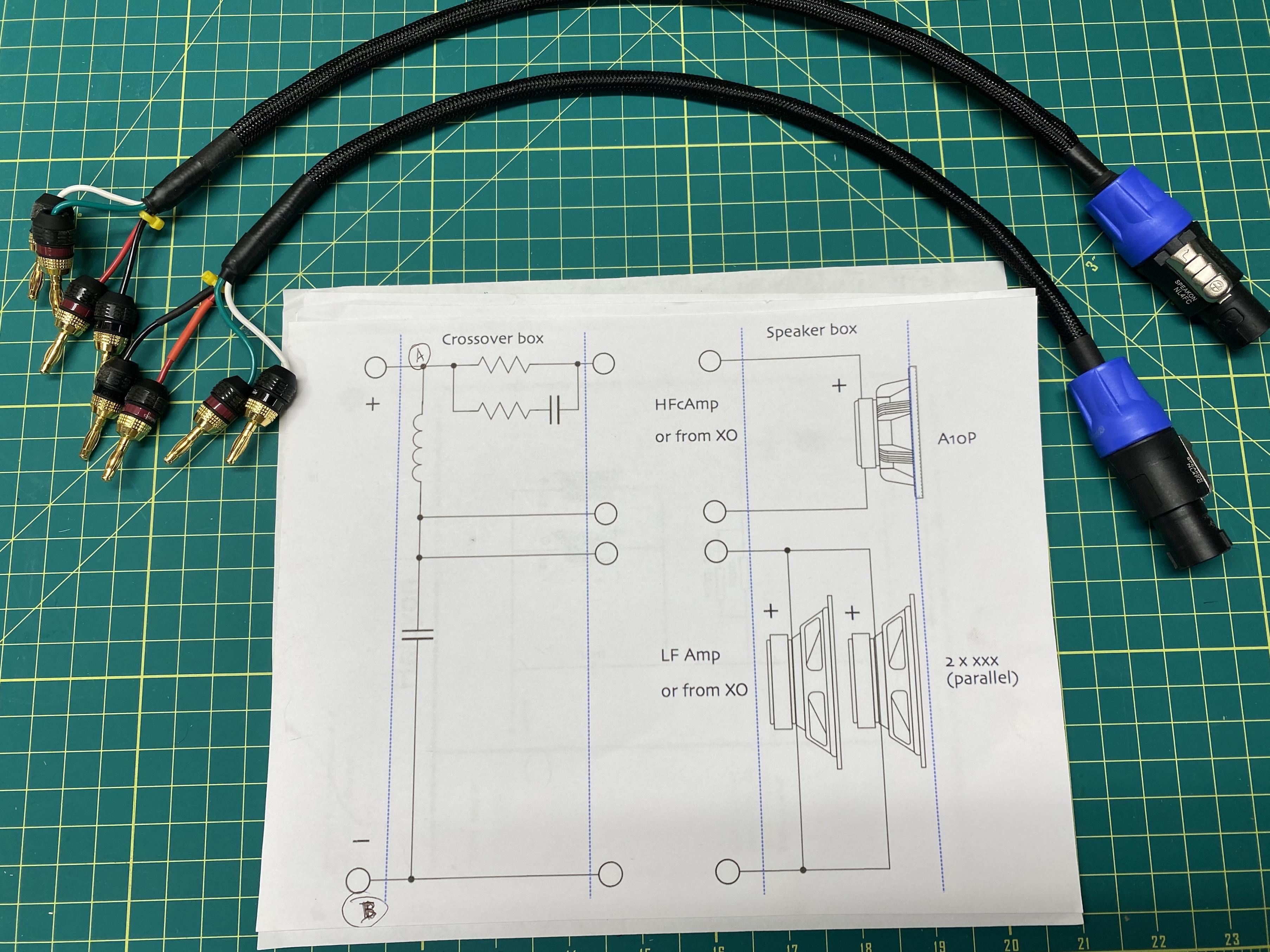

Ok, finally an update on a little progress. As mentioned above, Dave of Planet 10 was nice enough to make a very professional-looking diagram for me, showing how I could bi-amp these speakers, without losing the option to use the cross-over Curt designed, despite the cross-over being serial between woofers and Alpair. The cross-overs were pre-assembled by Madisound, but the diagram was a little rough, so I had quite a time figuring out exactly how to convert Dave's diagram into reality.
The cross-over will be mounted to the bottom of the speaker, hanging upside down, in a 4" riser box under the speakers.

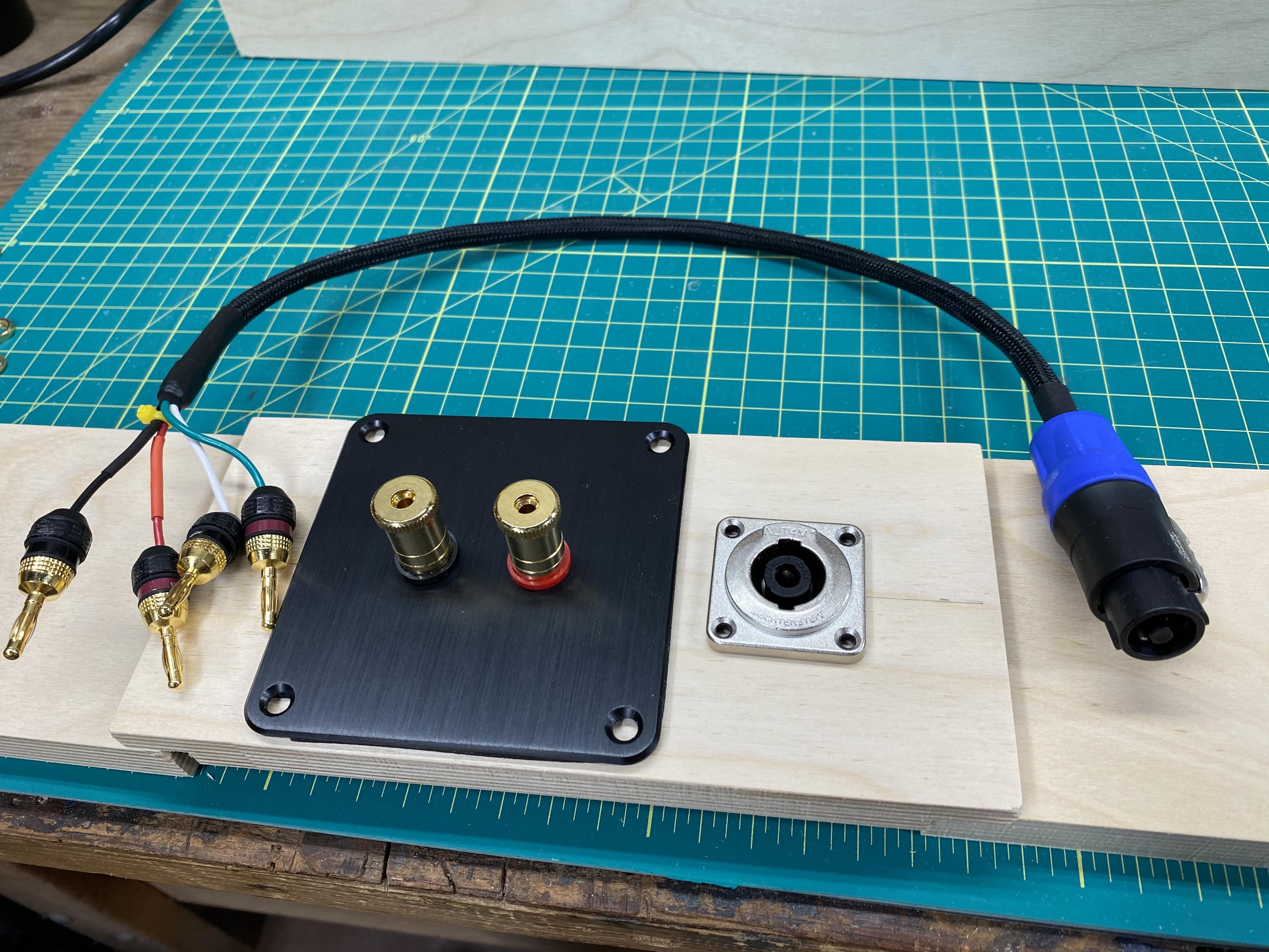

I decided to wire it in such a way that if you put left and right into the upper pair of binding posts, and another set into the lower pair (of a 4-post pocket), hook those pairs up to separate amps, you would have the bi-amp scenario.
In order to use the passive crossover, I decided to create a 4-wire cable, with Speak-on at one end and 4 banana plugs at the other end, to connect the same 4-post pocket to the cross-over box. A separate pair of input jacks in the crossover box would receive input from the stereo amp.

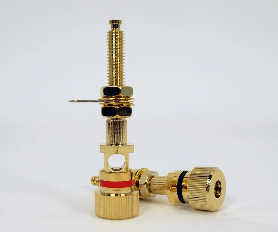

I don’t like that they have so much. All to often cheap ones with plastic nuts outperform them/
If you want, there are (at least should be) connectors like on the NAIMs & Quads (at least old ones) that are flush.
Something like these:
Gold Plated Binding Post Banana Jack Pair
I can’t find the 5-wau posts that
PE has/had that i like, but these, althou aimed more at amps, are OK,
w.parts-express.com/parts-express-dual-binding-post-banana-jack-1-red-1-black--090-475
They can also be found gold plated.
ConneX Connector Dual Binding Posts 5-Way Hex Head
These are better, and we use them often:
ConneX Connector Dual Binding Posts 5-Way Slot
Thes \e what we typically use on speakers:

Wow! $41 per post, $82 for the pair. And they go to great lengths to explain that that is the inexpensive one.
Except for the ConneX, most of those are for sheet metal chassis, it looks like. My problem is that I have to go through 0.5 inches of wood. So I think it's either the ConneX or use something like the McBride terminal cup you suggested. Maybe I'll do that, and just cut out a bigger hole. That would look a lot nicer. Thanks for the suggestions.
That is the only retail outlet i have found those at, choosen to meet our desire to not have anything stick ou tof th box, for the small cutout needed (not important for your XO box) and for the plastic nutted posts.
We bought them a couple 100 at a time from GOldwood. I have some left that i can supply (ON is locked down and i am not sure if McBride is moving anything out, and i am ceasing to do hardware). Postage would be more than a pair. email me if you want to talk.

Gold Binding Posts
I would stay away from those. Too much metal.
I recently posted a good bit on binding posts, i’ll have to se eif i can find it (actually i think it wa sfor Alan in another thread?). Unfortunately PE no longer sells theri best inexpensive good ones. People, i guess, go for this kind of bling.
As well, it is not a good idea to put posts thru the wood, you need to be able to easily remove them.
