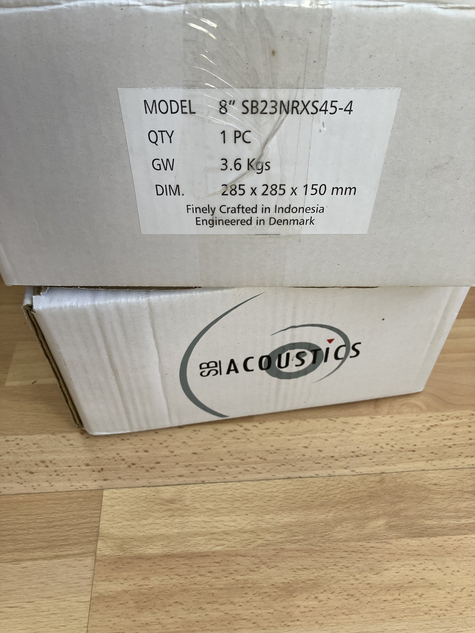

6sX7 Please keep in touch about what you learn. I am also beginning to wonder about the SB Acoustic woofers. The very bottom of the bass response falls off just a bit in my Halcyons and I woudl like to see if that can be corrected.david BTW,
I'm looking at revisiting the design this summer. With the original SB Acoustic woofers out of production and a hankering to get back into speaker building, planning on investing in test gear and starting from concept. Thinking MA CHP-90 for the FR and the Satori MW19P 7.5" for the woofers. Going to play around with various x-over topologies (incl. active) to see if anything really stands out.

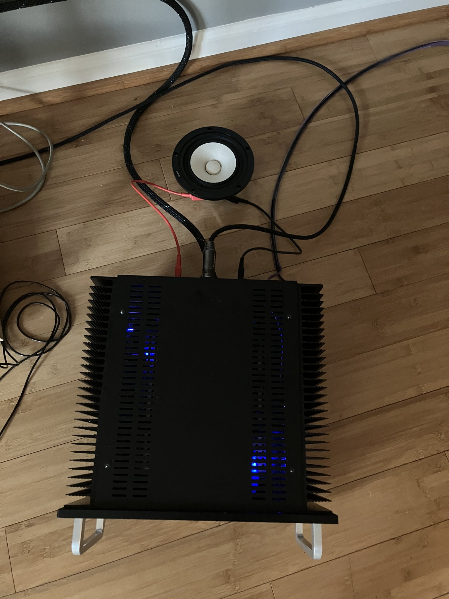

Going to put this here for now. Once I get enough substance to an actual build, will move to a stand-alone thread. Got the CHP-90s in and currently running some low level music thru them. Obviously no bass but the vocals and higher sound good. Nothing really sticks out as offensive. Will let these keep playing at low level for a few days. Then put them aside until I can get some measurement equipment. More to come.

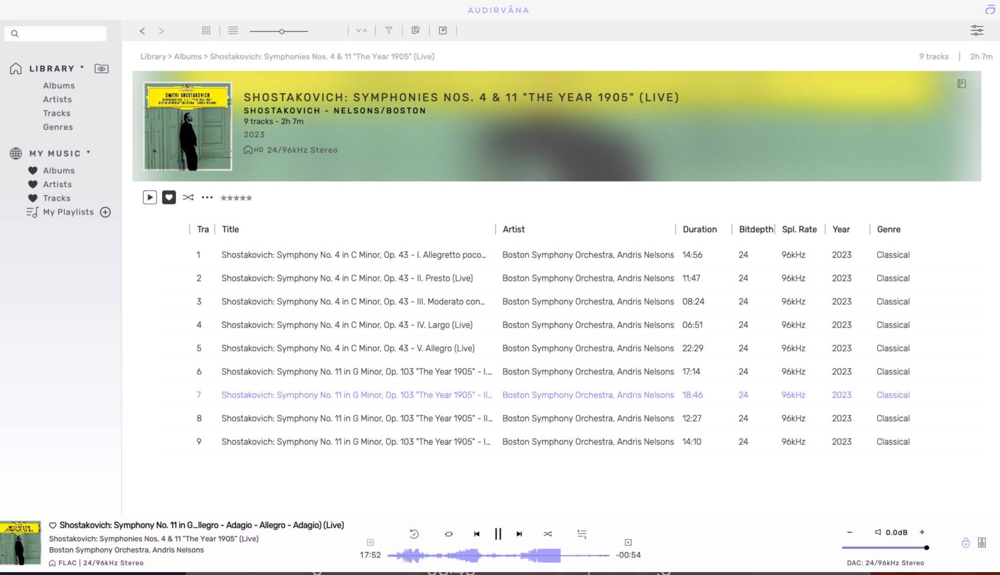

Not much progress on the Halcyon Redux. However, I'm sitting here listening to Shostakovich's 11th performed by the BSO conducted by Andris Nelsons. The Halcyons are very easily keeping up with some very impressive bass drum thwacks in the 2nd movement. This is also one of the first DG recordings I've heard in awhile with pinpoint soundstage. Goosebumps!

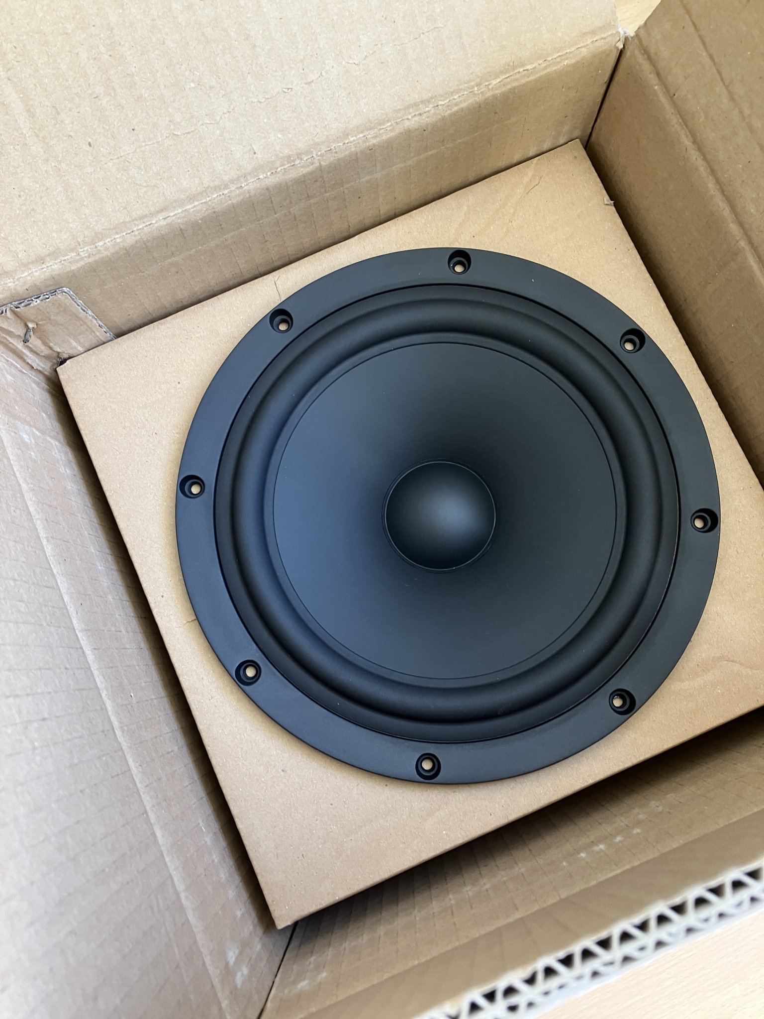

Been awhile and only here to report small progress. Got some woofers to experiment with. Work benches show up Tuesday so I'll finally have a work space to start actually working on stuff.

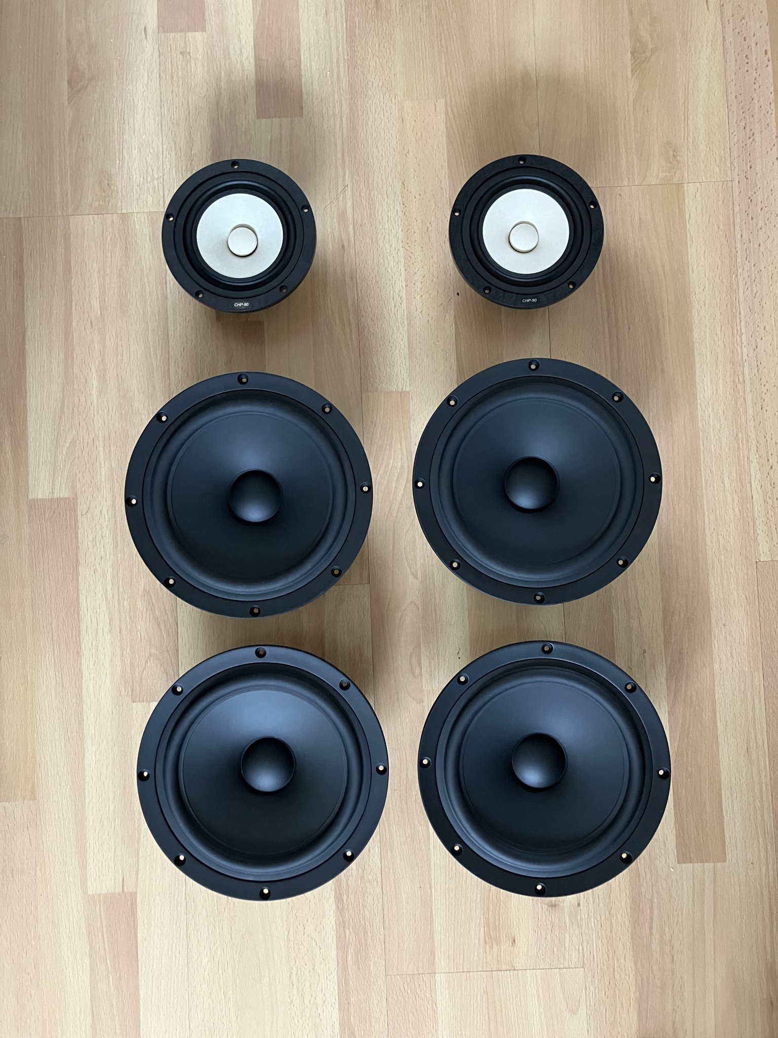

slow progress. Finally have all the drivers in hand. Something feels a bit like overkill. Next step is measurements. A buddy is building a twin pair as he's interested and setup to cut the panels for the boxes. Sent him a Parts Express DATS as he uses Windows so he'll be taking the T/S and impedance measurements. We still haven't worked out the cabinet configuration (ported vs. sealed; front firing vs. side firing woofers). After living with these Halcyons, I'd like a smaller cabinet. I'm looking at these 8" woofers, second guessing current choices.
Next major step is putting together a frequency measurement setup and learning the ins and outs of taking measurements.

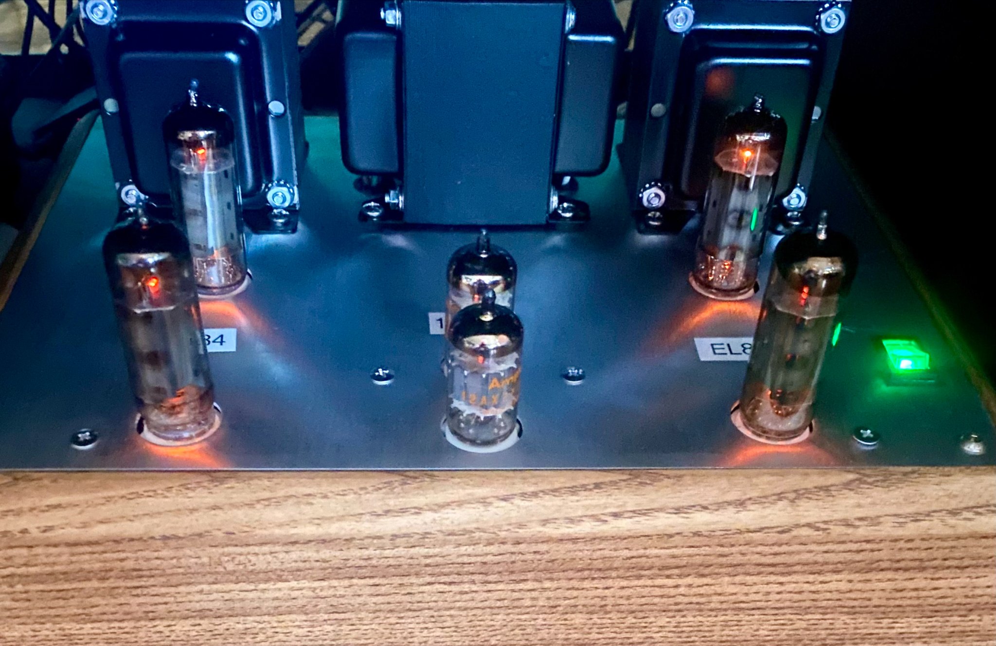

@6sX7 Yes, I got the ST-35 clone working. Mostly. I have some hum that is annoying and I haven’t tracked it down yet. But it sounds pretty good. I haven’t hooked it up to the Halcyons yet as I’m still in the basement with the amp trying to figure out where this hum is coming from.
This is the amp:
https://dynacotubeaudio.forumotion.com/t5016-new-spin-for-st-35-design#48518
The tubes were set a little (lot) hot when I took the photo but I like the look. Now they don’t glow nearly as much.
