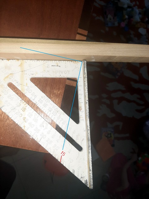

Speaker placement is something I get pretty excited about! Especially with these open-backed designs. 🙂 My experience has been to get them off of the wall as far as you can. The crossovers are designed to take into consideration the back wave bouncing off of the back wall. So Jim and Curt usually suggest a range of how far to place them. Getting them off of the wall further, in my experience, sets the center image further back behind the speakers and helps with the sense of space. I have my speakers set to 15 degrees off axis as that is what Jim suggested for the Bordeaux.
I start with an equilateral triangle between the speakers and my ears. Move my seat forward and backwards until I can hear the imaging working well. However, that is really all a taste thing. Even changing placement from time to time can give you a different experience if you want to change things up.
