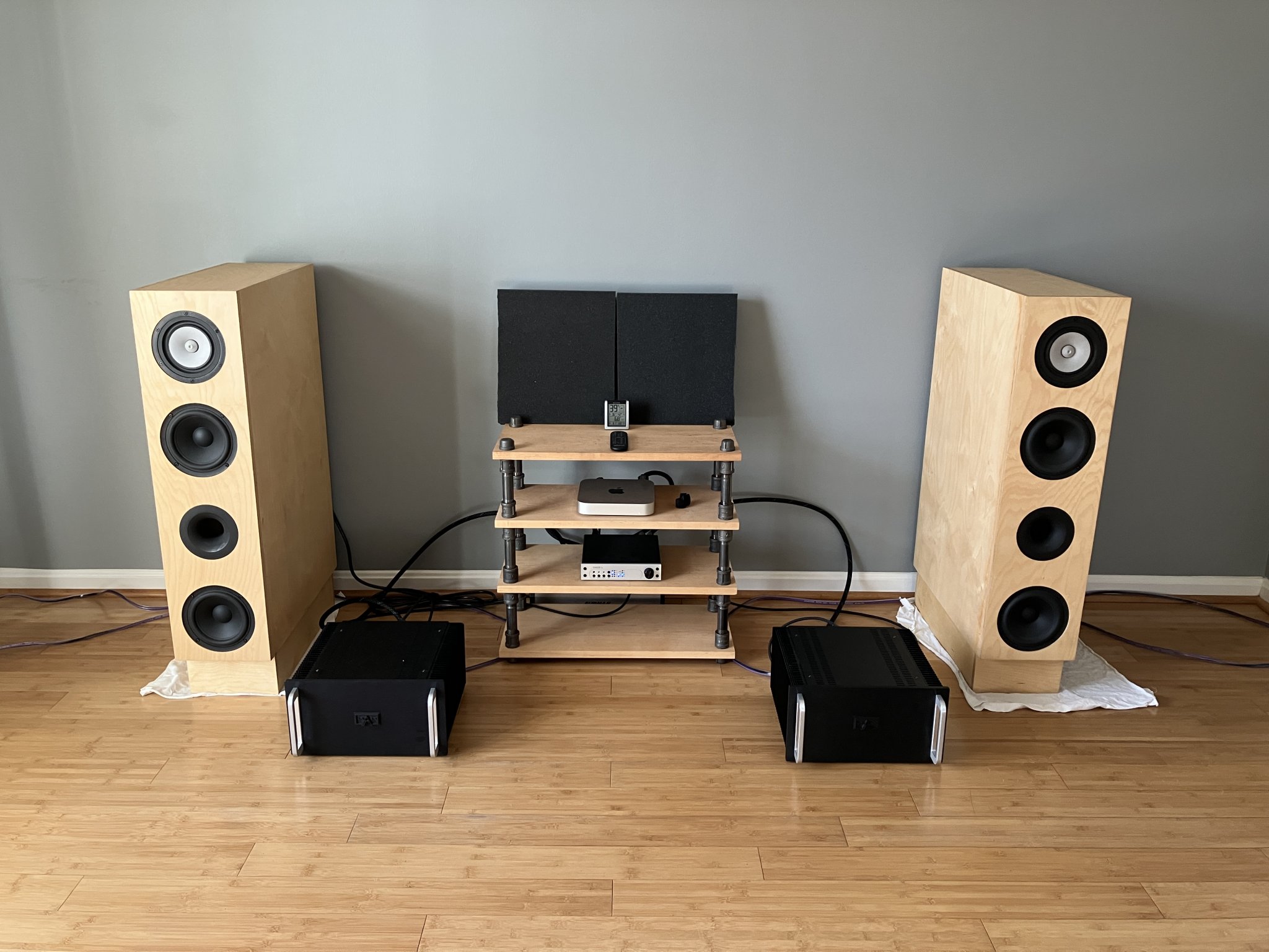

Latest update. Finally got the second F4 monsterblock functioning. Went the route of buying 1% source resistors from Mouser and getting a matched set of MOSFETs off of ThatcherDIYAudio @ Etsy. Cranked the bias voltage up to 300mV and got very good matching current across the triplets, ~2%. Have the monsterblocks in the system and just threw the Gladiator soundtrack at 'em. No sweat. No congestion. Hearing things down in the details that I've never heard before. Next step is to work on speaker placement and room treatments.
Beautiful! Placement, yes, you need to definitely get those speakers off of the wall 🙂
Curt's speakers are generally tuned to be flat at 15 degrees off-axis right?
