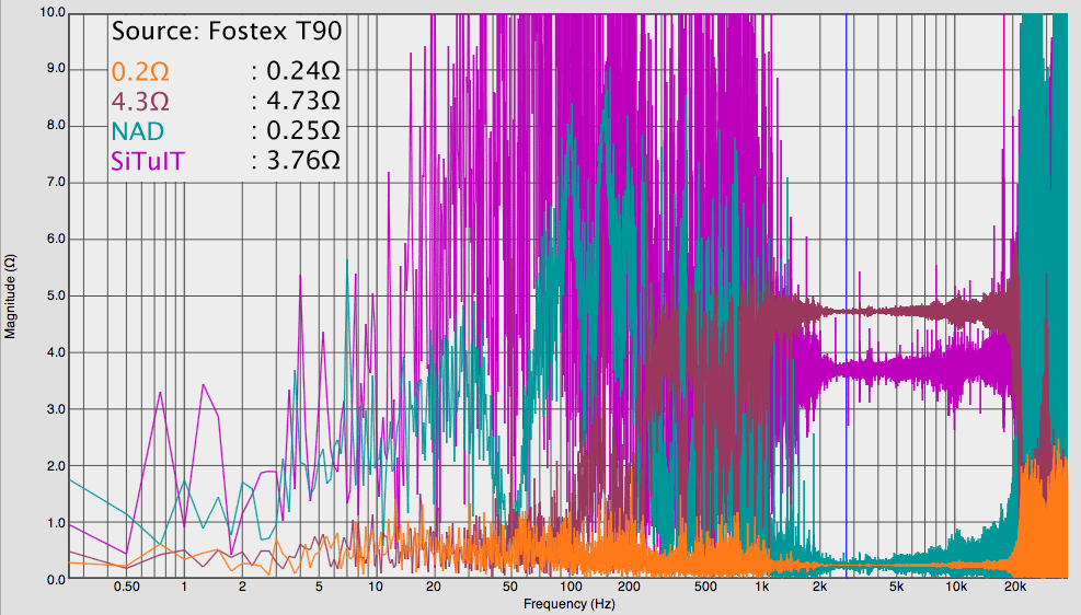

Let' start with the basics, the method itself. I will demonstrate that this method is accurate and that the result are reproducible.

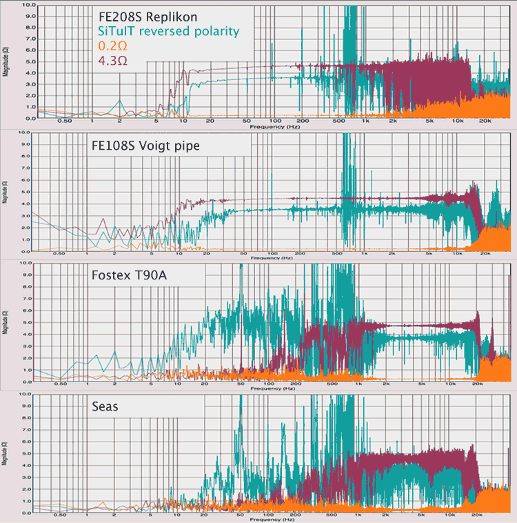

Attached you see the impedance plots for four different loads as a Fostex T90A horntweeter sees them. I selected resistors with values close to the impedance of the amps under test.
I state that these results are accurate and completely in accordance with the existing theoretical framework.
Primary observation: An Amplifier is not a resistor.
Gut feeling: The irregularities in the operating band of the T90 are caused by driver resonances.
In the next post we will hear what a Seas dome tweeter has to say.

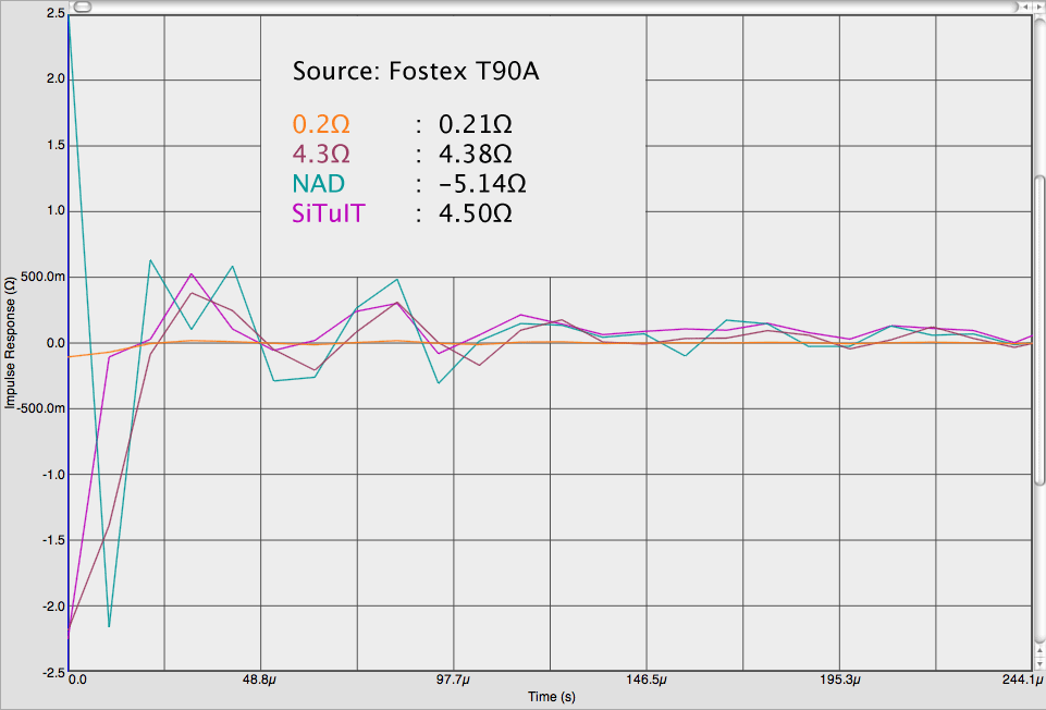

Oops, let me rephrase that:
The impedance plot for the amps is very different from that of their resistive counterparts.
Interpretation:
An amplifier is NOT a resistor.

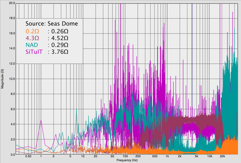

Attached are the results for a Seas Dome tweeter. I don't know the type, it just says Seas on the back. The fact that the obtained values are again in close proximity of what we expect them to be is a testament to the sensitivity of the proposed method.
Let me offer a blunt interpretation:
The NAD sucks in the high frequencies, The Set sucks, period.

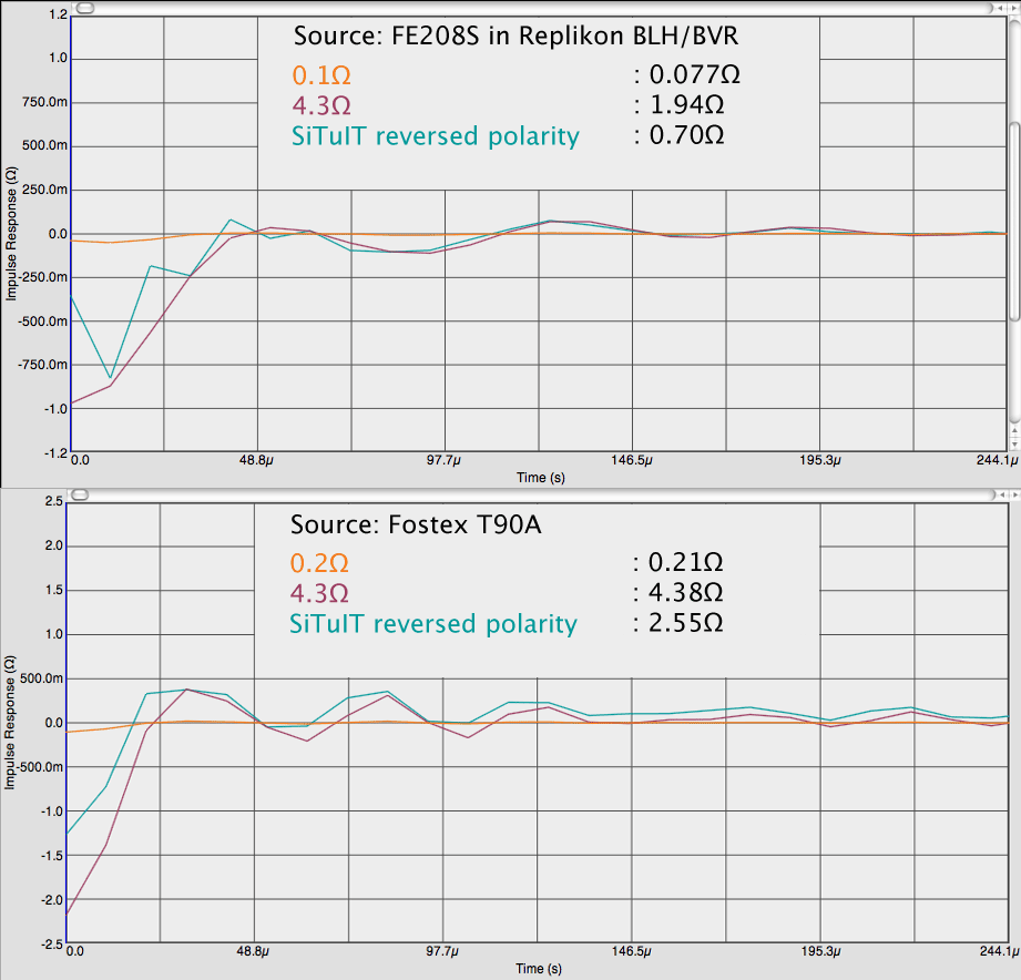

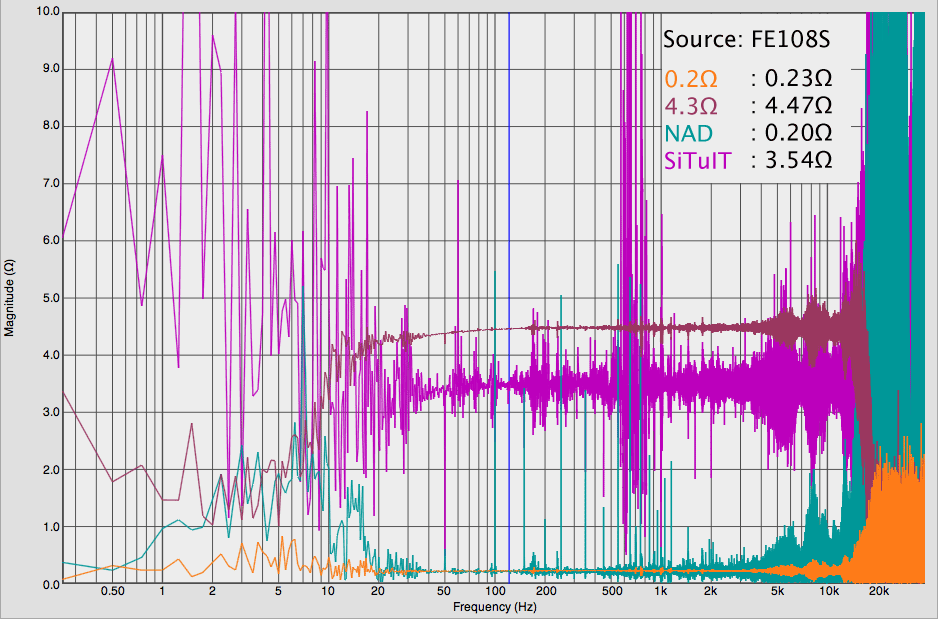

Exhibit #4
This time we listen to what a Fostex FE108S in folded Voigt pipe has to say. For this measurement the loudspeaker was placed at 1m distance from the noise source. Measurements on the tweeters were made while placed on top of this speaker. The hight was about 1m.
I think it is safe to say that there is a pattern here.
Before we turn our attention to the impulse response again I will have to perform some more measurements that will help to establish the validity of the method itself.

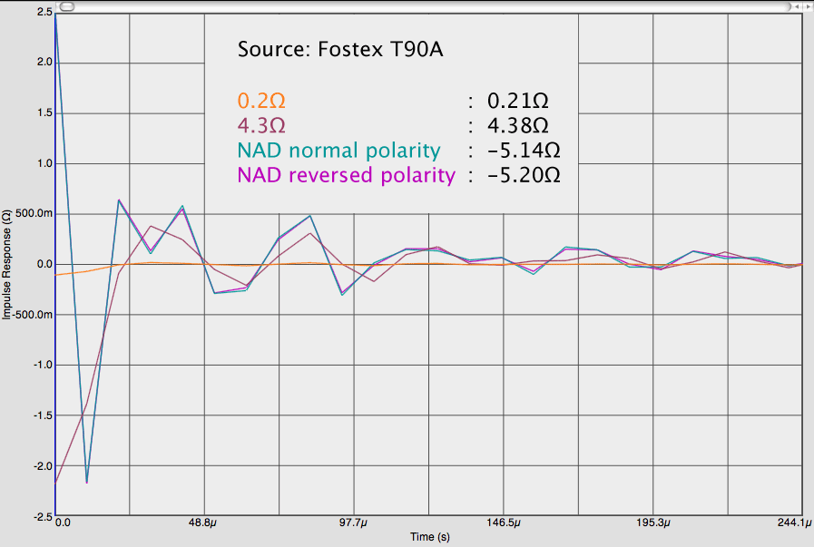

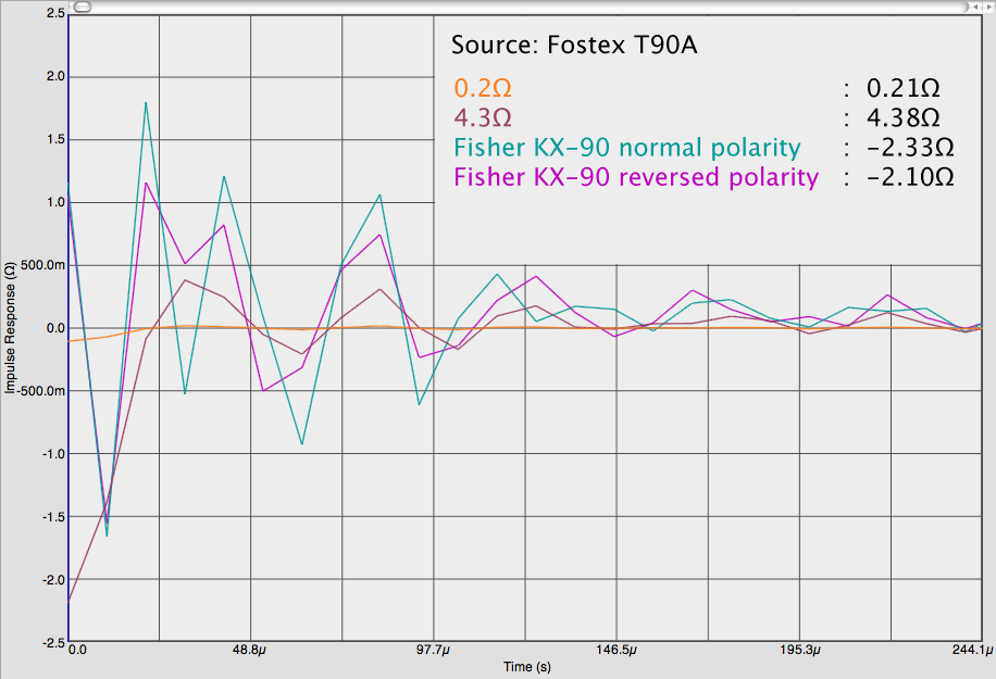

Rube Goldberg method for measuring resistance
First:
I discovered the reason for the negative values in the impulse response. It is because I designed my little impedance box from the amplifier perspective. If the driver is used as the source the current runs in the other direction, so the phase of the current is opposed to that of the voltage in my measurement.
Second:
The method itself has an interesting property: Calibration of the mic pre-amps is not required. Two things determine the accuracy of the G-method:
1. The value of the current sense resistor must be known precisely.
2. The gain of the two channels measuring voltage and current must be matched, or the difference in gain must be known precisely.

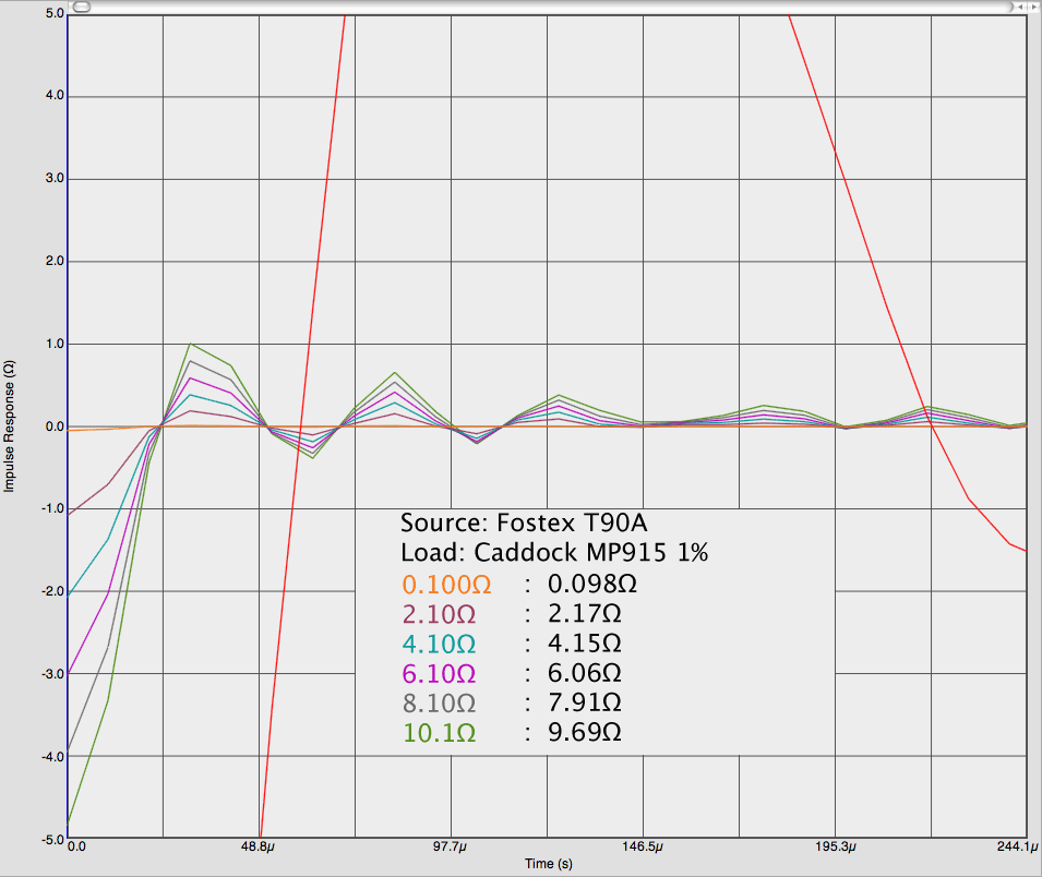

As proof of the validity and, if I may say so, astonishing accuracy of the G-method I offer the data presented in the attachment.
The graph shows the impedance impulse response for six different, purely resistive, loads. I used Caddock MP915 non-inductive 1% resistors as a load. The current sense resistor consists of 5 parallel Caddock 0.50Ω 1% resistors.
I multiplied the value at t=0 by two to calculate the resistance. The obtained results are within 5% of the expected values, if the 10Ω resistor is excluded the values are within 3%.

There will be accusations that I will use this result to explain away the lousy impedance plot of the SET amp. This will not be the case, I don't need to do this, the results will speak for themselves.
I have documented my method, I have shown that I can get reliable results.
And here's the important part: My results are in complete agreement with the existing theoretical framework.
Before you look at the attached result, let me tell you that the best is yet to come.
I would like to ask you to refrain from posting until I have presented the new metric I mentioned earlier.

Let me broadly categorize what people will exclaim when they look at the attachment:
- Oh, dear
- Yes!!
- Fraud!!
- Please make it go away.
The attached result shows what happens if you do the same with a Fisher KX-90 push-pull tube amp.
The NAD and the Fisher have one thing in common. Care to guess what it is?
Ladies and Gentlemen, hang on to your hat because the next posts will show something that is not supposed to happen, cannot happen, is just plain impossible.

The attachment shows the impedance impulse response for the SiTuIT single ended tube amp when the polarity of the driver is reversed. The observed values for the resistors will be addressed later.
The results for two drivers are displayed, I can also show the results for the other two drivers.
Some more of feedback's biggest mistakes
The previous result was interesting. This is the one that blew my mind.
And here it is, the impedance plot of the SiTuIT single ended tube amp for four different drivers.
I had to reduce the size of the image because of file size limitations but I think that the message is clear.
