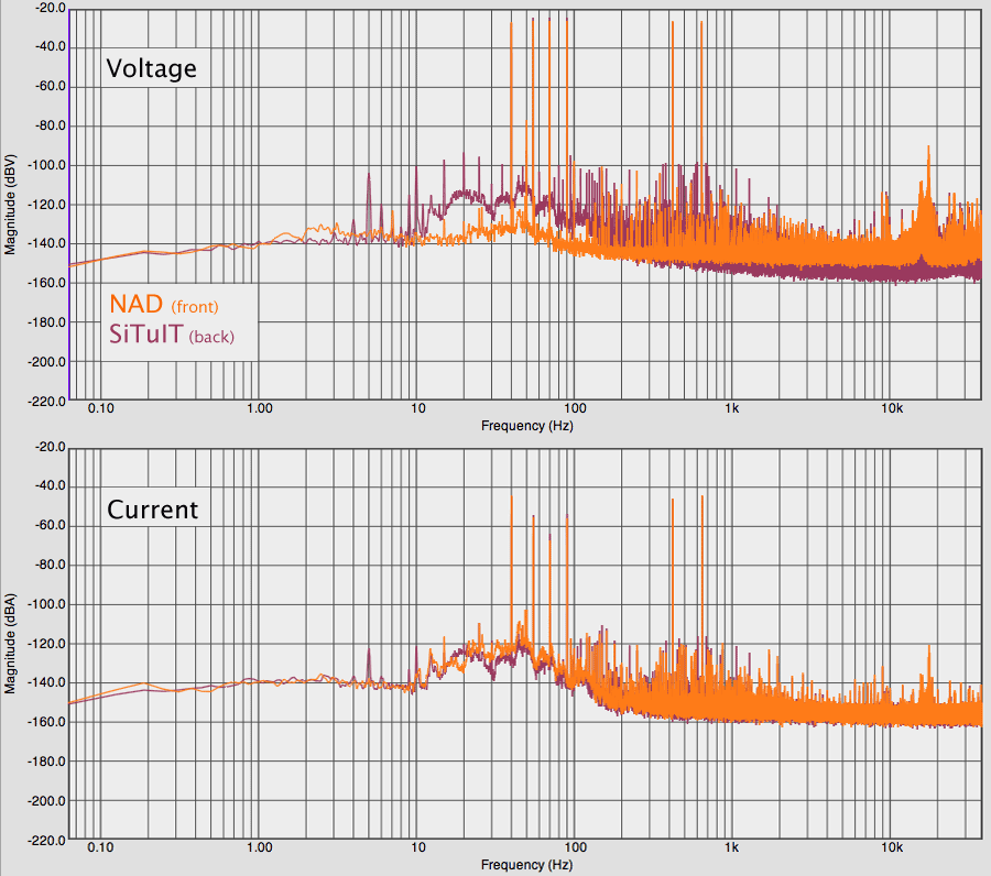

Multi-tone distortion
To see if there is any difference between the voltage and current distortion I constructed a multi-tone signal with the following frequencies: 40Hz, 55Hz, 70Hz, 90Hz, 421Hz and 645Hz. Impedance and phase are all over the place for this set, 645Hz is the only one where the phase angle for both voltage and current is near zero.
Attached is the spectrum for this multi-tone for both amps. The parameters were: FFT size 1536000, SR 96KHz, Rife-Vincent 2 window.
If we look at the voltage spectrum we see that the SET amp performs much worse, there are lots of IM products visible in the spectrum. The environment noise coming from the speaker acting as a microphone is also clearly visible.
The current spectrum shows a completely different picture, the big difference between the amps has disappeared. We would have to look at the details to see which amp has the lowest distortion.
A detailed analysis will take some time but here are some number to get a sense of what kind of distortion levels we're talking about.
Reference 40Hz:
Si V -27.075dBV
NAD V -26.452dBV
Si I -44.943dBA
NAD I -44.372dBA
These are the numbers for the highest peaks in the spectrum relative to the 40Hz reference:
Si V 20.000Hz -66dB (NAD -102dB)
Si I 25.000Hz -64dB (NAD -65dB)
NAD V 17.701KHz -63dB (Si -95dB)
NAD I 48.938Hz -57dB (Si -77dB)
I'm not quite sure what to make of the 48.938Hz peak in case of the NAD, it could be the mains but there is also a peak at 50Hz:
NAD I -58dB
Si I -70dB
Stay tuned, more to follow.

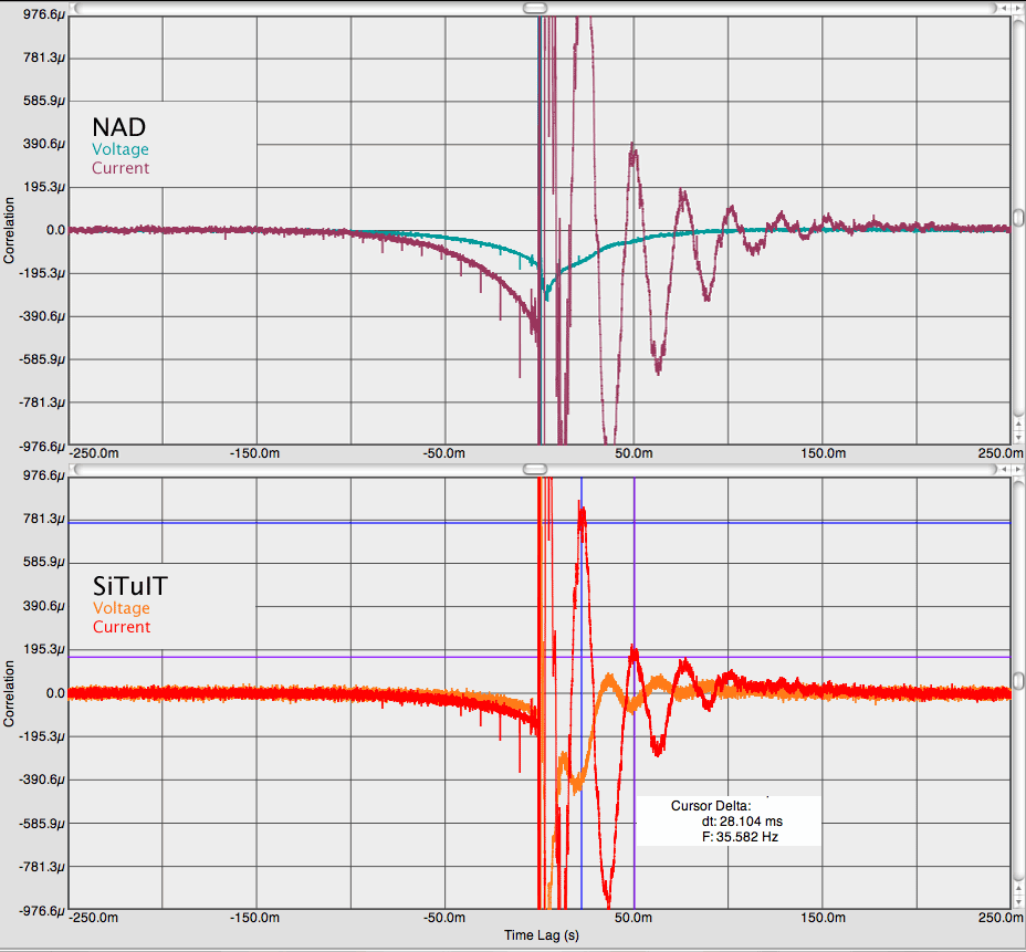

Cross-correlation revisited, feedback schmeedback?
In post #2 the cross-correlation is shown for a very small period of time. The vertical scale is 1, the maximum for the cross-correlation. What if we were to zoom in vertically and look at the 'time distortion'? By this I mean using the same approach as for evaluating harmonic distortion.
The maximum value for the cross-correlation is 1, this makes the interpretation very simple: The 10% distortion point is reached when the plot goes below 0.1, 10m is equivalent to 1% distortion and 1m is equivalent to 0.1% distortion.
The results for both amps are listed below, the value between brackets shows the cross-correlation at that point in time.
10%
NAD 83µs(86m)
SiTuIT 68µs(58m)
1%
NAD 1.375ms(-9.36m)
SiTuIT 1.031ms(-9.94m)
0.1%
NAD 39.719ms(-1.000m)
SiTuIT 36.896ms(-0.989m)
The attachment shows the plot for voltage and current for both amps. The vertical scale is just under 1m (0.1%), the horizontal scale covers 500ms !
As for the 35Hz resonance, all I can think of is that it is half of the main system resonance (70Hz).
The following experiments are indicated:
1. Stuff the Replikon with pilllows to see if this changes the response
2. Repeat the measurement for the NAD with the suggestions Graham made earlier.

The 35Hz resonant decay must be the result of the driver/enclosure combination.
Stuffing the Replikon with a pillow lowers the frequency of the resonant decay to 30Hz and reduces the amplitude significantly.

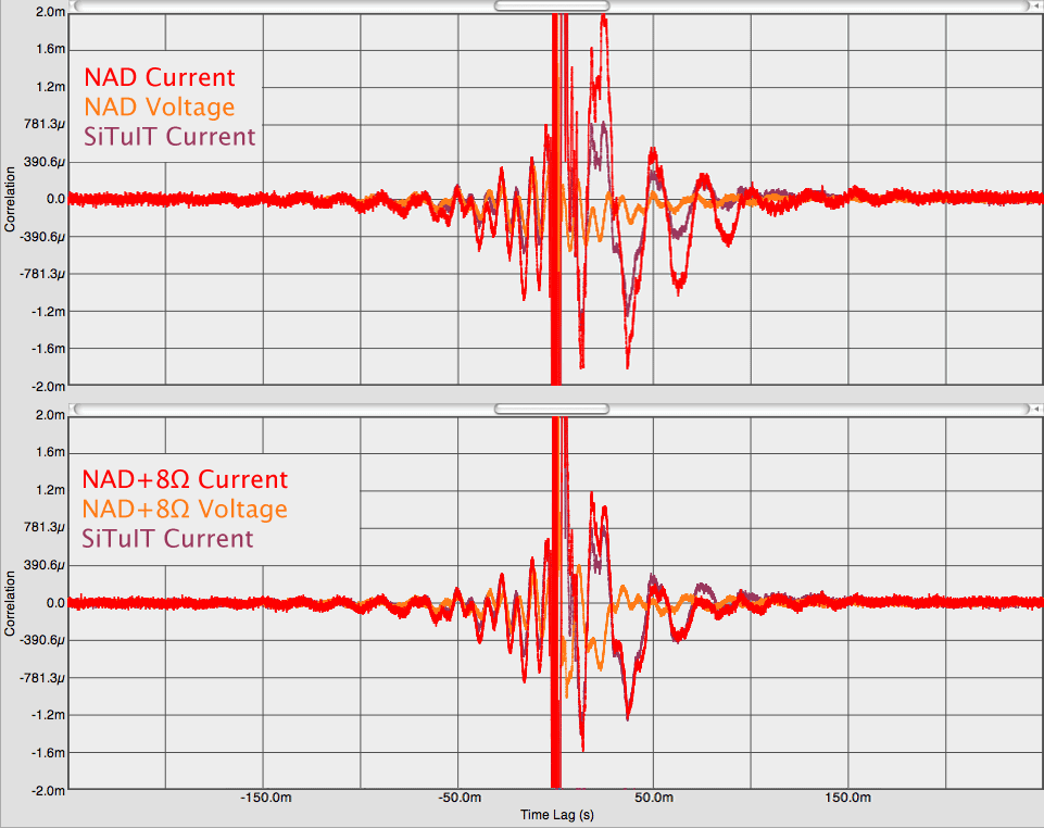

The attachment shows what happens if an 8ohm series resistor is inserted between the NAD and the Replikon. We see a reduction of the voltage damping, but an increase in the current damping. The current plot for the SET amp is provided as a reference.
Why does it look so different from the plot in the previous post? I forgot to set the digital EQ to bypass ! The signal before t=0 and the other differences are the result the EQ in action. Another can of worms has been opened, sigh.
So far these measurements show that the 'damping factor' as calculated by dividing the number 8 by the output impedance of the amplifier is a misnomer. It should be called 'damping reduction factor'.

Hi Gerrit,
So the series resistance does give the NAD a similar current damping characteristic to the triode (which has its own natural internal anode resistance) !
It damps some of the energy which NFB ensured became trapped within the loudspeaker system, but also reduces the storage of those energies in the first place; energies which cannot then fail but to dissipate at (natural) frequencies in series with cabinet, voice coil, and cone impedances other than the impedance dip frequencies at which they originally became stored !
The voltage damping between both amplifiers still does not match, and this suggests to me that the resistor needs to be paralleled with an impedance network which additionally approximates transformer core and winding losses, plus capacitance induced losses arising between the triode electrodes.
Then with such a parallel connected network in series with the NAD, it should indeed 'sound' the same as the triode, this bringing us back to loudspeakers sounding 'best' when driven by an optimum source impedance, this varying with both driver and frequency too, and maybe even being frequency band adjustable via controls on a SS feedback amplifier.
Taking this reasoning forwards - if a series impedance matching network between LS and NAD does match tube performance, then any tube amplifier can be more simply, more efficiently and less expensively replaced by a network plus quality SS NFB amplifier which already provides lower waveform distortion than the tubes can !
This would be the inverse of a parallel network connected across the output terminals of a current source amplifier, which Nelson Pass has already untilised as a valid arrangement.
Controversial or what !
With controllable euphonics too !
Cheers ......... Graham.

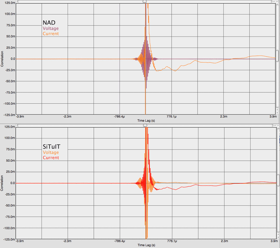

The attachment contains another correlation measurement. This time I measured the response on one channel (pseudo-random noise excitation) while playing the multi-tone signal from the frequency domain distortion on the other channel. This should provide some insight into 'acoustic crosstalk'. Pay attention to the vertical scale, 25m is equivalent to 2.5% time domain distortion. Again, the SET beats the NAD.

Your definition of MORE damping is not logical unless you
can show that the actual driver behaviour is more damped.
That is exactly what these measurements show, the current damping is better with the tube amp. This can be seen in every single correlation measurement I performed.
The measurements were performed on the system as it is actually used, the amp connected to the loudspeaker in the room (the last result even includes the other channel). In medical science this is called an 'in vivo' measurement.
Measuring amps with resistive loads or loudspeakers in anechoic rooms are examples of 'in vitro' measurements, i.e. an idealized laboratory setting.
During my education as a pharmacist the importance of this distinction was illustrated by the story of the iron in the spinach. This myth is the result of chemical analysis of the iron content in spinach. None of this iron actually enters the bloodstream, as far the human body is concerned there is no iron in spinach at all, the body needs Fe2+ ions, spinach contains Fe3+.
The same is happening here, we based all our conclusions about damping on measurements concerning voltage while we should have looked at the current. Voltage does not enter the 'bloodstream' of the driver, current does.
The map is not the land. If there is a discrepancy, the map is wrong.
