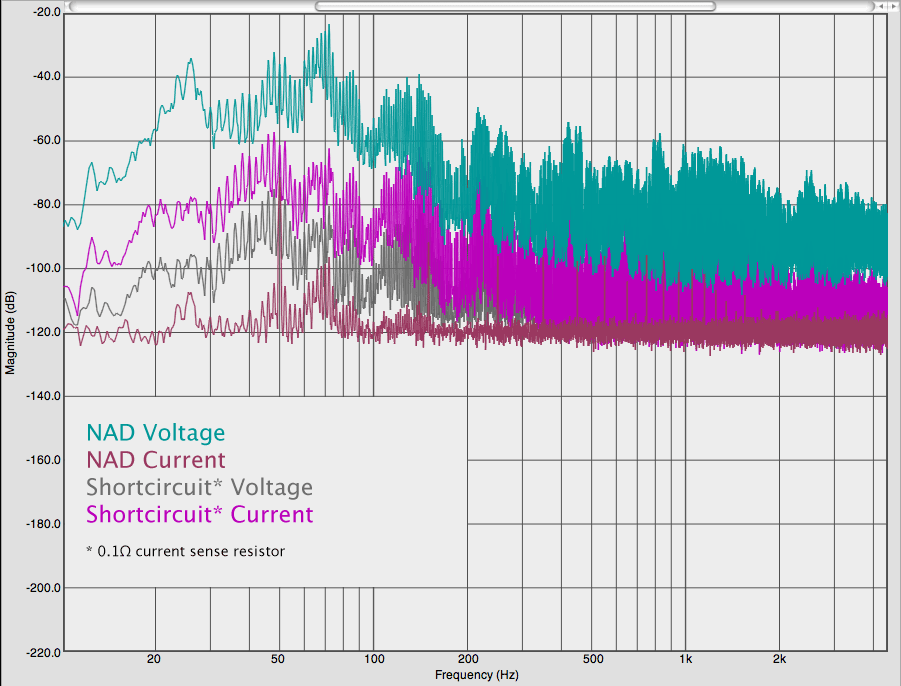

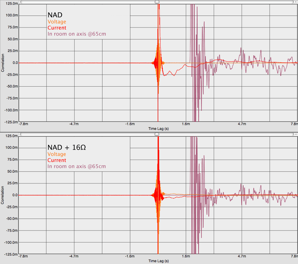

If you want to analyze what makes the sound, you would have to analyze the entirs chain, from voltage (or current) through the motor and the mechanical impedance, through the cone velocity and finally to the sound.
Correct, my point is that current measurements are more correlated to what's going on in the room than voltage measurements.
Ideally one would need to measure what's happening in the brain of the listener.
Current drive leaves all mechanical resonances undamped and does nothing against comb filtering due to delayed internal enclosure and external room sound reflections interacting back with the driver.
Attached is the correlation for voltage, current and in-room signal for the NAD and the NAD with 16ohms series resistance. To be fair, the directly connected NAD has lower values for most peaks in the first 0.7ms, but in the timescale shown in these plots the NAD with the series resistance seems to perform better. The first room reflection is just outside the plot, so we're looking at driver/enclosure resonances/reflections. Personally, I find it difficult to base any definite conclusion based on these results.
The damping factor of the NAD is limited by the 0.1 ohm current sense resistor to 80, with the series resistance this number drops to 0.5. This would suggest a huge difference in favor of the direct connection. I, for one, don't see this reflected in these measurement results.

Gerrit Boers said:
That is exactly what these measurements show,
A thread that starts with an apparent question when what
is actually wanted is to tell you what they think answer is.
Your measurements do not show the effective damping
of the driver as you are not taking into account the
interchange between electrical and mechanical energy.
You are reading stuff into your measurements that is simply wrong.
🙂/sreten.
Hi all,
Welcome Dr. Geddes, I hope you'll find the results of the following experiment as interesting as I did.
Sreten,
You're correct, that was not proper reasoning. See below for more proof.
Here's the experiment:
I measured the current and voltage on the output of the NAD while making a lot of pseudo-random noise on the other channel. The noise was amplified by one of the SET monoblocks to exclude any effects of crosstalk internal to the NAD. Then I switched the NAD for a testlead, i.e. I shorted the driver. As the 0.1 ohm current sense resistor is still in the circuit, this situation represents a true damping factor of 80.
I think this result shows that, from the perspective of the driver, the NAD does NOT represent a low impedance load.

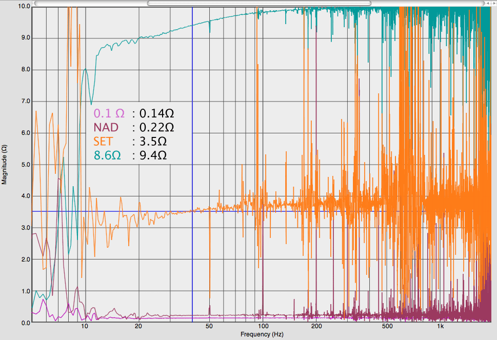

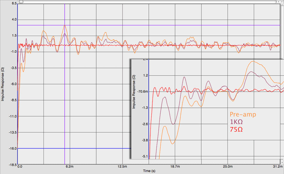

Forget the last post
I'm just trying to replicate the previous result, seems I made a mistake somewhere.
I will take some more time to perform some proper measurements. My apologies for this, it was an honest mistake.
It seems the previous post was not a complete waste of time after all. I must admit that I was so preoccupied with proving my position that I mixed up observation with interpretation.
I suggest we put the whole solid state versus tube argument aside and concentrate on the observations.
What makes the measurement in the last post interesting is that it reverses the signal flow.
Normally we stimulate the driver electrically and measure the electric and/or acoustic results. Now the driver is stimulated acoustically and the measurement takes place on the electric side. The driver is the source and the amp is the load.
By means of an dual-FFT analyzer the impedance can be plotted as the driver sees it. Attached is the result for four different loads, the numbers in black are the values for the impedance at the cursor position (40Hz).
First a note on the measurement itself. Both voltage and current are measured by means of a balanced microphone pre-amp operating at maximum gain setting. The channel that measures the voltage has the -20dB pad activated, thus the gain for the current measurement is 60dB and for the voltage it is 40dB.
Observation:
The range between 30Hz and 50Hz is very clean compared to the rest of the spectrum.
Interpretation:
This is the range where the BLH/BVR amplifies the low frequencies, this results in a stronger electrical signal which in turn results in a higher signal to noise ratio.
Observation:
The plot for the SET amp contains very large spikes, both up and down. It looks like these spikes come in clusters.
