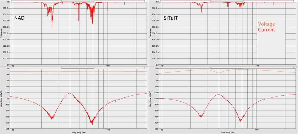

Hi Gerrit.
Is something wrong with the tube amplifier voltage trace shown in Post#2 ?
Looking back to Post#1 it is there too.
As if something is saturating or current/voltage limiting;
maybe this also affecting the following settlement !
Regarding Post#5.
The NAD current response shows an increase in mid-range current draw, essentially an increase in the 'shout' normally attributable to a widerange driver.
I suggest that if you put a resistor in series with the output of the NAD having a value the same as output impedance of the triode amplifier the increased mid draw will even out between the amplifiers.
The current curve for the triode shows increased output at higher frequencies, in line with the results observed by Nelson Pass in his Current Source Amplifier .pdf, which I cannot find on his Website, and so I cannot reference it at the moment.
Undamped impedance peaks due to the Replikon cabinet show very clearly.
I don't think so. The peak for the voltage is probably between two samples at 2.5 microseconds, a higher sample rate would be required to confirm my suspicion.
The curent curve shows increased output at higher frequencies, in line with the results observed by Nelson Pass in his Current Source Amplifier .pdf, which I can not find on his Website to reference at the moment.
Impedance peaks due to the Replikon cabinet show clearly.

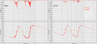

I note in Post#8 that the dynamically induced current variations modify the voltage trace of the tube output (in series with Ra), though modify the current amplitude of the NAD due to its output voltage being NFB controlled.
Also,
this being something which would need to be considered by those who rely upon CSDs etc., and as considered by Klaus above -
the electrical phase response has been modified by the change in drive impedance,
and with the transduction response being modified, so too must be the reproduction characteristics as well.
Of course this is far from new, for others have shown how drive impedance/damping affects LS response and thus reproduction, and so I wish Gerrit the best of Luck in being better able to analyse the technical aspects of what we hear via our loudspeakers.

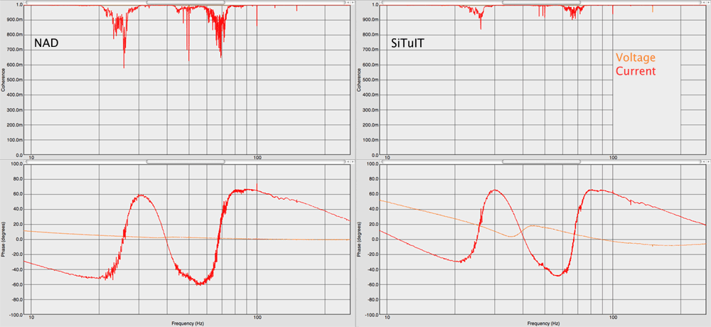

I had noticed the irregularities in the current phase response that Graham mentioned. It seemed worth 'zooming into', so I repeated the measurement with a lower sample rate setting (96KHz) but a higher FFT size (1536000) resulting in a 62.5 mHz resolution. The output level was 250mV for both amps.
The attached image shows the coherence (top) and phase (bottom) for output voltage and current. Notice that the voltage coherence is perfect for both amps, just a light glitch at around 150Hz in case of the SET amp.

The main difference between SET and SS NFB amplifiers is that the latter has two inputs, with that second input being the NFB sensing node which is connected, hopefully directly, to the output terminal. Many SS designs have series output chokes between the output terminal and the control sensing node, which means that the music waveform at the output terminal can be fractionally modified by back-EMF with respect to the sensing node!
When I simulated amplifier circuits with equivalent dynamic loads (complex R+L+C) I found errors were much greater when the virtual loudspeakers had crossovers which introduce current phase change with respect to voltage around the crossover frequency.
In view of SS output stage class-AB crossover effects being exacerbated by load phase change I ended up examining how the amplifiers behaved in response to 1V and 10V step inputs fed into their output terminal via a nominal load impedance resistor (8 ohm). Some would allow >>100mV of output terminal swing before settling with damped oscillation.
I cannot presume to know exactly what your current investigation is revealing, though clearly measurable phase jitter (noise arising due to NFB correction?) is arising which cannot fail but affect waveform coherence in time.
One significant aspect here is that this is for just one channel.
Where two channels are similtaneously but independently creating such jitter, then any stereo imagery location must be rendered fuzzy and less precise than that provided by the SET.
I also equate this response jitter as being the SS aspect which impairs the 'blackness' behind reproduction, the 'blackness' which immediately deepens with tube amplifiers and competent SS class-A.
I trust that the amplifier input is truly clean such that the input stage is not switching under some circumstances.
Any chance of you repeating this examination with a 2 or 3 way LS with crossover to check for linearity about the upper crossover frequency where most SS NFB designs have fully developed quadrature damping characteristics.
Cheers ....... Graham.

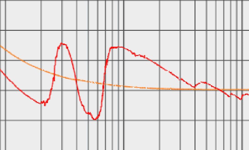

Attached you'll find the 'zoomed in' plot for coherence and amplitude. Again, the amplitude plot for the voltage is clean. The nastiness is only visible in the current plot.

Another aspect I reasoned regarding NFB SS amplifiers, is that because they match the voltage output waveform to input waveform regardless of current, the amplifier countered driver back-EMF alternations become trapped within the composite loudspeaker circuitry.
Thus with an underhung single driver like most Fostex types, all current flow errors are trapped in series with amplifier/cable/voice coil/cone impedances and cannot fail to modify on-going reproduction after the event which generated them - a phased haze where there should be clarity.
Thus an underhung widerange driver cannot fail but to 'shout' much more acutely at higher frequencies when driven by a SS amplifier - unless - it is driven via a series impedance having values similar to the transformed anode resistance of a tube amplifier via which some of the back-EMF and re-transduced mechanical and microphonic output due to cone break up and secondary air-side events can become passively dissipated externally; as with the triode plots.
Many years ago, observations here with tweeters on extended leads showed the audibility of SS class-AB amplifier exacerbated noise events was most notable because they modified higher audio frequencies (not clipping), even though they were often caused by low and mid frequency related inductions. Tube amp tweeter output always seemed just plain normal, even via AB1 with NFB (the application of which is of course limited by circuit phase changes).
Lynn Olsen's Ariel LS is known to reveal weaknesses in SS amplifiers, I believe because it crosses over to the tweeter at a higher frequency where most NFB responses are already in full quadrature.
Of course all SS amps do not behave similarly, so maybe here is a more relevent method for studying bipolar/Mosfet and different classes of output stages, maybe even with different R+L+C circuits to (quietly) represent realistic LS loads.
Maybe an equivalent circuit for the Ariel LS would be worth testing as a LS load, though of course complex cone and air induced events will be completely missing.
Cheers ......... Graham.
