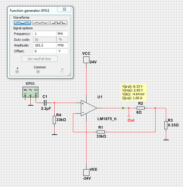

I can't see a good reason for the 47 uF cap. Just take the feedback between the .22 Ohm resistor and the load, using any resistor with colours you like. The value is not critical, but it has advantages to use the same value as on the input side. Like you did. This will minimize DC offset and might decrease distortion a bit.

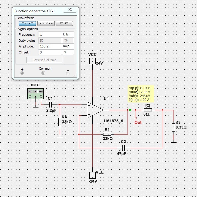

You don't need the 47uF cap.
See this schematic.
But the price to pay is a few mv output offset. In the schematic it is 4mv.

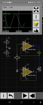

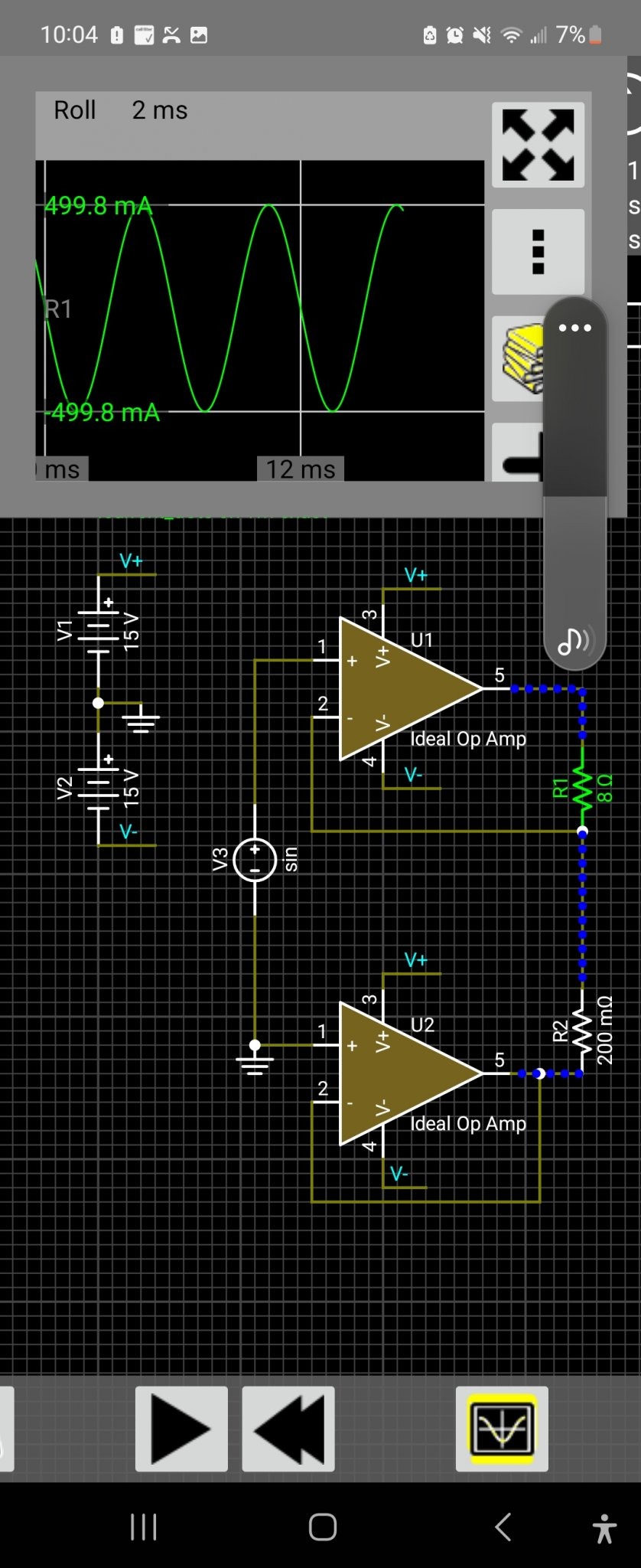

I don't think this will work.
The "inverted" amp will massively influence the current-drive-feedback of the upper amp. Probably BTL current drive is not that easy to do.
I think you're right that the way I posted it will not work well. It's just a driven ground in that ideal case. It's certainly not balanced in the way a voltage out BTL setup is. Even with a symmetrical input signal, the top amp sees the speaker load plus half the sense resistor, while the bottom amp just sees half the sense resistor as load. The way I posted it, the bottom amp sees 0 ohm load (short to ground)

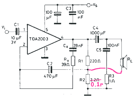

A plain 100-200 ohm resistor in parallel with load will do.
Or turn network into mixed feedback type, allow for a little voltage feedback too, so open load does not turn into full open loop.
Say pure current source gain with normal load is 40X (8 ohm - 0.22 ohm), add a small resistor in series with cap so with no load it shoots up to, say, 400X or tops 800X
Sound will be almost the same, but amp will be safer.
