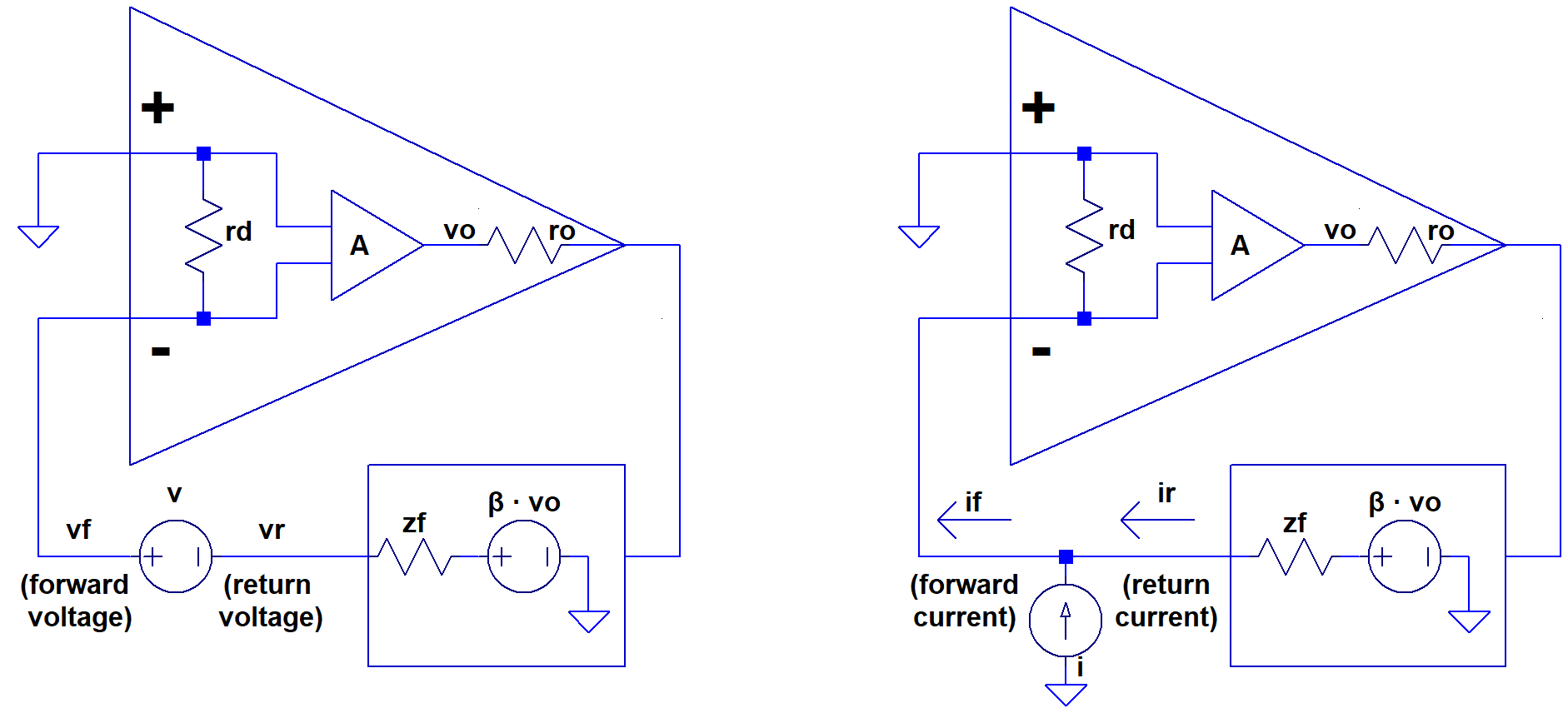

Let’s approach the subject of this thread a little differently. Around feedback loops, there are both voltage and current gains. One way to evaluate them starts with inserting a signal into the loop without disturbing impedances or component biasing. If two specific signals traveling in the forward direction around the loop (one immediately after the insertion point and the other immediately prior to it) are non-zero, then the signal gain and feedback are finite and non-zero. The following text and accompanying schematic provide a general example which supports and elucidates these claims.
Consider any amplifier that has inverting and non-inverting inputs and a single ended output. There is an impedance rd between the inputs. We could describe the output stage as a voltage source vo in series with ro or equivalently, a current source io in parallel with ro. And we could state that vo is equal to the unitless parameter A times the difference between the input voltages, or alternatively that vo is equal to the product of an impedance Z and the current flowing into an input, where Z = A · rd.
Let’s work with the first of each option pair. From the perspective of the inverting input, the combination of the output stage and feedback network looks like an impedance zf in series with a voltage source equal to vo times an attenuation factor β. Analysis of the accompanying circuit loop gives us:
There is less current than voltage gain when zf/rd is greater than one, but more when that ratio is less than one. The gains are equal when zf equals rd.
The situation is the opposite for feedback. Decreasing values of zf/rd lead to growing amounts of voltage feedback, an intuitively satisfying result. But increasing values of zf/rd mean that a smaller portion of ir is leading to a larger portion of if - that is, current feedback is rising.
a current gain of ir/if = (β·A+1) · rd/zf
a voltage gain of vr/vf = zf/rd + β·A.
The application of the forgoing analysis to the main subject of this thread should be clear.
