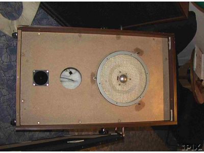

And not just behind the driver. Let's open our minds to the potential of flow resistant/acoustically absorbant materials in front of a wideband cone (around the perimeter), damping the fundamental resonance and absorbing the extraneous resonance signatures of the surround and standing waves along the outer circumference of the cone.
The east german build TH315 "Schulze" 12" coaxial did exactly that. A flowresistance in FRONT of the cone. I worked a few month in the workshop/factory that made these and Schulze KSP-215....

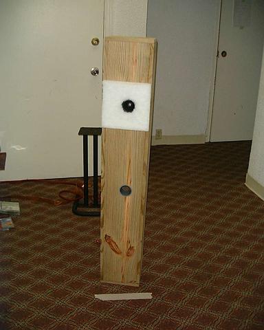

Let's open our minds to the potential of flow resistant/acoustically absorbant materials in front of a wideband cone (around the perimeter), damping the fundamental resonance and absorbing the extraneous resonance signatures of the surround and standing waves along the outer circumference of the cone. I imagine this treatment could effectively treat beaming/lobing in the bargain, even as it eliminated diffraction effects from the cone/frame/baffle transition.
Been there, done this numerous times and it does all these things. Here's the unfinished 40-1354 towers I was building for a buddy at the time the Atlanta 2001 DIY Meet came around. No super tweeter was used since he's deaf above ~7kHz, though the 3/4" thick polyfil with HF 'window' combined with the ML-TL tuning and $0.98 whizzer tweak, the MLS measurement was +/-3dB from 40-12.5kHz. Since the polyfil damps the flimsy rubber surround so well and softly limits cone travel, it gives it the 'euphonic' type of soft clipping similar to a tube driven AlNiCo speaker when overdriven. Even with no mass loading or stable mounting base, overall, folks seemed to like them quite a bit even with the rolled off HF and were flat floored by how much smooth bass extension they had. At least one guy was convinced I had a bandpass 'sub' buried in them.
WRT cosmetics, eventually the polyfil was sprayed with a tan vinyl spray and covered with a ~matching expanded double knit material to make it look similar to one of those big foam grills of the '70s.
GM
what do you think about quality of these drivers (th315)? Any datasheet?
I have two of them in very good condition (one without "resistance" on front:dodgy: ).

Bill F. said:
I guess there is nothing new under the sun.
Pictures?
I'm curious to what degree (thickness, location) they employed these materials.
See attached. The ayer was fairly thin, maybe 5mm or so (this is now almost 2 decades ago!)....
I had a pair in their original enclosures, I thought them very good.
