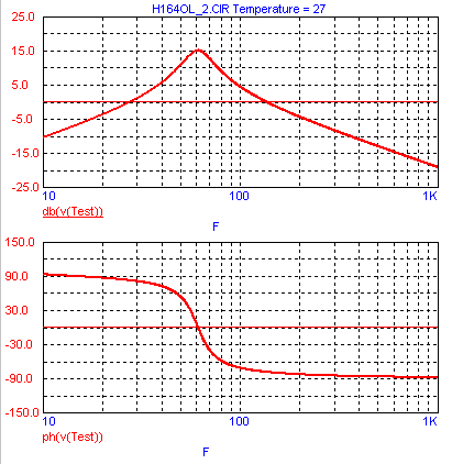

Pjotr said:Appended an electro-mechanical model of an electro dynamic loudspeaker. This model shows more direct what is going on in a loudspeaker than the model of T&S.
Does your model account for the non-linearity in BL, Eddy current losses and voicecoil heating.
Pjotr said:What can be seen is that damping is a force proportional to cone velocity.
Then you model has been simplified beyond usuability.The EMF and the electrical damping derived from that is proportional to cone velocity, voicecoil position in the gap and voicecoil temperature.
Pjotr said:Now is raising the mechanical loss a viable solution the get proper damping? IMHO we are trading bad things for other bad things then. It is very hard to get large mechanical damping ( = friction) with low distortion.
You feel it is "very hard"? Are you sure? Even this thread already contained some suggestions that would provide a "self damping" driveunit with a comparably linear damping directly proportinal to the voicecoil velocity.
In my view we trade several bad things for the responsibility to manage ONE bad thing responsibly. Less variables usually mean a reduction in the complexity of the problems to be resolved.
Pjotr said:A better approach looks sensing cone velocity and feed back that to the input of the current amp.
This brings us back to MFB and the problematic of how to sense the cone velocity accuratly. Most of the schemes used and proposed so far either suffer from insufficient linearity or are too frequency response limited to be really usefull.
Pjotr said:Better use an acceleration sensor mounted on the dust cap
ANd hope and pray that the dustcap is neither flexible nor imbued with any hysteresis. And of cource that the senser has no hysteresis and is linear.
Pjotr said:Piezo disks senses acceleration with pretty low distortion and are cheap.
That, except the point about cheapness is a thesis that cannot be accepted as true at all, sorry. Piezo elements suffer from exactly the things I suggested above which would make a bad sensor.
Sayonara

Dear KYW
Thank you very much for your negative feedback, very helpful
Maybe you do better to read again my post and get what I intended to say.
What I posted is in fact a summary from what was published in the AES journals in the past years concerning current drive. That publications showed more or less good results.
Seems you don’t appreciate a different view. Ok continue with adding mechanical friction to dampen a loudspeaker. Curious about your results.
Regards

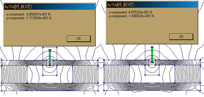

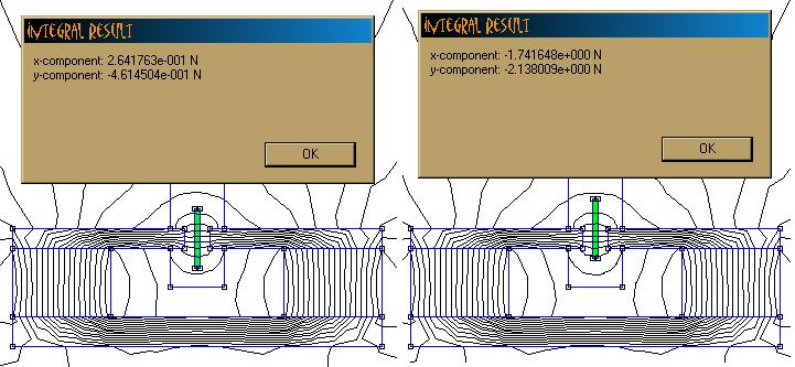

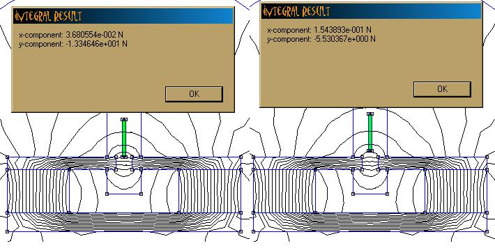

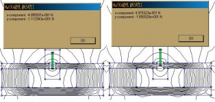

Just to clarify the behavior of magnetic ring suspensions, here is a series of FEMM sims of a segment of pure iron in a magnetic gap moving through steps of outward excursion.
Look at the Y-component results of the force integrals (ignore X). The values are negative when the net force is pulling the iron segment downward.
First attachment: segment centered in gap, and segment displaced outward 0.2"

Bill F. said:Just to clarify the behavior of magnetic ring suspensions, here is a series of FEMM sims of a segment of pure iron in a magnetic gap moving through steps of outward excursion.

Thanks for digging up that patent, Thorsten. Interesting reading. I doff my hat to the genius of Mr. Luth!
The patent appears to confirm what I was imagining about the function of the Hartley/Luth magnetic suspension, so I believe my simulations are still applicable.
I was interested that the VC former in the preferred embodiment of the design appears to be based on an aluminum tube with no mention of a slit, so it would be an effective eddy-current damper. I wonder if this is at least partly responsible for the lack of ringing at the end of the time/displacement graphs they use to illustrate the superiority of the magnetic suspension (with large dia. spider for radial centering) over a tighter spider suspension.

Yes, basically, the restoring force is allways directly proportional to the force attempting to remove the voice coil from the zero position.
Yup. It also illustrates to all the nay sayers that eddy current damping is not a "bad thing", as few who have experienced Hartley Drivers would argue that they "sound bad".
I would think so. Basically, combine a magnetic suspension and suitably arranged Aluminum VC with a suitable voicecoil in a magnet system with a reasonably well linearised filed and you have a driver that should do very well, if the acoustic system is build as well as the electromagentic one..

Re: Nice ideas, but...
Don’t worry too much, attached a picture of the (simulated) loop gain of a current driven Peerless HDS 164 woofer in a 20L closed box. Total Q was aligned to 0.71. Velocity feedback was taken from acceleration integrated by a 1 Hz, 1st order low pass filter. No signs of danger show up 🙂
Back to what a dynamic loudspeaker is in fact. If we ignore the acoustical output of the loudspeaker, which power is very low concerning the total powers involved (exempt for a horn loaded speaker), a dynamic loudspeaker is nothing else than an oscillatory second order mass-spring system. Such a system stores a lot of energy around its resonant frequency Fs. When we drive it with a voltage the speaker takes much less energy around Fs due the back EMF which is highest at Fs. Around Fs the impedance raises a lot and we can say the speaker takes the current that it needs keeping the stored energy within reasonable bounds. That way it is kind of “self adapting”.
Now if we drive it with a current we are forcing much too much energy into the loudspeaker around Fs, resulting in a sharp response peak around Fs and oscillatory behaviour (“ringing”) in response of a step input. Now what can we do about it? We can dissipate this excessive energy into heat by means of heavily braking the system as KYW proposes, either by means of viscous damping or by means of eddy current braking. This in fact lowers the mechanical Q factor. During the last decades many people reported that loudspeakers with low mechanical Q simply sound dull, sound “slow” and/or are lacking fine detail. It is not for nothing that modern speaker manufactures tend to make Qm as high as possible. A high Qm means low mechanical losses.
Instead of converting the excessive power put into the loudspeaker into heat by means of mechanical damping, we do better to NOT put excessive energy into the speaker IMHO.
There are two ways to accomplish this:
1/ Putting a notch filter in front of the amplifier, compensating for the peaking around Fs. A suitable filter is a bi-quadratic filter like a LW transform. However this is tricky at high values of Qm.
2/ Using MFB by sensing cone velocity. This is a well-proven concept.
Turning the excessive power around Fs into heat by using heavy mechanical damping is putting the horse behind the cart IMHO.
Cheers 😉
