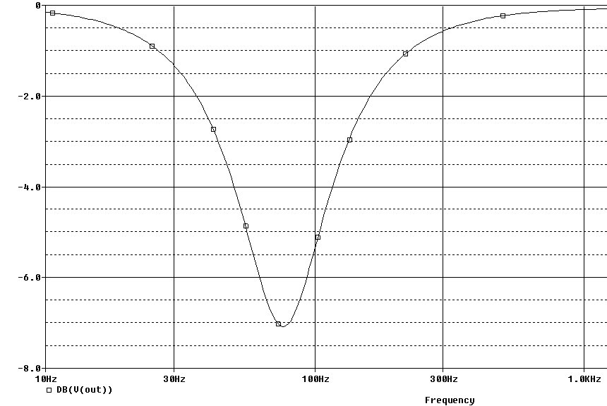

I have tried to simulate a series resonance circuit (realised with a "synthetic" inductor), see the schematic. Here you have the posibillity to choose the resonance frequency and the Q value as well. I think this is a cheap and easy way to realize the equalization, as long as you know your design parameters.
Equalizer response
It is simulation only (see my last thread)
