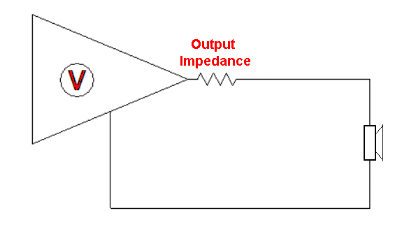

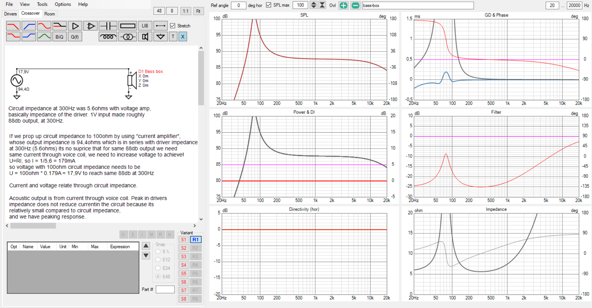

Joe, the current from "current amplifier" is due to high voltage over high impedance. Its the impedance in the circuit that differentiates "voltage amplifier" and "current amplifier". "Current amplifier" is misnomer here although that is what it is the effects using one, reduced distortion and electronic damping, is not properties of the amplifier or the current but the high circuit impedance. High circuit impedance changes how the driver behaves, current in the circuit is not manipulated by driver as much as with low circuit impedance. This is the confusion here, impedance in the circuit makes difference on the currents in the circuit. Thinking impedance and all is very clear.
KSTR explains nicely what the electronic damping is. When circuit impedance is increased electronic damping erodes quickly. Its all in the impedance. If circuit impedance doubles from drivers impedance alone, at some particular frequency like in drivers resonance, the current in the circuit with drivers back-EMF voltage cuts in half.

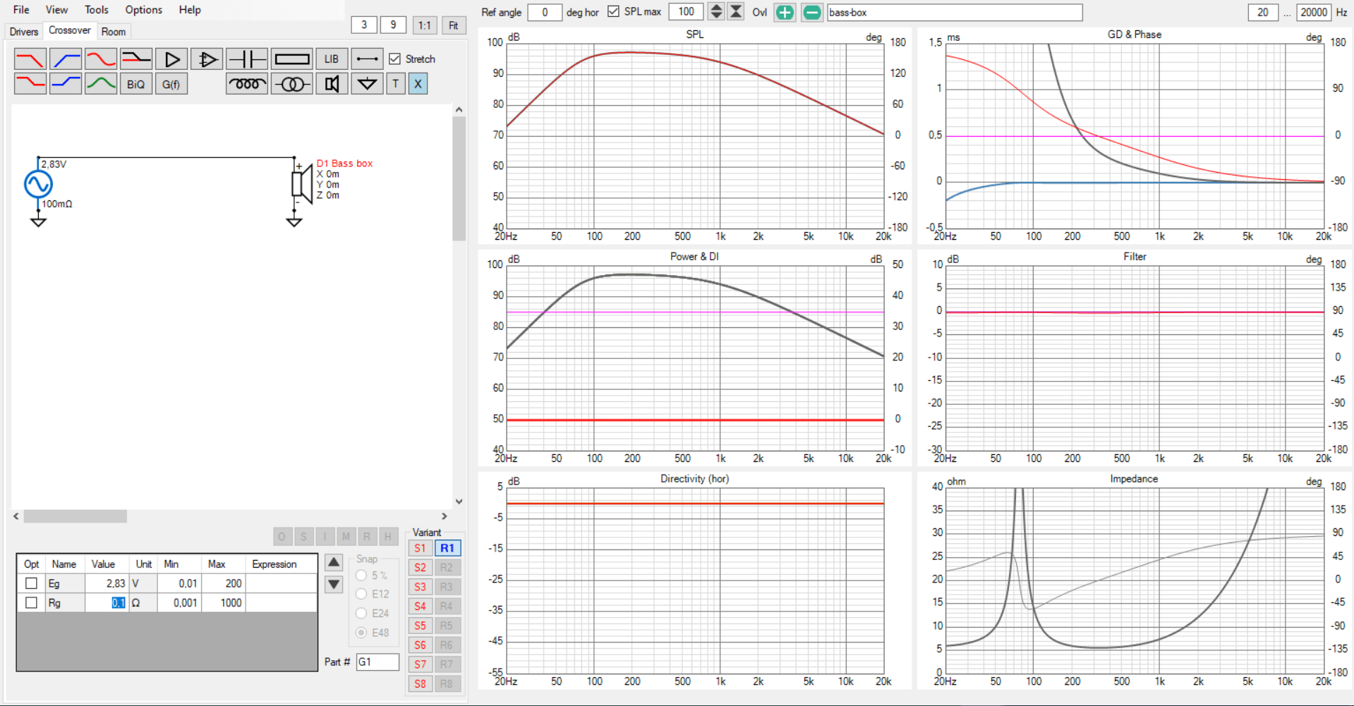

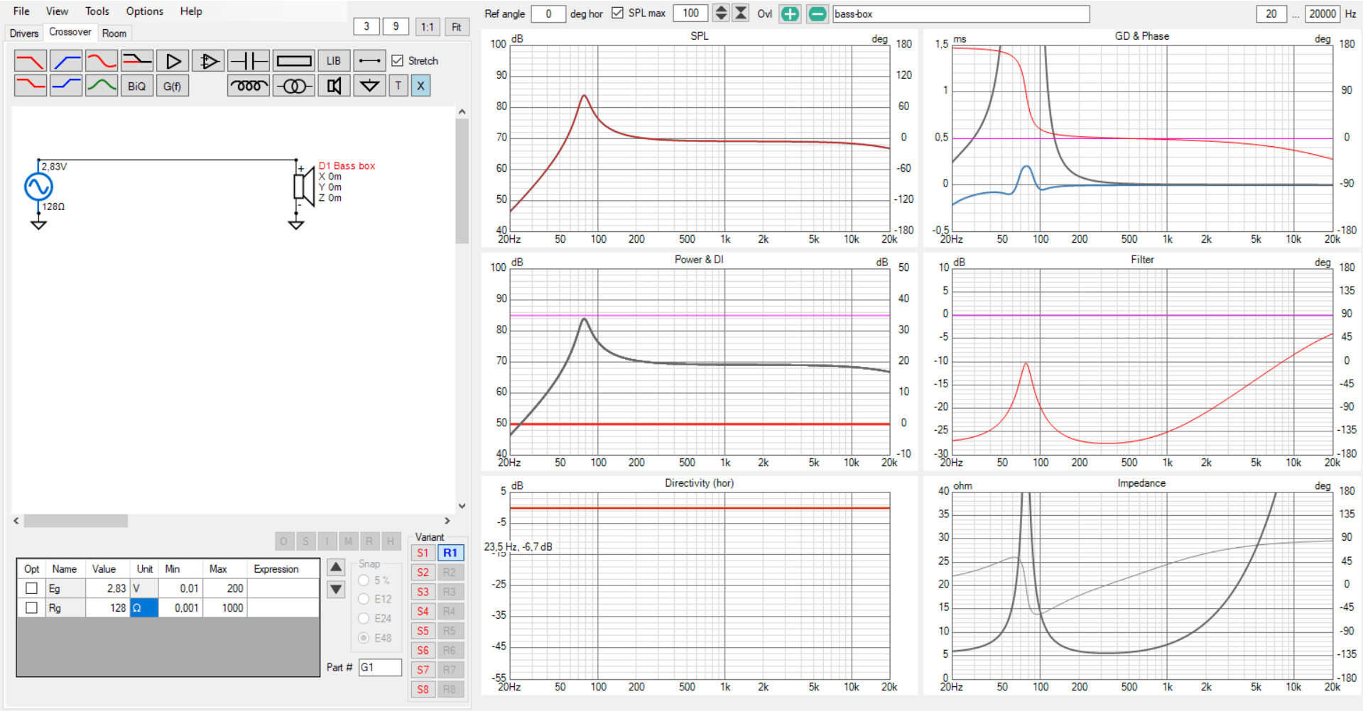

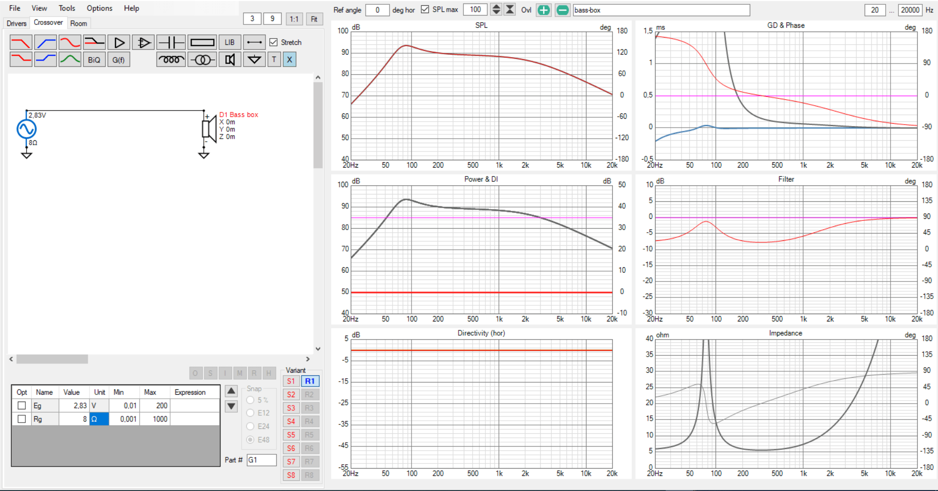

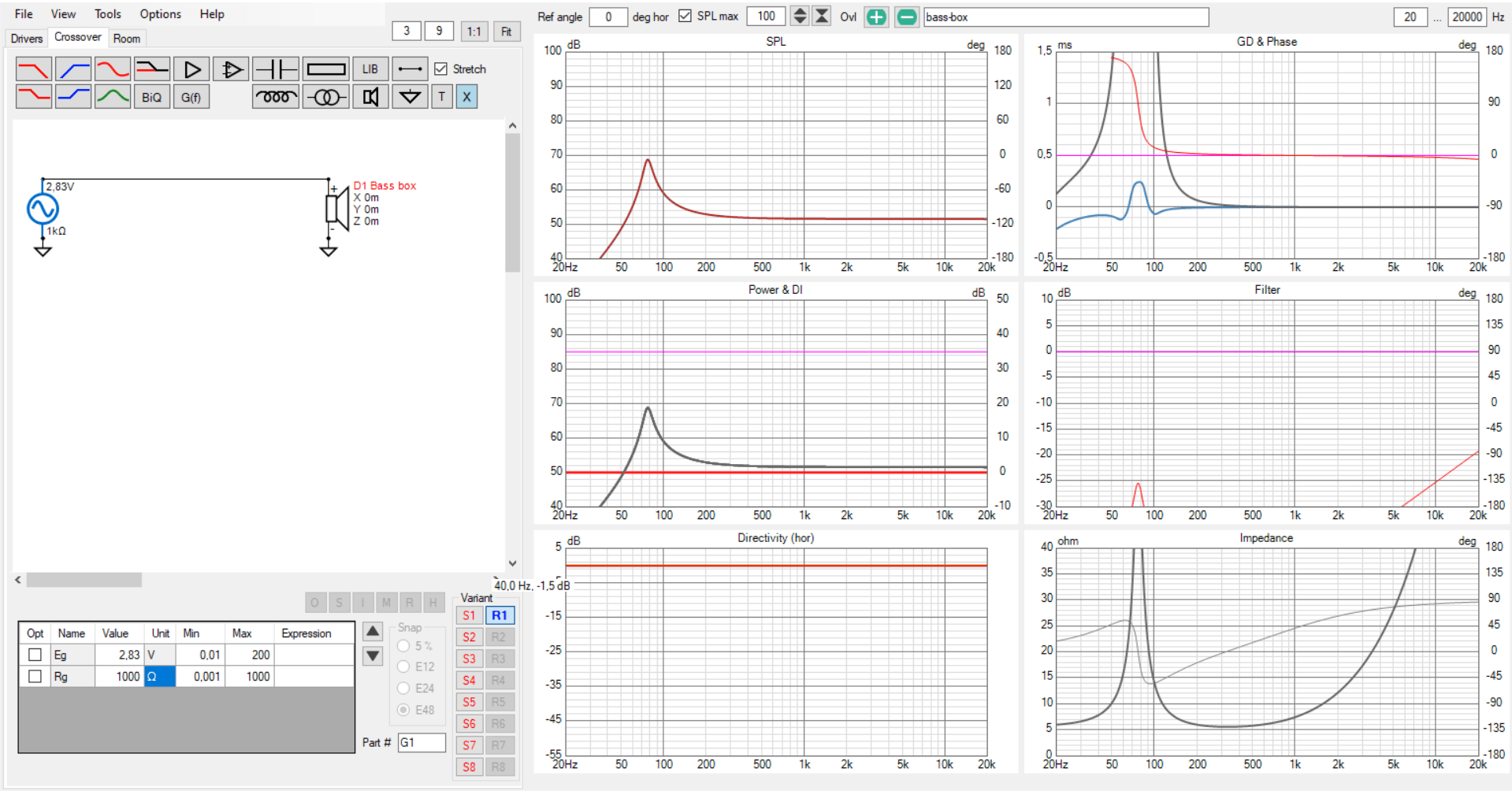

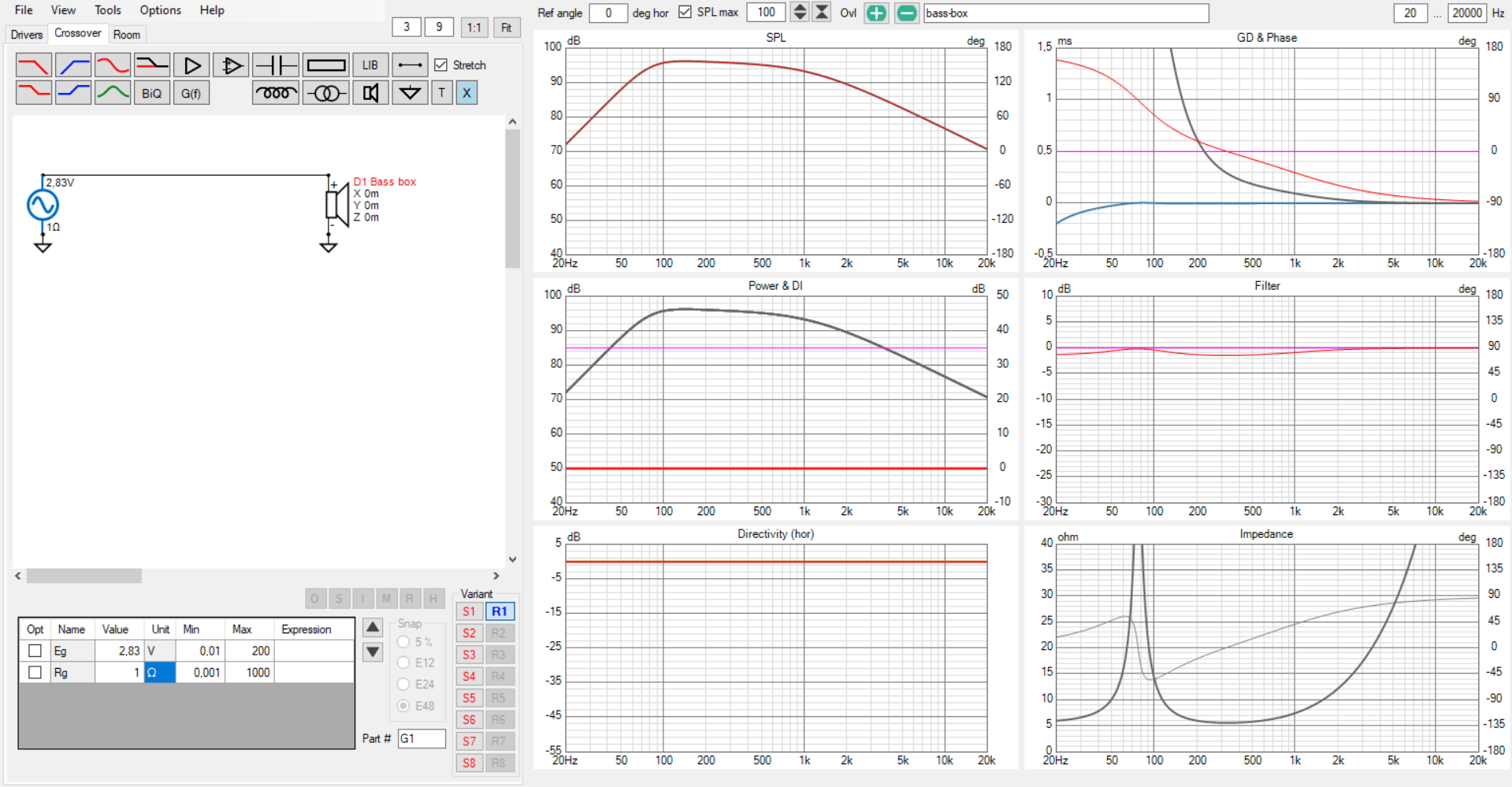

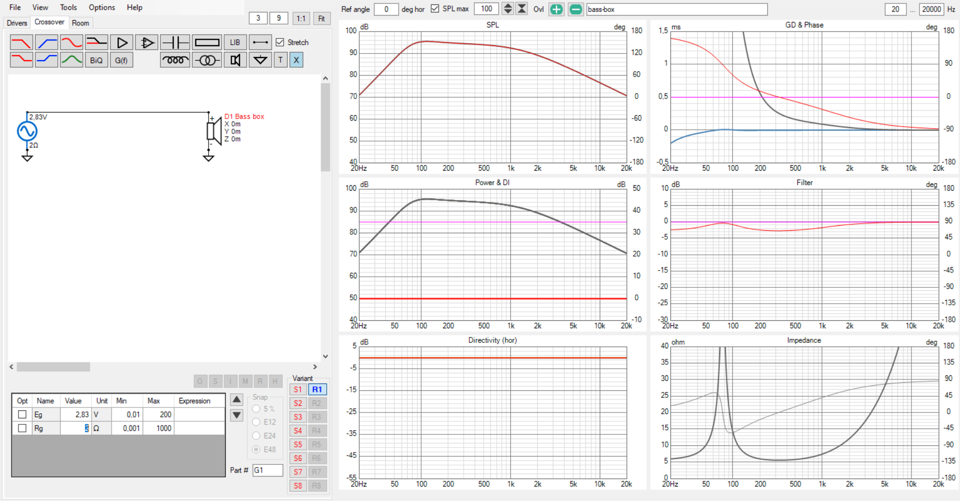

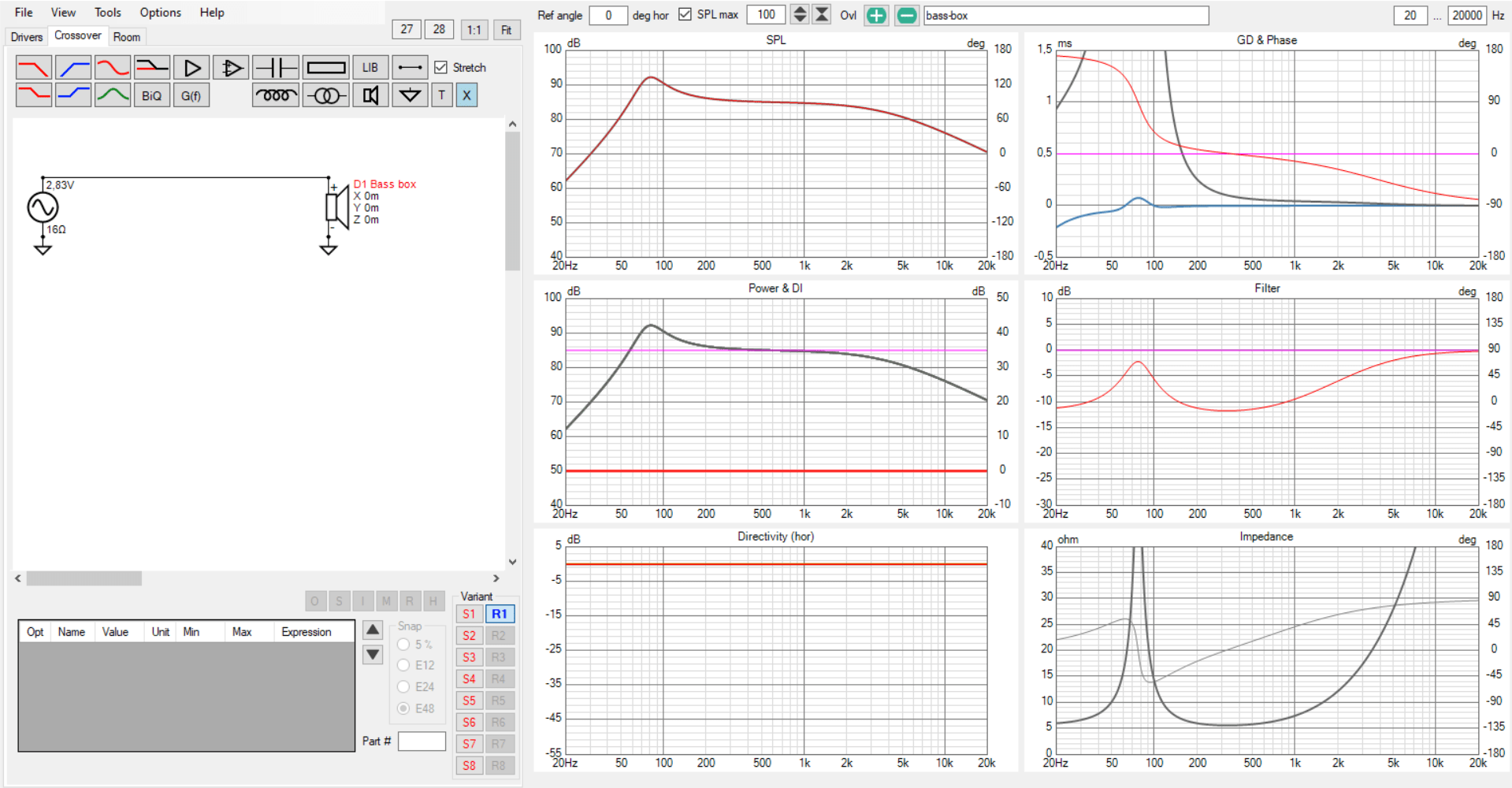

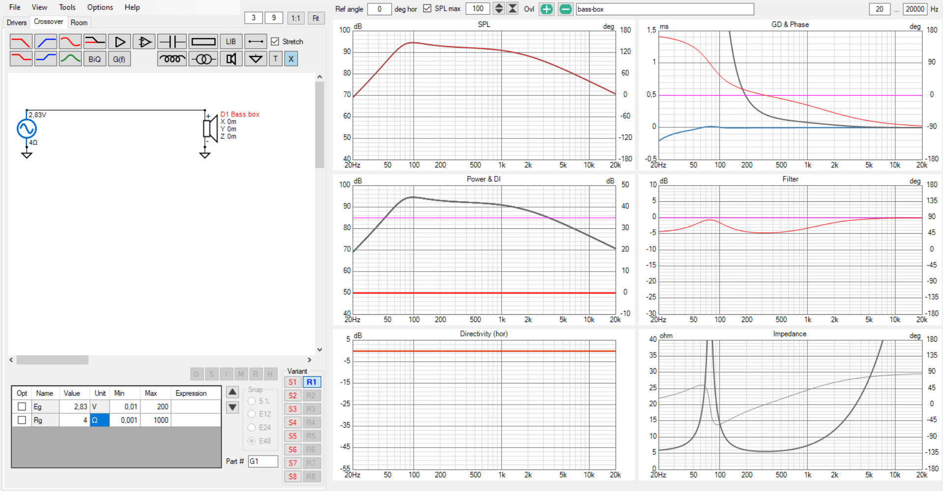

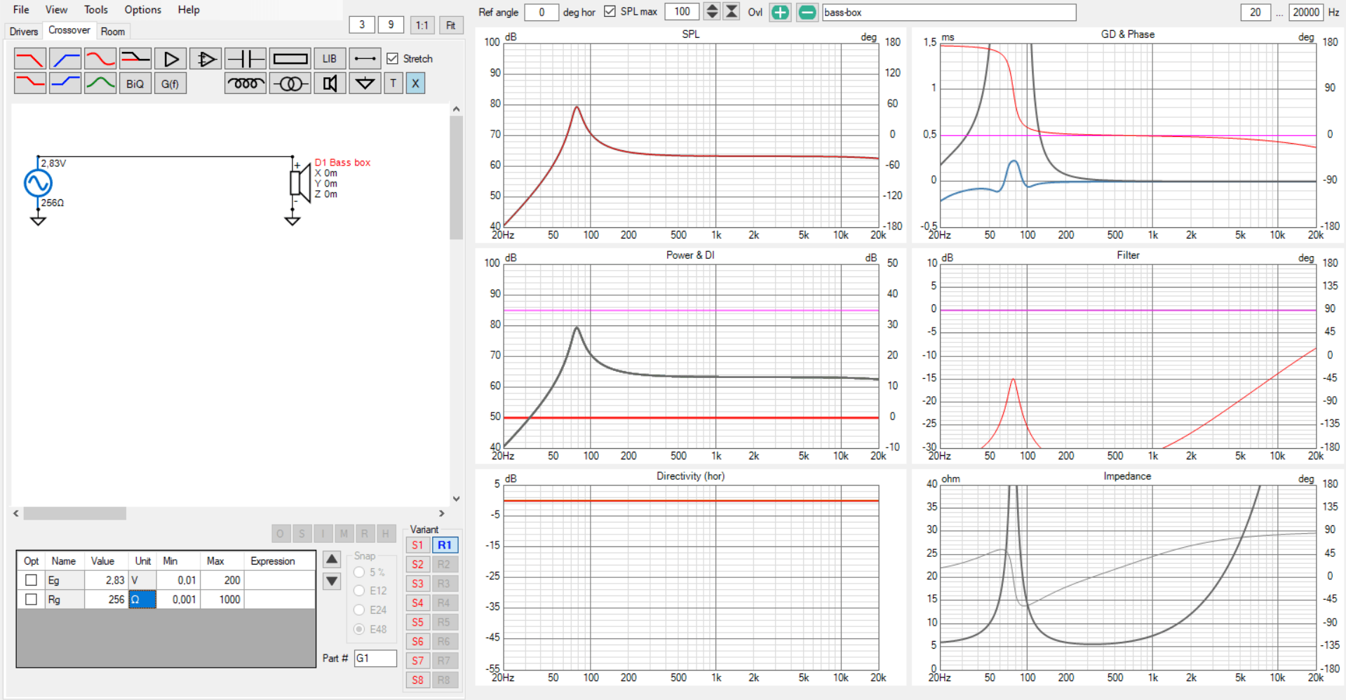

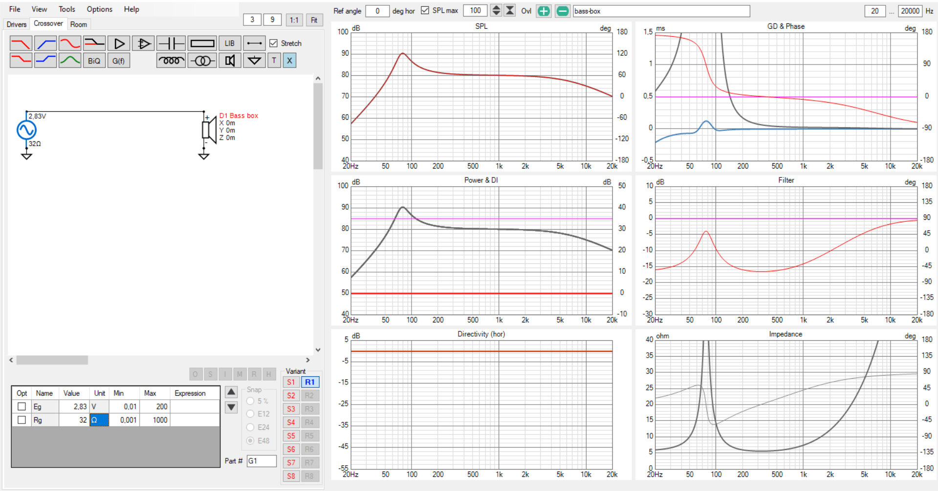

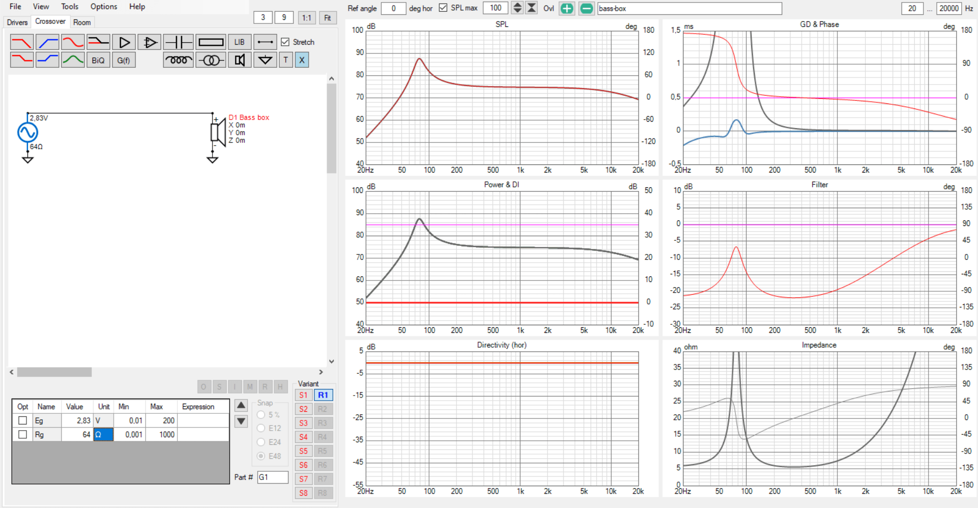

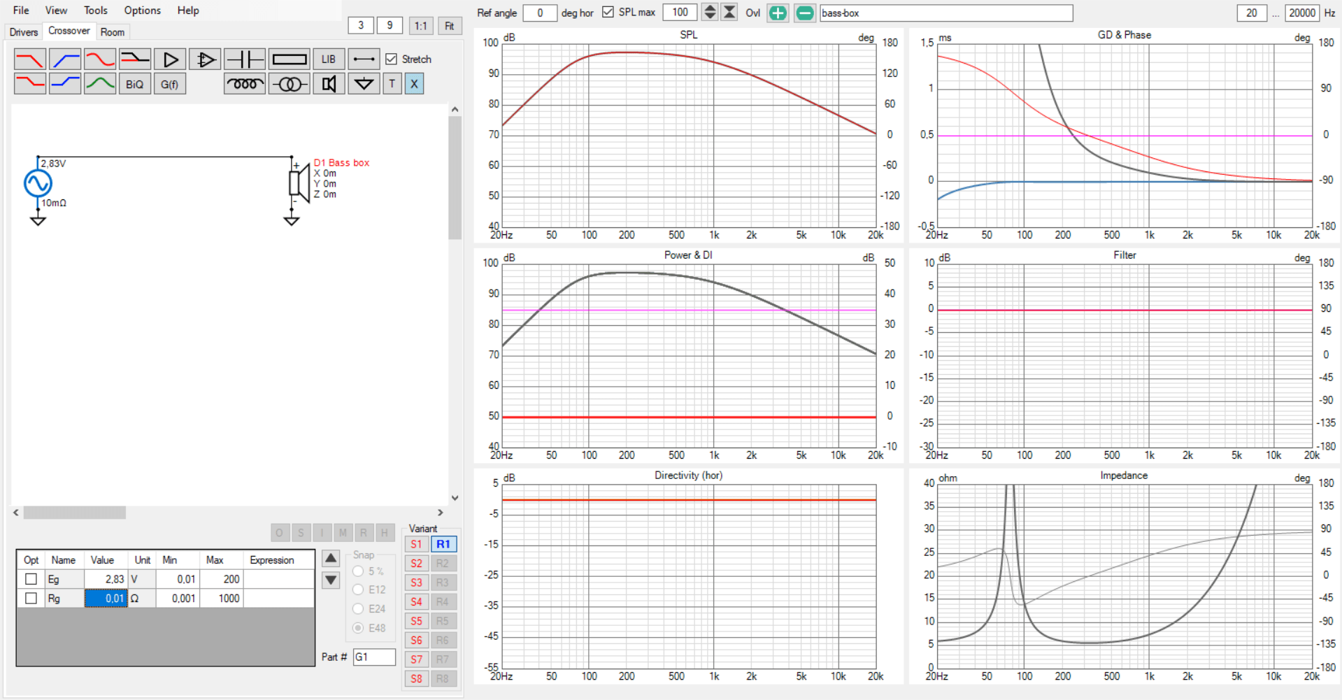

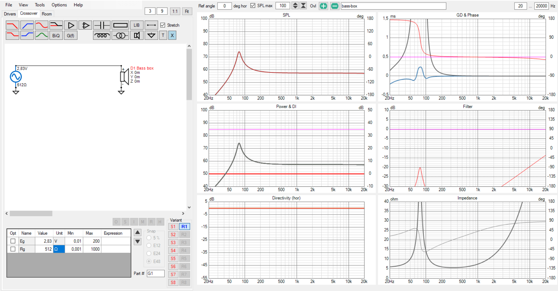

See this image series that shows what happens as circuit impedance is increased by manipulating amplifier output impedance. Cycle it through with keyboard arrow buttons.
0.01.png 0.1.png 1.png 2.png 4.png 8.png 16.png 32.png 64.png 128.png 256.png 512.png 1024.png
See, there is no line between current or voltage amplifier, all we have is circuit impedance.

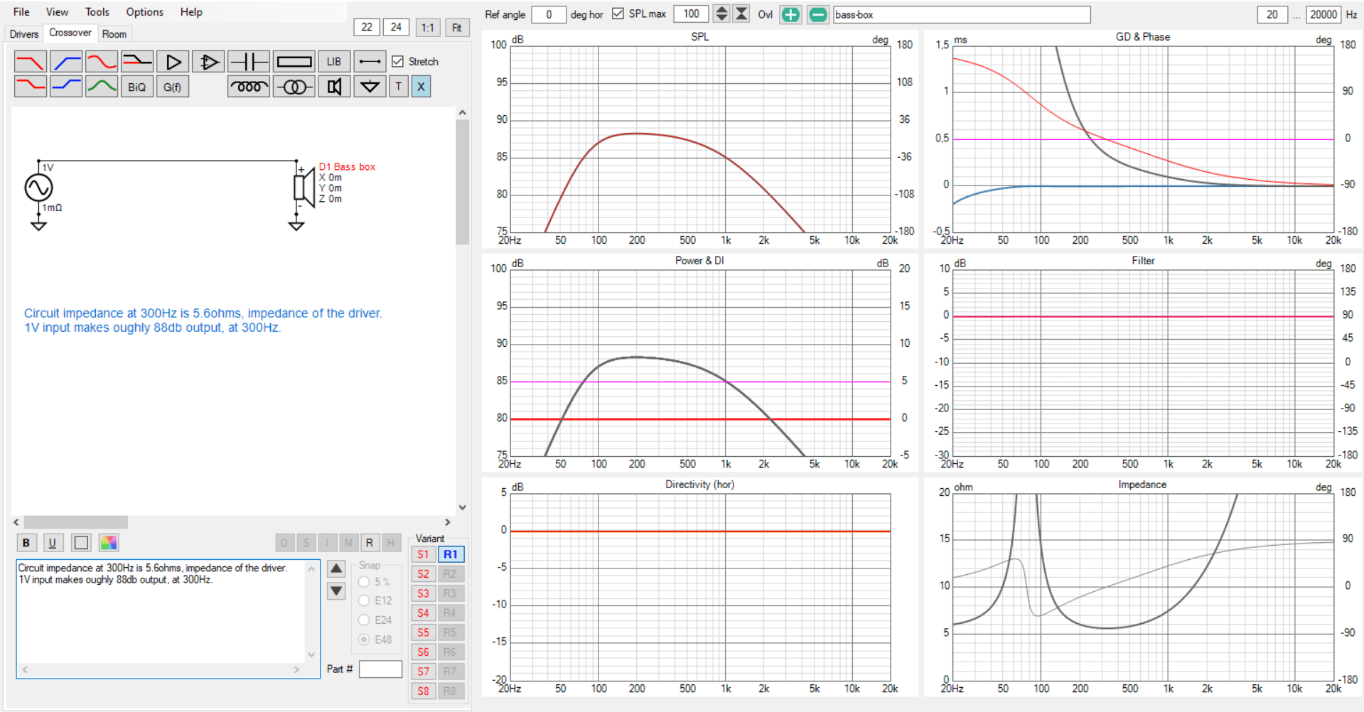

To reach particular acoustic output at some frequency some particular current needs to flow through voice coil. When circuit impedance is increased, we need higher voltage to make same current flow in the circuit, to reach same acoustic output at some particular frequency. See this example. It is 1V source, lets inspect output at 300Hz, it depends on impedance at 300Hz which in this case is 5.6 ohms.
If we then increase circuit impedance by using amplifier whose output impedance is 94,4ohms to make 100ohms total at 300Hz we can use the impedance to calculate what voltage we need to get same current flowing, same acoustic output, at 300Hz.
Whats the nugget of this post?
Electronic damping is from driver velocity generated back-EMF voltage, KSTR shows the math and its available anywhere else you look for it. When circuit impedance is increased this back-EMF voltage makes less and less current in the circuit, as can be reasoned from the above demonstrations. We would have to increase voltage of the back-EMF to maintain electronic damping with high circuit impedance, this is not happening because velocity stays the same for given force, so the electronic damping is lost when circuit impedance is increased (like with using current amplifier without low impedance shunt). Its not lost completely because impedance is finite, but almost.
In circuit analysis ideal current amplifier is open circuit, ideal voltage amplifier is a short circuit, KSTR refers to these for easy though processes. In reality current amplifier is Nortons equivalent, some finite impedance in parallel with ideal current source = series impedance for rest of the circuit. Same goes for voltage amplifier, its Thevenins equivalent, ideal voltage source with some series impedance = series impedance for rest of the circuit.
This stuff is taught in college physics, although not in loudspeaker context. Its no different though, loudspeaker systems obey same physics as everything else on this planet they coexists.

Can't argue what causes electrical damping, its in the math, look for KSTR post, or Esa's article for explanation and math if its not clear to you. As the math doesn't seem to be clear for people, I've tried to explain the very same thing through non math text and examples. If in doubt search for papers, for example this one https://www.aes.org/aeshc/pdf/how.the.aes.began/preisman_loudspeaker-damping.pdf from 70+ years ago.
A short (or low impedance) between driver terminals makes complete electrical circuit, back-EMF at cone resonance makes current flow in the circuit that makes opposing force in the voice coil, damping. Short, or low impedance, is through piece of wire, or in case of voltage amplifier the amplifies output impedance.
High voltage? My current source amp is 270 Ohm (I could tweak it higher if I wanted) and around +/-35V.
BTW, I don't need a simplistic lecture, please. Please read my comment to Allen below.
I have said many times that in principle, all amplifiers are voltage sources followed by an impedance.
There are no acceptance to that rule, unless you go down exotics ways of creating negative impedance amplifiers or use motional feedback. But let us stick with voltage sources and current sources. I am truly not fond of using phrases that has drive in them. The better word would be 'delivery' rather than drive. Besides, voltage drive definitely does not happen because the DC resistance of the voice coil prevents it from being such. But that is another story. There will be some who will disagree with me on that as well. But most of the VC

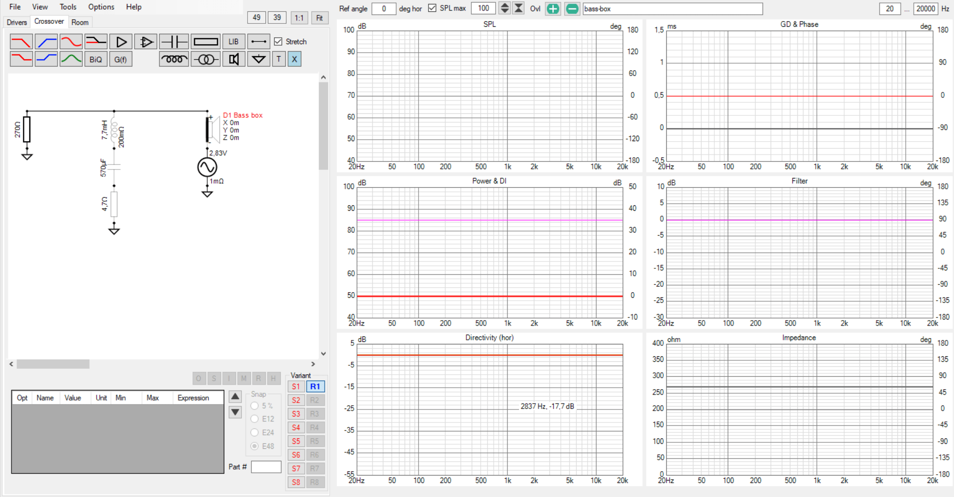

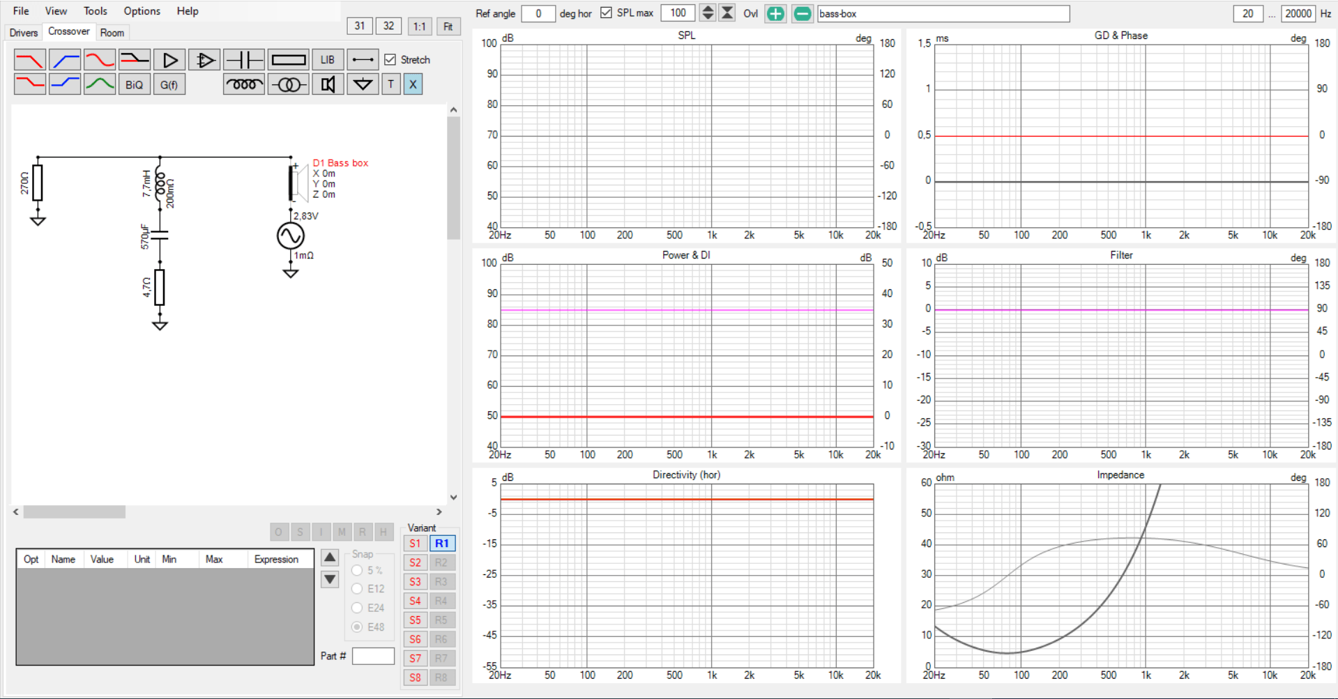

You are right the parallel passive components, shunt network, diverts some current past the driver because its impedance is smaller than through driver. Less current from amplifier flows through driver and response is equalized. But series impedance with voice coil changes as well, this is your error! Analyze circuit from voice coils perspective, for the damping current. The parallel network is parallel to the current amplifier output impedance, which reduces series impedance for the voice coil. In this sense there is now electrical damping, its not because of the amplifier but because of the low impedance parallel circuit. Its still probably too high for significant electrical damping though. See my post that demonstrates exactly this #681.
Circuit impedance from amplifiers perspective does not matter for the electrical damping. Driver does the electrical damping by self, as long as driver has low impedance load, low circuit impedance in series with the voice coil there is (some) electrical damping. It doesn't matter which amplifier there is if the impedance is modified with a parallel network there can be electrical damping, only thing that matters is the impedance in the circuit series with voice coil.
So, you are right there can be electrical damping with current amplifier, but it is due to using the passive parallel network. Main difference you see in the response is from the equalization, reducing current through driver. The electrical damping is not too great still because the shunt network impedance is probably several ohms at least.

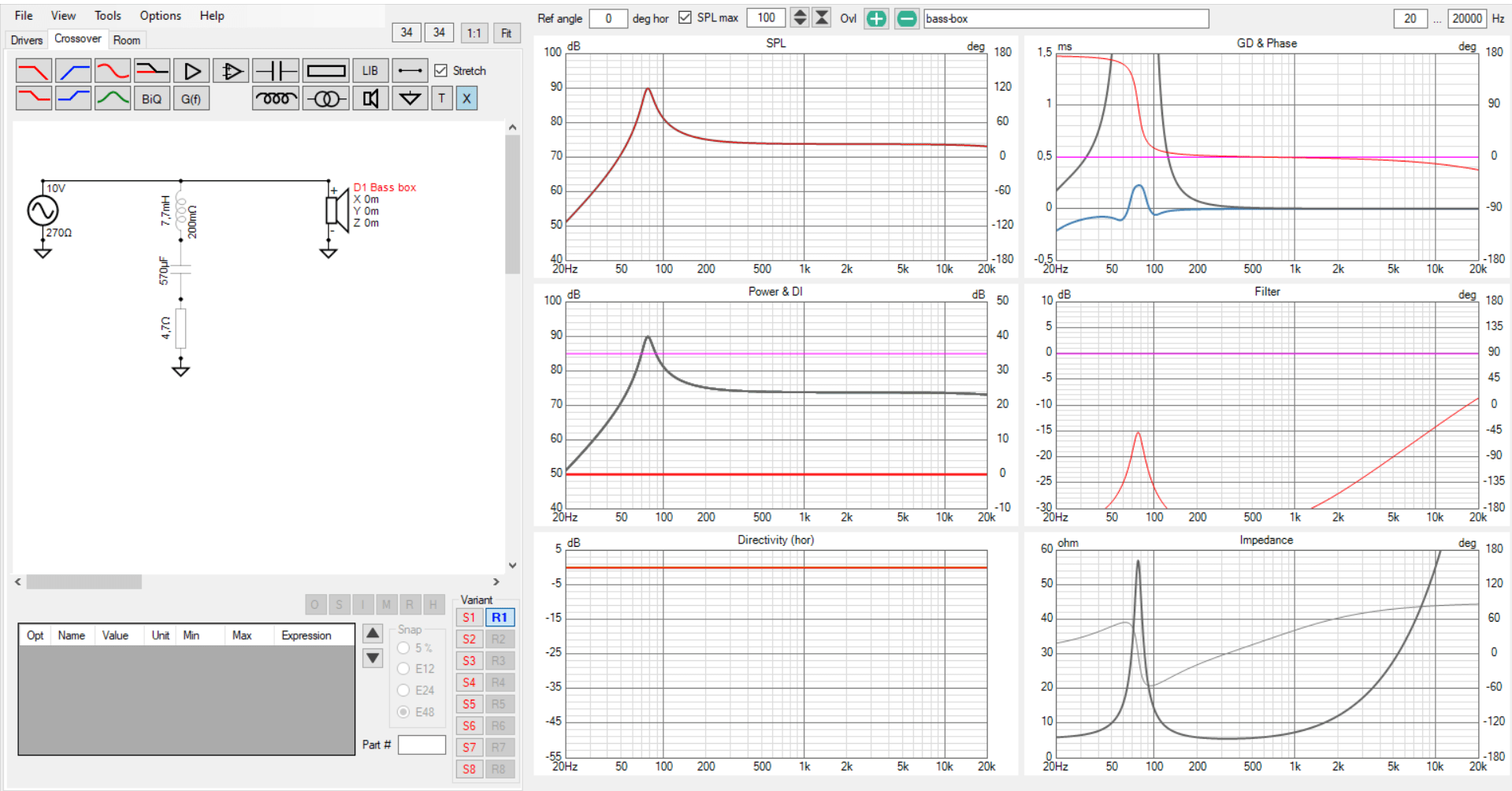

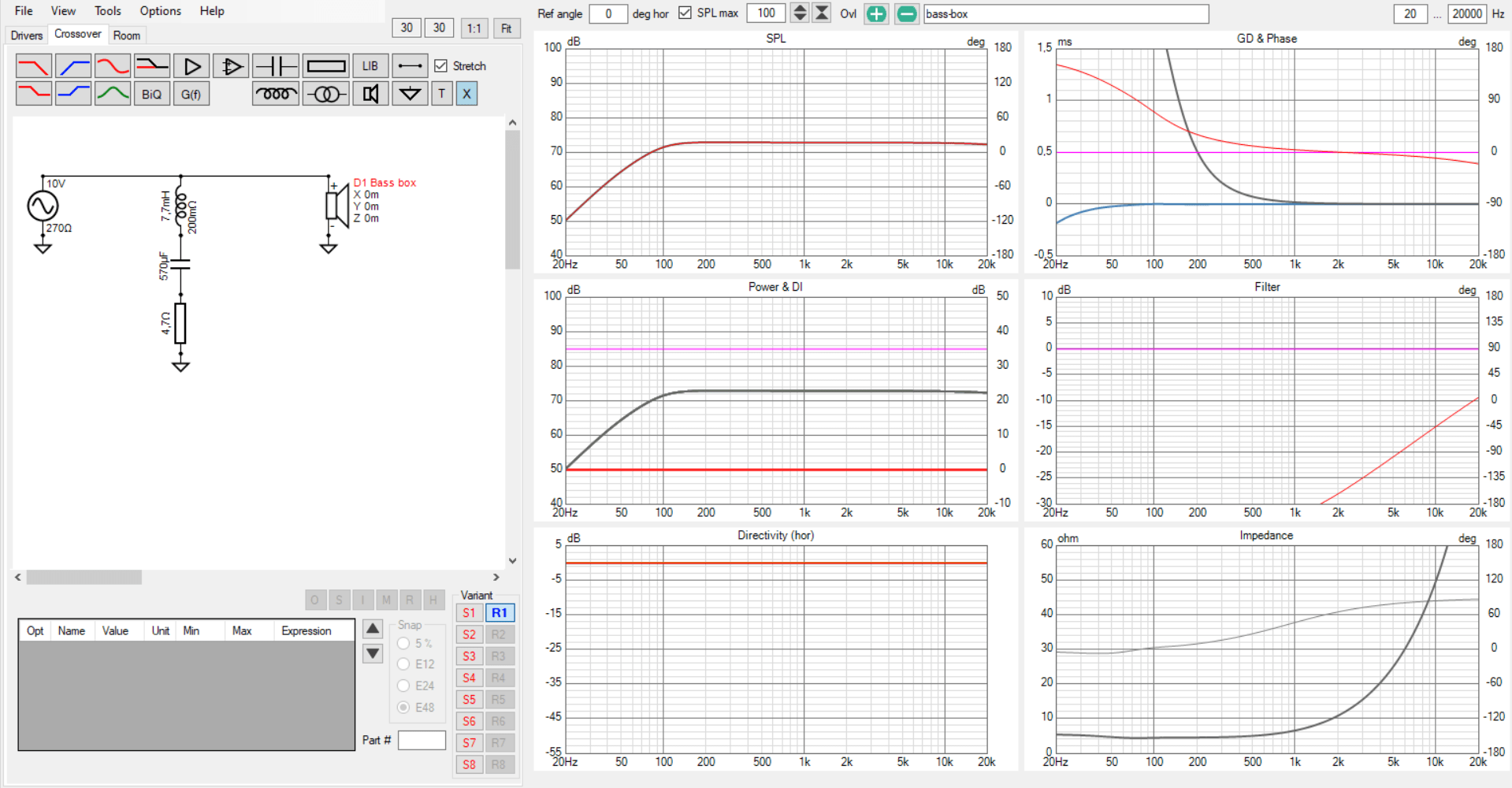

Here again, 270ohms outputimpedance "current amplifier". Peaking response at resonance, which is equalized with the parallel circuit in place.
Here is circuit resistance in series with voice coil, its lowest ~4.7ohms, while it allows some damping current to flow its not as great as if there was ~0ohms circuit through amplifier output impedance.
Without shunt, tadaa, no surprise impedance in seiries with voice coils is 270Ohms so not much damping current.
