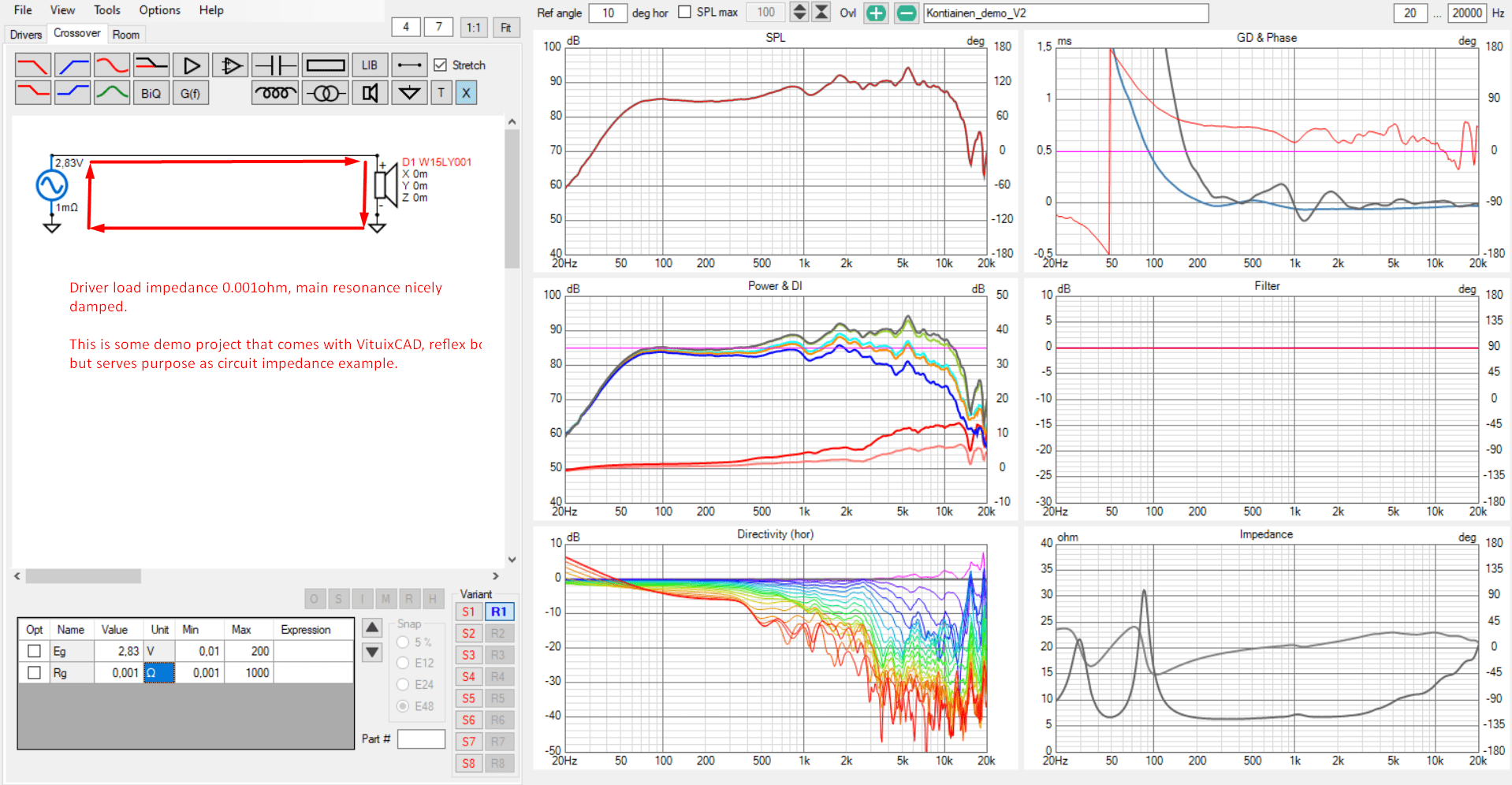

Sure, basic circuit analysis. Kirchows stuff, more current flows where resistance (impedance) is lowest. Its all about circuit impedance. Shunt network between amp and driver, when tuned to drivers main resonance peak frequency, is parallel with the driver and has much lower impedance at that frequency than driver and thus most current in the circuit flows through the shunt and response is equalized.
The same circuit can be also analyzed thinking about the drivers damping. You are right its not amplifier that does the (electrical) damping, its driver that does it by itself as long as there is low impedance circuit. When we have high output impedance on amplifier the damping current can flow through the notch. Amplifier damping factor is silly name, easy to misunderstand. We could also calculate damping factor for our passive filters and sell more speakers, I wonder why manufacturers are not utilizing this in marketing

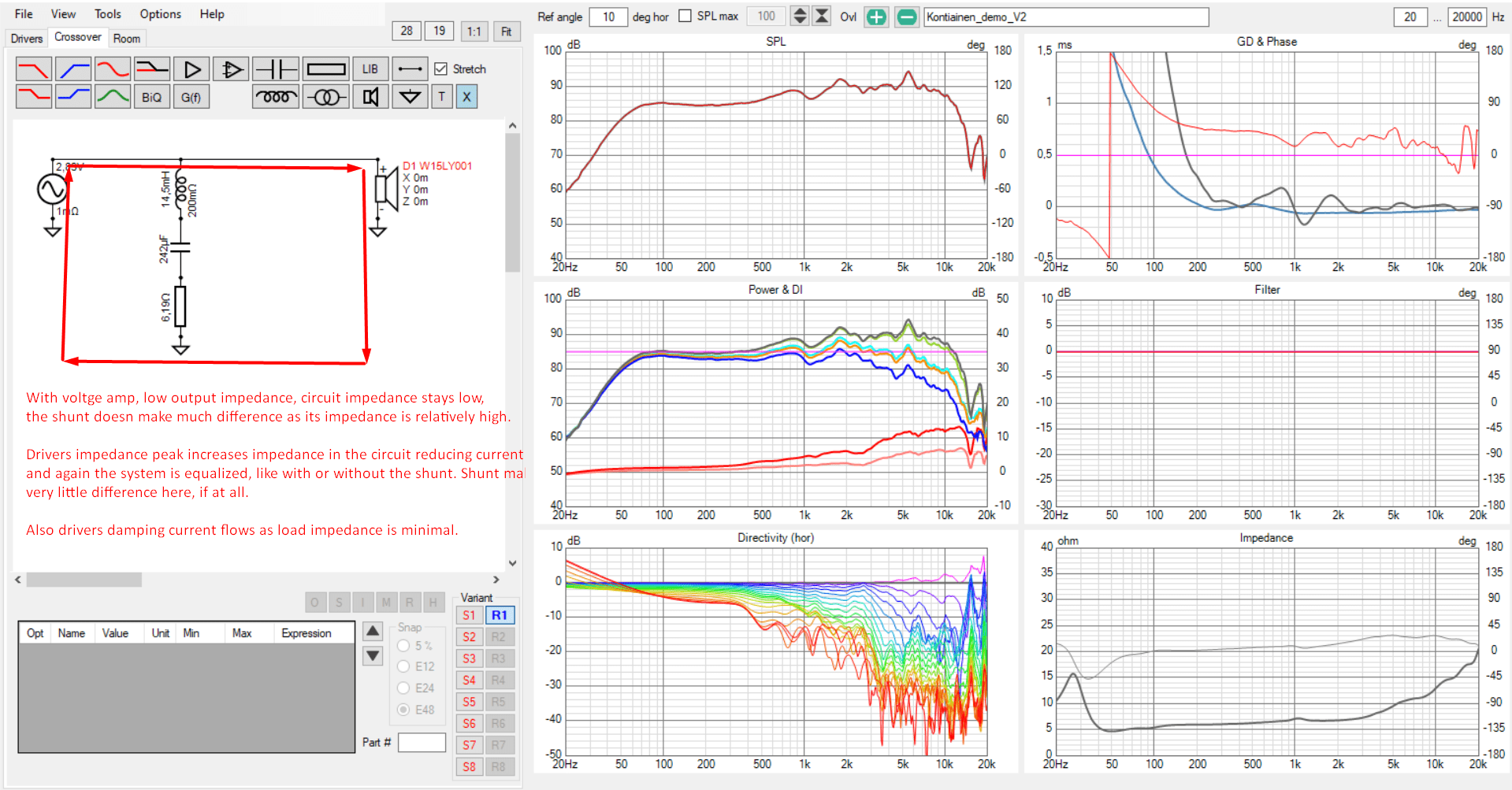

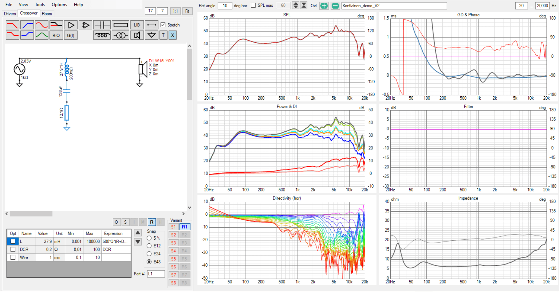

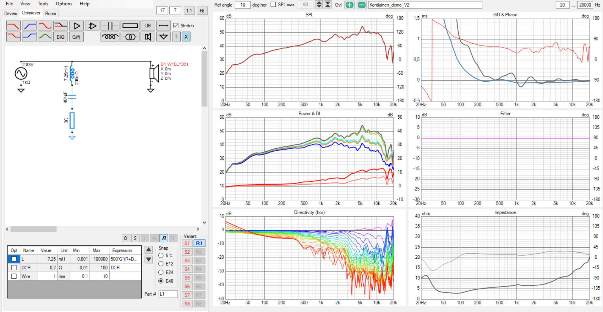

Here is example, high output impedance amplifier, tuning of the system Q just by altering impedance on the shunt, which determines how much current goes through the driver, and how much driver back-EMF makes damping.
After all the amplifier does not have any say on what the driver + box Q is, only the circuit impedance as drivers load determines it. Amplifier is just part of the circuit and partially affects what the impedance is for the driver to make the Q.
ps. pardon the examples are from a demo project that ships with VituixCAD. The lower impedance peak of reflex box can be confusing, it would have been nice example with closed box measurements Anyway, point is to demonstrate its the circuit impedance, not type of amplifier, that matters. We can manipulate circuit impedance for what ever we want, especially with active loudspeaker systems where any passive network can be tailored for impedance alone.

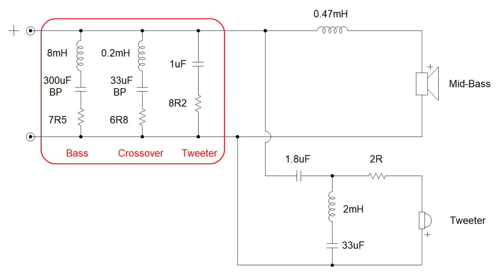

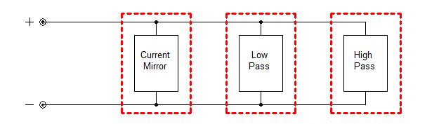

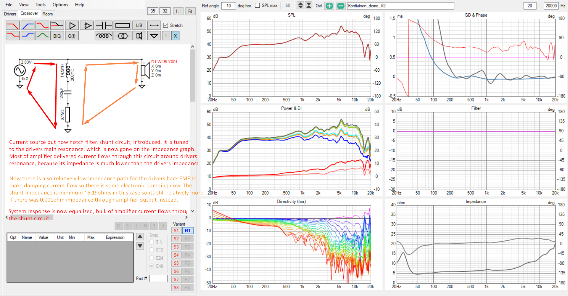

Oops the first image is wrong, text missing, and already got off from computer. Here is some text that ought to be there. In the first image its just voltae amp and a driver in a (reflex box). Circuit impedance is determined mainly by the driver impedance. Its high on drivers resonance, and rising with voice coil inductance. Excursion would modulate and so on. Back-EMF voltage can make current in the cir uit, so driver is daped on the resonance. Response is flat because current decreases because impedanve is high, given cpnstant voltage.
Yeah sorry about the sloppy example images, I could have drawn the orange back-EMF current into the first image as well, and draw it circulating opposing direction and so on, light red current through the driver with the shunt in place and so on
Anyway, VituixCAD is nice to experiment with this as it shows acoustic response. Acoustic frequency response is directly related to current through voice coil.

This knowledge of reducing driver motor generated / affected current works as distortion reduction mechanism can now be exploited quite easily on all kinds of systems. No matter current or voltage drive we can affect circuit impedance with passive parts. All we have to do is think what the impedance seen by the driver is and manipulate it. Of course some constrains are laid as we need to consider also impedance for amplifier load, what the frequency, how much amplfier current flows through driver, what the frequency response is.
Purifi has excellent example of parallel notch filter in series with a woofer to reduce (distortion) currents in electrical domain, which the cone resonance would amplify. Same EQ notch to equalize the cone resonance could be done with series filter, but it would not reduce distortion currents in the circuit.

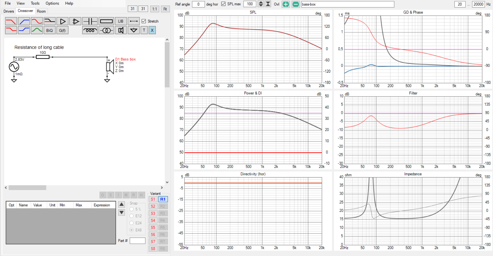

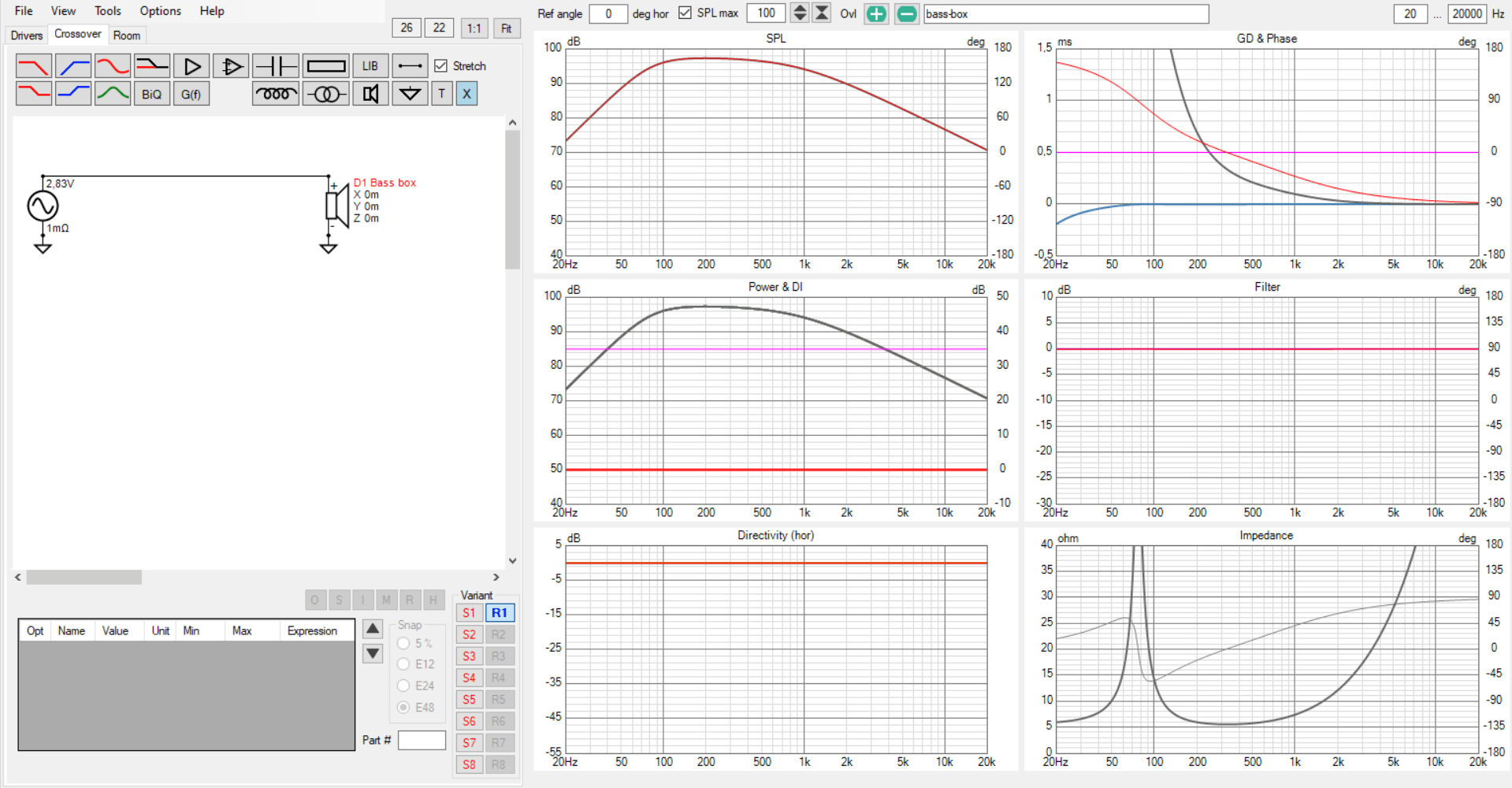

Found out VituixCAD enclosure tool can export simulated closed box SPL and impedance plots. Lets try something. These are examples with voltage amplifier, but they demonstrates what we can do by knowledge on how circuit impedance affects things.
Here is sloppy bass box, not very low frequency extension but fine as an example. Hooked to a class-D amp, not much impedance in the circuit apart from the driver itself so the driver back-EMF dampens itself at resonance. Box is dimensioned and damped so that system Q is nice in combination of the two, mechanical and electrical damping.

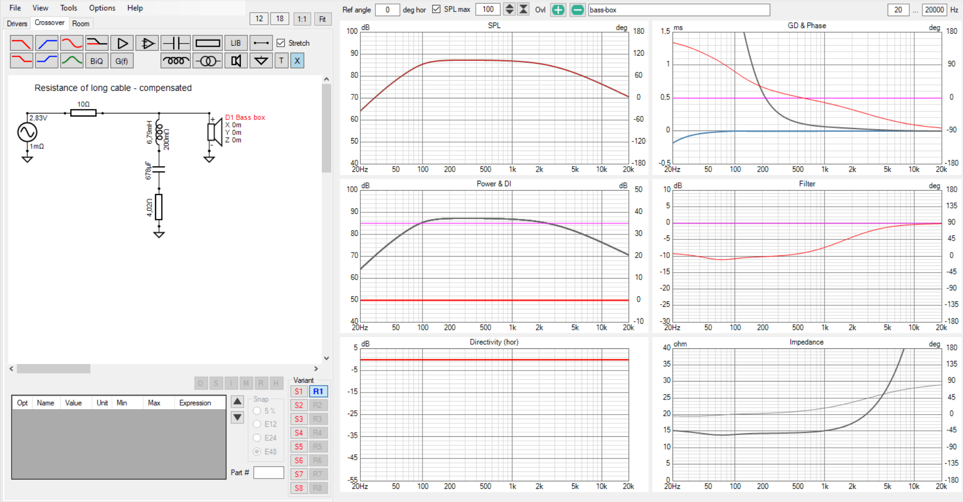

But, now the speakers are dragged on to the roof for garden party, long speaker cables. Resistance in the cabling appears increases impedance in the circuit and electrical damping of the driver is reduced. Back-EMF voltage makes less current in the circuit, driver resonates with less damping in the system, system Q has increased and we have a peak in the response.
But hey, we can just add low impedance circuit inside the bass box, with short wires, to allow damping current to flow! Nice, although expensive

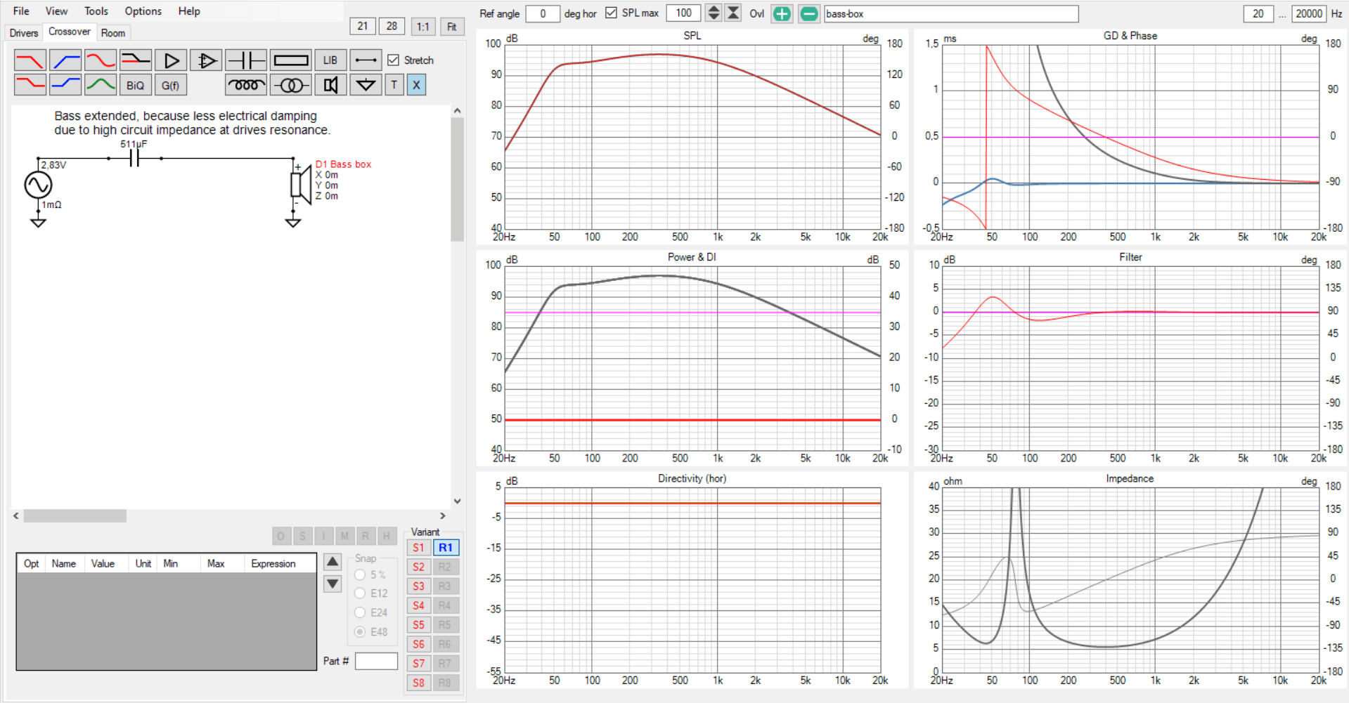

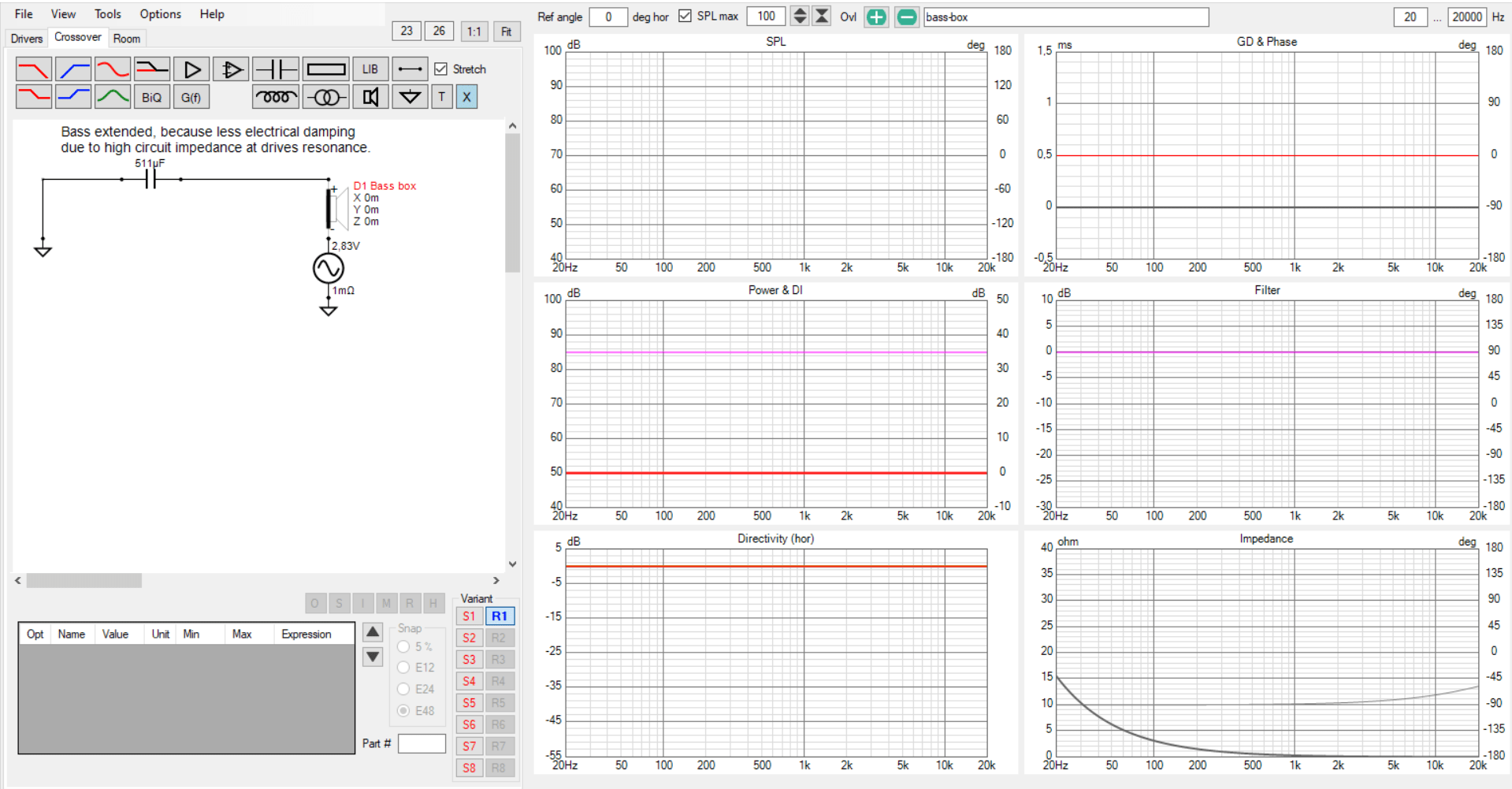

Ok, another example. What if we wanted the peak? What if we want to extend such box response by allowing the driver resonate some, reduce electrical damping, increase impedance in the circuit a bit? For sure, simplest is to increase the circuit impedance on low frequencies with a capacitor.
These are some practical examples how to utilize circuit impedance. These are for bass box, purifi example linked on previous post was for ~mids, woofers top bandwidth distortion reduction. How about tweeters then?

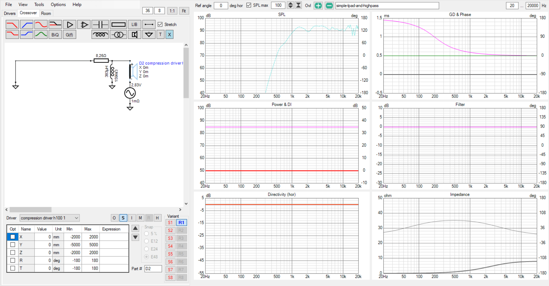

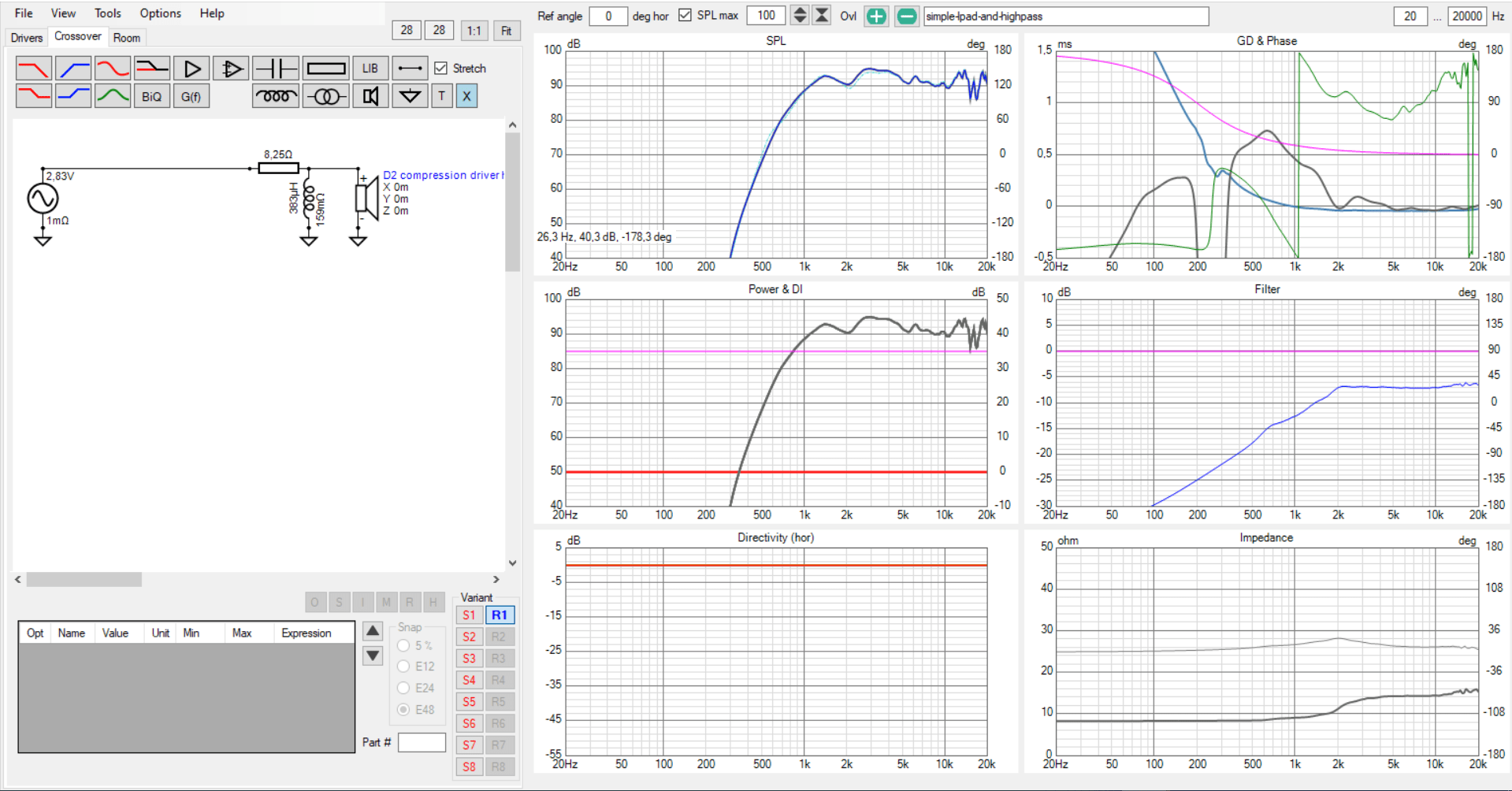

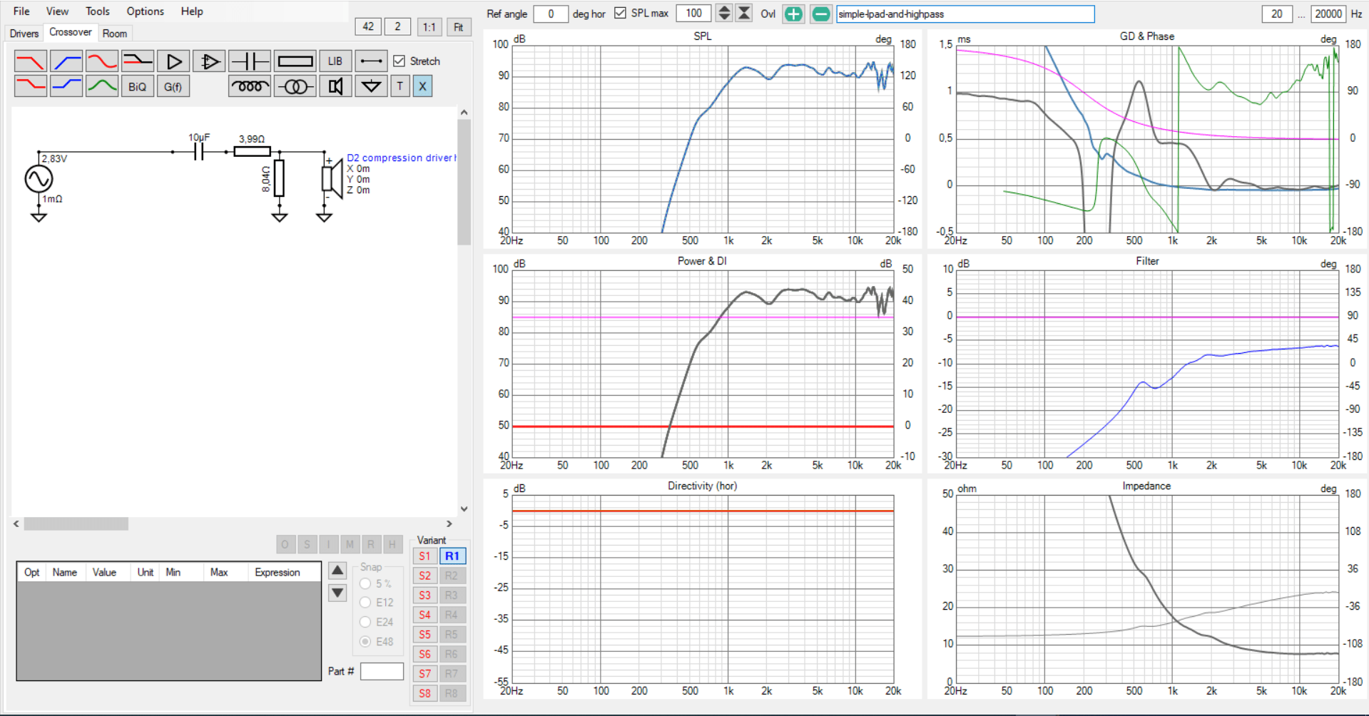

Here is two different ways to make a pad and simple high pass filter for a compression driver. Whats the difference, which one would reduce the horn to microphone bass and mids and possibly reduce distortion due to reducing the driver dome movement due to this external pressure affecting it?
Well, propably not too big of a difference in practice, not sure if I hear any. Anyway an example that a desired frequency response can be attained in various networks and the difference would be in impedance seen by the driver, which affects damping current and distortion currents.
On these above graphs all impedance plots show load impedance for the amplifier. To analyze what impedance there is outside the driver as drivers load, use trick from the Purifi paper, swap the source in place of the driver to see the impedance, short the driver if wish to see only what the passive network adds / does. Here few from the above

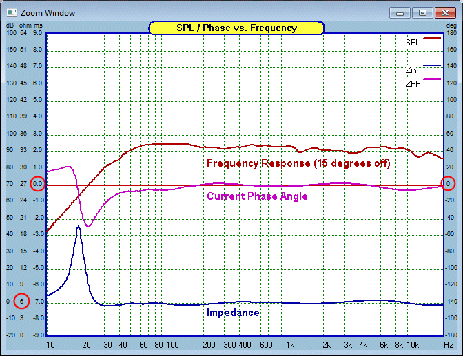

Here is example:
Here is how one example with well picked drivers worked:
Take this as a sealed box, with vented box it is a bit more tricky, but is does work:
