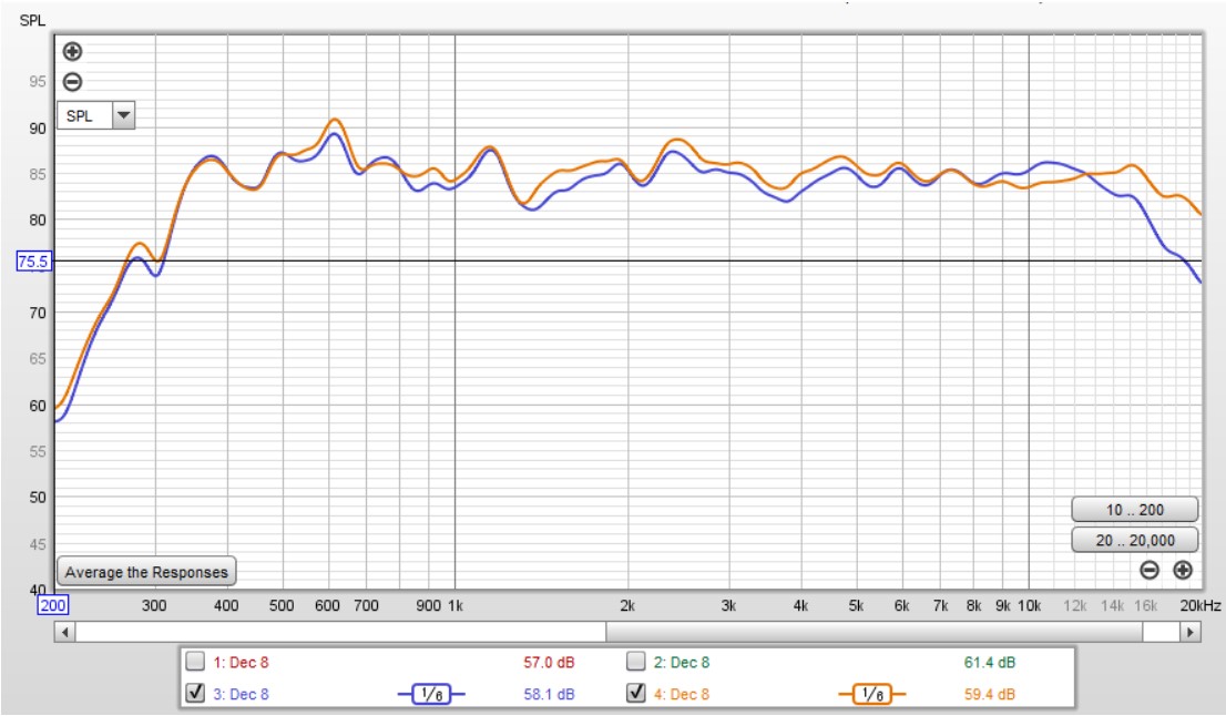

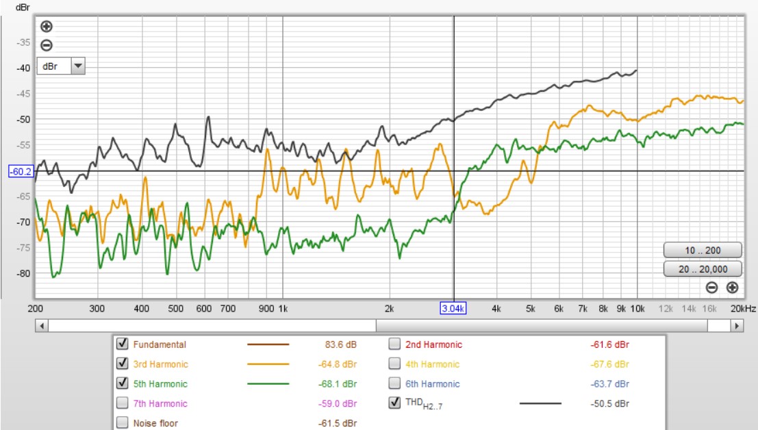

I've experimented with current drive and have seen improved acoustic distortion results over voltage drive in certain applications. Most recently using DML's (Distributed Mode Loudspeaker) with a single exciter (supplemented by separate enclosed woofers below 250Hz). I have found the acoustic distortion to be at least 5dB less above 3kHz using a current drive amp (compared to a voltage drive amp). See attached SPL chart, orange is current drive and blue is Hypex Ncore (voltage drive). Notice the "natural" EQ with current drive above 12kHz as the exciter's impedance rises. The second chart is the current drive distortion and the third chart is the Hypex Ncore distortion. The distortion reduction with current drive is most noticeable in the odd-ordered harmonics.
Thanks,
Dave

Don’t be excited to see current distorted under voltage drive. Current drives the loudspeaker, but especially at high excursion is worse than voltage usually. Magnetic field is likely way off at high excursions and stiffness is definitely very non linear. These non linearities are partialy compensated by voltage drive. At higher frequencies lower excursions other nonlinearities starts to dominate and that is where current drive helps.
Anyway both drive methods are not perfect, just both have advantages over another regarding the origin of distortion.

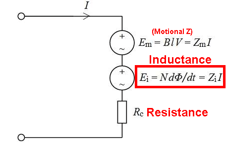

I would encourage people to have a look at the motor design of most speakers. Specifically, the voice coil height vs the height of the magnetic gap, and the materials that the magnet is made of. And also try to break the 'gross' voltage down to smaller increments along the length of the coil.
So, for a given voltage signal, there will be some voltages at the top of the VC, some in the middle where most of the mechanical forces are produced, and some at the other end. As long as the voltages are spread evenly, everything should be fine: the fraction of the VC that is located in the gap is like 2 auto-transformer taps whose voltage is a steady fraction of the total voltage applied at both ends, right?
But as we apply more detail to the inductor, we find that the incremental inductance is not the same along the length of the coil. The iron core interacts with the coil, giving it more inductance in some places than others. This means that for a VC divided into 3 equal lengths, the inductance will be different for each. What's worse, it will change dynamically as well when the coil moves around. The deflection of field lines in the core will also have an effect, so there could be a range of different inductance curves for the same mechanical position depending on the signal strength. So the voltage (and current) across the sound-producing part in the middle will be modulated by the excess inductance of the overhanging parts.
If we could run a couple of taps off the VC to measure those inner voltages, we could see that they vary in spite of a voltage amplifier's best efforts. The trick with so-called current sensing is that the current through the sense resistor is (likely) a much better approximation of the current in the middle of the coil.
Some speakers try to improve on this state of affairs by short-circuiting the over-hanging inductance with copper loops. This ought to make the inductance more consistent along the whole length of the coil, so it acts more like it's underhung. But it still seems like a stop-gap measure, and probably introduces other problems like parallel paths for the current to go through, in which case it's not measurable with just a simple resistor.
Edit #2, actually I'm not entirely sure about the last part about adding copper around the VC. It seems like electrons in the secondary winding get pulled in the same direction as in the primary, and the field lines partly cancel out, reducing the overhanging inductance. But in doing so, there is a braking force (Qms goes down), which could also be prone to modulation.
Oh, this is a wonderful topic. I would like a discussion on this very much. There is something that is hidden in open sight there and it is delicious.
On average, only around 30% of the length of the VC is in the gap. The inductance we measure across the entrire voice, pretty much is only developed in that gap, only that part of the VC.
I think that it is OK to model the VC as if it was a single layer. For simplicity's sake. There is good precedence for doing so, as we model the inductance as a lump is series with the DC resistance of the VC and also the motional impedance.
[Apologies to Esa Merilained, Red added.]
It makes it easier going forward, but I do have some interesting things to say.
