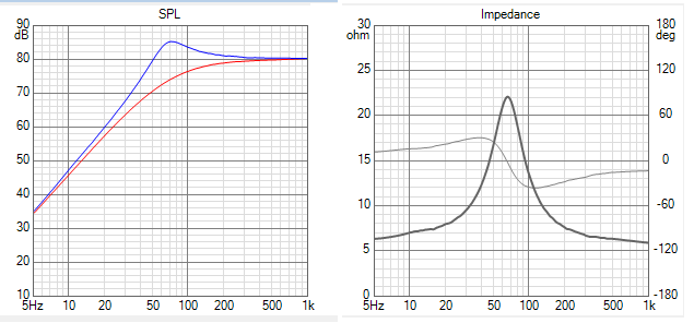

Aperiodic has little to do with Q. You are trying to flatten the impedance resonance. It is aperiodic if there is no bump. Hard to get all the way there.
A current amplifier provides little or no electrical damping to the loudspeaker so the Qm. If you use an amplifier with infinite Rout and the driver in an infinite enclosure the low frequency response will have box Q the same as the mechanical Q.
So if you can find a driver with Qm 0.707 then you can get close to that in a large enuff box.
In practical terms we can find driver swith Qm as low as 1.3, 1.4. Say up to Qm = 2. The driver will be peaky in a sealed box. Aperiodic damping is an attempt to lower this — ie add more mechanical damping to the driver.

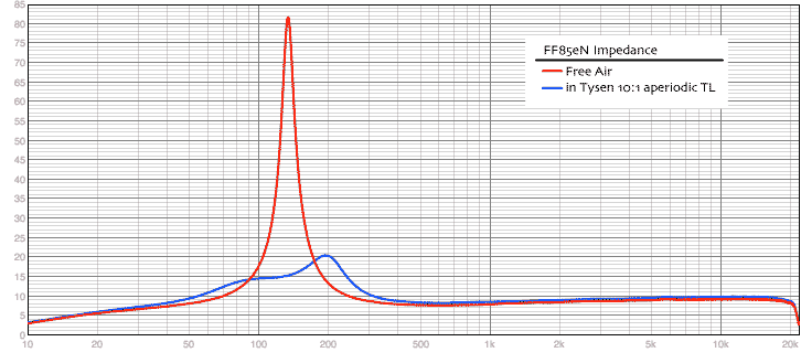

Acoustic damping of a speaker
You wish to kill the resonance of the speaker and that's where you need some effort.
In his book Esa Meriläinen showed that strips of cheap cotton fabric may be effective if you stuff the box with them.
Here is a quote from his web page:
It is obvious that there are plenty of possibilities and options. One is a damped acoustic labyrinth / transmission line inside the speaker enclosure.

FAQ about current-drive | Current-Drive - The Natural Way of Loudspeaker OperationOn pure current-drive, the effective Q value is determined solely by the mechanical Q of the system. As all available speaker drivers are designed to work exclusively on voltage drive, their Qm values are usually too high for current-operation as such. However, it would surely not take long to develop self-damping drivers if only some effort were put to it. Even now, there are rubbers that yield free-air Qm values of around 1.5; and according to tests with cotton cloth enclosure stuffing, the final value can yet be considerably lowered from this.
Often it is not even necessary to reach to the 0.7 since with a slightly higher value, the mild boost that develops in the 100 Hz region can be used for benefit to compensate some part of the baffle step.
Below are shown the drawings of a closed transmission line enclosure with a screw-openable back wall, managing the damping of the driver's fundamental resonance. The cabinet consists of a 2-litre chamber attached to a little over 1.5 m long, 9-layered channel, which, when suitably filled, forms the acoustic load resistance needed by the driver for the management of the bass resonance and optimization of the response. Besides, thanks to the interior walls, the cabinet is excellently rigid.

If you want to do a comparison you should use a loudspeaker with a “flat" impedance curve.
Then no EQ is needed. Like how does one actually decide where to set the EQ?
