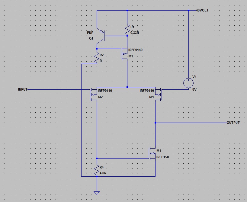

it works OK.
I have not had time to study the LT-spice program any more. I had to make dinner.
I believe the voltages are a little off in the simulation. The output is not centred in the middle as the voltage-swing would clip unsymmetrical. There is more "wasted" voltage in the bottom part of the circuit due to the sensing fet and resistors setting idle current.
The fet sensing current through the amp is a logic gate IRL510. I have two volts Vgs setting the current at 2/1,5 = 1,333 amperes.
It sounds much better then my QSC RMX 1450 and my old Mission Cyrus amp. Much cleaner with much better separation of the instruments etc.. I run my large BIB with a B&C 10PS26bass driver and a small 3 inch Faital pro fullrange driver.

(R2 should be 0,5 R)
This could be an idea for a simple reasonable linear high output impedance amplifier. It is a inverted Triadtron with a folded cascode pushpull output stage.
This is a very simplified schematic. Only the bare essentials to show the idea.
Johannes

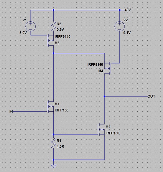

And the last variation of a current drive simple class A amp, based on the Triadtron concept from Tubecad.
It should have a decent linearity (i hope), high output impedance and sound really nice. I have not built it yet, but i hope i can test a simple crude version next week.
I am slowly learning to simulate circuits with LT-spice.
Thanks Pawel for showing me LT-Spice!
Johannes
