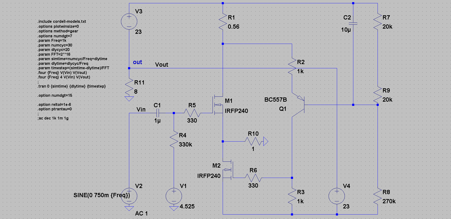

Today i modified my latest 3 watt Triadtron to have an very high out-z. I did not measure it but i guess it is 500 ohm or so (i have a 1 kohm resistor from output to ground to bleed of any voltage from the output capacitor). I tested to drive my MLTL (Beyma 12P80Nd) from one channel of my QSC RMX1450 with 470 ohm resistor in series, and it sounded very similar. It had the same elevated response around Fs and in the treble. My Triadtron was much louder and had a much more lively and smooth silky midrange (vocals and piano).
It is not difficult to have an extremely high output impedans. I don't have any global feeback and very little voltage gain to begin with. No problem driving anything from a dead short to parallel resonant circuits, loudspeakers and LEDs pulsing with the music.

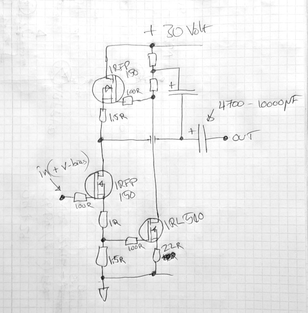

Hi
Please show the schematic, if it is not a secret
No schematic right now. It is a work in progress and i am constantly changing things and testing new ideas.
There is a lot of information about the Triadtron on Tube CAD Journal It is the inverted Triadtron with voltage gain i am using as a base for my experiments.
Johannes

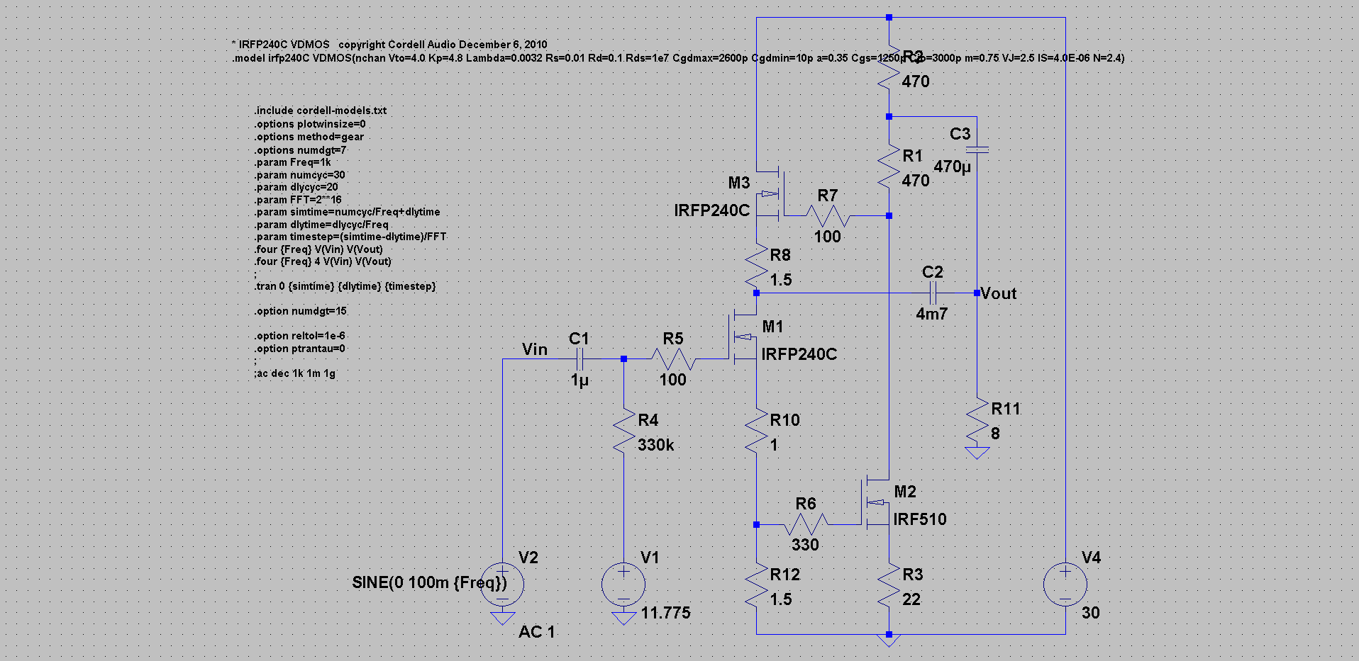

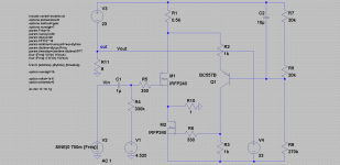

What program are you using for those nice schematics Pawel?
I have no experience of Spice (drug or electronic simulation). I have tried once many years ago, but all the "experience" i got was a feeling of absolute helplessness and despair..
The "Triadtron" is a really nice circuit in real life too. I have built a few and they work admirably. Stable. Low distortion (only by ears).
This is the inverted Triadtron. Q1 is a IRFP150 with the drain instead of the source attached to the output.
Johannes

ltspice
LTSpice from LT http://ltspice.linear-tech.com/software/LTspiceIV.exe
free and realy fine, the learning will take you not so long, Mooly created fine thread in "Software tools" @ diyaudio: http://www.diyaudio.com/forums/software-tools/260627-installing-using-ltspice-beginner-advanced.html

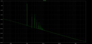

for playing

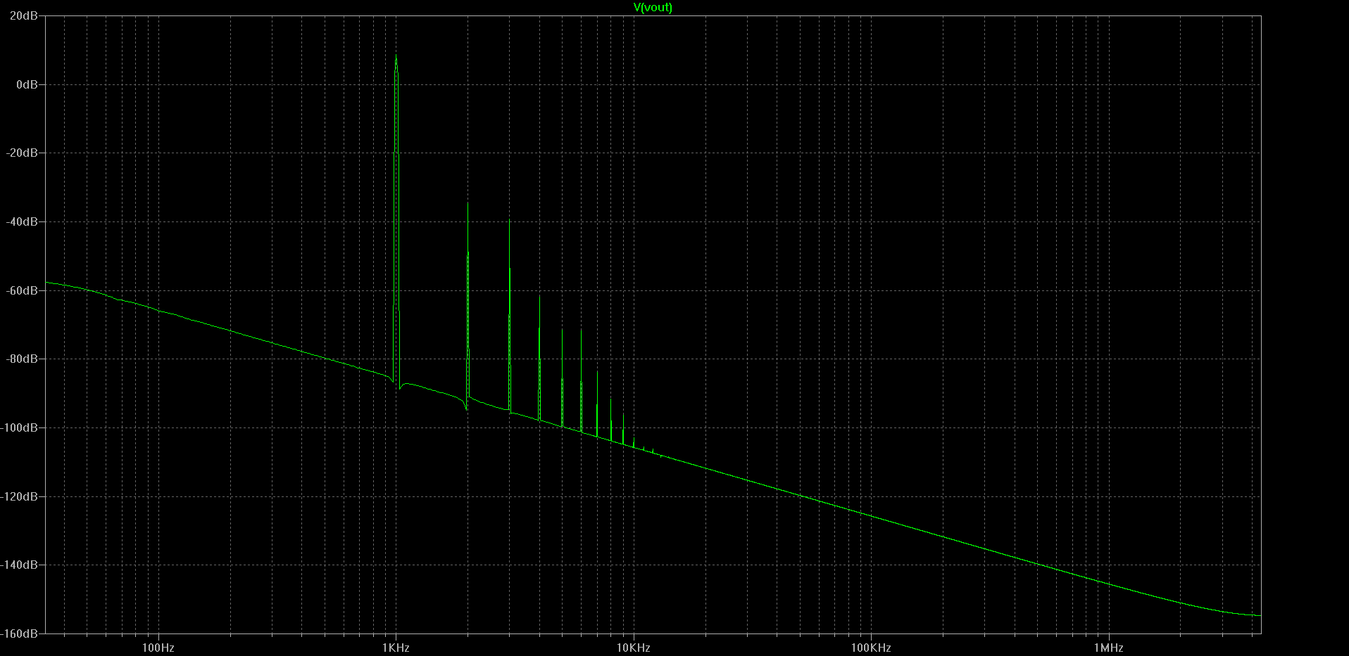

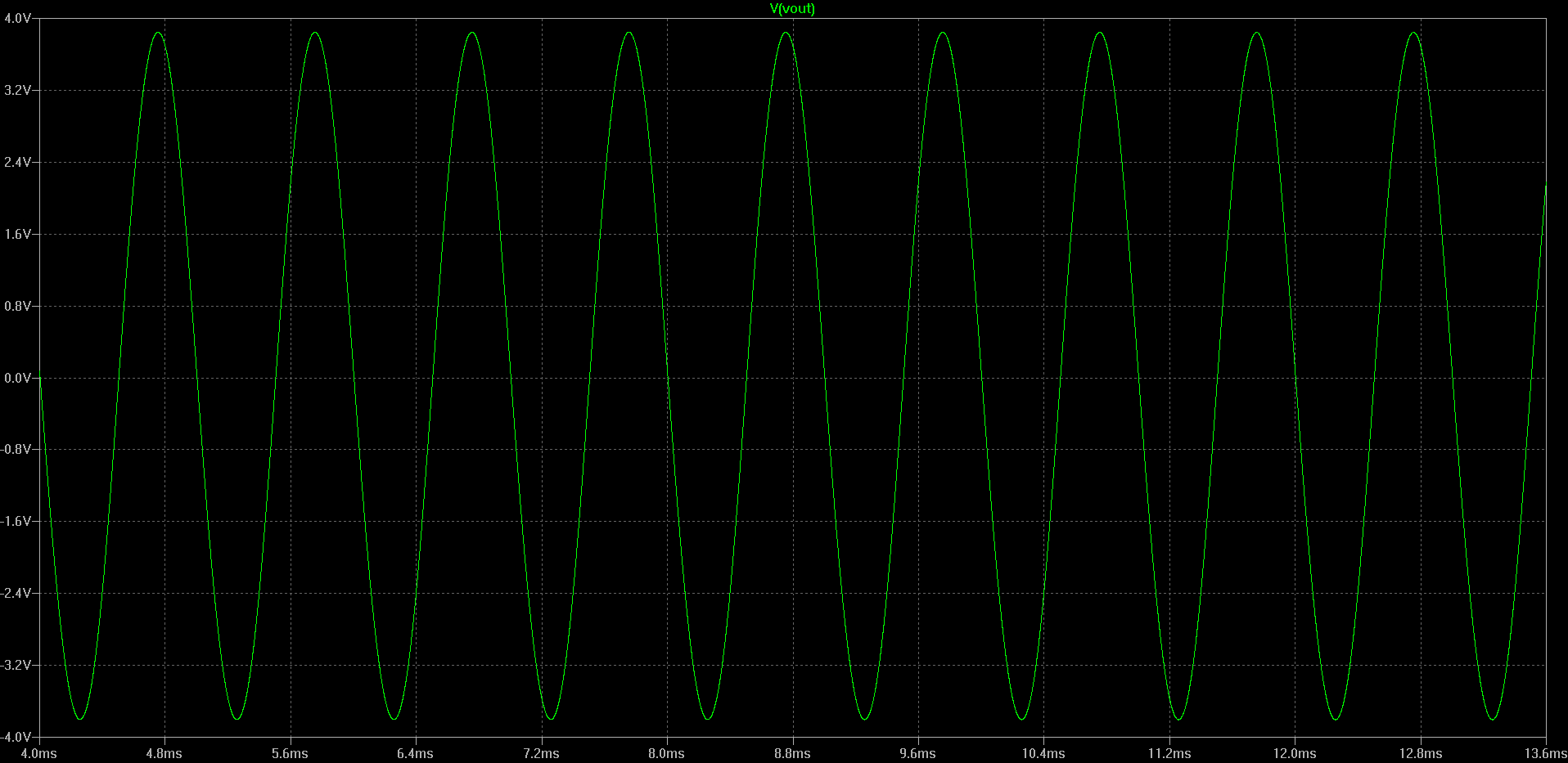

Hi Johannes
Attached you will find asc file with your amp for playing with,
it contain the models and should work just after installing LTSpice.
have fun!
