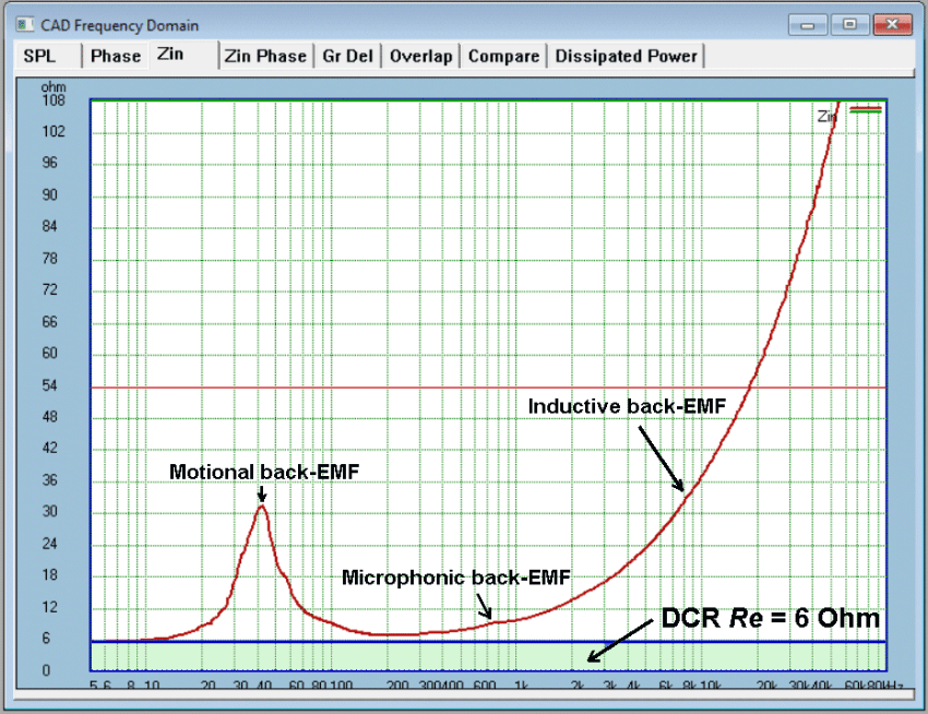

The LF spike is the motional impedance. The steady rise from around 200 Hertz and up in the inductive impedance.

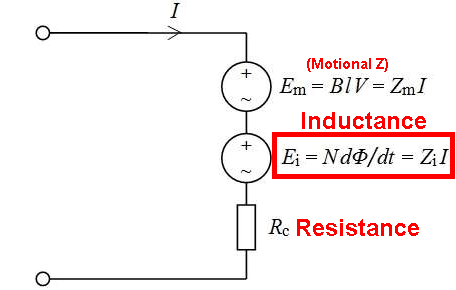

They were shown earlier as:
The three series components are seen in a standard impedance plot:
Motional back-EMF, same as Em, also known as the motional impedance. Not that being a form of back-EMF also means that it is a voltage [EMF] source that shows up as an impedance in the impedance plot.
Inductive back-EMF, same as Ei, also known as the inductive impedance. Again a back-EMF that shows up as an impedance and is also a voltage [EMF] source.
Resistance, same as Rc, the DC resistance of the voice coil and is constant with frequency.
Note that they are all in series and adding up. At LF Em dominates and higher up Ei dominates.
Here is a slight complication as it seems not to show up in the model above. This is the Microphonic back-EMF.
This usually does up in the area (frequency) where the inductive impedance operates. It is usually caused by imperfections in the driver or it can also be caused by the box design where box resonance can show up in the impedance plot.
What happens is that any imperfection in the speaker system can make the inductive impedance unstable.
Then the whole impedance stability is affected because all the elements are in series.
The impedance can be modulated by a number of things, including driver design, box design, ostensibly crossover design can have both positive and negative effects on it (I posit that 1st order crossovers can stabilise the inductive impedance and other crossovers do not, but that is another topic).
So it can be seen why microphonic back-EMF is incorporated inside Ei inductance. This is the main cause of instability. Also excursions can cause the indctance to rise when the cone goes in (+) and go down when the cone goes out (-).
There is a lot more to be said, but what we see is that the stable impedance/resistance of the VC is made unstable by Em and Ei.

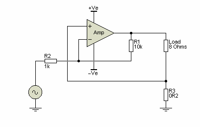

The result is that impedance modulations = current modulations when the amplifier is a voltage, but not so much with current drive.
This is why the current source in various measurements, some shown online, indicates lower distortion. The force-factor is related to the current of the amplifier and not its voltage. Mentally sorting this all out is not easy.

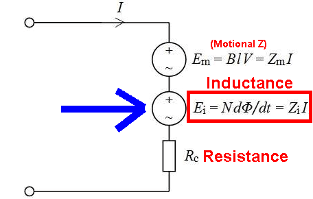

As for inductance only really showing up in the gap is logical?
The part of the coil (Xmax) that sticks out at of the gap, will act more like a wire-wound resistor than an inductor. The gap is where the magnetic circuit is focused and also where the force (causing sound) is applied to the VC. So websites like Purifi Audio, the connection is often made between that force and inductance, as being related.

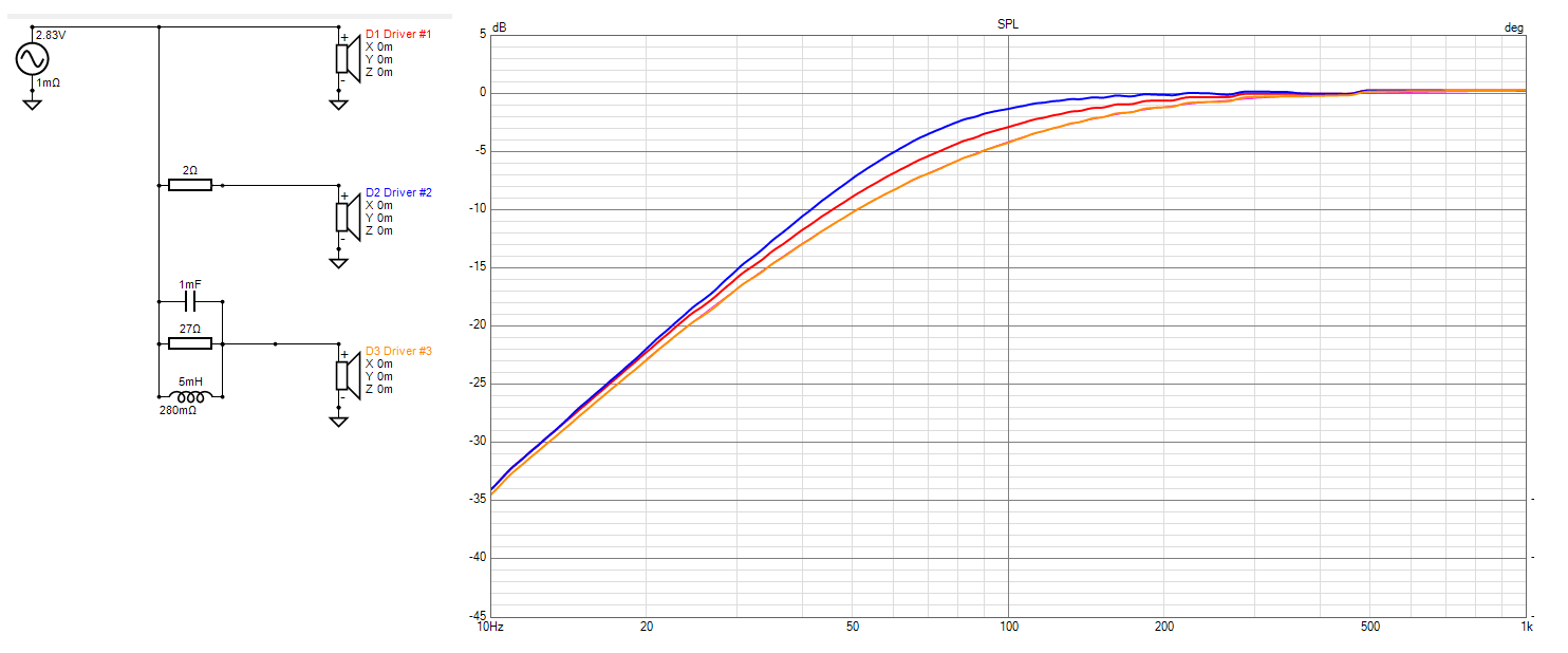

Not so. Here's the series version. You can lower the Q from a Voltage source with no insertion loss...

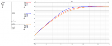

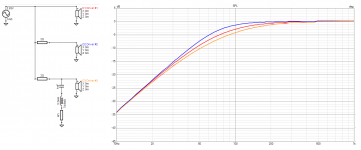

AllenB shows shunt network in post #666, if it is tuned the driver/box resonance it lowers Q. Its parallel with high amplifier output impedance, a low impedance path. Circuit impedance seen by the driver is now (mostly) through this low impedance path and not through high amplifier outout impedance, around frequency where the notch is tuned to.
The shunt is parallel to driver as well and some amplifier output current flows past driver as well, its a notch filter with high output impedance amplifier.
Works with a voltage source!
Forget it then.
I thought this thread was about current drive. Yes I am familiar with all that clever stuff (I don't need somebody how to create a negative impedance amp, thank you very much), it's all well and good, but I thought it was reasonably obvious what I said and in the context that I said it. I was trying to guide the conversation down a certain way, but that seems not to be possible.
I will ask it again: Can you achieve the same thing with a current source?
Yes!

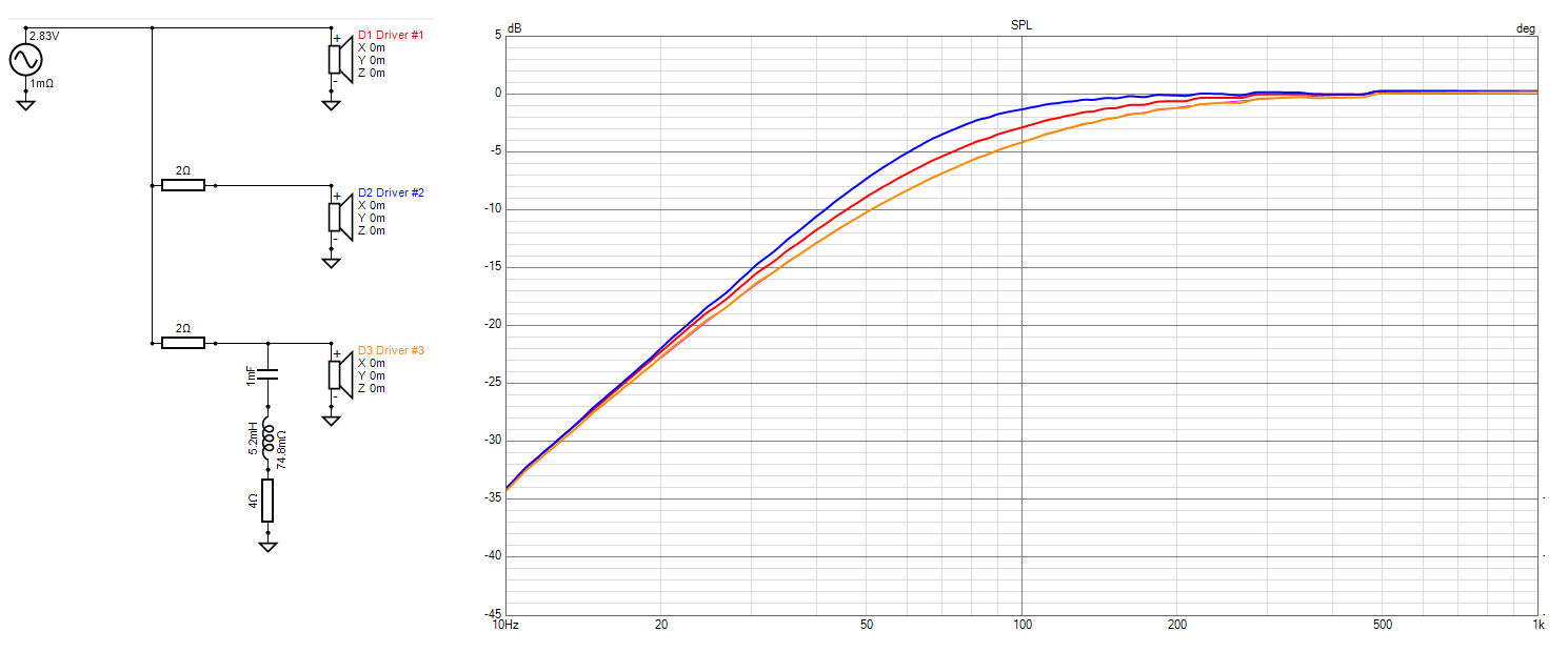

Say that I disagree. Would this demonstrate that? (Naturally, the red driver#1 has been level shifted -2dB)
I agree that it is a neat trick. But this is still a voltage source, so some would say that the amplifier still has damping because it is a voltage source. I would disagree.
But you did something else not obvious. Think about, and the phrase that I used earlier, that damping is related to current versus frequency. Analyse what your tuned network did on the current side of the amplifier. And the fact you are using a tuned circuit, bravo!
If you could do the same with a current source, then you have proven that damping has nothing to to with the amplifiers output impedance.
This is what I am getting at. The idea that the amplifier provides damping would be disproved if what I am saying is right. Surely the day must come when we say that amplifiers have any real say in the damping as such. Indeed, as your example shows, by manipulating current versus frequency, you have shifted the alignment, and very cleverly at that. But the real damping LF wise is totally defined by the alignment of the speaker and not that of the amplifier.
