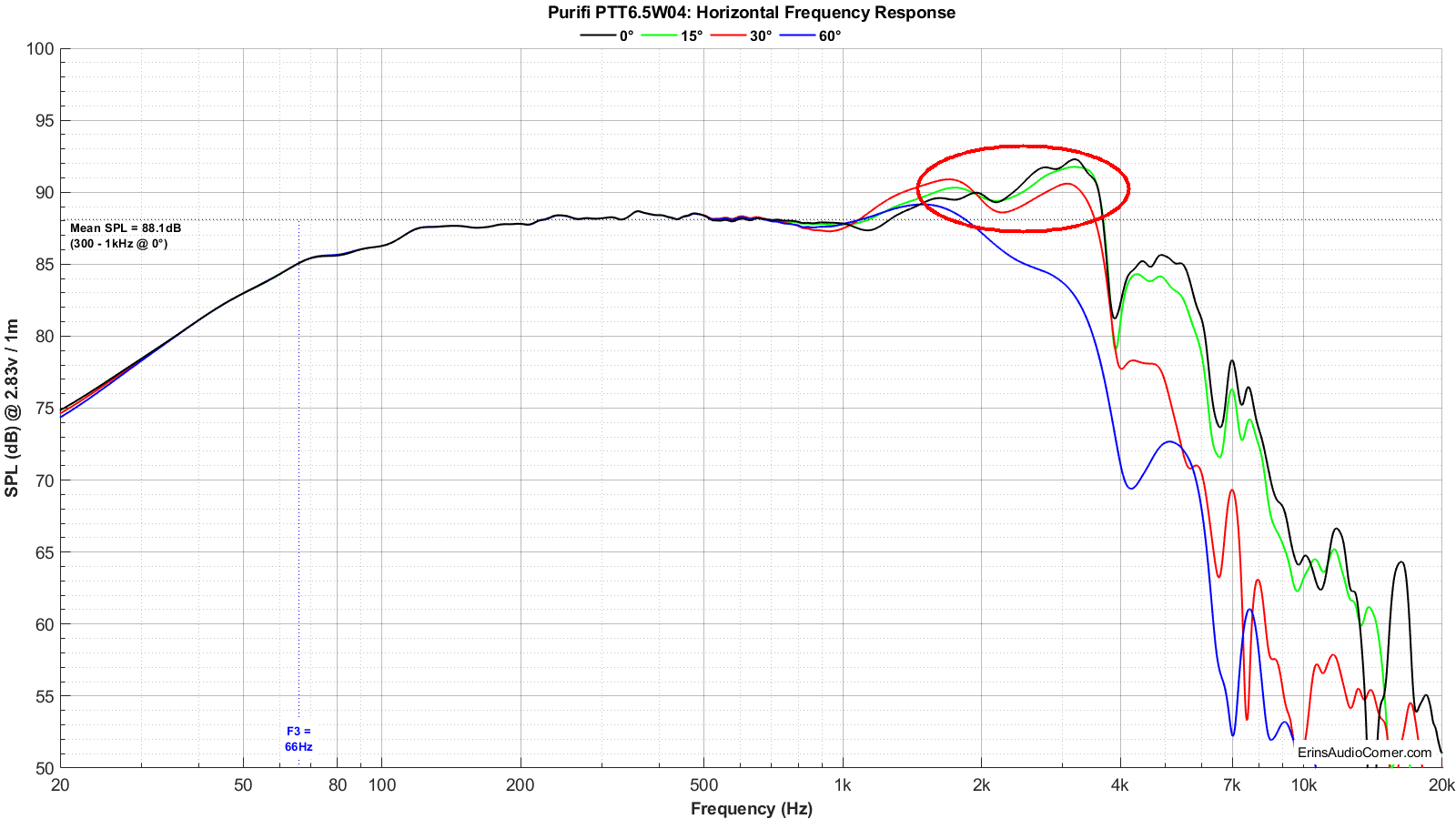

I realise of course that this was about mass limiting acceleration and bandwidth and that I was quoting a throw-away-line that was added about damping factor being a myth. I stopped using the myth word because strong language like that puts some people off; but still thought it was a myth. I have now gradually gone back to using it again and seeing it on the blog was a good thing.
But this raises something else that I am curious about. Yes we know that mass, acceleration and bandwidth are related, just as the blog describes, plus the myths about lighter cones being faster etc. The Purifi cone is not light mass and as long as sensitivity of the '6.5W08' is up around 88dB (and I have measured it and it is), then I have no issue.
But I note that ring of mass behind around the cone periphery. It is of course hidden from view in use. Whether on purpose or not, that added mass and the reduction in acceleration at the edge of the cone (we know flat response requires flat acceleration), that it has this benefit of reducing the radiating surface area starting near 1KHz and up. You can see that in the frequency response at off axis versus on axis (see below), and at 3KHz how little the response changes over a 60° arc. And they keep staying close together over 30° arc, even as the response falls around 4KHz (also helped by inductance I would imagine) and up. It is something I have not seen in any driver that I have measured, or other drivers for that matter. I can't help thinking that this was deliberate design feature, so I am curious whether it just worked out this way, or was there more to it?
I might add that I use the tweeter to fill in off axis limitations of the midrange driver. So it is something I am very conscious about. Hence I look very careful at the beaming in the upper midrange. Hence also liking waveguide tweeters.

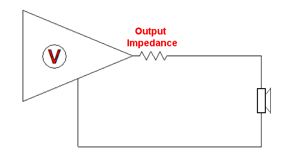

I think the core of it can be stated in just a few words.
The damping of a driver depends on the total source resistance its voice coil (as a generator) sees, and that includes the driver's own Re and any additional series resistance in XO coils and such. So we have always several Ohms here.
Therefore it doesn't matter at all whether the amp -- plus wiring -- has an output resistance of, say, 0.1 Ohms (a 4Ohms-DF of 40) or 0.0004 Ohms (DF of 10000), it is always a completely negligible part of the large total resistance available for cone motion damping. Very high output impedance does change speaker frequency response according to its impedance curve, of course, and if anything, that change is what is actually perceived rather than any alleged change in actual damping.
