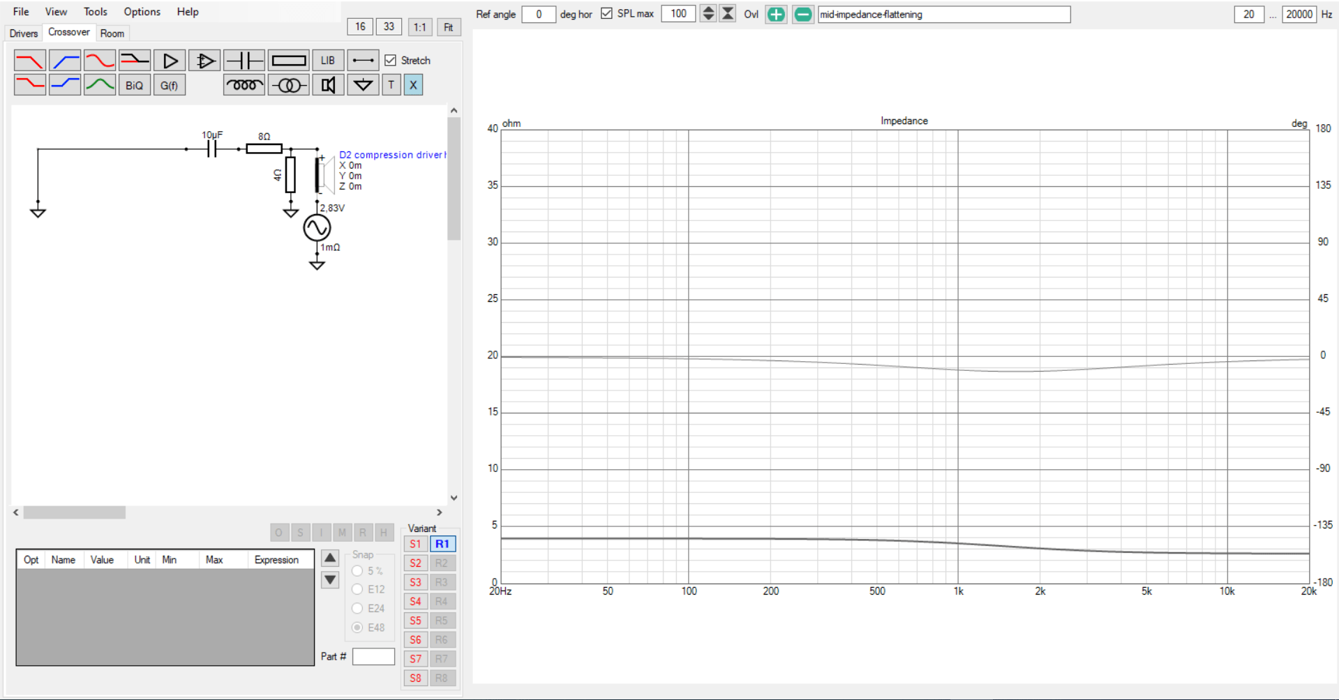

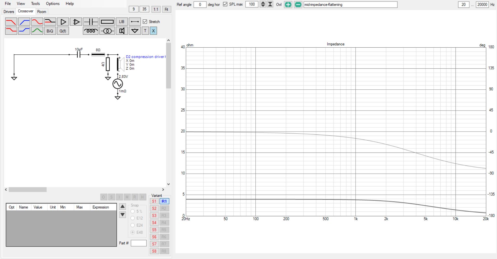

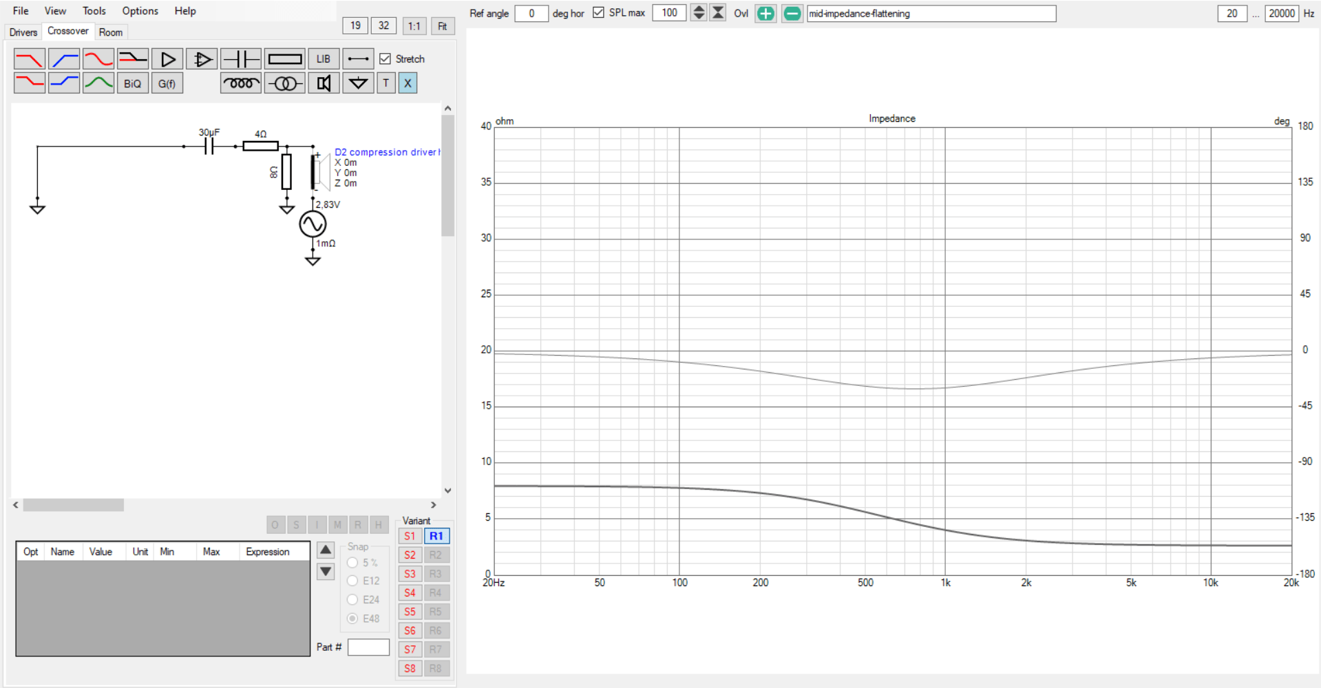

Here is example how you can analyze you situation in VituixCAD, replace amp with short and move the source (amp) next to driver so impedance plot shows impedance series with the driver. Plot the variations you've tried and see impedance for driver load. You probably want "low" impedance for driver resonance to dampen itself and "high" impedance to reduce distortion current.
Here are few of your variations as I've understood:
As you see impedance is reverse what we want. Its "high" on drivers resonance (low frequencies) reducing electrical damping and lowish on pass band allowing any distortion currents. On all these configurations.

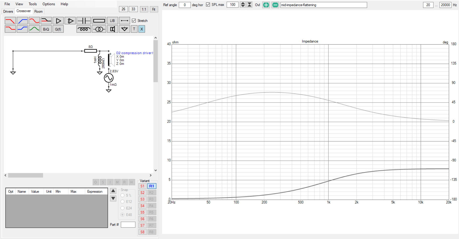

You can reconfigure the system like this instead. Try realistic values for resistor and inductor, I don't know what they are for your application.
As you see impedance as driver load is now completely opposite than with series cap + pad. Its low around drivers resonance allowing perhaps more electronic damping and rises above to reduce any distortion current. The coil in parallel provides low impedance path for damping current. Frequency response can be roughly similar as with cap + pad, see #685
While any / none of these might sound better than the others in you system and application, you just need to iterate them through to find out as KSTR suggested. I would configure your compression drivers side by side and listen them without rest of the system. I mean, setup one driver with your favorite settings as benchmark and then setup the other one with any of the iterations so that you can listen both ABX style. Adjust DSP to match the frequency responses within 0.5db or so. If you hear difference between the setups then you have a better sounding one. Otherwise you could use any of the configurations and call audible difference bias and be happy
