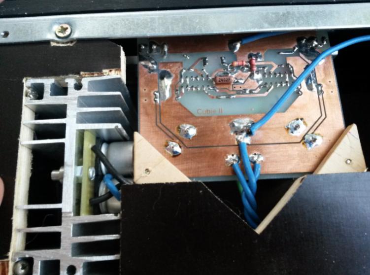

Anyway I just made the black and white based on your artwork
That PC board is a small cute design, I increased the size so all the 1/2W resister can feet , no need to stand it up al do that is not a problem at all.
I will build these amp to, that is main reason I mode the layout to feet my amp case.
I built several yeas a go a ProFet amplifier and I want to replace that with a newer design.
To be honest the sound of that already boring 😀
If someone want to use these layout ( I did not ask JUMA permission yet, I hope to post here is not a problem) you have to set up your printer to 136 to 138%.

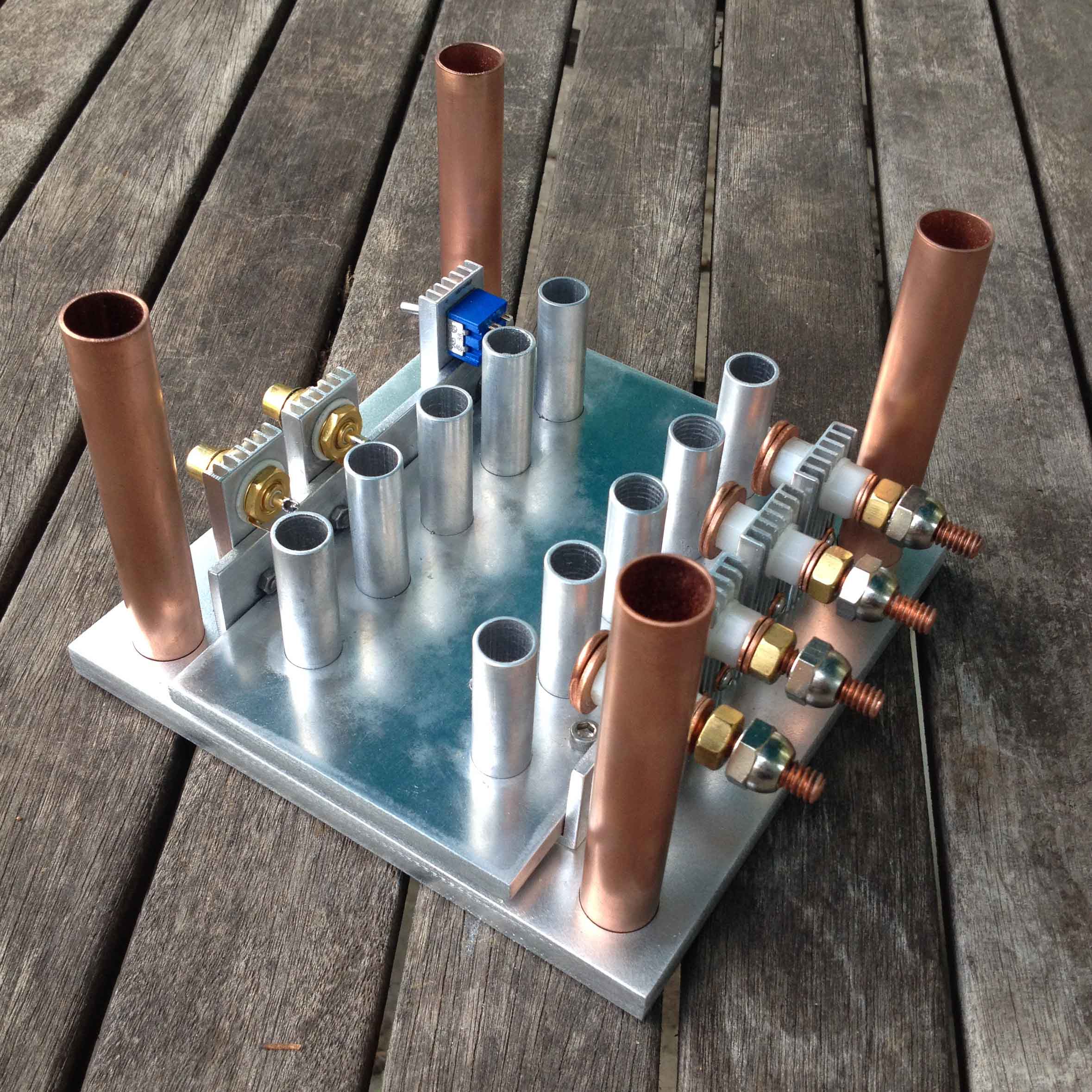

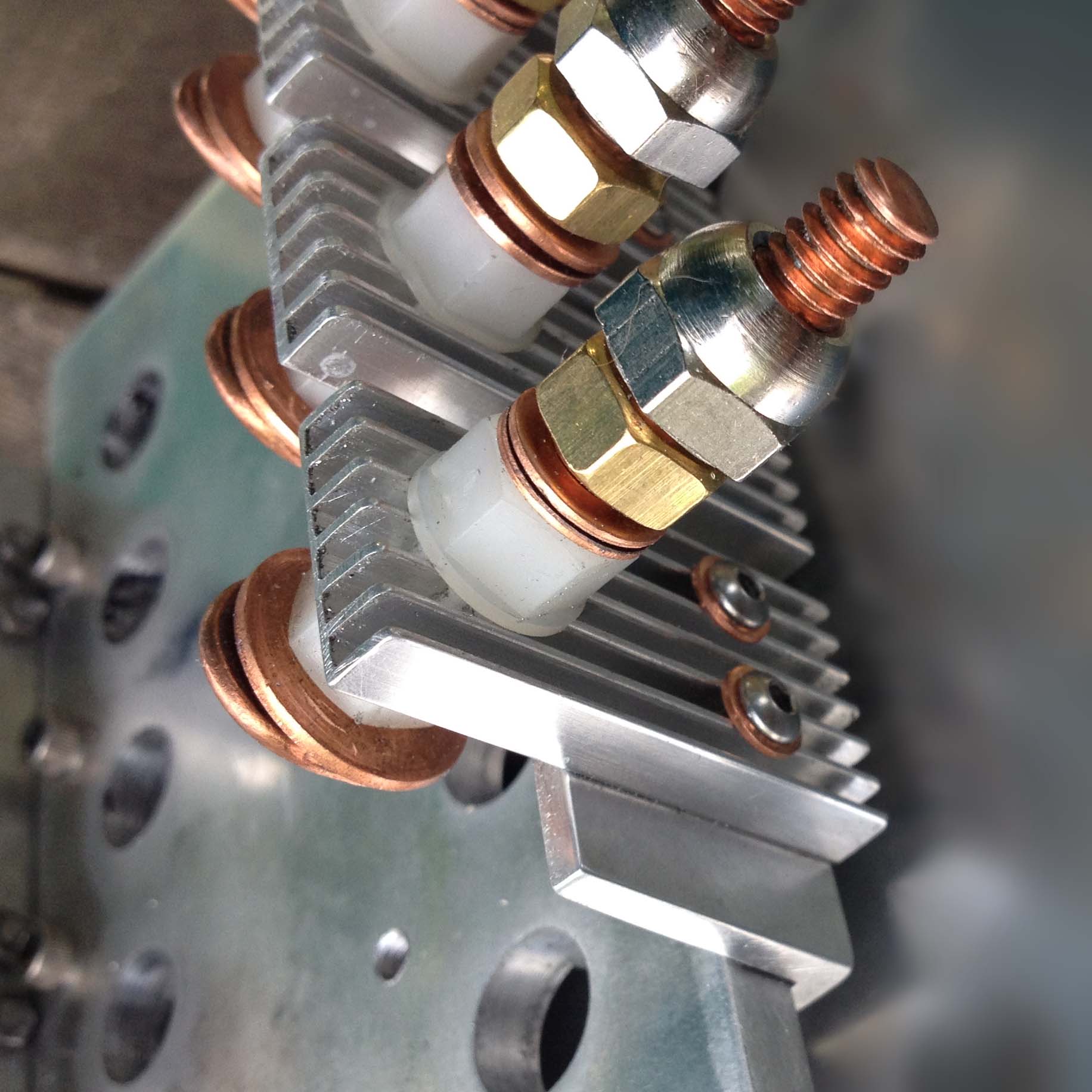

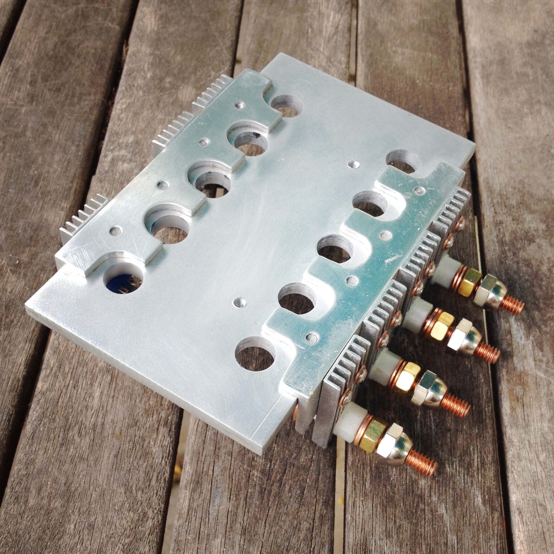

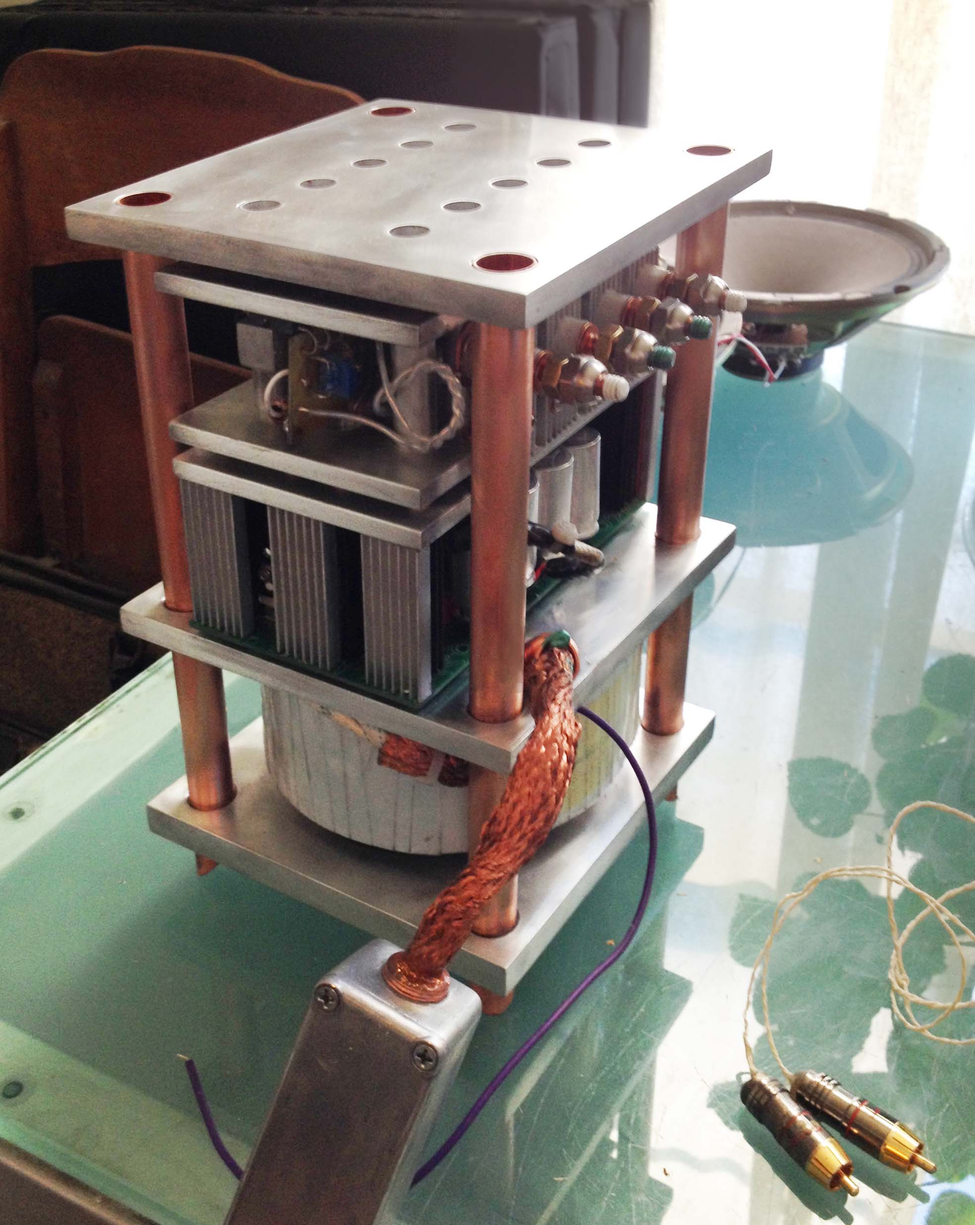

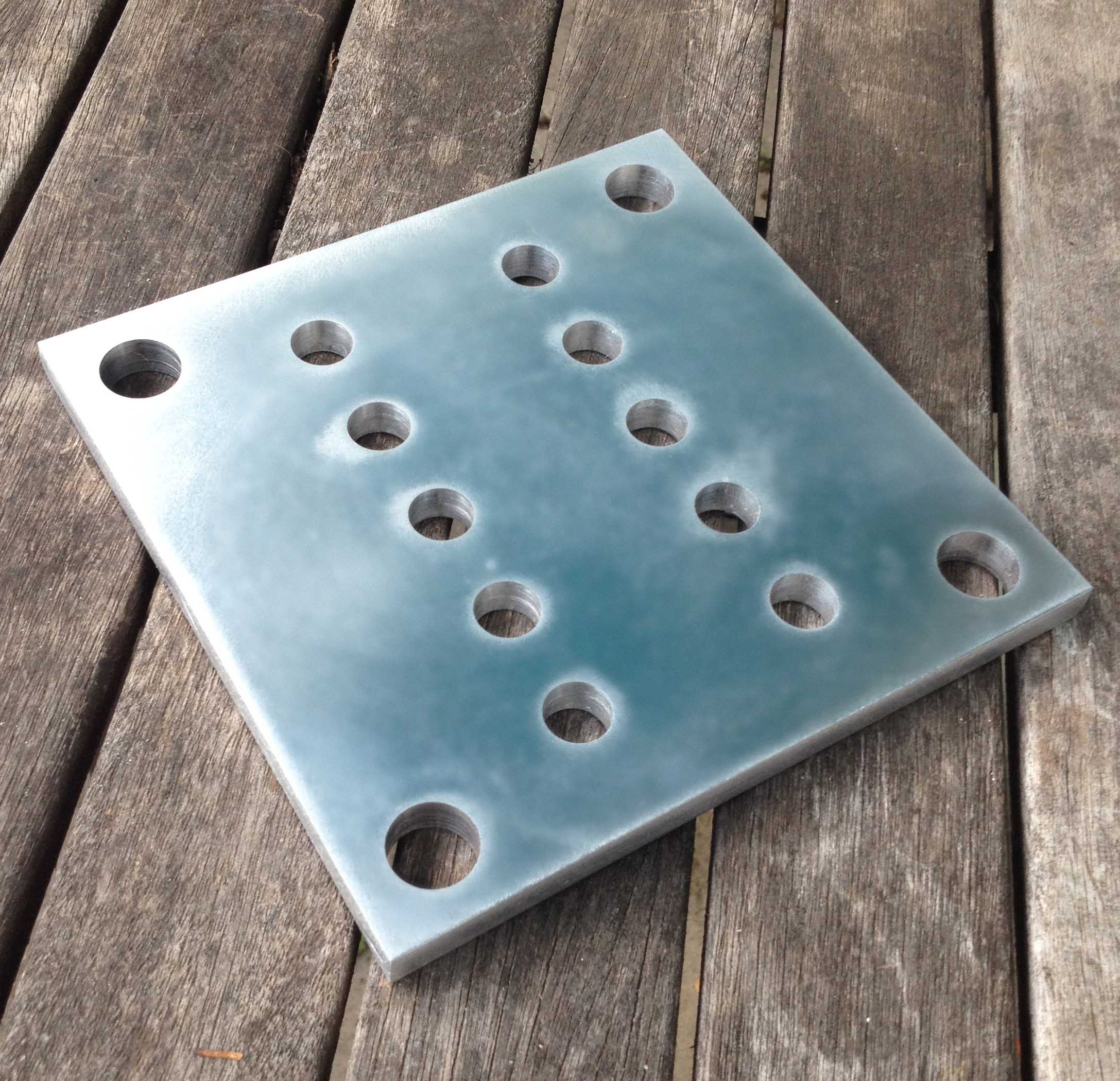

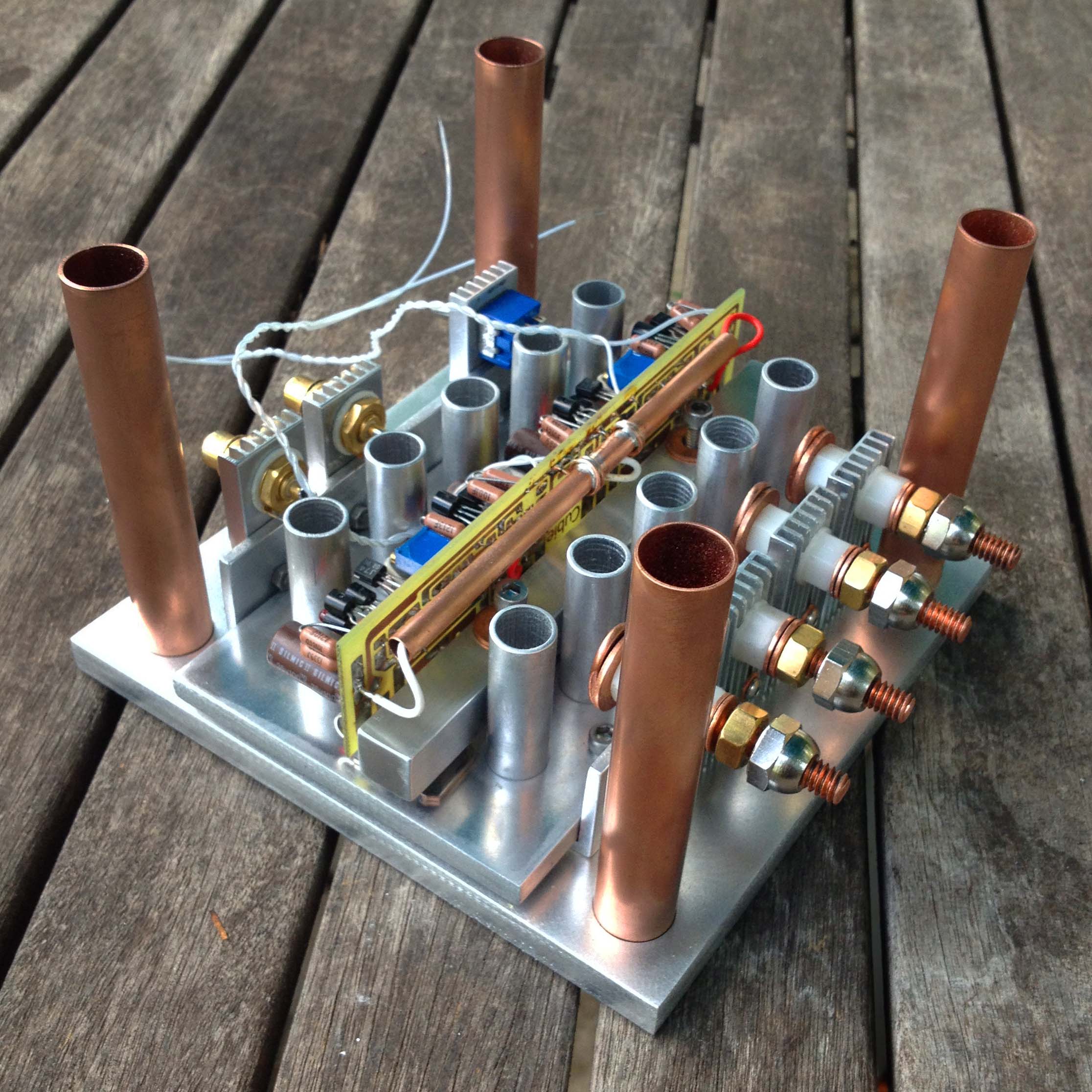

More pics. Cubie 2. Figured on this module I'd take some pics before I actually assemble it.
All that tubing and copper makes me think its some sort of waterblock manifold. So pretty you could take it to an art fair and sell them at a nice markup because they are functional art.

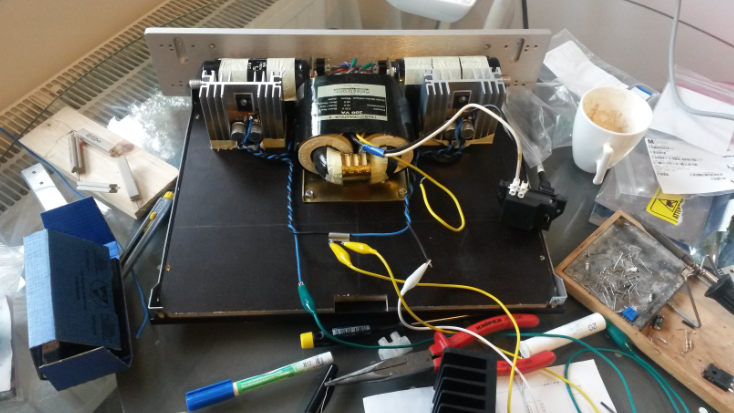

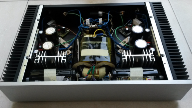

My more ordinary small version 😀 Currently set at 400mA and +/-20Vdc, so it is running quite warm. Problem is the slightly too high voltage of the transformer, so I also had to use a zener in my cap multiplier to clamp off some volts (and those little grey heatsinks are running now at almost 60°C :-/ but the IRFP044 seems not to have any problem with it..) The big case sinks on the side are running at +/- 43°C hottest part, also warm, but I believe it is OK (not using the amplifier when it is > 21°C ambient)

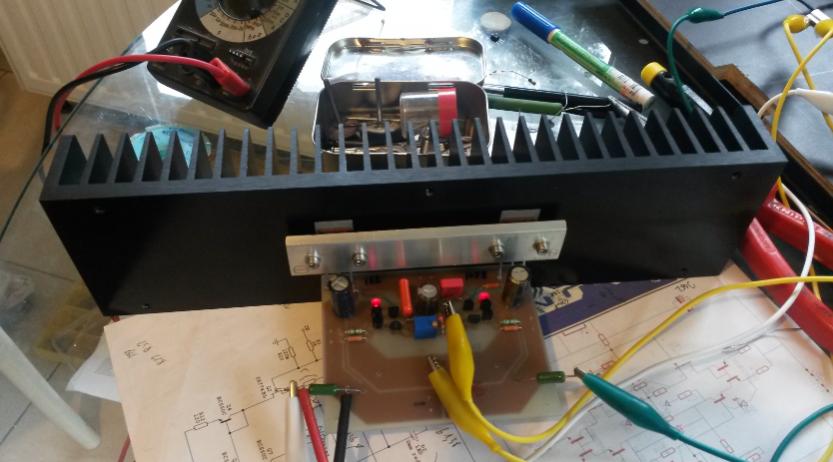

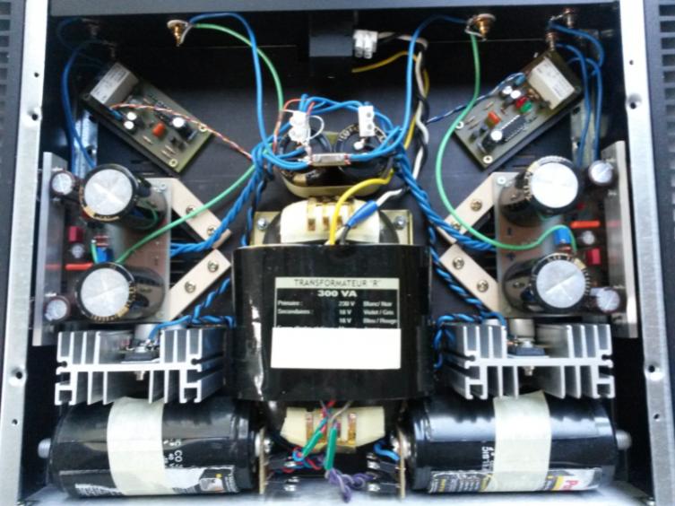

Build with the components I had for other projects that never saw daylight... It really rocks with my 94dB Cabasse speakers! 🙂
Thinking of implementing a switch that can lower the bias... (for critical live concert listening or soft background ;-) ) but afraid that the offset might change too much when bias changes. Would also like to redo the power supply as I'm not very happy with the layout (although I have no hum whatsoever in my speakers) or I will have to at least change these big elco's on the front side that are not in very good shape as one is quickly loosing its charge without load.
Juma, thanks a lot for such an incredible design, if you have a cold alternative in the same league, please share! 🙂

Hi Berny, glad you like it. 🙂
To relax the thermal conditions, it's best to lose some windings from transformers secondaries i.e. lower their voltage.
43°C is OK, you can go up to 50°C with no worries about LATFETs. 60°C is not a problem for IRFP044 but it is for surrounding capacitors - I suppose that's what you meant by "not very happy with the layout".
How much the offset changes with bias change I cannot tell you exactly (it's a small change for sure), but it's easy to find out (just don't forget to disconnect the speakers before the experiment).
When it comes to "cold alternative in the same league" I'm afraid it can't be done with less than 200mA in the output stage no matter how good the measured data looks in various designs that try to achieve that with 100dB of feedback, HEC or similar schemes, bizarre output stages...

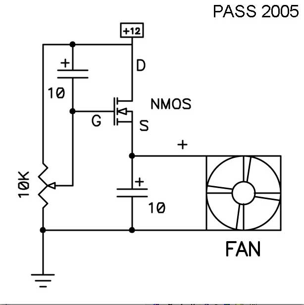

A fluid bearing fan with a simple Nelson Pass speed control is really quiet. Moving some air is good. I built a couple of these right on the potentiometers. The trick of this speed controller is the caps/mosfet provide a little kick to start the fan at a slower speed than
would ordinarily work .-mars
