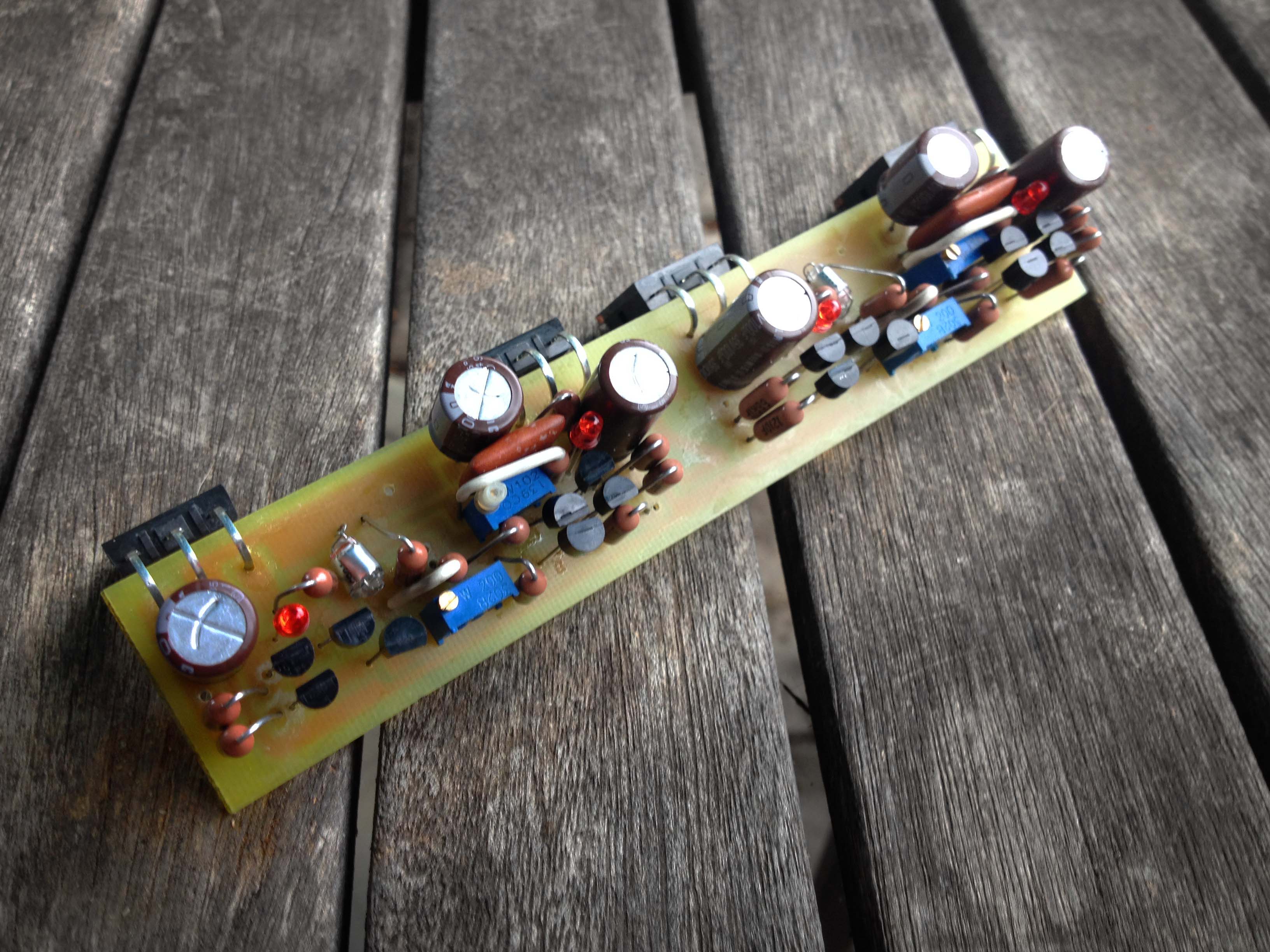

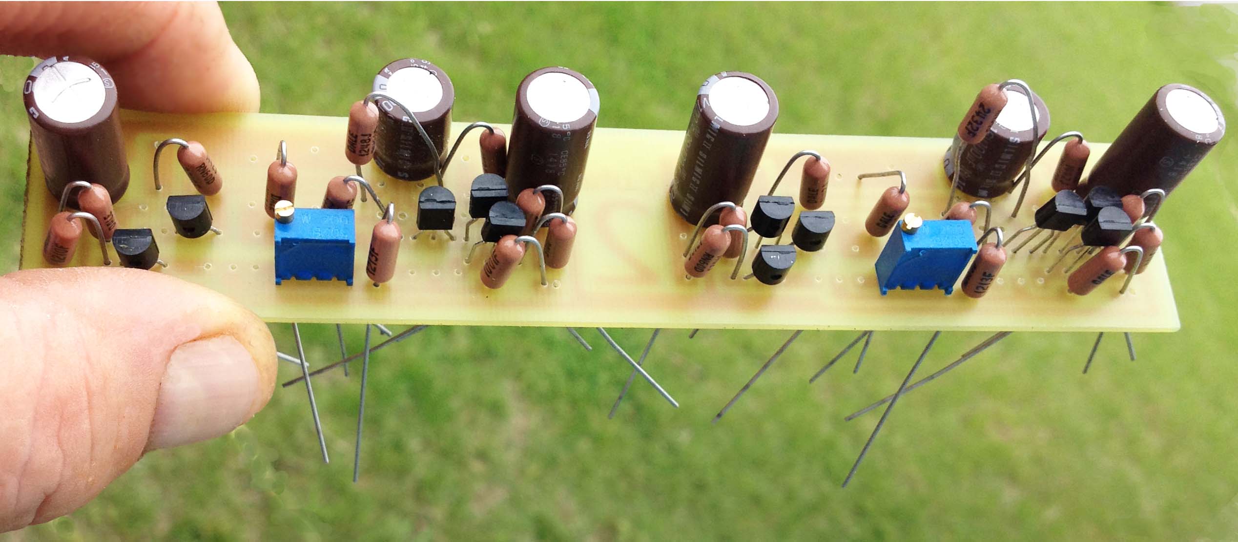

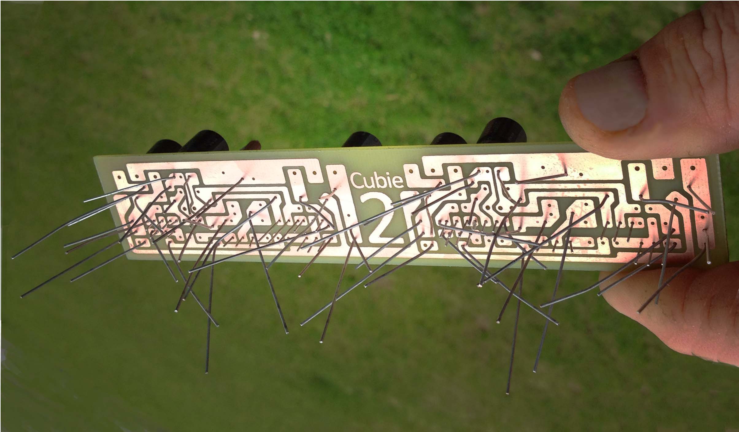

Cubie is getting stuffed. Good thing I bought a bunch of bc550's or I'd be out in the yard looking for the missing one that fell out somewhere.😀 Soldering tomorrow!!! I love to solder.

Looks OK if you have tested JFETs and MOSFETs before soldering all the parts because it won't be easy to measure critical values across those stand-up resistors (voltage drop on R10-R13 and Rbias).

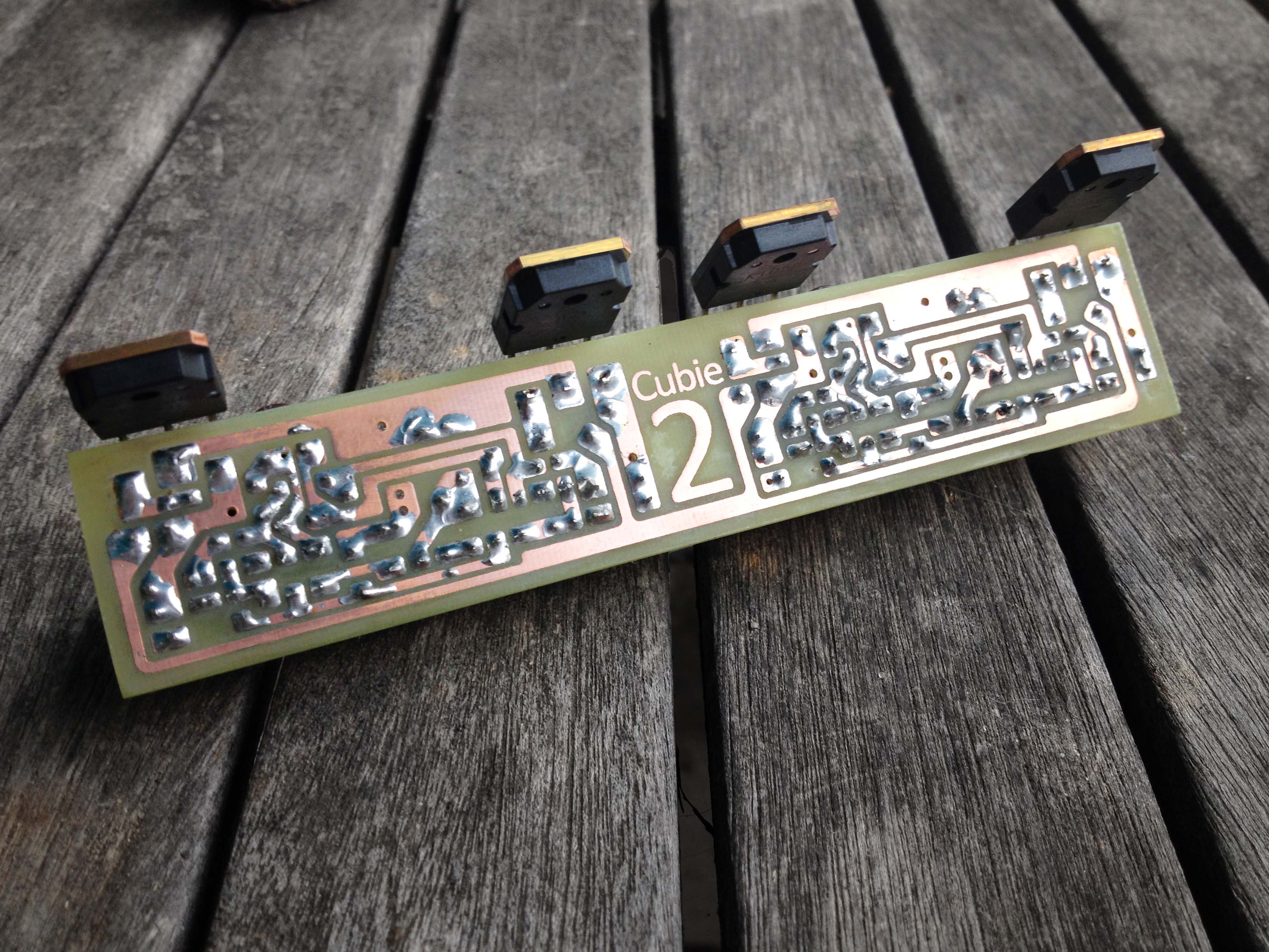

Dont forget that you have three independent GND points on your PCB (signal GND on each channel and common power GND for output stages decoupling caps) that should meet at main GND of the amp.
Take care about LED's polarity - if all is OK they should be glowing, but not very brightly (there's only about 1mA through them).

I have a trace connecting the ground from the electrolytics to each other, so I just need to connect that to signal ground on each channel. Should there be any sort of anti-parallel diode/ big resistor isolation, or just a wire?
I'll make sure I leave some lead exposed on the bottom of the resistors for measuring.
Good to know about the led's not being bright.The flat indicated on led in your drawing is negative, (the short lead), correct? Thanks!!!

... just a wire?
That's all it takes.
...The flat indicated on led in your drawing is negative, (the short lead), correct?
Anode is connected to higher potential, the flat (cathode) goes to lower potential - check that with DMM (diode setting). Meaning higher or lower than zero, positive or negative is less usefull here - both cathode and anode of D2 are positive, it's just that anode is "more positive".
