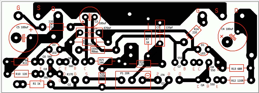

Juma, if you could glance at this and see if I've made a stupid mistake, that would be great. I think it is ok. Thanks!
Any special resistor wattages or cap voltages? I assume 25v caps for C5 and C6. (+-15v Supply).
10V for C3. I'm going to use 16V.
C5 and C6 25V or higher. I already have 35V lying around, so that's what I'll be using.
I see no mistakesJuma, if you could glance at this and see if I've made a stupid mistake, that would be great. I think it is ok. Thanks!
You got caps all right as well as ammel68 (C3 - 10V).
All resistors are 1/4W except R20 - I used there 1/8W because of tight space but you can use 1/4W and turn it to standing position. Its value is not critical - anything from 47k to 330k will do OK.
I see no mistakes

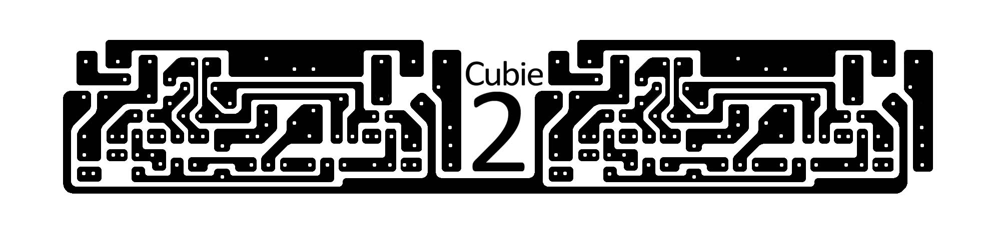

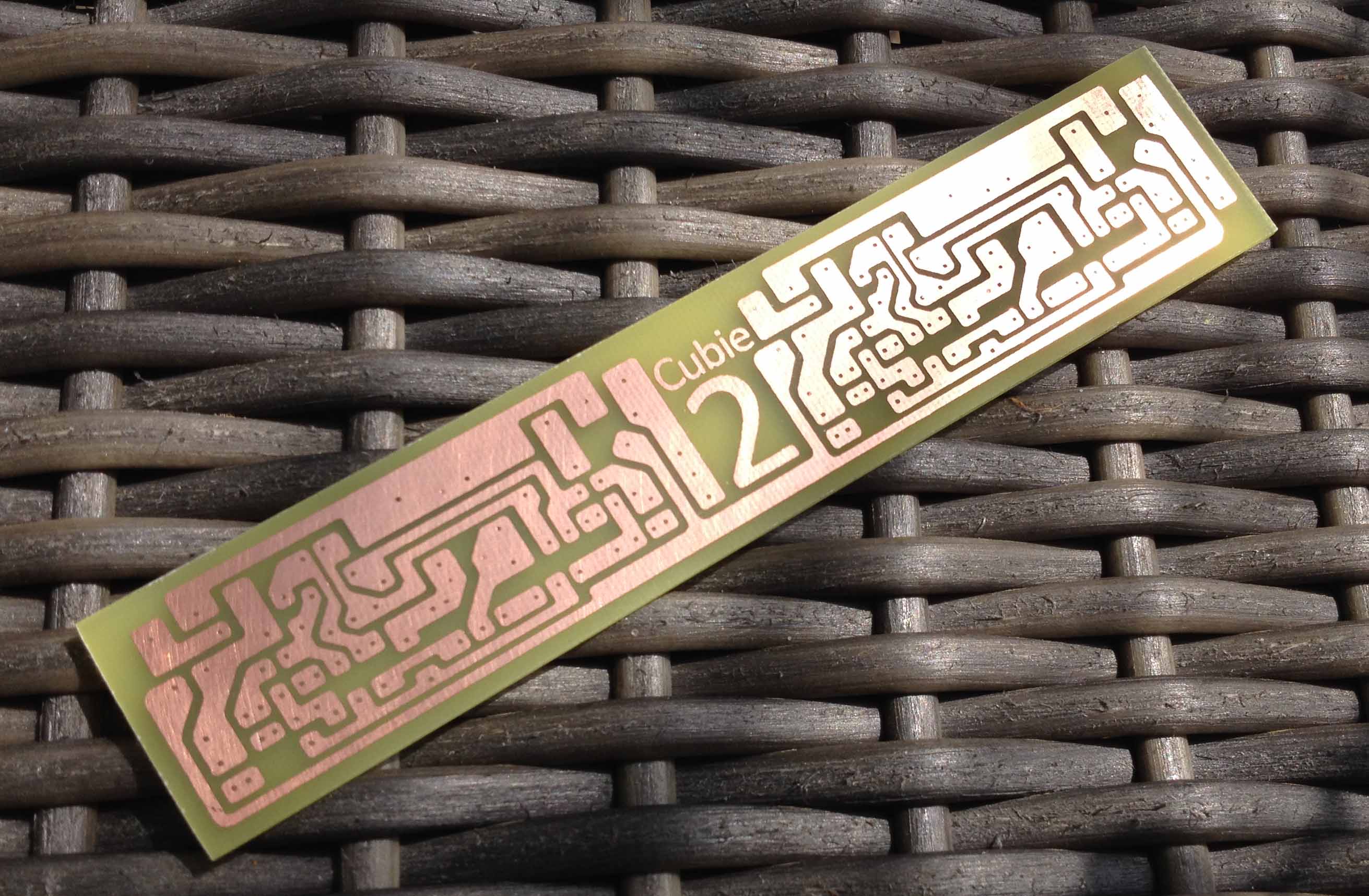

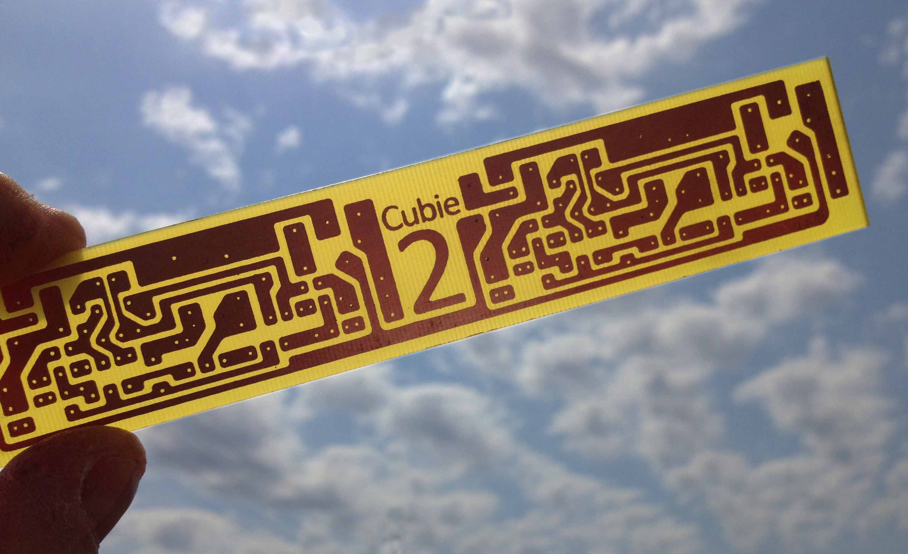

Etching done! FR4 2oz. Sweet!
marsupialx, "sweet indeed"
Looking good! 🙂
Definitely! Maybe it should be called Cutie2? 🙂

Let the amp's name stay as it is. We will call marsupialx the Cutie instead, and if you look at his PCB for Cubie1 you'll see that we can call him Curvy too... 😀...Maybe it should be called Cutie2? 🙂...

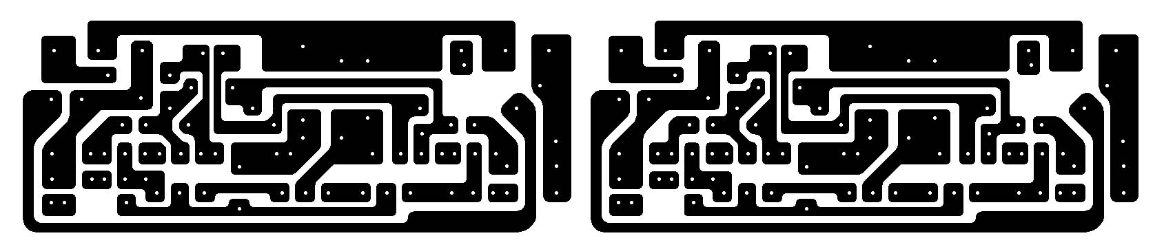

Juma, where do I measure to set bias on the Cubie and Cubie 2? What voltage am I looking for to get a medium bias on the 1058 and 1062 latfets? Thanks, sorry I'm not more knowledgable in these things -marsupialx
