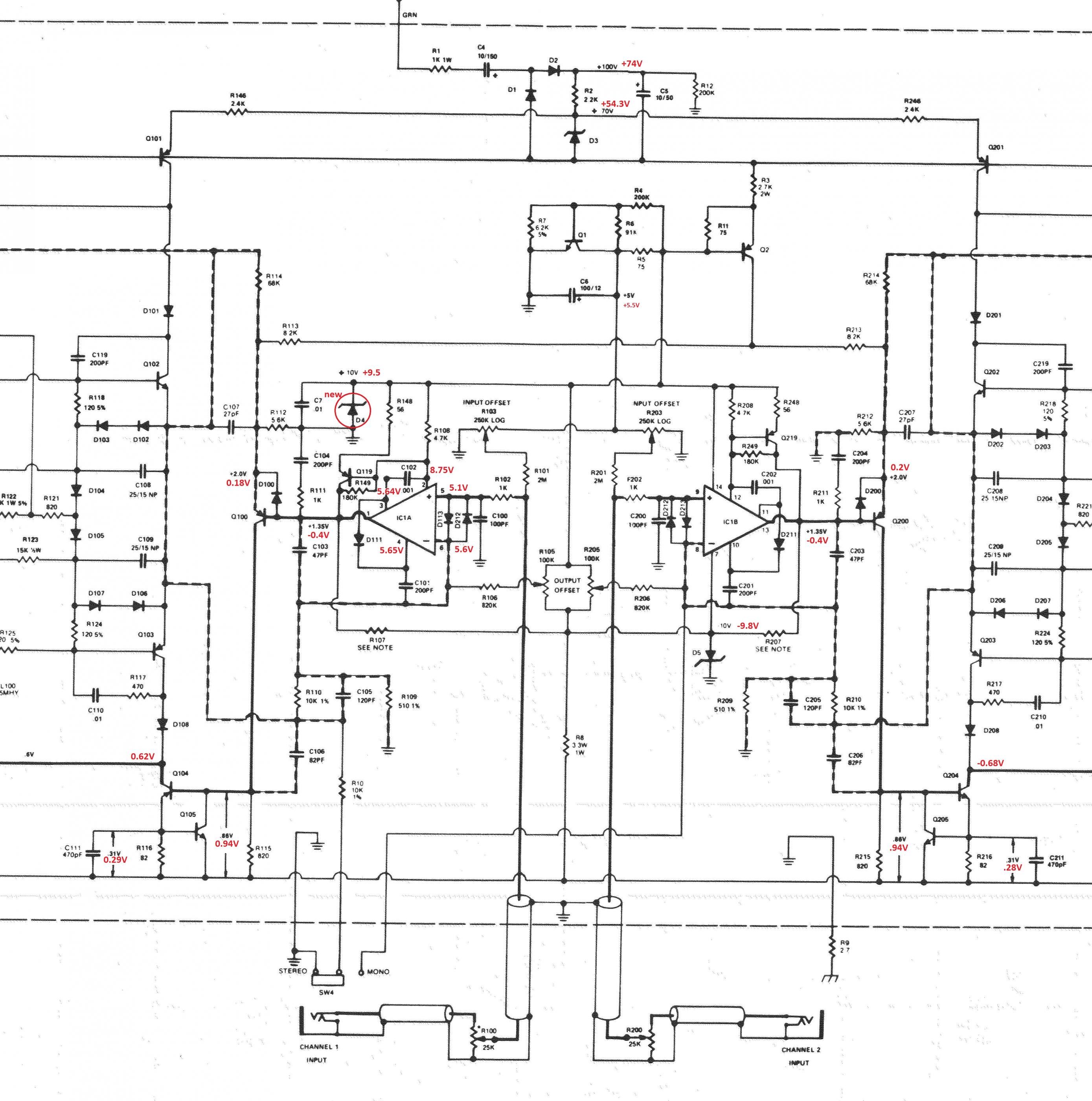

The speaker negative terminal, and various other points, is your ground terminal. Say the ground is the end of R146 where it connects to the 0.1 uf capacitor and the ground binder terminal. That is the main thing you could get wrong in measuring.
Your meter could also be out of calibration, with your 9.2 v versus 10, but you put new zener diodes in there, right? Did they come from a major distributor, ie new stock? I use B tolerance zener diodes from newark.com or mouser.com to calibrate my meter, which reads fine.
If you got the new zeners from a surplus house and they are out of tolerance, I'd let the -9.8 zener be but insert a 1n4148 line to line in series with the 9.2 to pull it up to 9.9 v.
Then I would use the offset adjustment pots to make the op amp output 1.35 like it says, then since your problem is with the resistor on the output, (speaker, but you put that away didn't you?) do that then trace the feedback path back to op amp in 6 (inverting input) to see if something is blown up in that path.
You can also track the op amp output to D10blob (collector of Q100) and D10blob (collector of Q104) where you have other voltages listed, to see if the voltages are correct with the op amp out at 1.35. Then check the D10blobs that they are dropping about 0.6 v, slightly turned on.
There are other voltages you can check at Q106 at the bottom and D3 at the top. Etc. You've got a layout, you may want to make a copy and write on the copy test points like A, B, C etc, which correspond to voltage points A, B, C, you write on your copy of the print.

finally found D4, the +10V zener. It was buried under a resistor. Discovered it by measuring every visible diode on the board and finally last night I noticed this diode in a very tight spot. when I look at the schematic it seems to me that there is more than one resistor involved in generating the current that runs through the diode. There are several resistors on the cathode end of D4. I will set up test of new diodes using 24VDC PS. I can use a 1 kohm resistor in front of the diode to generate 24mA. The resistor goes on the anode end? Then do I just measure the potential difference across the diode?

replaced D4 zener on +10V. +9.2V increased to +9.5V.Output of opamp went from -.5 to -.4, below the +1.35. I took a bunch of measurements that have been recorded on a copy of the input board layout drawing. When I clean up the sheet will publish or email to you.
The +5V offset reference on the collector of Q1 measures +5.5 should be +5. The +2 required on the emitter of Q100 measures 0.18V on Channel 1 and 0.2V on channel 2 well below the required 2V(emitter Q100/200).

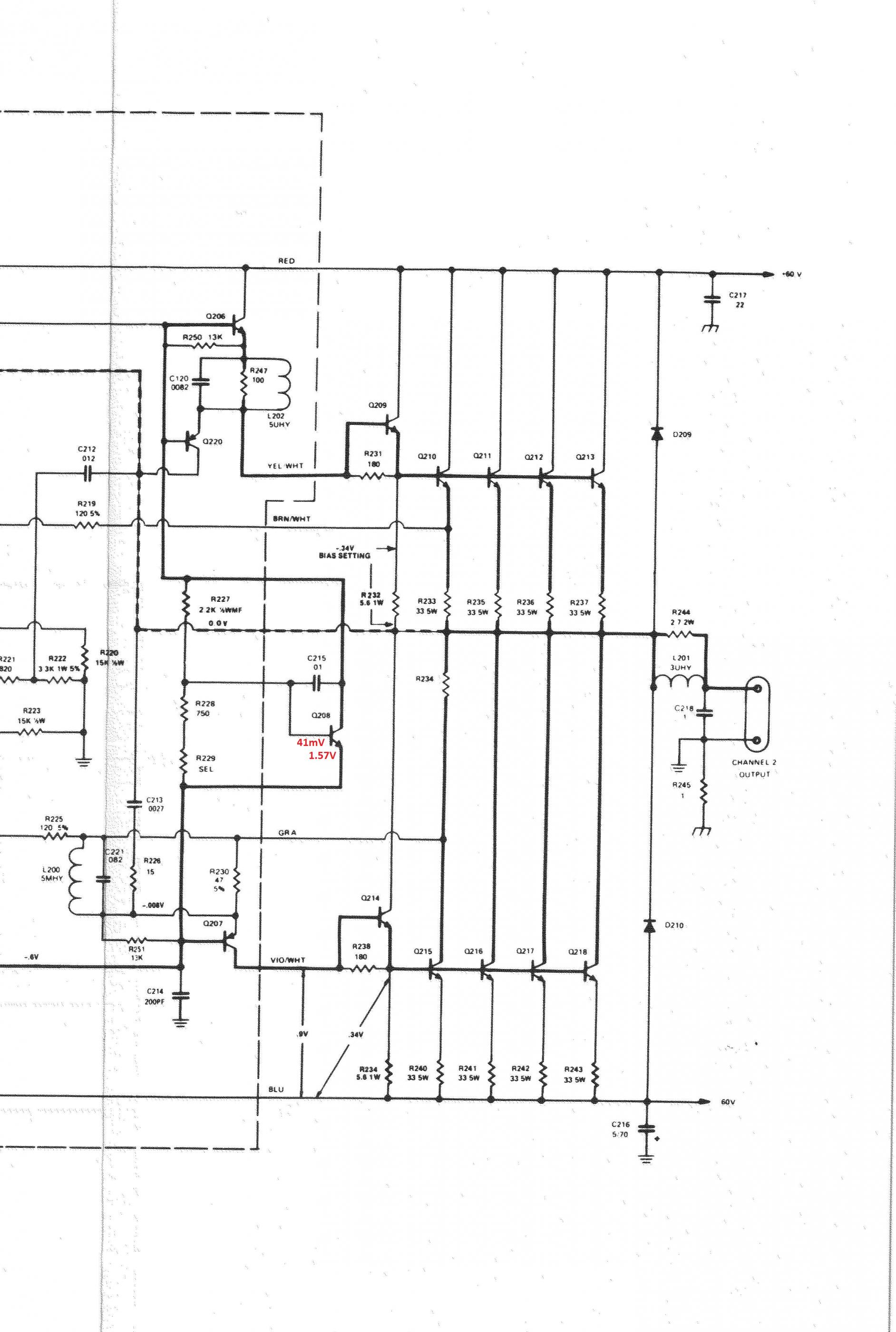

still interested in the + and - 60V rail measurements that I am getting. They measure closer to 44V. Is this a RMS measuremnt taken via the DVM while if measured with an oscope it would exhibit 60V peak to peak?
the bias on channel 1 is still too high.
put the 200ohm trimmer in place instead of the 150ohm hand select(channel 1). This is the channel that got all new output and driver transistors and the positive and negative predrivers on input board(Q106,Q107). With 150ohm hand select in place the bias channel 1 is 420mV. with the 200ohm trimmer max'd out the bias is at 357mV. I have the amp operating again. Channel 1 is operable. Will check to see if I still get the power up issue with load on the speaker terminals. Previously with the speaker left attached on power up the light bulb stayed glowing brightly and didnt dim. Currently I power up the amp and connect speaker after power up. Today I did power it up and shut it off with speaker connected and didnt see the same issue not sure if letting the caps drain fully might cause the power up issue. Yes it is still having the same issue....assume DC offset at power up with load on speaker terminals. I will get two 10 ohm 100W resistors tied together and use that instead of speaker.

Op amp measurements
Pin 5 5.1mV
Pin 6 5.6mV
Pin 1 -0.44V
Pin 2 8.75V
Pin 3 5.64V
Pin 4 5.65V
Assume Pin 6 is actually -5.6mV since the output is negative.
Pin 5 5.1mV
Pin 6 5.6mV
Pin 1 -0.44V
Pin 2 8.75V
Pin 3 5.64V
Pin 4 5.65V
I'm not worried about Q1 measuring 5.5 instead of 5.0. It only feeds voltage to two adjustment pots, so you should be able to compensate with the pots.
I am worried about -0.4 v out pin 1 of IC1. I would do the pin 6, 5, 1 measurement and calculation. Is is performing mathematically? then if IC1 is socketed, I would pull IC1 and see how much current is coming out of Q1. Then I would check that that current is within specified current load of a 739 or 749. If the IC is not socketed, I would pull the base of Q100 see if it passes a quality test at significant DC voltage. Of course if it fails the double diode test on the DVM, no reason to go on to voltage-current check. Also test D10blob, the diode between collector and base of Q100.

Edit, cross posts, will look at your op amp results. The "bias current" is high, and you have only measured one side, not the other. There are 0.34 volt indications on both R132 and R139.
Edit 2, 5.1 mv -5.6 mv is -0.5 mv, and you are seeing -.4 v out, for a gain of 100? Is R101 a 2 megohm resistor? red black green? Is R149 a 180k resistor, brown grey yellow? If they are then the gain should be about 180k/11k or about 16 to 20.

IC1 UA379 had a pin on leg 1 so that a probe could be connected to it. When I went to remove IC1, very carefully, I discovered that the leg of the chip was missing, the larger section of the leg adjacent to the chip was there, and the pin which I thought was soldered to leg 1 stayed in the socket. Thought maybe this was the problem with the output. I soldered the pin back on to IC1 leg 1 and reinstalled back in socket but no change in output. You were correct on your resistance values for R101 and R149 used in the calculation. On channel 1 the bias setting across R132 and R139 were high 420mV. Currently I replaced the hand select R129 with a 200ohm trimmer which is currently max'd out and the bias is measuring 360mV. The original hand select R129 was a150ohm resistor. So this has been increased to somewhere around 200ohms and the bias setting was reduced by 60mV.
I have attached the channel 1 output board schematic with measurements taken to date. I will attach the other sections of the schematic with measurements today as well. Hopefully they are readable?

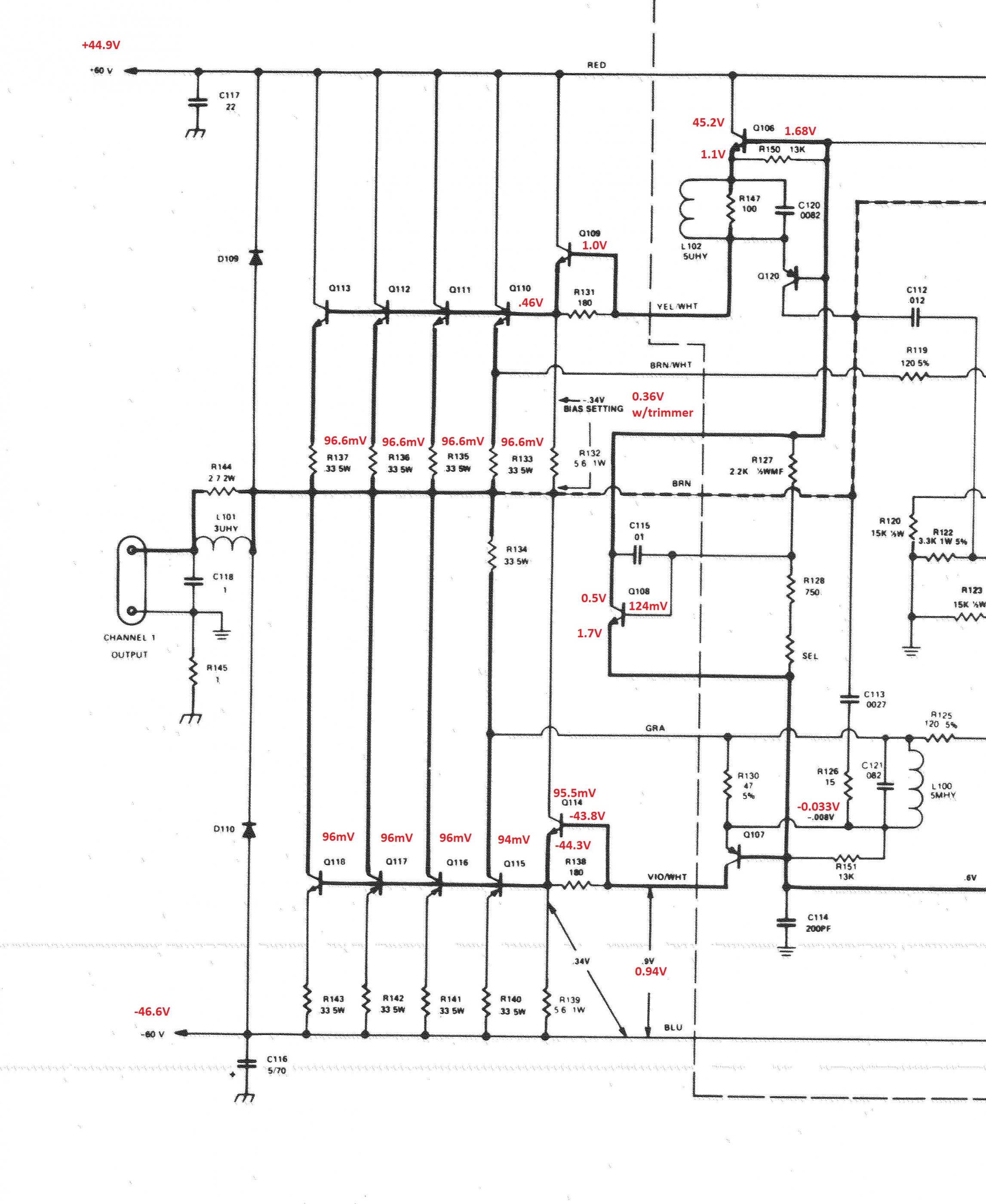

5.5 v at D4 is very wrong. You may want to check both ends of all the load resistors to see which one is hogging the current. We already had evidence something was wrong with IC1, check if the resistors to it show it is the current hog. Also Q119.
Q104 has the base back biased if I read this right. I would think at idle no signal it would be slightly forward biased (.6v) to let a little idle current through the output transistor driver to eliminate crossover distortion.

If you are going to prove that the emitter resistors have no current on them, you have to measure both ends. Only one measurement is needed for the common speaker terminal, but you have to show it in addition to the five emitter-resistor terminals. I can't tell if these output transistor measurements are with the DC on the speaker terminal or not.

"If you are going to prove that the emitter resistors have no current on them, you have to measure both ends."
I did take 0 state measurements (meas relative to gnd) on both ends? 97mV on one end and 96mV on the other end?
"I can't tell if these output transistor measurements are with the DC on the speaker terminal or not."
These measurements would be without the speaker load and the DC voltage issue. I have a tendency to power the amp off quickly when the light bulb doesn't dim and the speaker flexes its muscle along with an inherent hum. An aluminum plate (heat sink) is being tapped today to mount the two 16ohm 100 watt resistors to for a load. I would prefer to have this connected than the speaker. If I get the resistive load completed tonight I can check to see if the same issue occurs and try to measure the DC at the speaker terminal and transistors. Can I leave it in this state (light bulb glowing brightly) and take measurements?

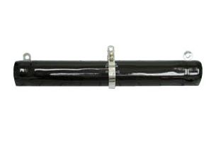

I have a pair of these resistors: D225K10RE - OHMITE D225K10RE - RESISTOR, WIREWOUND, 10 OHM, 225W, 10% | Newark element14 US
I cut the side out of a PCAT tower and cut two tabs about 1.5" x .4". I bent the tabs up 90 deg and then bent the ends in .5" to insert in the ends of the logs. So the resistors sit up in the air, off the coffee table I work on amps on.
Resistors with a smaller hole, I stick a screw up through a plate of sheet metal. Then I put a wooden or plastic torus at the bottom to hold the resistor up off the plate, so I don't burn the wood. A nut on top holds the resistor on.
I cut these sheet metal plates with a die grinder or air shear. Use safety glasses of course.
Yes, once you have a safe place to dump the current you can leave the amp on with the light bulb burning.
If I put a salvage speaker in series with a faulty amp, I put minus to minus 4700 uf 200 v capacitors in series with it. Any cap over 1000 uf would be okay. I use the caps that are too old that I am suspicious would blow up as rail caps in a repaired amp. The DC voltage out the speaker terminal hasn't blown one yet.
You may find old appliance heating elements make suitable load resistors for amps, by measuring their resistance. Unfortunately you can't take a DVM into Goodwill to measure them. I've got an old room heater with a bad tip-over switch that the heating element is useful.
