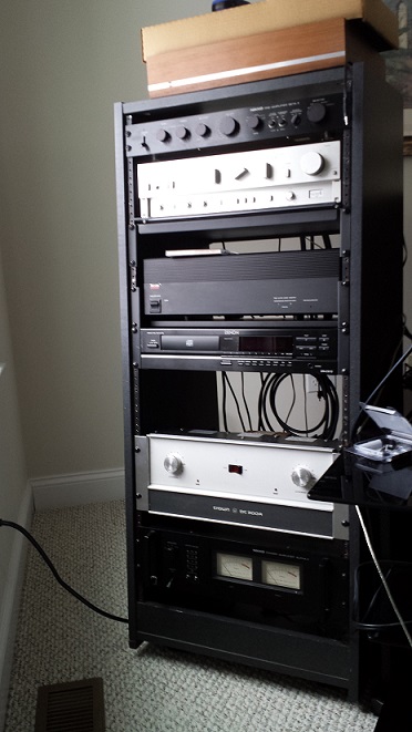

anatech just connected up with me on my initial plea for help. Reminded me that I never really showed the finish product. It has been awhile since I rebuilt channel 2, about three months back or so. This involved replacing all outputs and drivers along with matching the predrivers replaced on the main board. These were all required to get channel 1 operating. Replaced the pots with new ones. Fab.d the missing rack flanges and reassembled and tested. Finally made it upstairs out of the basement hooked in to the main system. Bought a used rack and assembled some of the stuff into it. This amp is a beast as far as power and runs incredibly cool even when running it a bit loud.
actually the photo doesn't show the Furman power conditioner that my brother got for my birthday. It has the pull out LED's, nice for using the rack at night.
