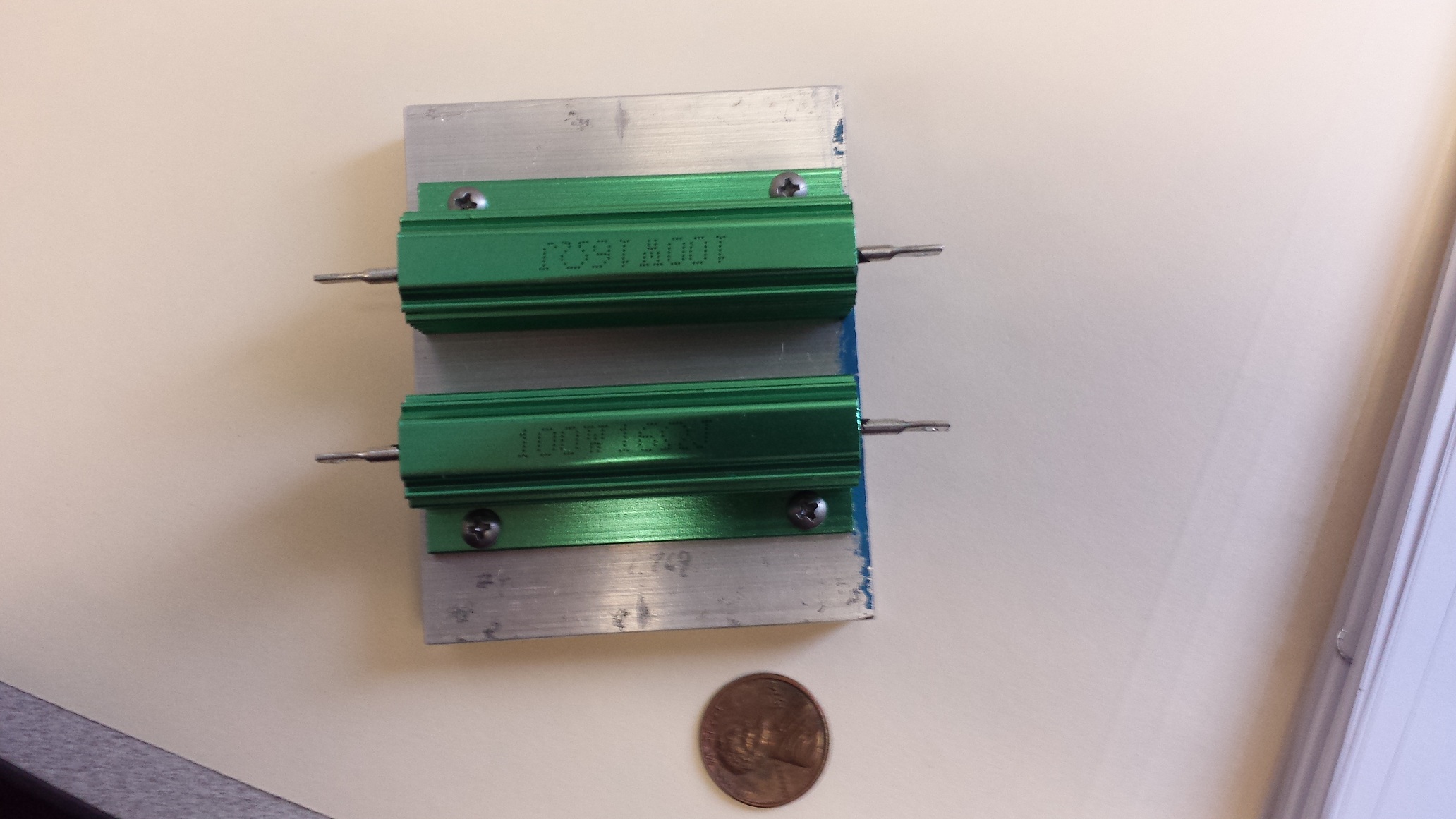

finished up resistive load and hooked up to amp channel 1. Power up and the bulb stayed glowing.

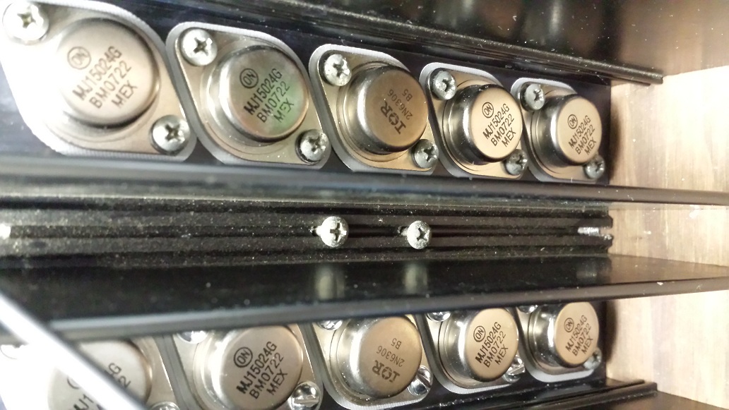

Amp S/N 28945
DCA board #9785
IOC board #9794
Output boards #7954

Has me wondering if the DCA board and IOC board have been transplanted from a DC300A seriesII.
Anyone have experience with the board #'s and product line?

indianajo, djk was correct in having the light bulb removed while operating the amp with any type of load. The measurements in post 102 were taken when the amp had the light bulb on it and was powered on with a load. In that scenario I believe some of the transistors latch one way or another and would stay that way similarly as was seen when the amp was powered on using the variac. Once again thanks djk for monitoring my efforts. Those measurements taken in post 102 were with the light bulb in place and a load on the output. Those measurements would not be measurements taken on an amp that one would think was capable of playing music? And as stated in previous posts the reworked channel 1 has been hooked up several times and found to be operable.
Last night removed bulb and powered amp up with resistor load. Did not see the same issue the amp was having on power up with a resistor load on it (DC of 7V on output). The max'd out 200ohm trimmer was still in place so the bias setting on channel 1 was still over 400mV.
This morning I took 3ea 100ohm resistors in series and replaced the trimmer. I wanted to convince myself that the bias was capable of being adjusted. This scenario dropped the bias below the 315mV minimum allowed, good news. Next step is to get the select bias resistor/s that work and get them in place.
Then another round of measurements without the bulb in place. thanks to everyone this amp might come alive.......

The main PS rails were reading 44V instead of 60V because the light bulb was in place. Without the light bulb the rails are measuring 63V. So the comment I made about rms and p-p voltage was incorrect (Post #39).
In a hold pattern. A 270 ohm bias resistor should be delivered tomorrow. This should get the bias for channel 1 in spec. I have been thinking that since the opamp output is low, if it is increased that it might impact the bias as well?
Anyways bias resistor will be installed. I think the next step is to put the audio generator and oscope that was purchsed to work. Definately will be looking forward to support on this.
Will use the resistive load fabricated. Will input a sinewave of what freq. and amplitude?
Will start with looking at signal at input of opamp and at output?
