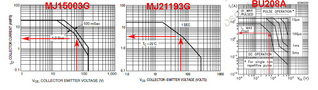

This was off of T Waits thread on resurrecting a Crown DC300A, the15003 are seriously compromised at the supply voltages available from this amp. 21193 would be much better in the higher voltage region of SOAR. The extra current from the 15003 is of no advantage.
The SOA limit on the 21193 is 4A at 60V, the 15003 is 3A at 60V
15003 transistors
jackinnj, i dont know much about how to select eqvlt transistors so I am relying on what I have read. Your response indicating "The SOA limit on the 21193 is 4A at 60V, the 15003 is 3A at 60V " what does it mean in laymen terms? From your experience are the 15003 transistors an acceptable replacement? Please provide quote for 20 pieces delivered to 03051, Hudson, NH. thanks Bob
Here's what I mean -- the MJ21193 is a slightly more expensive and faster transistor, ($5.25@ in quantities of 10), ft 4MHz, higher power handling -- the MJ15003 is somewhat inferior with an ft of 2MHz but less expensive. I've also got a few hundred of the discontinued BU208A which was a horizontal deflection transistor -- http://www.st.com/web/en/resource/technical/document/datasheet/CD00000993.pdf nobody needs HV CRT transistors anymore!
thanks for the reply. I decided to purchase MJ15024G at $2.49ea from US source guaranteeing not counterfeit.
Good choice.

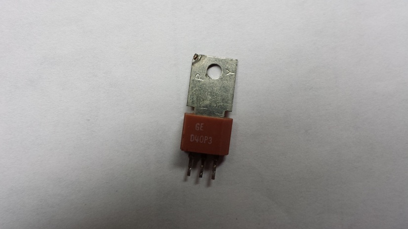

the negative predriver was pulled out 2N4929 (Vceo = 150V, Ic=0.05A, hFE 25-250, ft = 100mhz, 1W) and it failed double diode test. Looking for suggestions for substitute part. I have found references to 2N5415, 2N2216, 2N3637.
Purchased 5 ea 2N5415 to replace the failed neg. predriver Q107 . Pulling all the outputs and drivers out of Channel 2. Will install new drivers and outputs on Channel 2 output board.
