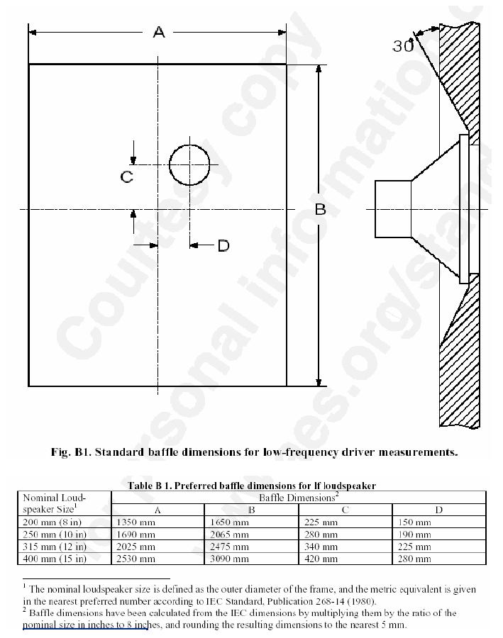

The response on the datasheet is measured on a large panel (IEC baffle) and that's not the case of a speaker cabinet: Seas and Audax are an exception to this rule.?? Baffle step sort of has me slightly lost beyond it's general definition.

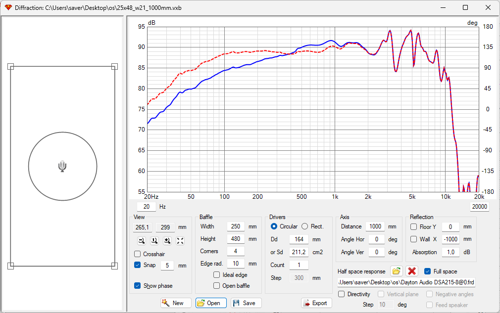

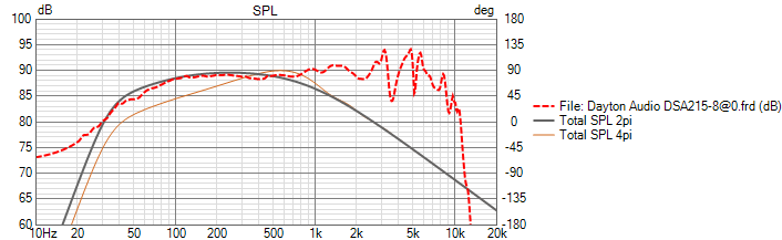

Anyway, that's the DSA215 in your box: brown line is the FR accounting the baffle step loss at LF; dash line is the DA FRD file.
HF section at 1m (Dash line is the DA FRD file)

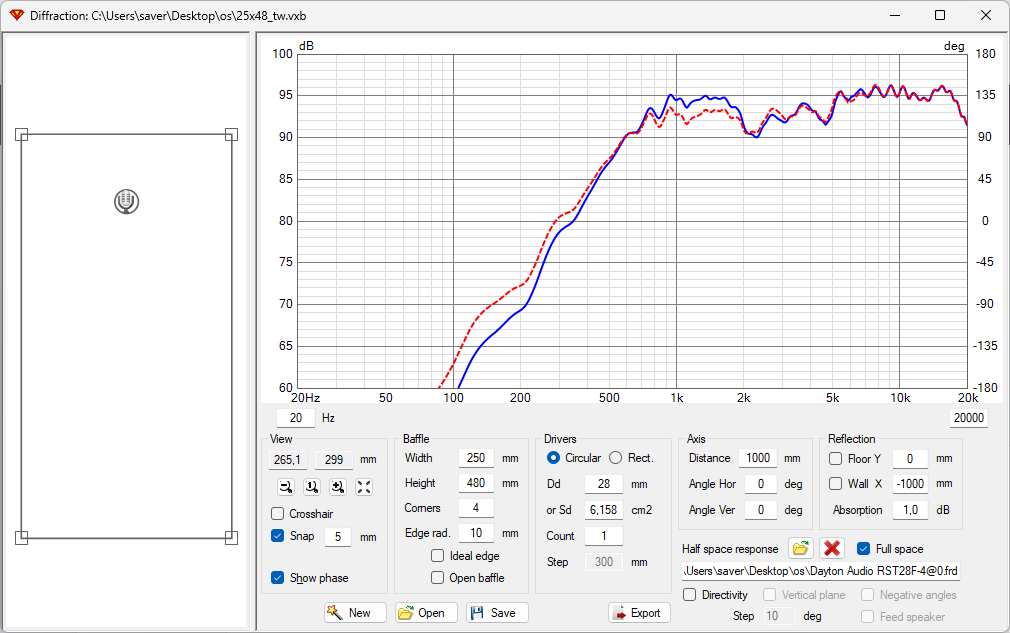

And that's the TW in your box (Dash line is the DA FRD file)
Infinite ?large panel (IEC baffle)
So , this all shows the drivers + the reflected sound of the panel the drivers are mounted on ?

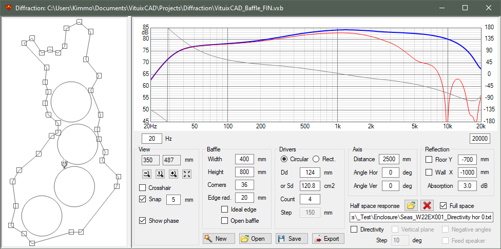

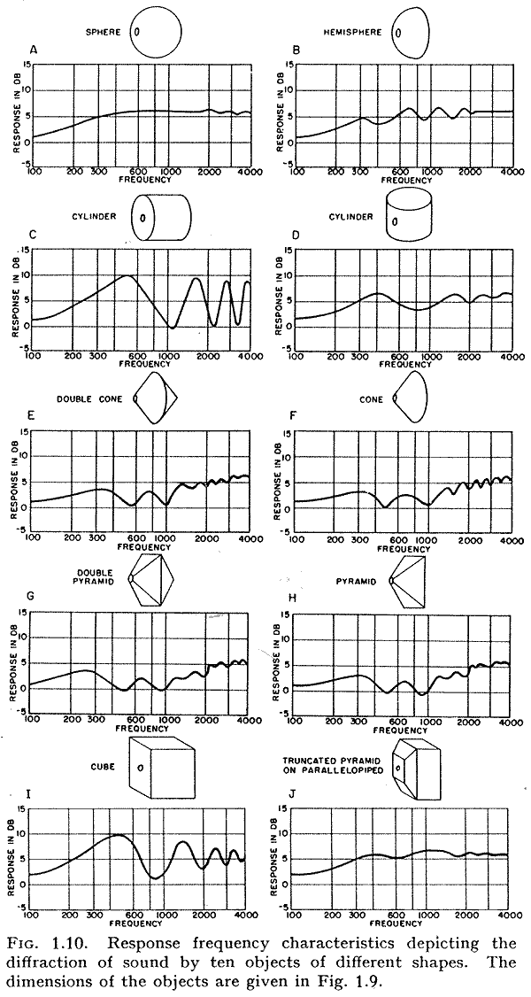

Yes, it calculates the modifications of FR according to the panel size and the Sd of the driver: it's quite accurate till the driver acts as a piston, but it does not consider the shape and/or the material of the cone that could improve the on/off-axis FR. You can also simulate strange front panels by modifying the number of corners: see this image from VCad manual.
See also here for the diffraction of different solid shapes https://www.aes.org/aeshc/pdf/how.the.aes.began/olson_direct-radiator-loudspeaker-enclosures.pdf
