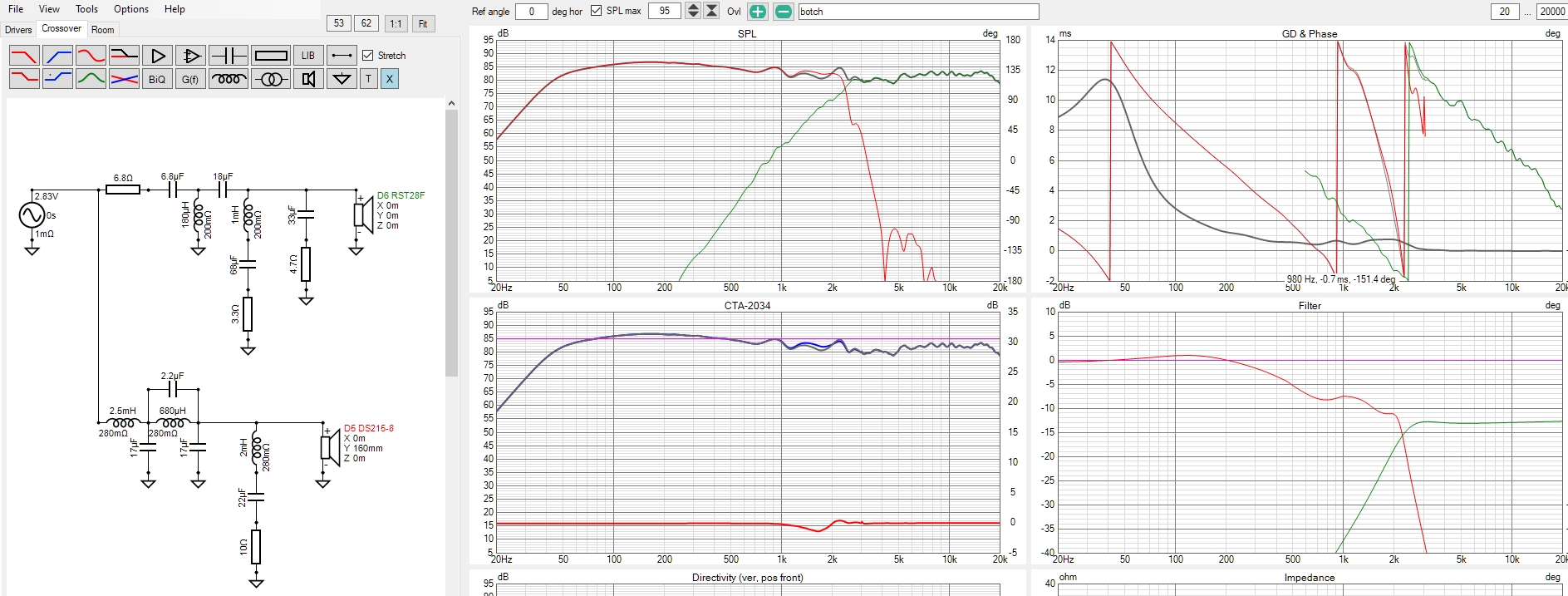

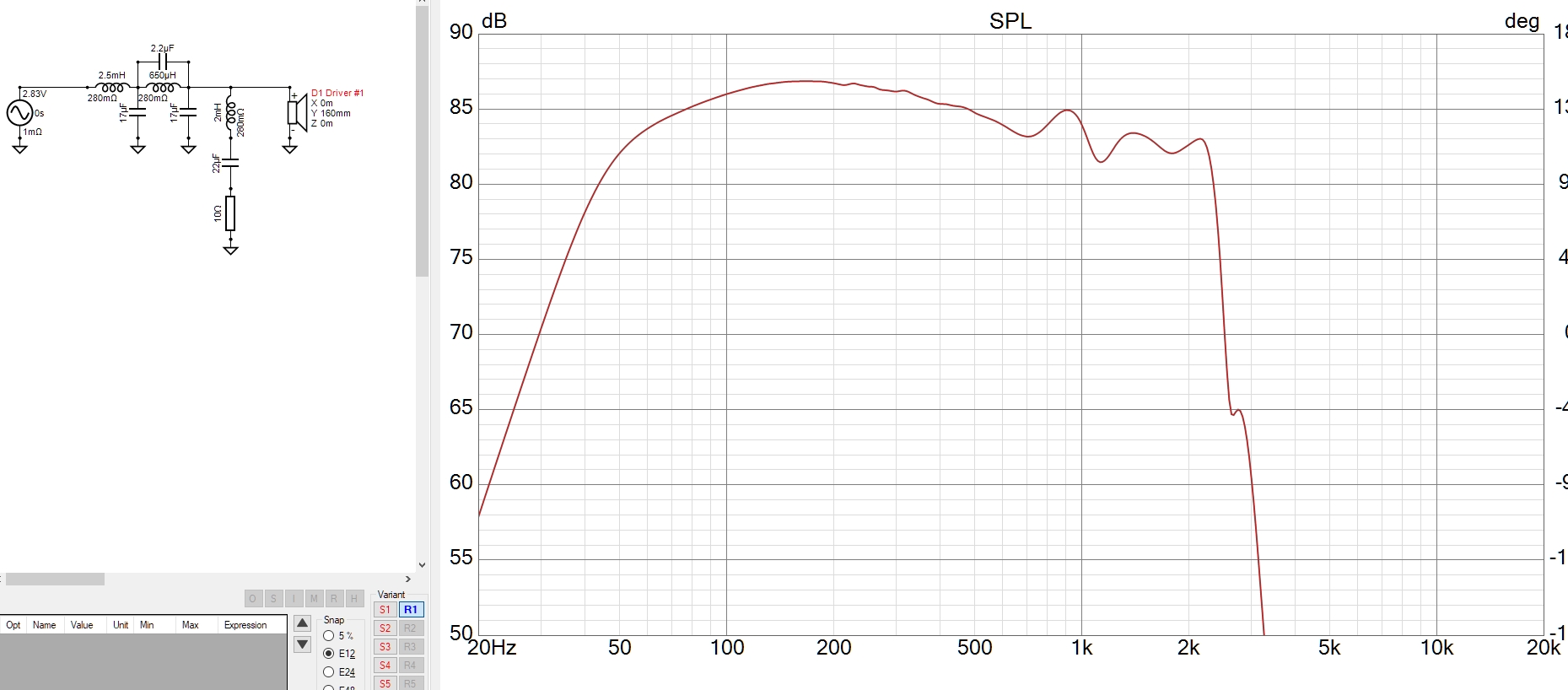

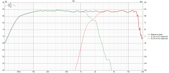

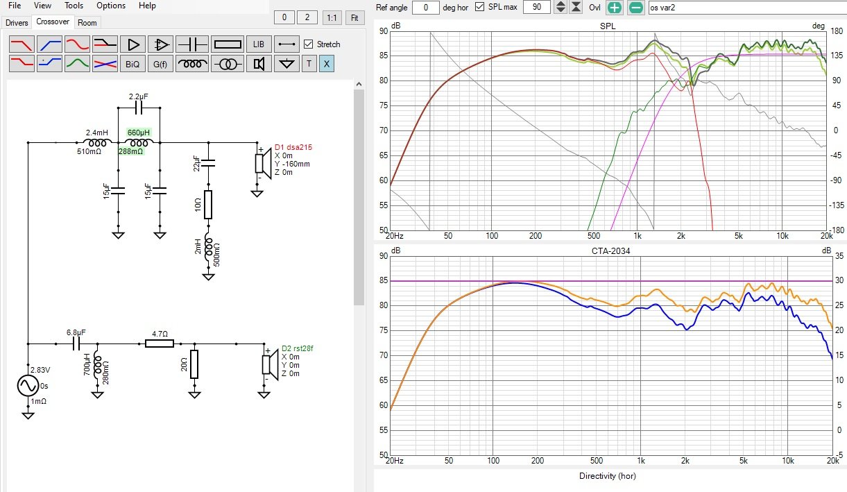

Well, I had one more go at my sim anyway based on the extra info about your box. I also looked for a tweeter alternative to the RST28F and found the venerable Vifa/Peerless DX25 which hfc and heissmann and zaph have all tested favorably. It has a slightly lower resonant frequency than the Dayton, and though it has an on-axis bump at the far-end, its off-axis drops almost inversely, so I don't think it's a problem. We can then go for a slightly lower XO frequency of 1.9khz, and achieve a much better phase response and more benign impedance response, though I suppose it's no issue for your amps. All the files are in the zip but you need to download vituixcad to open the project up. I'll show you what mtg's woofer filter did to an ideal driver and the estimated spl and impedance response of the DS215 files I used in my sim. I still maintain his woofer filter is...weird. The bottom line is that the breakup of the DS215 is really rough for a 2-way; it's more suited as a woofer in a 3-way crossing way lower, frankly.
From https://www.mtg-designs.com/diy-speaker-plans/flex-8/flex-8-ds

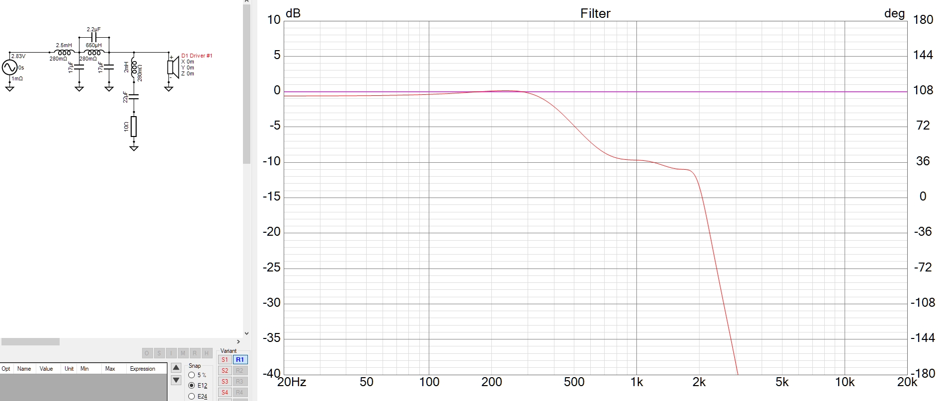

This is what the woofer filter is doing electrically, shown with an ideal driver:

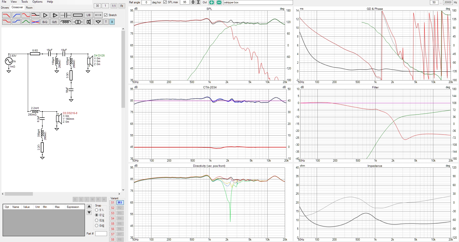

Then based on my guestimations for the DS215 response in your box, it would produce this acoustically. I don't think it's good. I'd choose instead any of the user submitted sims in this thread.

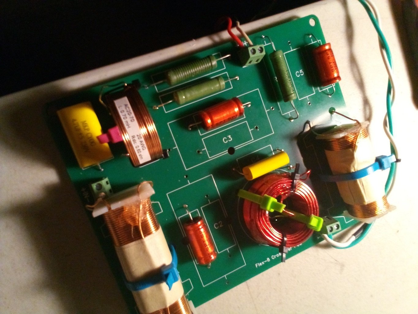

That's why I did this - (below) , and just built the damn thing !!!!
I thought - how could things sound better with all those parts ?
Turned my speakers on ..... WOW !!!
Hearing all sorts of detailed imaged "ghost sounds".
Instrument placement is really different and detailed !
This driver did not sound like this with my simple 2nd order filters.
TOTALLY different sound - I like it!
The designer modified this 4th order for 6 different PE (cheap) drivers and
totally ACED it !
My dome tweeter might be padded down to much ... just a slight adjustment to 4K and up , mostly flat for music.
I lost 2 db output , too. 4th order might have losses,
Mids are more subdued and mellow .... Bass is better , too.
Very much more nicer to listen to - I'm happy.
Luckily , my amp is 2R stable and 70W/8R , I could still get 110db+ . This Xover
sucks 5% (loss) of total power.

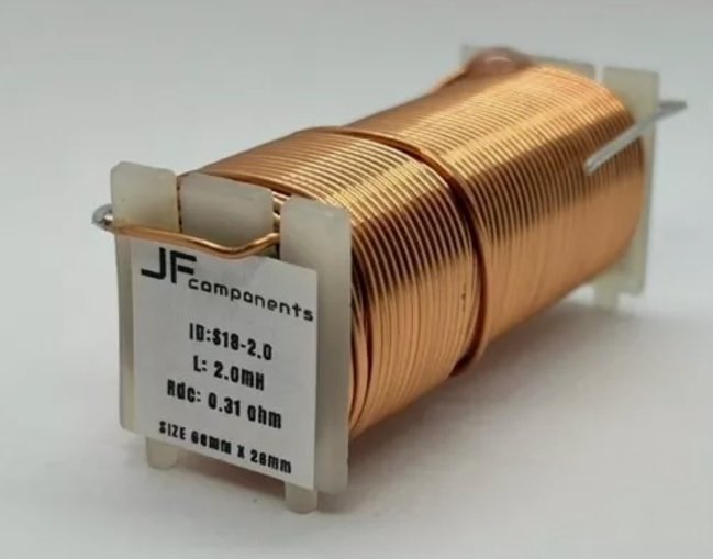

I think these Xovers are worth 70-80 a pair (my cost). I did have to unwind (adjust) my big coil (4mH to 2.4mH)
and reused my 1mH (to .66mH) I overshot the big coil , just one layer dropped the 4 to 2.4mH ? ? Perhaps the Iron core
is different from the air core to calibrate mH's ?

I'm glad you liked the result. My misgivings were based on the fact that they were using a compression driver with horn, so presumably the woofer filter is shaped to match that. The slope is steeper than 4th order - almost a brick wall - yet the tweeter filter is not going to blend normally with that if using a dome tweeter in terms of summing or phase. Perhaps you like the high amount of driver separation anyway. Deliberately sticking a peak in the response to manage the inherent dip in the driver...this would also be quite odd.
Yes , I am worried about that. The dome is way different from the Flex-8 horn/waveguide.yet the tweeter filter is not going to blend normally with that if using a dome tweeter in terms of summing or phase.
The compression driver in the original design is behind the woofer.
The dome at least sounds nice , I don't see how that "holographic" soundstage could be the result of some major
deficiencies.

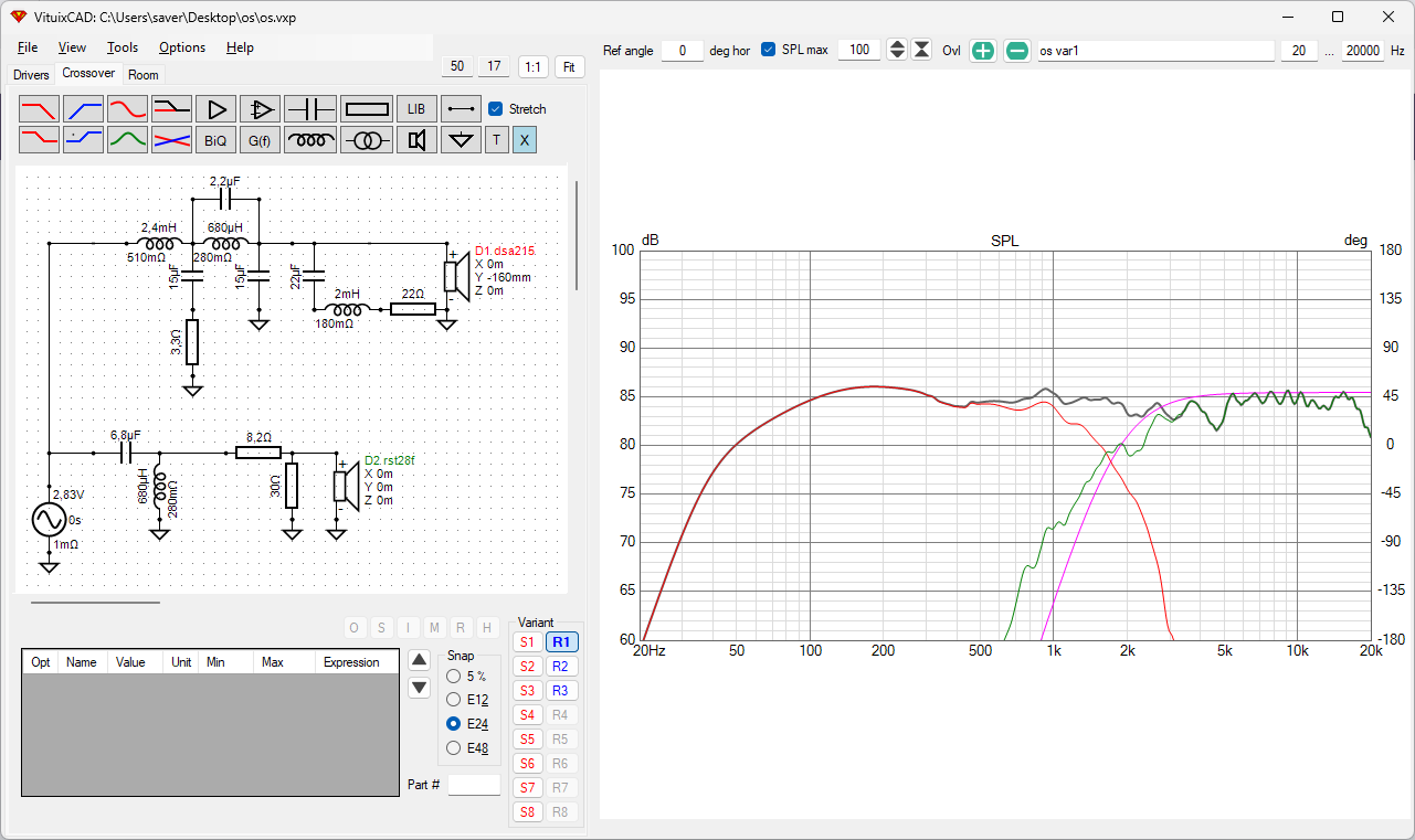

If it sounds good, it is good, some say. Without measurements, who knows what's going on?

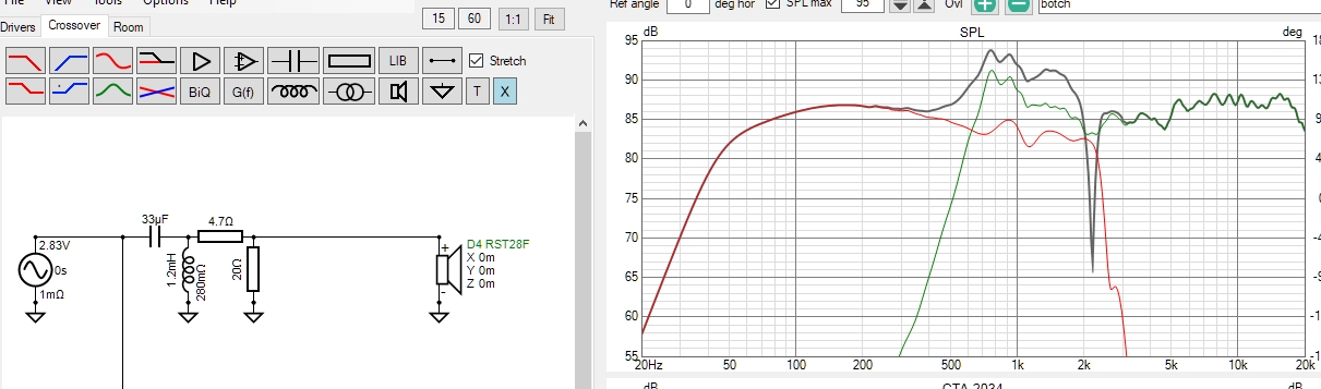

I plugged in the original XO but simulating with the Dayton dome tweeter. Unadjusted, you'd get something like this.
Even if adjusting the level, this slope of the tweeter and overlap to the woofer is really not looking good.

But you have the padding for the flex-8 horn. I'm using (4.7R + 20R) instead of the flex-8 horn (10R +.9R). The designer padded the hellI plugged in the original XO but simulating with the Dayton dome tweeter.
out of the horn , as it has SPL of 107db. The Dome is 92db.
I figured the LPF had some losses , so dropped the dome down 4db. At least I won't blow it !

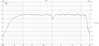

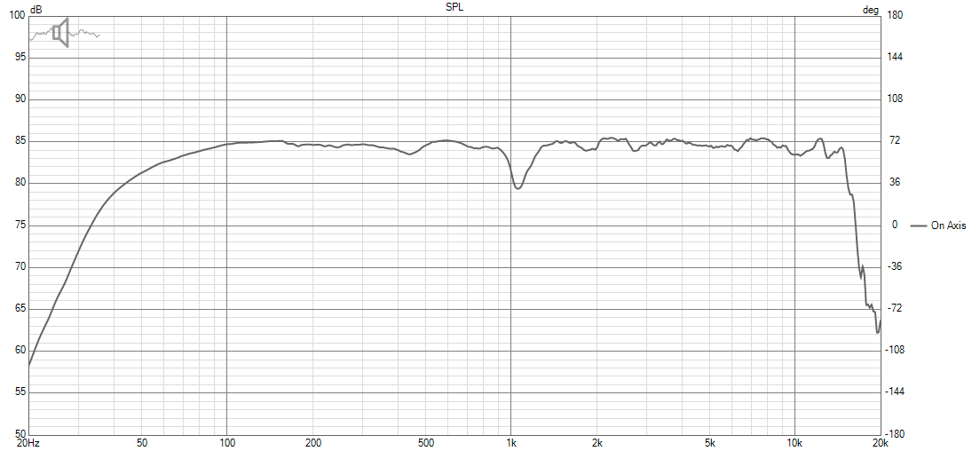

I only have a phone app that checks levels (below)...
1-3K seems to be within 2 db (even at 105db+). Phone mic sucks , just slightly accurate from 500-15K....
(below 2) is the flex -8 with the horn. Tweeter slope looks similar to a PE dome.
Phasing is right at the Xover point (2K) , no cancelling - down 3db 2K- and up. I might change the 4.7R to 2.7R to boost
the tweeter.
(below 3) is the actual DS-215 with that big dip at 1K. 1K is perfect on my actual speaker. I only hear it on the woofer , disconnect the
woofer , -15db on the dome only - hard to hear.

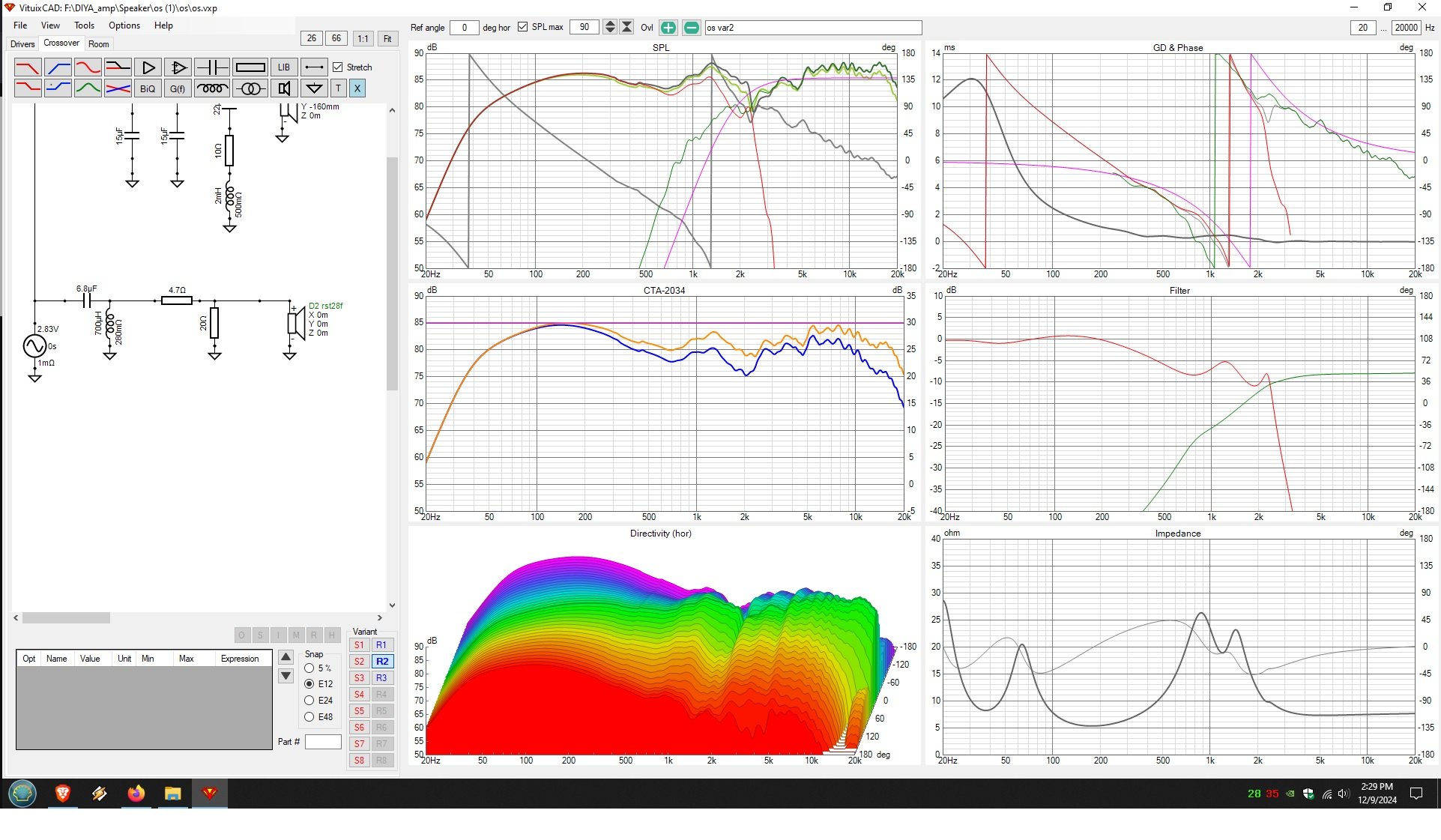

I was just illustrating what happens if you use the main filter (cap and coil) for a completely different driver.
If I plug in your resistor values for the l-pad, this is how it models.
Inverting either driver shifts the null to a wonky peak.
The biggest problem is the tweeter slope around 500hz and hump about 700hz; you only optimize/fix this by trying to complement the woofer slope; i.e. change the tweeter filter to 4th order or more and shift the tweeter crossover point higher.

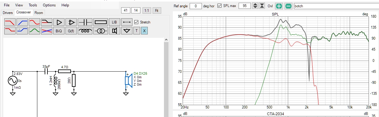

Can't explain that. Here a quick and dirty to my point about a steeper tweeter filter to complement the woofer filter. Phase and impedance not so bad.
If you have the parts, you may try it, but then you might as well look again through all the other sims submitted in the thread and pick another to also try.
Everything is made harder by using the PCB crossover designed for different drivers/tweeter to the one you actually own.

Just as spice that depends what you feed them. With real measurements in the actual box the simulation tools can give incredibly accurate results!what level of accuracy the speaker models have
The 2.5K dip is generated by the interference between W and T in 1-2K range, also you need to smooth the woofer peak at 1.5K and reduce the dip on the 500-1K caused by the LCR. You can add a resistor in series with first cap and increase the resistor of the LCR notch and then pad down the Tw as you like by adjusting the parallel resistor. The TW filter slope is LR4 acoustic.Final solution - below.
Weird , can't (real world) measure that 2.5-3K dip in the sim ??
