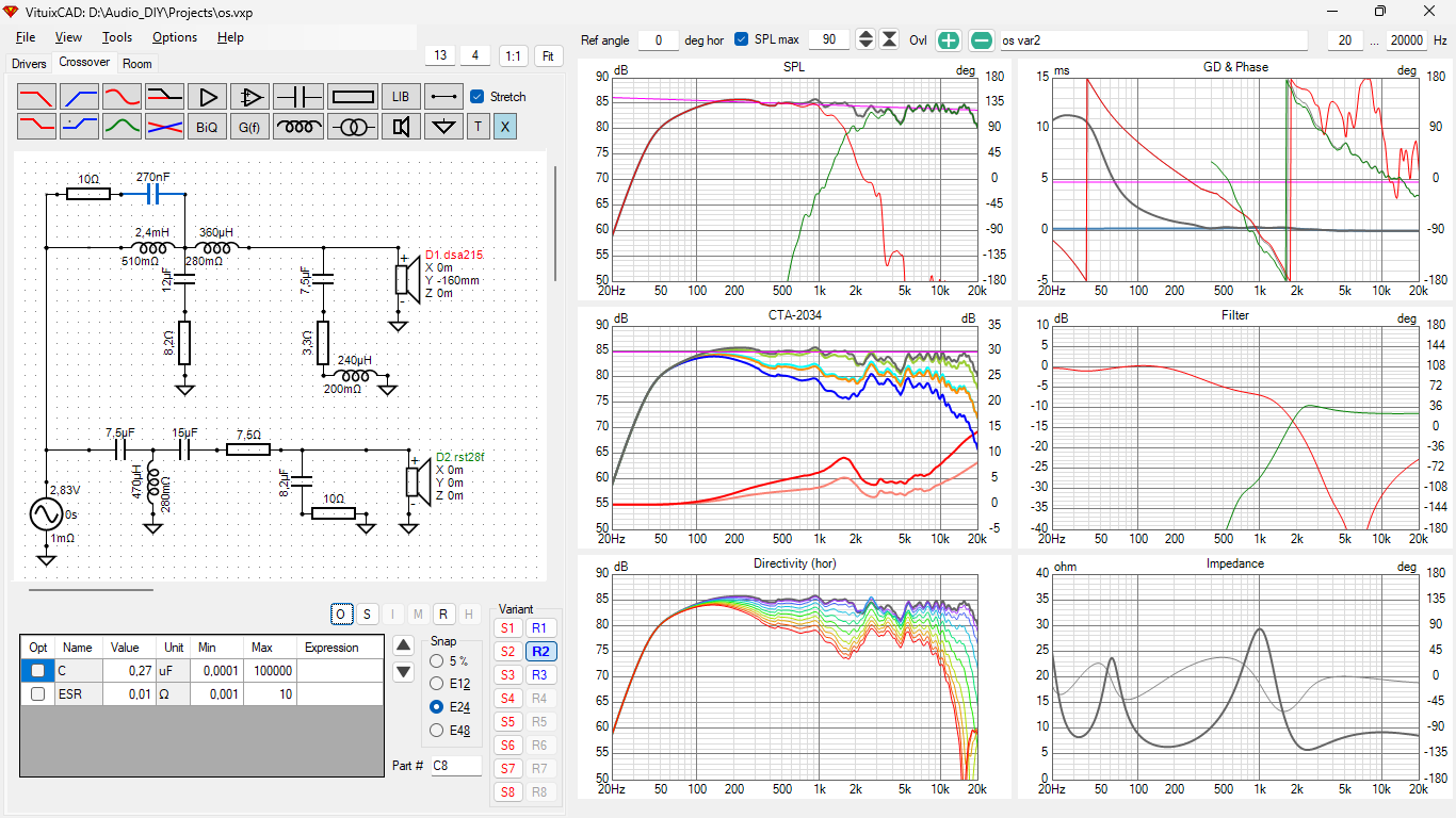

Hope you don't mind, I did a rough sim in vituixcad going for LR4 at 2k using @DcibeL's guide for approximating baffle step. I used rough woofer Z offset of 50mm and Y offset of 178mm. Very rough guesses, but anyway, it's not as simple as Allen's, but I tracked the tweeter with a slight downward tilt as you mentioned the speakers currently sound bright. Here it is:
Reactions: AllenB

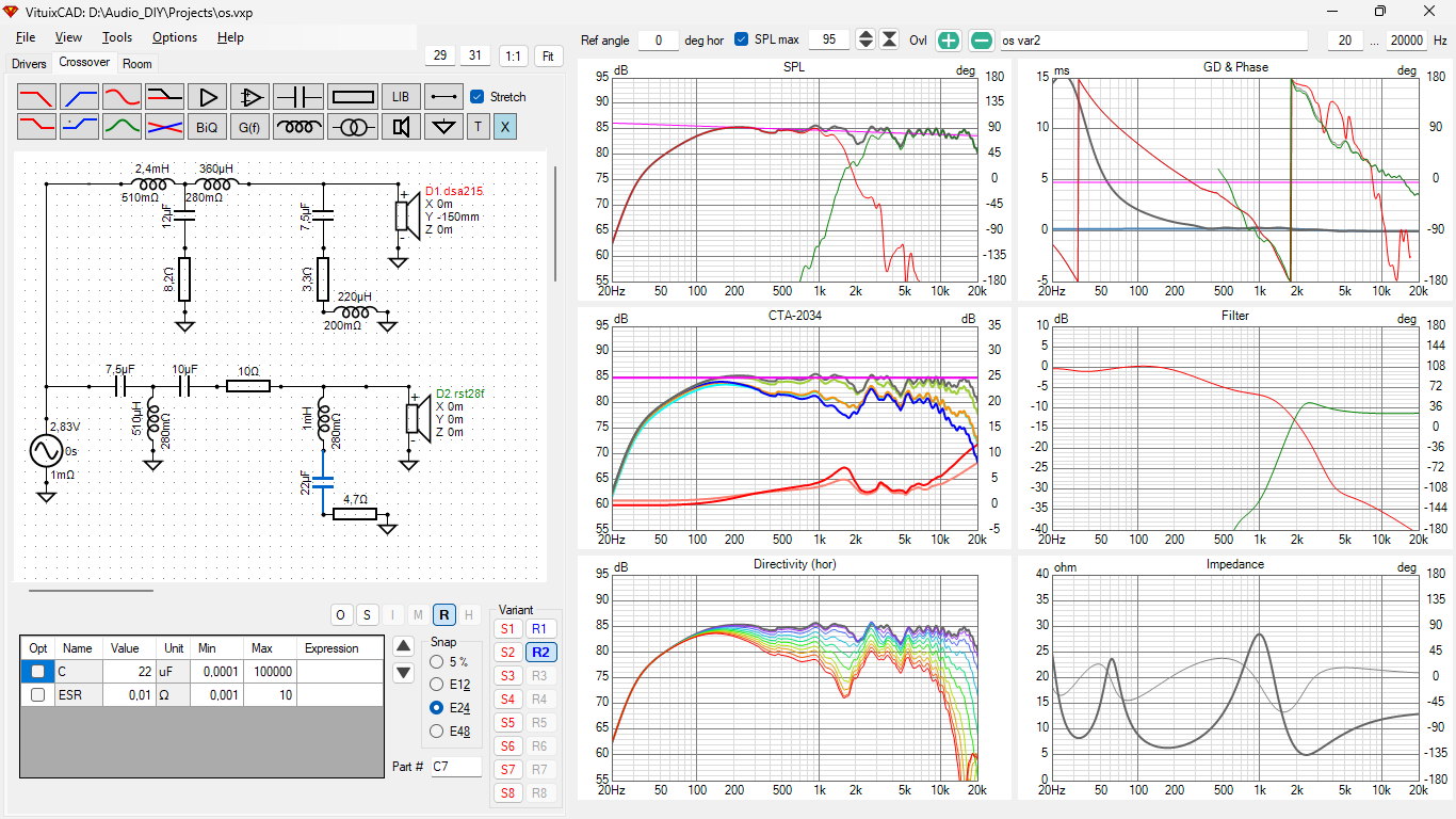

I'm new to that website, but I agree that the woofer crossover linked is frankly weird with a brutish notch, and its almost brick wall slope does not mirror the otherwise straightforward tweeter filter at all, which is closer to LR2 than anything else, at about 2.2khz. Assuming their measurements are fine, I just started at 2k cause it's a bit removed from the glaring dip in the woofer at 1k.
This shows the difference from the values in post #1..

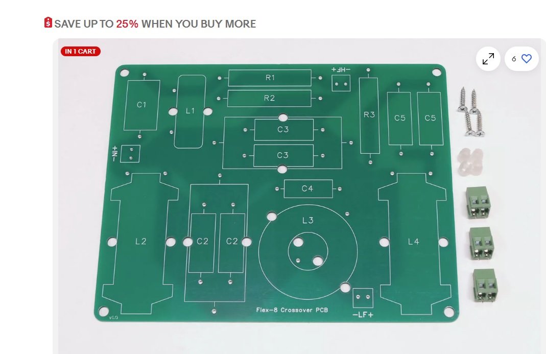

I can do that , I have lots of room on the Xover board (and the parts). This Xover (below) is so populated already - why not !

PS - I need to get the "L2 - L4" to populate it. I found 4mH used (unwind some to make 2.5mH) and found 2- 2mH (used).
All for about 25$. I have all the caps .... I'm the "amp guy" - I have 4 DIY amps (Wolverine,Sonance260,H-K680 ... and a HYPEX 400w) !

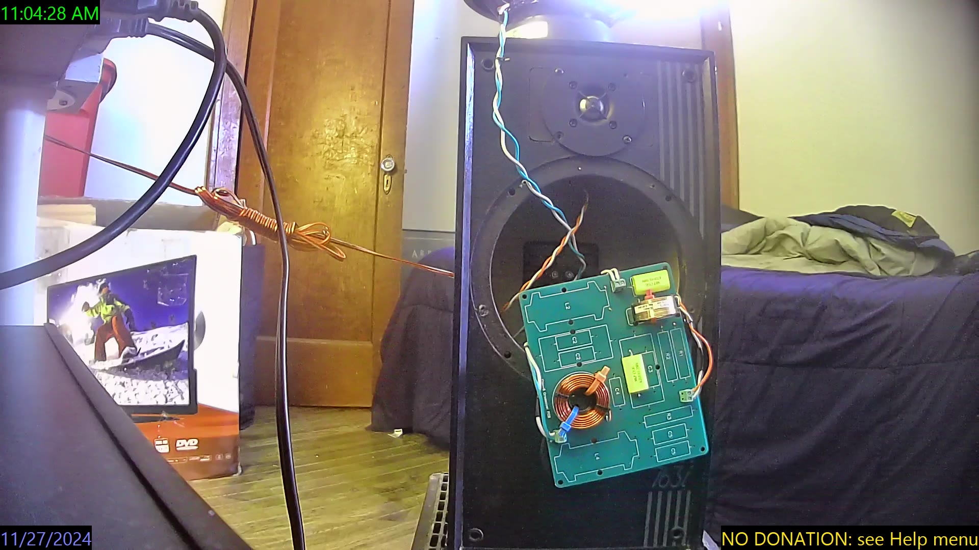

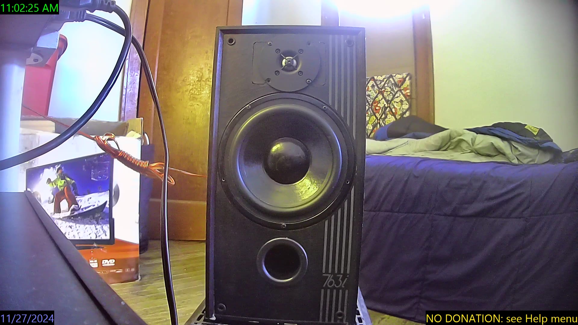

Here is the box , besides the actual dimensions - the volume is within a few liters of the "FLEX-8" spec (22L).
Port is 18+ CM long- 60mm flared.
I cut my Mission 763i's down from 35L , now they are big bookshelf speakers. The specs of the DS-215-8 worked out best with around 20L.
The bass was a bit lower <45hz in the big boxes , but now the SPL is higher across the rest of the drivers range. upper bass was "muddy" at 35L.
I have my 2.5 and 2mH inductors ordered , can't wait. The 1mH you see , I will reduce them to .6-.7mH.
I still have a choice on the tweeter . I did not know the tweeter needed a zoble , it's Z only deviates at it's 720hz Fs ??
I see the modeled SPL at 85-86db .... so these 3rd/4th filters order have quite some losses ? DS-215 is 90db , tweeter is 93db.

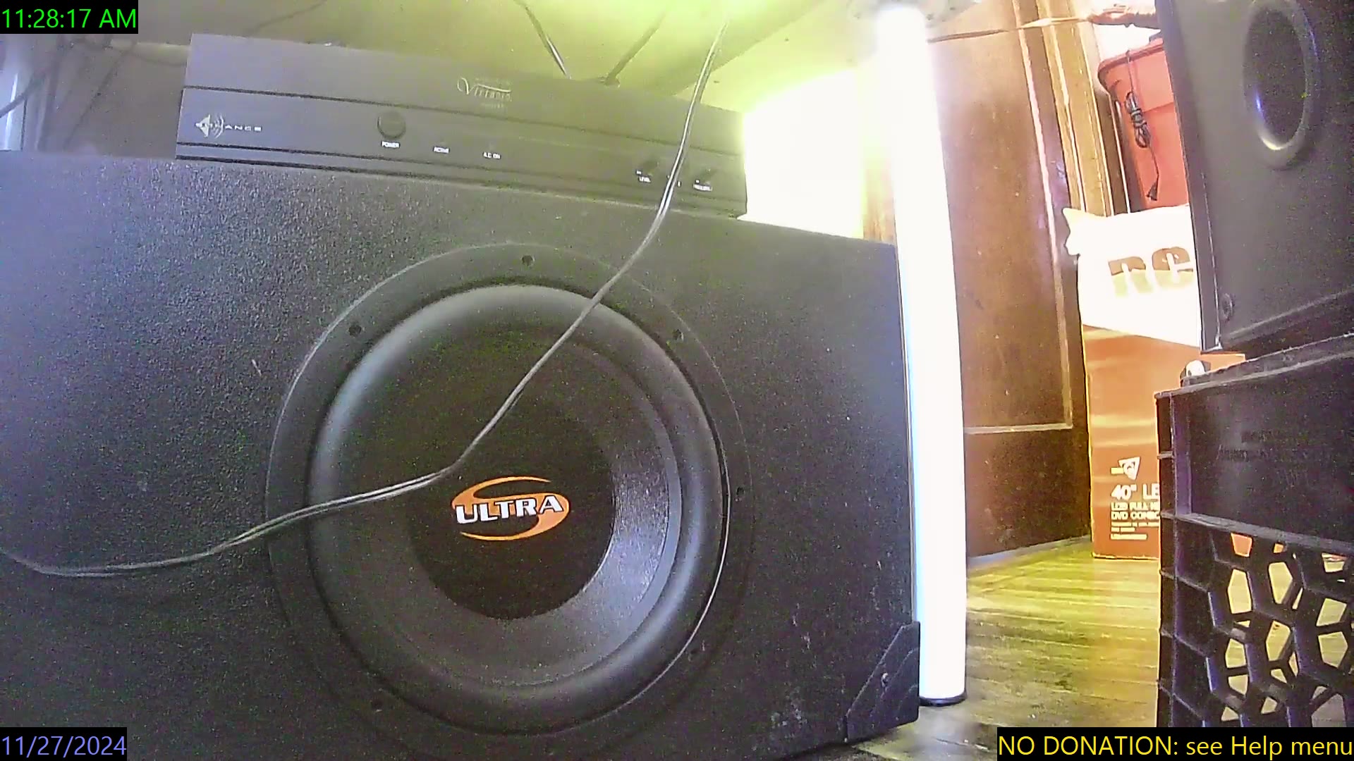

With multiple amps, you could consider an active crossover.
I don't have THAT many amps🙂 . I do "sub it" for music , DSP can split hard at 70-100hz. That rebuilt amp on top is class D 320W with a DIY
op-amp LPF (with a no B$ adjustable phase). That sub has 60mm Xmax !
I do have a full 5.1 DAC , but my top (good) DAC is just stereo (Topping E30).

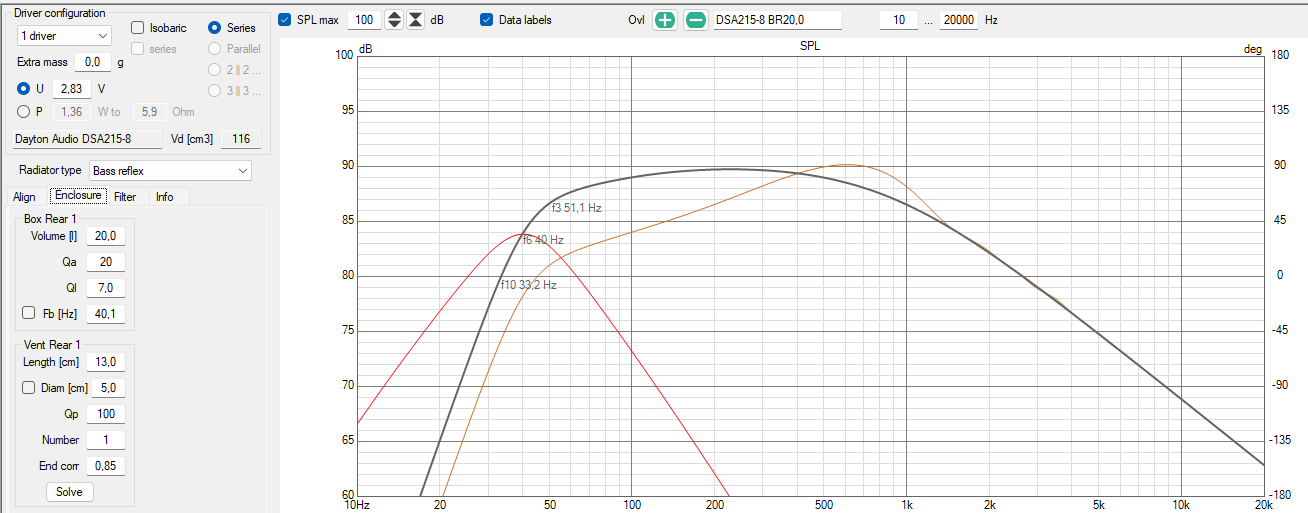

I have updated the simulation with your data (20L volume and the correct vent size without the flare).
SPL is 85 dB because of the baffle step loss.
I used a notch on the TW because there is too much energy in the 2-3kHz range given from the tw response summed to the woofer breakup. I tried to reduce that energy and get a better in-room and power responses, but then the on-axis response sucks because the blanket is always short when you cross an 8" to a tw over.
XO is LR4 acoustic @ 1750Hz
I attached the files I used if you wanna play in VCad.

Even as I thank all for these tips , I might just go with the original design. I have the PCB and BOM.
All I might have to do is reverse engineer for the domes I have....
Speaker parts are freakin' expensive , hard to re-purpose inductors and big poly caps.
