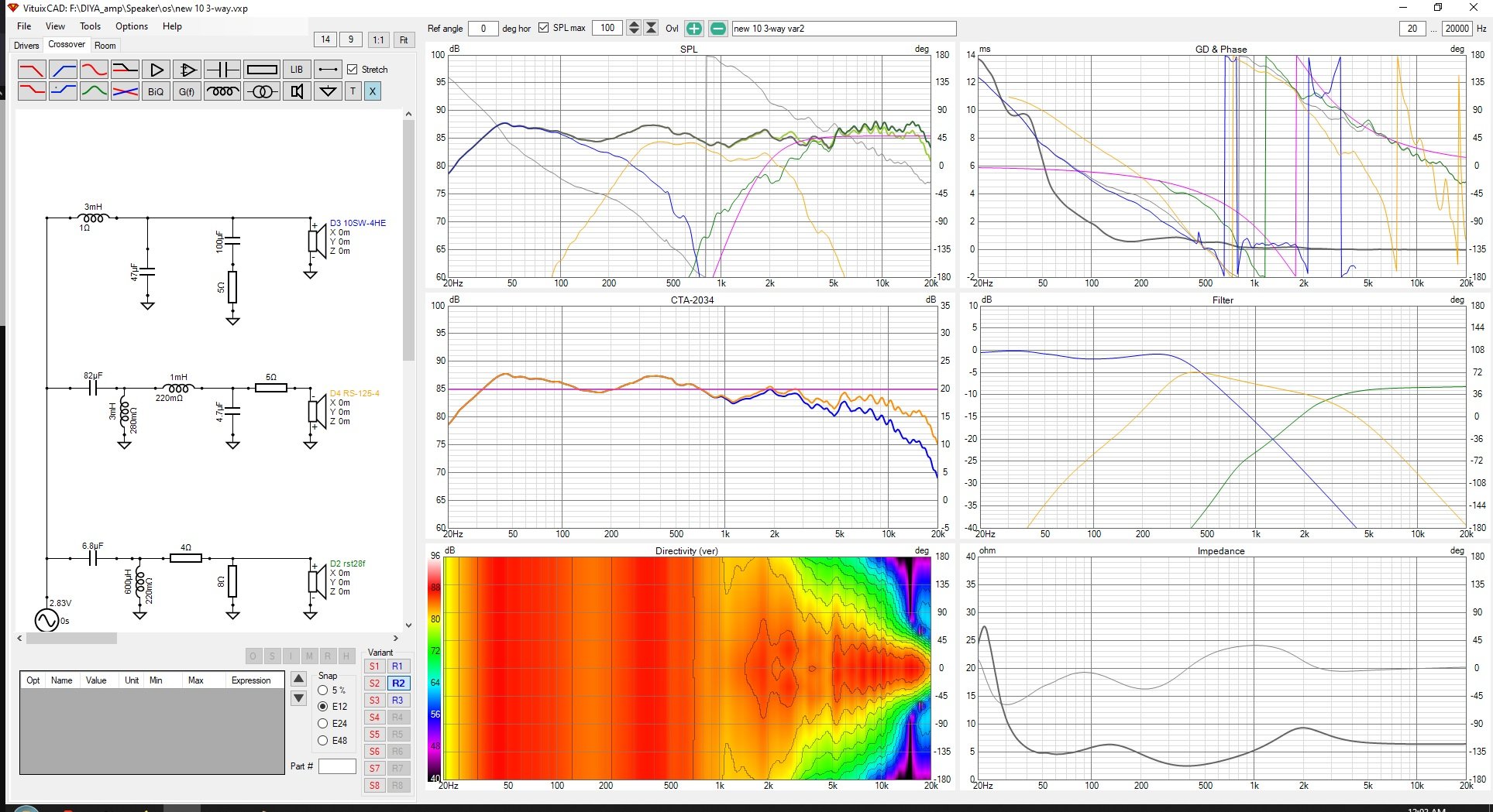

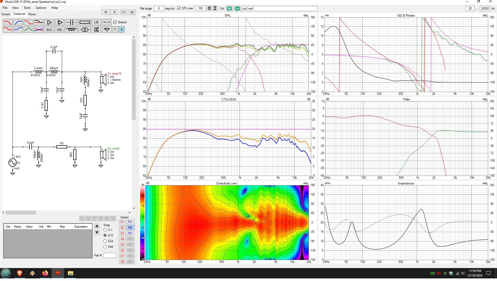

NICE ! Just a few resistors. Cool ! I'll have to order them. Thanks.The 2.5K dip is generated by the interference between W and T in 1-2K range, also you need to smooth the woofer peak at 1.5K and reduce the dip on the 500-1K caused by the LCR. You can add a resistor in series with first cap and increase the resistor of the LCR notch and then pad down the Tw as you like by adjusting the parallel resistor. The TW filter slope is LR4 acoustic.

Yes , COOL. I'll even be able to add the new 3.3R right next to the existing C2 PCB pads.
2db is smooth enough.

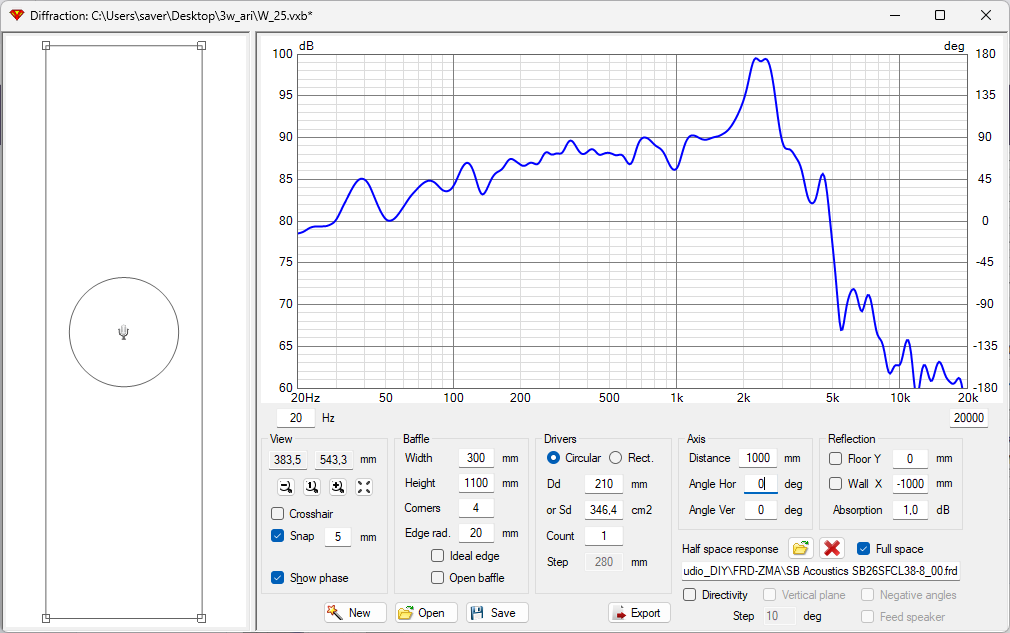

For Mid and Woofer, you should use the impedances of the drivers in box calculated by the Enclosure tool and not the ones given by the manufacturers.Yup , nice.... (below).

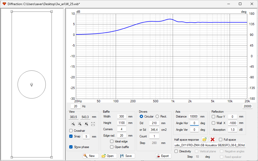

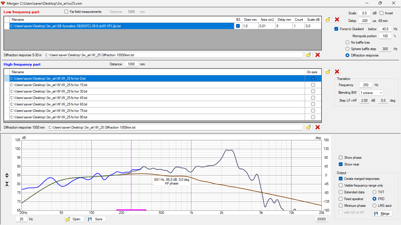

You also need to calculate the baffle step loss with Diffraction tool.
LF section @ 10m
HF section @ 1m
And then merge LF and HF: check the item Directivity if you want off-axix FR.
