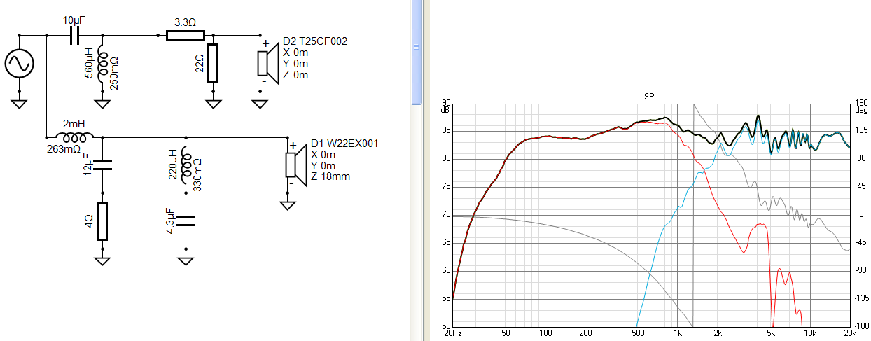

Speaker built
Hi Guys,
First of all I wish you all a happy new year.
Well I have built my new speakers using the Seas Trym drivers T25CF002 and Seas W22EX001. I built the crossover from the Seas supplied schematic for the kit on their site. I decided to abandon the proposed stepped baffle and waveguide options in favour of a conventional baffle with drivers recessed.
I have just spent an eternity trying to add pics to this message but I guess I'm not up to it.
Now for the adjustment phase!
Soundstage fantastic. Depth fantastic. Focus fantastic. However there is a huge problem with the base. I've tried all sorts with the damping or lack of it to sort it but to no avail. I want to stress that the bass is NOT boomy. It is tight, punchy, articulate, rhythmic etc. Just too dominant. I have noted that by raising the volume level for voice and the upper frequencies that the bass is very loud and I'm thinking of the neighbours. It seems that there is an imbalance between the two sides of the crossover.
One thing I have noticed is that when I check for the 1db attenuation I get 0.65 series and 49.17 parallel for the L Pad resistors. The crossover however asks for 3.3 for series and 22 for the parallel resistor.
I was wondering if my problem is caused by attenuation?
Any help welcome. However please don't ask for measurements as I have no means to carry such out. This is a build by ear. If I can refer you to the seas web site for the driver data sheets and the Trym crossover schematic I would be grateful. I am sorry I don't know how to post pics from my PC.

Where are you placing the speakers? What are the distances to the nearest walls?
Is the enclosure ported or sealed? if ported - what happens if you stuff the port?
Hi Dave,
I don’t have much lee way for adjusting placement. The speakers are 3/4 meter from tha wall. Same place as before using same 45L size cabinets which are ported to 35Hz. Have tried the bungs without any success and also tried removing the port tube which effectively tuned the cabinet to 59Hz. Nothing helped. The damping alterations produced subtle changes but didn’t improve the balance between the low and the high. Martin.
My simulation changes show a change of LPAD resistors from
3.3 / 22
to
0.65 / 49
increases overall tweeter / treble response by 2.8dB from around 2.8KHz up. This should definitely be noticeable - but you may experience a bit of a dip in the 1 - 3KHz area (since the tweeter is now significantly boosted). I'd expect this 0.65/49 combination to sound a bit bright.
I'm surprised you say it's bass heavy. The Trym crossover has not a lot of bafflestep compensation by my simulation and tweeter level is appropriately attenuated to match.
What reference tracks are you listening to / using? The next step would be to play tones from a generator (e.g. using WinISD) to see where the "bloom" occurs.

We seem to have an established design by SEAS here:
TRYM
45L of reflex box. Looks a bit bass heavy to me. 2mH IS a whopping bass coil. I'd better get my simulator out. We might find 1mH more to taste. But I just don't know at this stage.

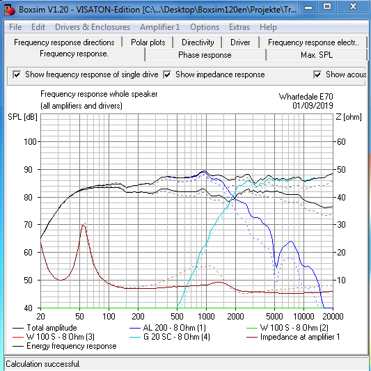

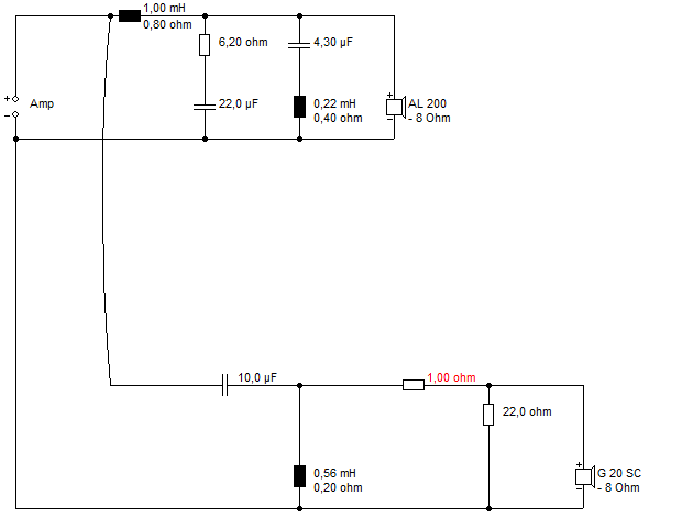

With a switch to a 1mH inductor you are going to get gain in the 300Hz to 1.5KHz area increasing from 1 dB to 6Db - this will reduce bafflestep. It doesn't screw with the phase too much and you still get LR slopes with the XO point shifting up slightly. You're also increasing the playing range into the W22 breakup - so may introduce other problems. Changing a crossover as suggested really needs measurements. Swapping the inductor out will change midrange response and this may upset things about the speaker you find perfect.
All suggestions are really flying a bit blind without a combination of gated, nearfield and finally 90 degree in room sweeps to get a full picture.
The cost of buying 2 1mH inductors and shipping might be the same as buying a MiniDSP UMIK-1 and measuring and being able to see what's going on 🙂
The reason I went for LPad changes as you asked the question and these are cheaper components - and easier sourced. If they don't work - less money wasted. They also have less impact on other parts of the system.

Let's take it from the top.
TRYM
If a speaker seems bass heavy, you reduce the bafflestep coil. 😎
I ran this one up the flagpole in a rough and ready way with a smaller 1mH coil and did a couple of other adjustments. Looks alright to me. 😀
