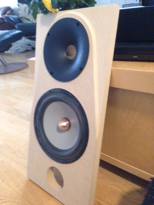

Dave I am going with the Seas T25CF002 with the W22EX001.
Overall baffle dimensions are 305 x 940. The top tweeter baffle is 6mm thick by 160 x 305.
The woofer baffle is 24mm thick with a 45 degree chamfer on both sides and a 22 degree chamfer on the top. Dimensions of front face are 269 x 773. Back face is 305 x 780. So there is a baffle sloped step of 18mm between tweeter and woofer. The cabinet front wall is 18mm giving a total wall thickness at tweeter of 24mm and at the woofer of 42mm.
Tweeter centre is 95 from top. Woofer centre is 287.5mm from top.
I will be interested to see how your simulation and xover differs from the Sub-Chebychev based xover of the TRYM.

In this case the original TRYM xover won't work as it is designed for a flat baffle. 18mm is a lot in term of phase at the xover frequency.So there is a baffle sloped step of 18mm between tweeter and woofer.
Also your baffle width is not what it should be, but that is a secondary problem, you should at least build a flat baffle or add a 18mm sub-baffle for the tweeter.

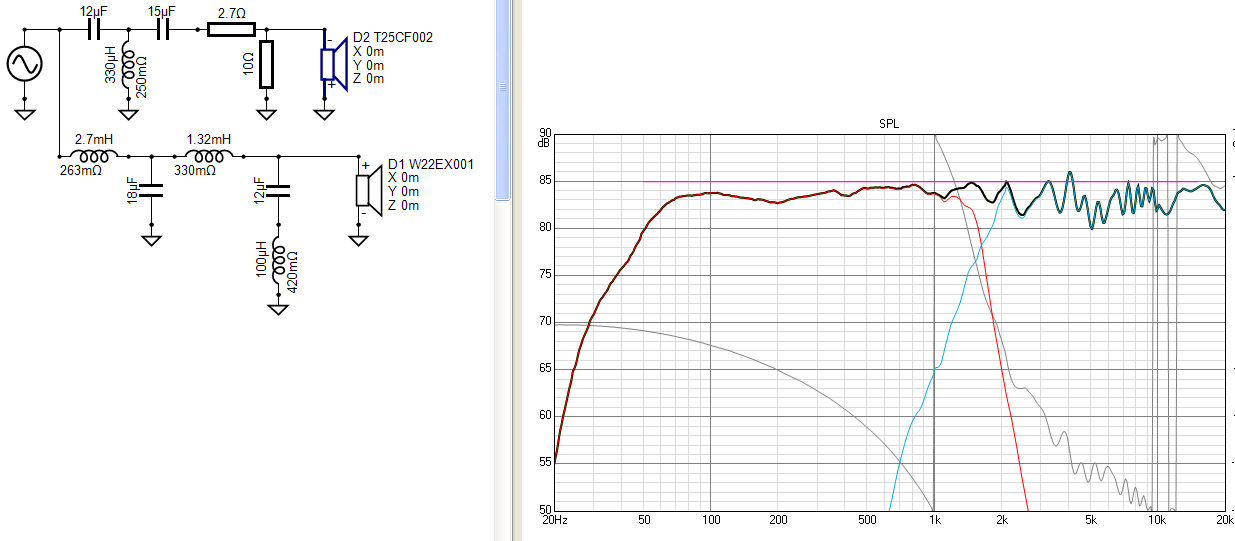

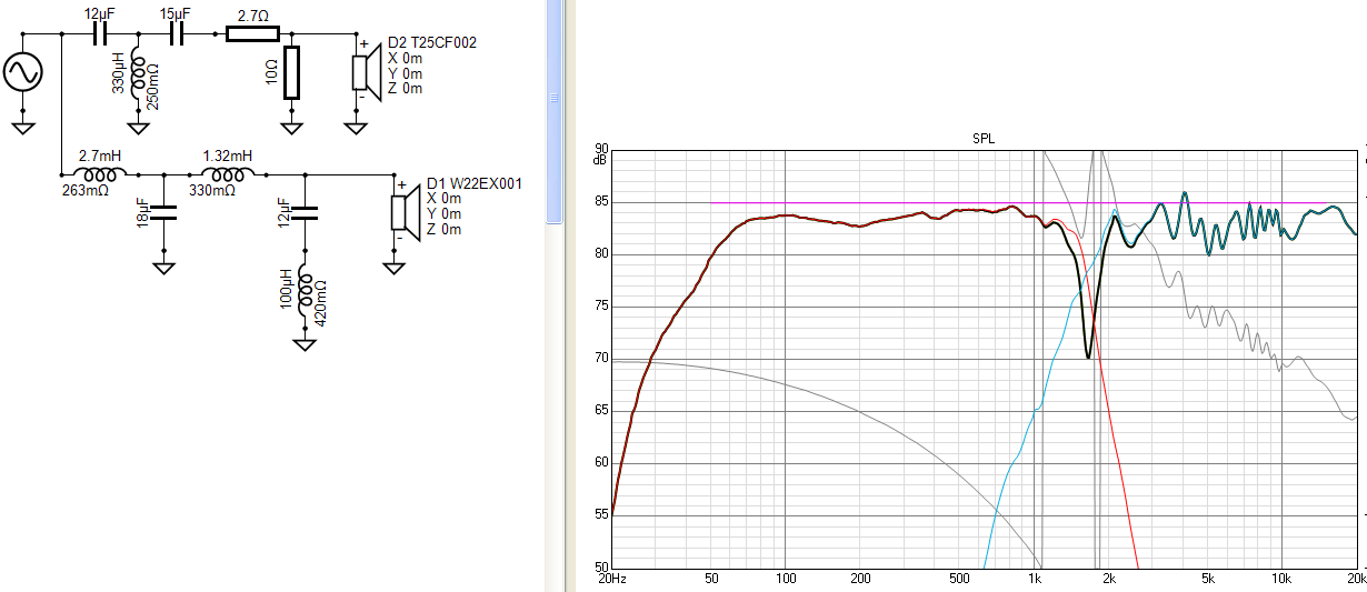

Here's my attempt.
I've assumed a stepped baffle of 18mm - still requiring another 30mm (guestimated) for Z offset to VC centre of the W22 and angle up to the tweeter listening axis. My L26 is ~ 37mm back from the baffle plus the angle up to the tweeter listening axis. I can change this if you can please measure the baffle face to VC centre of the W22 and repost.
I've targeted a LR acoustic steep slopes. I did this for 2 reasons:
1. Avoid W22 breakup
2. Avoid stressing the tweeter

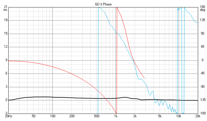

I arrived at a Fc ~ 1639Hz - which really is a little lower for the T25CF002 than I would prefer. the T25CF002 has generous xmax (0.5mm) and with the steep slope applied, I am hoping the woofer shows stress before tweeter issues - but I have not modeled excursion (yet) to find which gives up first.
the simulated in box response of the tweeter used a 0.6m x 0.8m source BDS for the Seas factory measurement (I have assumed a centred "worst case" position on this baffle as it is not stipulated - rather than IEC offset). This results in a lot more ripple.
Secondly, the target baffle I found a peak at 4Khz which may not be there in reality... So I would look at an average response in this reason rather than stressing.
This is where in box measurements will be vital. I am confident when I have good source data - but I'm layering guesses.... Note the reverse polarity of the tweeter.
Feel free to ask questions.

Thank you Dave. I appreciate the time this must have taken. I also appreciate the difficulties of using a stepped baffle. I have added to the complexity not only in xover design but also cabinet construction. I am going to take some time now and after the seasons festivities are over hopefully I can make a decision about which direction to follow. I have a great deal to think about.

You're welcome Martin. I find these exercises fun and it gives people food for thought. Heck - criticism is welcome.... I learn 🙂
With metal drivers (I use them), the compromise is limited passband or requirement to use more crossover parts to hammer the response into the required shape and / or attenuate the usually severe breakup.
Using drivers that aren't intended to "meet" therefore means even more extreme measures than usual. Hence the extra crossover parts than would otherwise be seen in a conventional 2-way.

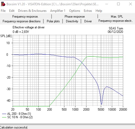

I was messing around with the SEAS TRYM, myself this afternoon. Software | Visaton
I didn't find any solutions better than SEAS came up with:
I find no convincing arguments for stepped baffle here. But maybe waveguides might be a game-changer. Dunno.
A waveguide would certainly be recommended. This should effectively allow a nominally 2000Hz electrical co to achieve the required 1639hz as per my design and reduce tweeter stress therefore distortion. The waveguide however will not address the potentially harsh H3 at 1400hz of the W22. Only the listener could confirm whether tolerable

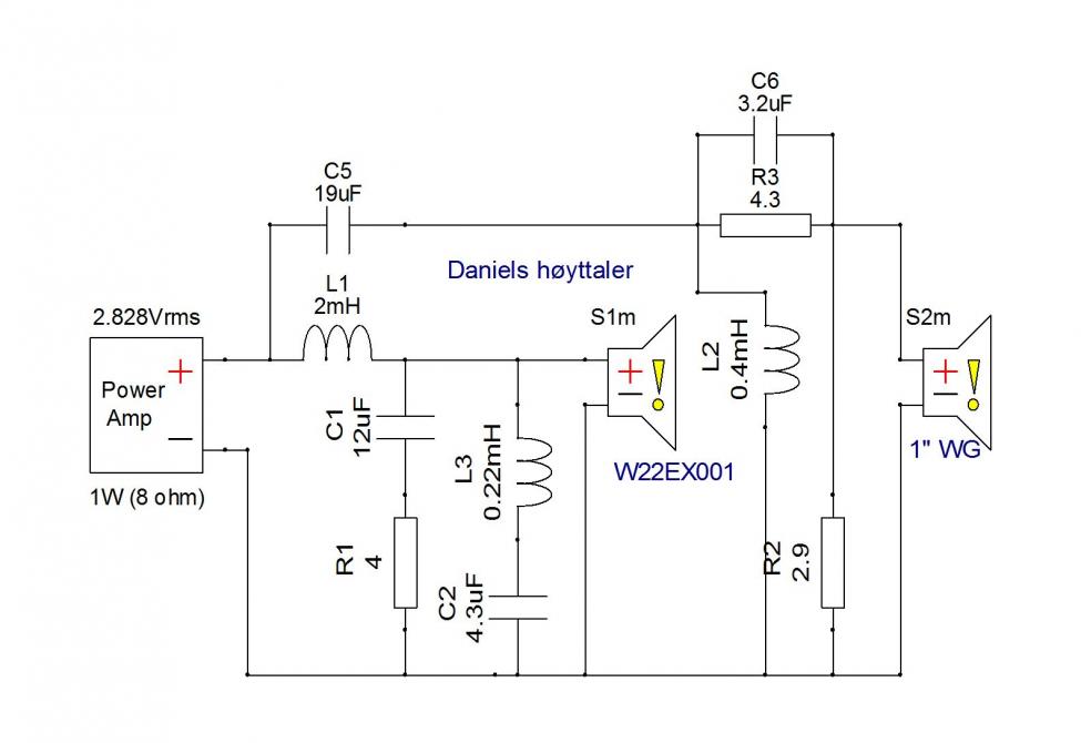

Seems to be using a SEAS 27TDFC tweeter, with unchanged SEAS Trym bass filter.
Seas TRIM (W22EX001 + WG)
Zaph|Audio
